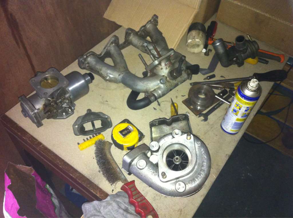

you will only need to "clock it"Only issue is my output is facing downwards , but thats not the end of the world
Am i right in saying this can only be done in 180 degree rotations ?you will only need to "clock it"![]()
you can usually clock one any angle you want (usually a locating dowel to remove first)Am i right in saying this can only be done in 180 degree rotations ?
Iv heard so too , the mg metro turbo uses a converted blow through version , but the basics of the carb are different from a lot of others , and seem to be very reliable , and durable .I have heard that SU carbs can deal with turbos quite easily. Good luck as well mate.
Yeah I have seen that the Turbo SU's have some sort of expansion tank on them. If you need anyhelp best bet is to visit the Turbo Mini forum. They are always turboing SU's.Iv heard so too , the mg metro turbo uses a converted blow through version , but the basics of the carb are different from a lot of others , and seem to be very reliable , and durable .
And thanks mate , all progress will be shown here , slowly , but surely![]()
Yeah originally wrote that as I was thinking about regular carbs. No idea why but alot of people prefer to turbo SU's than any other carb.Im confused with all this , my email says this is what you said :
Wish you luck mate but a turbo and an SU wont end well.. Have you considered putting the carb before the turbo?
Thats quite the oppiste of what you actually said
As regards su with turbo , my carb will be going before turbo , so its acting as normal , no real difference as far as its concerned
OhIf you keep it the way you have it now, you will have to move the alternator to clear the exhaust you have to make,
Think you will have to move the alternator either way, coz if carb is on other side, it will hit that too
