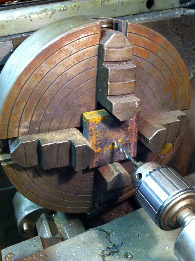

So put in the ffour jaw chuck ,
Grabbed the piece ,
Drilled it till i could get the boring bar in and opened her out to 44mm
Drilled the other holes
Opened them out bigger and haypresto :)

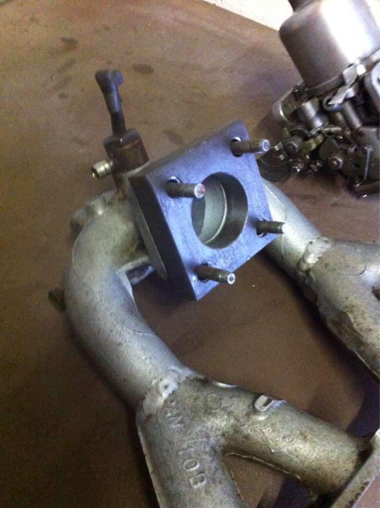

Total cost of spacer €1.50
And 35 mins of my time again i swapped chucks over and all :) saves tryna find one and post it to ireland :)
Plus its another piece i can say i made myself :)

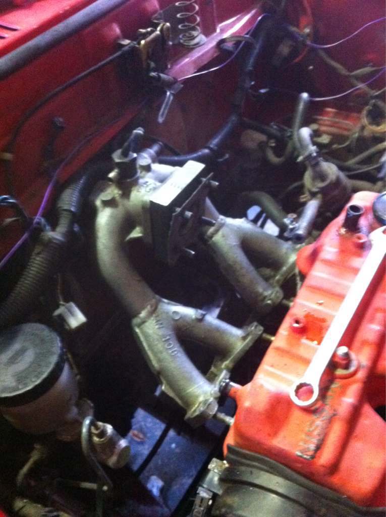

Thinking of spraying the intake mani and my home made adapters vht black will that make a difference ? Was considering taping up important stuff and doing the ma12 head too ?
Yes , i promise :D at the moment im confident about the SU on its own , just a little nervous about turbo so i was gonna run SU for short while whenever i get it on road and when it goes off the toad again ill turbo it , baby steps for me , really dont want to **** it up :p

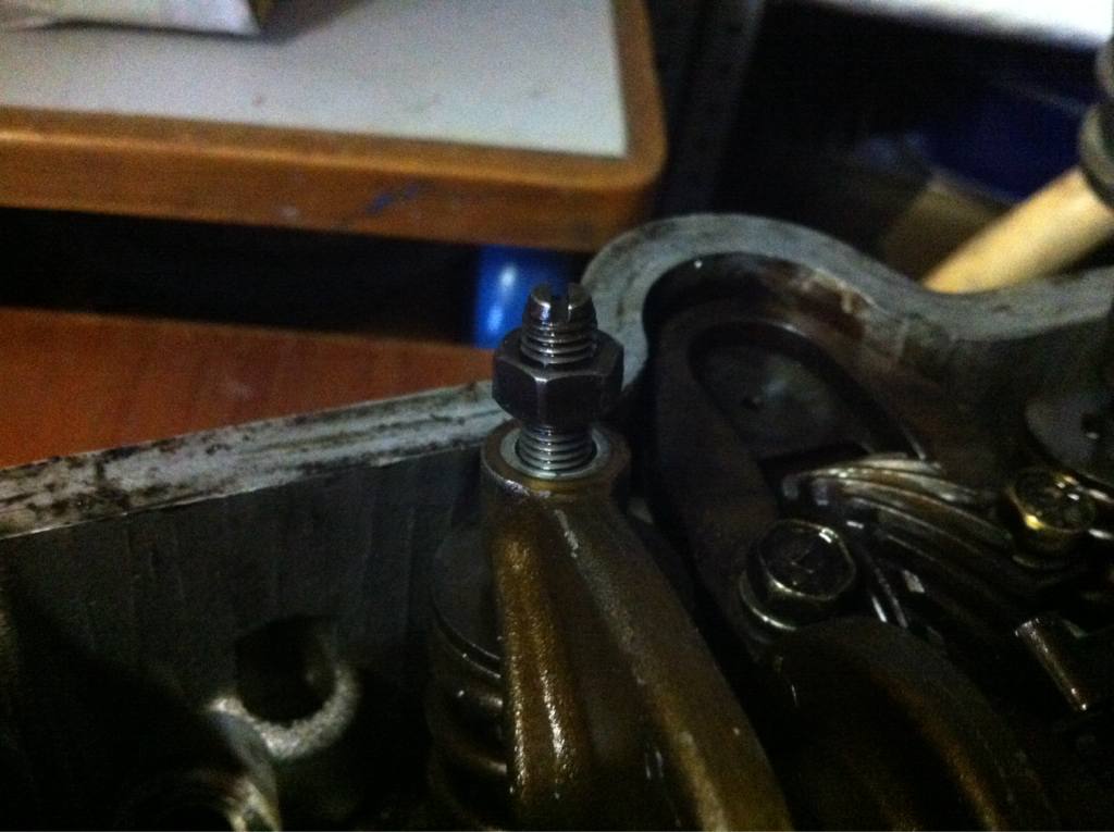

So missing nut on ma12 head , does it matter how tight they are ?
Gonna have to take ma10 head off before i evenss try mani so will be puttin on ma12 head , anything i should be careful with when taking it apart ?
Yup , i dont think it came with a nut but its no biggie i probably have one in workshop :)
