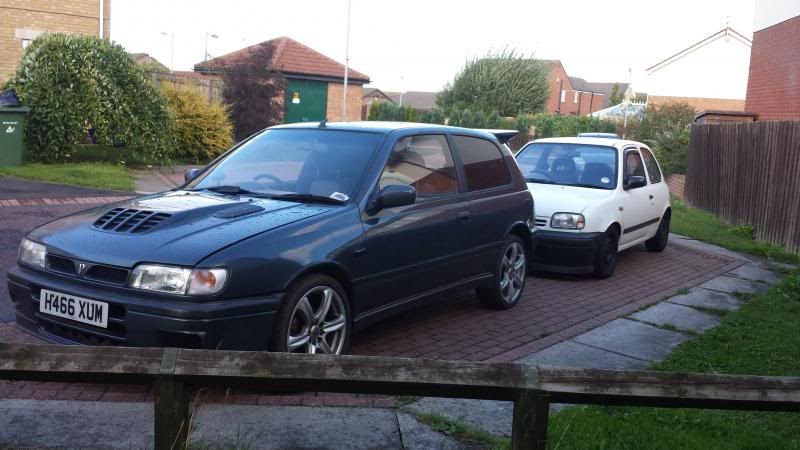

im now on the hunt for a pulsar gtir to make mine 4wd whole hog then do a ve head conversion once i get my hands on one.
It'll be good to see how a simpler traditional engine mounting and transfer box stacks up engineering wise against a boxer engine and its huge gearbox :)
Give me a shout if you need any R' advice.. Not wanting to blow my own trumpet, but there isn't much I don't know about anything to do with them...

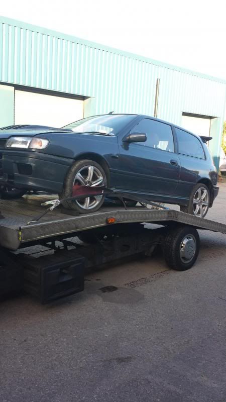

Gtir is in the same state as my old p10 primera. To save it would need a reshell. Everything from the pulsar is goin into the micra so it will be wide tracked and suspension mounts welded in too. The whole car will be stitch welded and rollcaged. So i dont see why it wont handle well to be honest.
The r has a bad misfire like its flooding bad. But i havent had a look into it yet il check it over for the usual stuff soon as i get the time. Want it running like it should before i fit into micra .

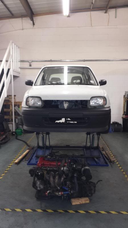

well thats the current sr20 setup now sold.

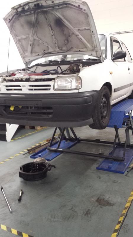

so over the next few days its getting stripped and so is the gtir so i can start.
1st step gonna fit engine and gearbox into place weld in mounts etc.
2nd step line up the rear subframe for fitting and welding
once thats all perfect remove all and start seam welding the chassis and fitting a rollcage
