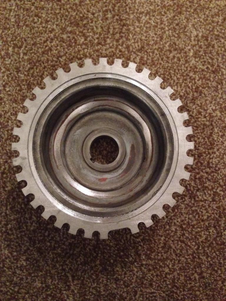

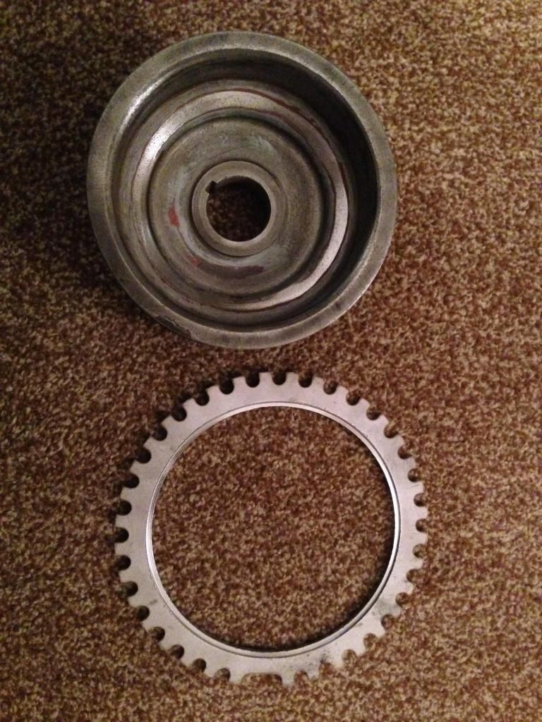

Yep, engine set to tdc then the missing tooth and sensor can go where you like as long as they are 90 apart.... Or as pork said some ecus can run at various degrees as long as you set it in the software.
The hawk ecu I had could be calibrated but had to be at least 70deg btdc :)
