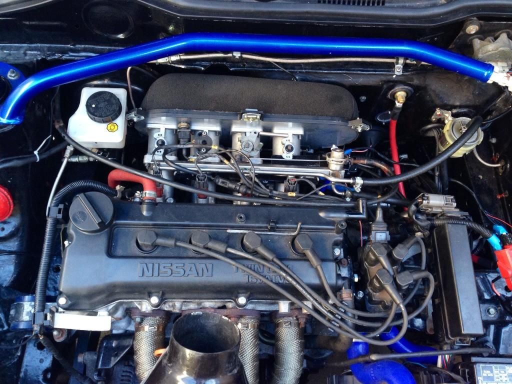

Today got the ignition timing synced in with the ECU
However I think the TPS min man max are out as it's not retuning to idle when the throttle closes it's reving down VERY slowly so a reset of that and a look at the ignition table is next
This to improve drivability or for more power?
A bit of both hopefully, il love to hit the 140bhp mark and it will be a lot more driveable than the carbs. They are a bit like an on off switch, not much progression in the throttle. Now I should be able to keep much smoother throttle in bends rather than going into a bend and throttling it on the way out :)

A few nights this week should see the wiring all tidy and sorted, wideband to be dead to the ECU.
Brakes bless and checked over next Saturday before the wideband gets calibrated for some one the road mapping next Sunday afternoon[/URL]
Not much of an update, the fueling is 90% there with the ING map to be gone over this Sunday.
Cars pulling well right up to the limiter at 7k so far, with a temptation to move it up to 7.8k to see if there's much more to be given. No point in ringing it's neck for no reason.

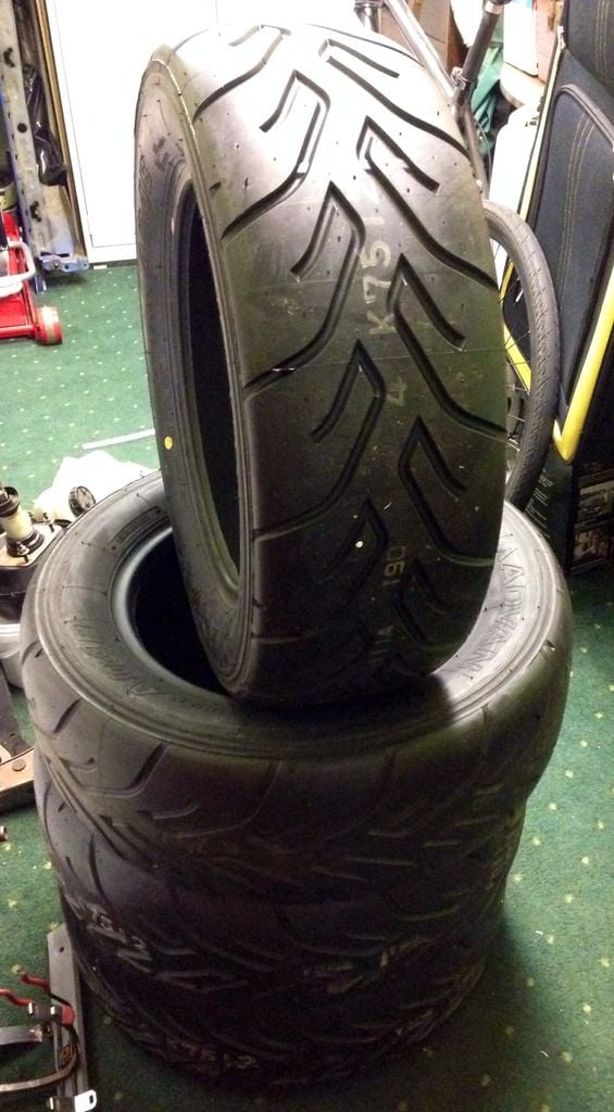

In the mean while the new rubber has arrived :)

Well the map seems to be 90% sorted. 4th gear showing the car pulling hard right accross the rev range. 151.1bhp shown on the readout but that's merely road mapping as a rough figure. 135 -140 maybe? But other than pub talk numbers we went with how the car drove.

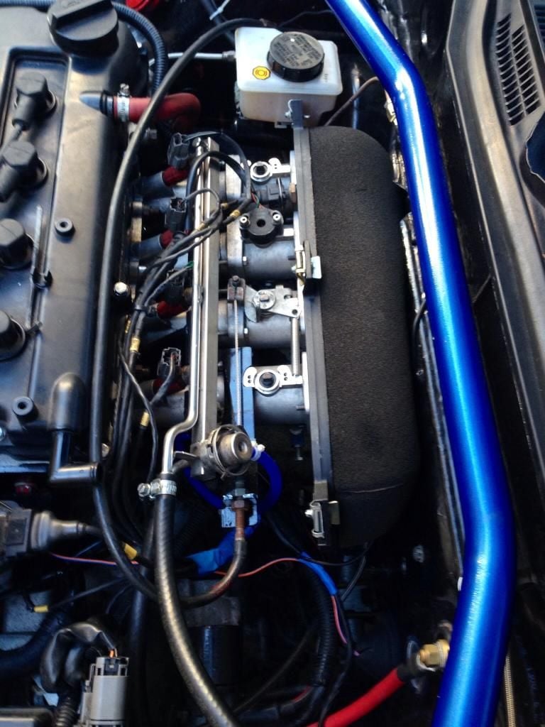

Hmmmm mine are the same, I was losing a bit of driveability as I'd reach WOT at 30% pedal movement. Been thinking of changing to smaller ones :-/
I was looking at that earlier and I think I might knock up some trumpets but maybe ones that insert into the TB to reduce the size a bit as I can't get much length.

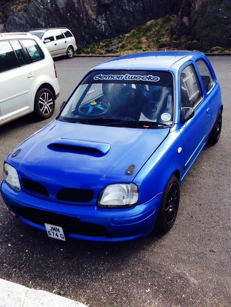

TEST AND TUNE
Today went very well heavy fog made learning the track crucial but lifted after a few hours!
Car went well all day as strong as ever, still amazes me the punishment CG / CGA motors take an still make ready power.
