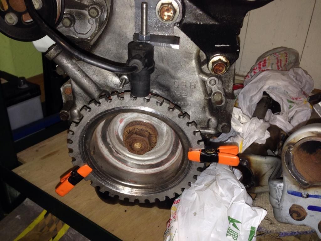

i would think before paul, then the ecu will hold the spark for 45 to 90 deg basically ?
what ecu is it ?
the omex pdf is saying 90 deg btdchttp://omextechnology.co.uk/600 ECU Installation Manual 2v01.pdf
the diags show it 90 deg before tho paul, and they say another option is to remove the tooth after welding (before again eh )
9 o'clock. Before TDCUnfortunately the wheel iv got already has the tooth missing.
I don't know why this has confused me so much, so with my sensor at 12 0clock il need the gap at 3 o'clock?
its confusing eh paulwith the sensor at 12 o,clock the notch needs to be at 3 o,clock (tdc cyl 1) which means it had triggered 90deg previously
or put another way, sensor at 12 o,clock notch at 12 o,clock crank at 90deg btdc cyl 1
I was only 180degrees out9 o'clock. Before TDC![]()

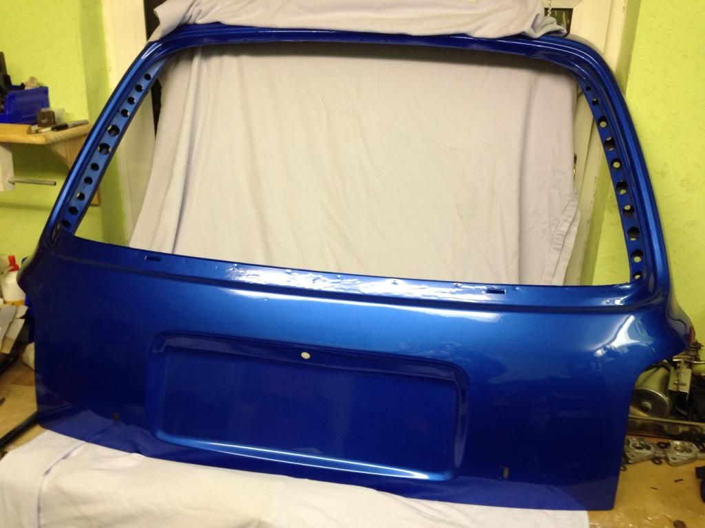

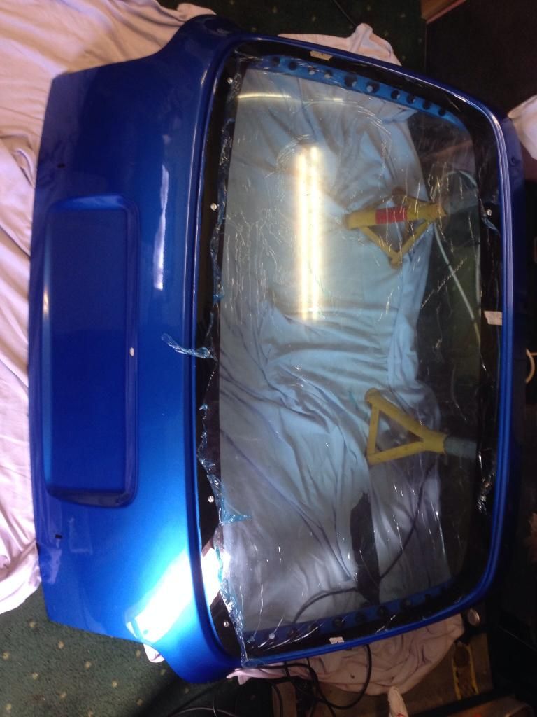

Polycarbonate Paul?
Polycarbonate Paul?
Good manYep that's the one mate, going to paint up rear 1/4 windows as you suggested![]()
Good man

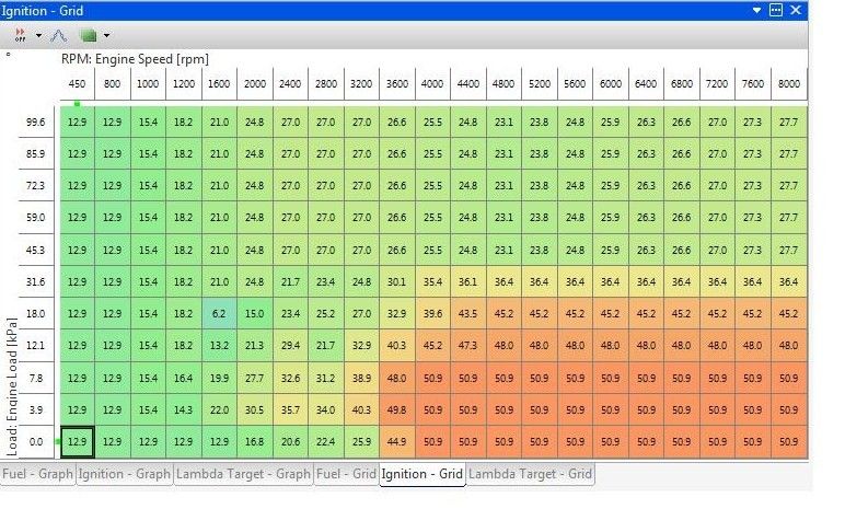

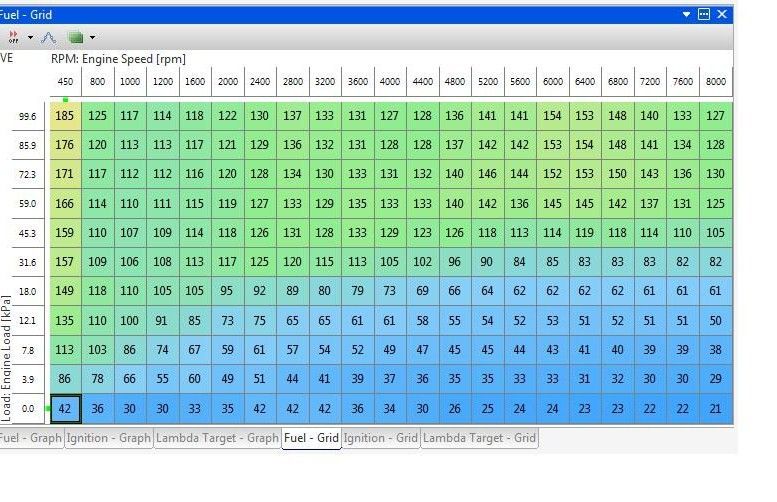

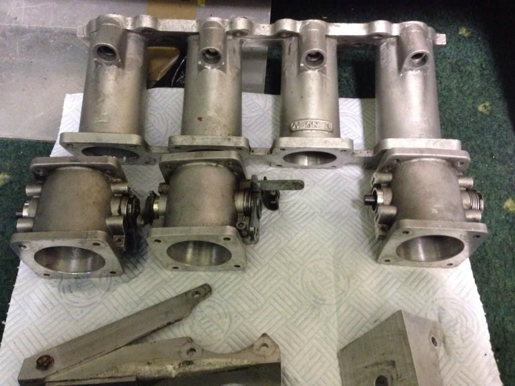

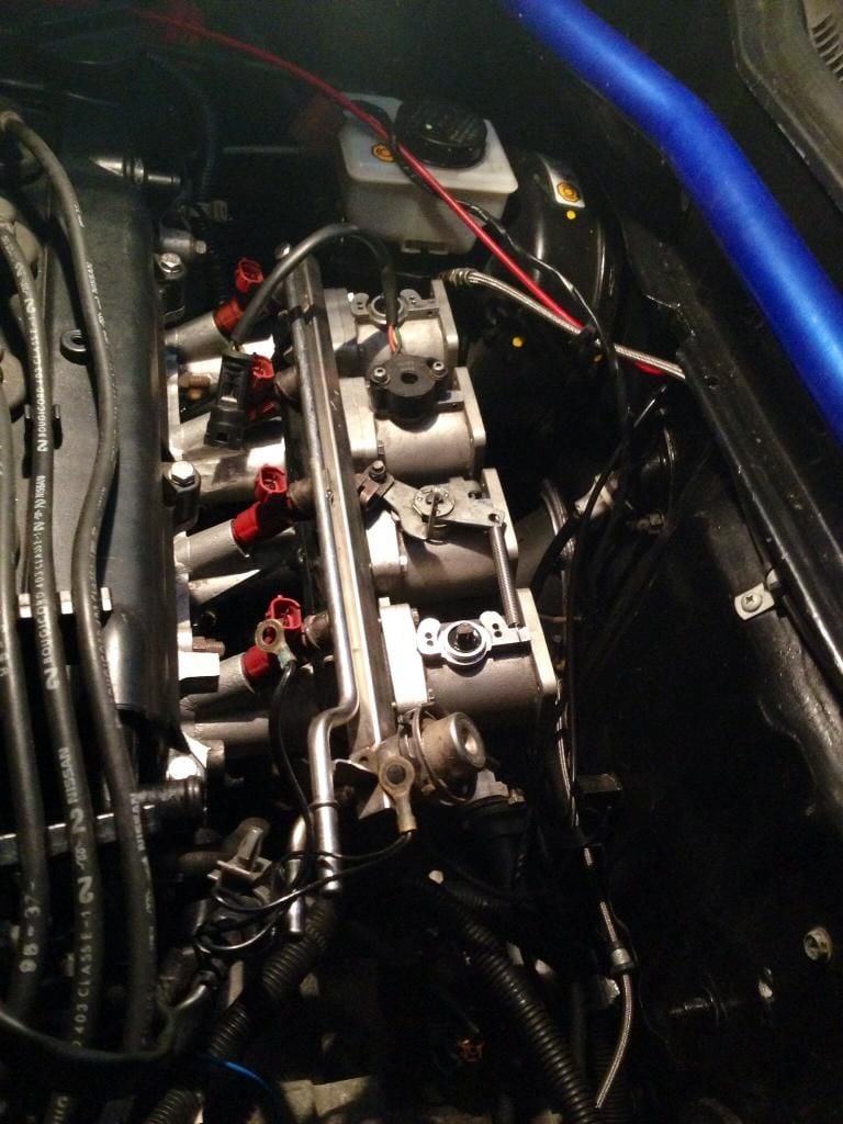

have you compared the maps to paul,s (pollyp) n/a ones paul ?
With a set of ITB's you will probably never get bellow 20kpa or possibly 30kpa (depending on size) mine idles at 54kpa
I'd start your table at 20kpa, this would then give you a more usable table.
Might need to invest Frank.generic ebay map sensor paul ?
they must have run alpha n eh paulpretty basic system
Been as the car is for sprints etc alpha N would be OK, you just loose some of the drivability.
Depending on duration then alpha N might be more suitable
I ran Alpha-N paul and it worked very well.
Vacuum wise, we'd see readings in the low 20kpa range at idle on a CG13 with 773 cams. I'd expect you'll see a little more on the CGA3 though.
