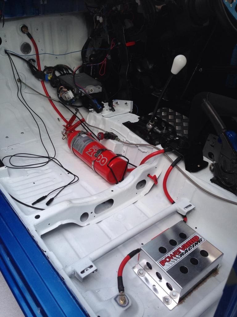

Cool - many thanks and is that with a Bogg Bros inlet manifold? Or can you make your own from a cut-up standard inlet manifold?
It is a BoggBros one mate, they do a very neat job and I asked them to offset them to the right so I could keep the brake servo. Also asked for a vac take off on cylinder 1 as well
It's already running the bike carbs and standard spark at the minute bud.
Next is stand alone management with bike throttle bodies a similar setup to Mike Jones etc

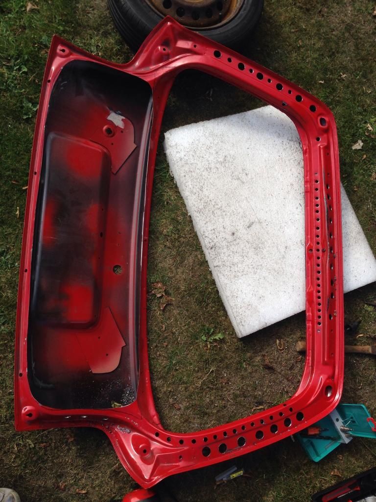

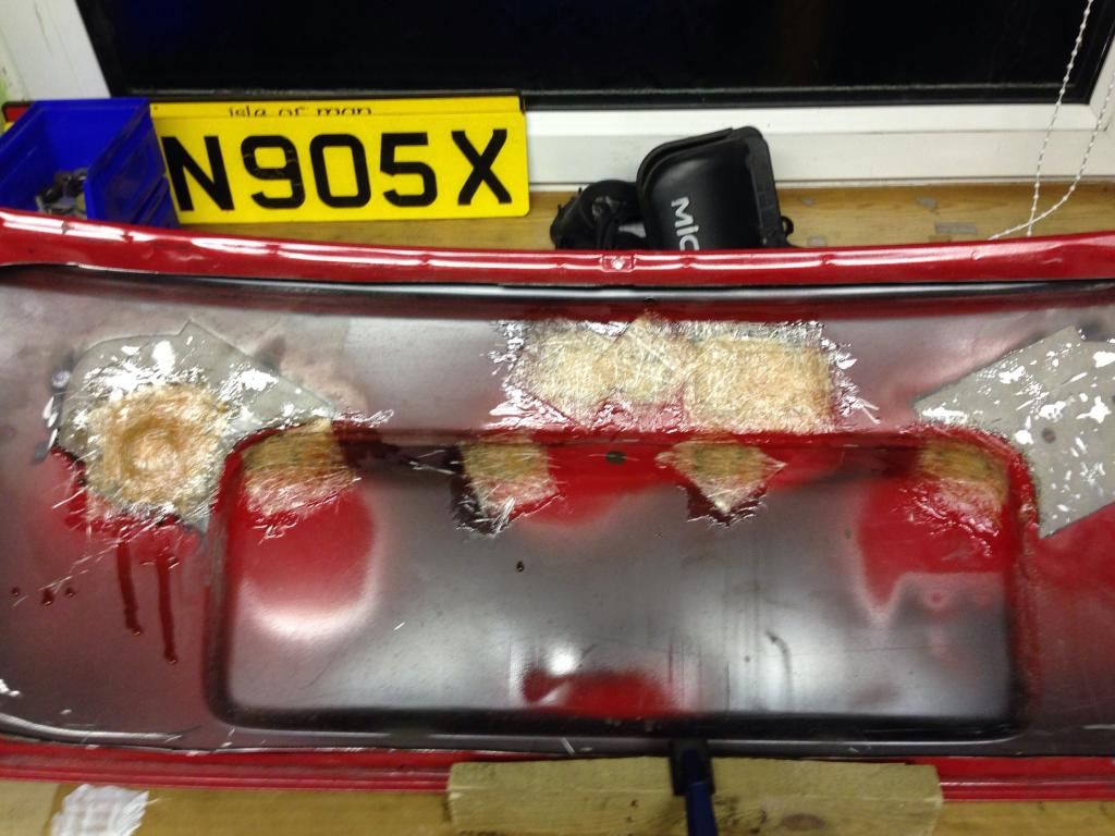

Had my first attempt at some fibre glassing. Quite please with the results not pritty but so long as it's water tight and a bit of filler on the back should see it right
What you doing for plate lights. Literally going for bare skin approach for new build. You got poly windows ? Including boot?
Iv left the little hole in the middle to put a bulb in for the plate light bud, just paint half the bulb black so it shines down :)
Iv Poly driver and passenger windows but yes the rear screen and 1/4 windows will go Polly as well over the next month or so.
I'm hoping to prep the tailgate for paint to save a few quid at the sprayers
Bang on. I figured all of would need was one bulb to make people happy. I have been thinking of how hard it would be to make a rear fb tailgate... I would literally just put a square In the back of poly to see what's about to crush me.

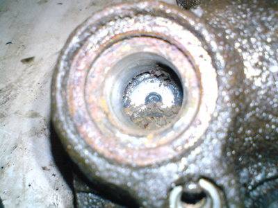

After a run around the TT course yesterday to blow the cobwebs off I noticed the rear discs had not been touched. Still a light rust on them, so the calipers don't seem to be up to much back there! sticking piston mech no doubt. A little job for one evening this week

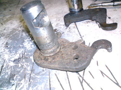

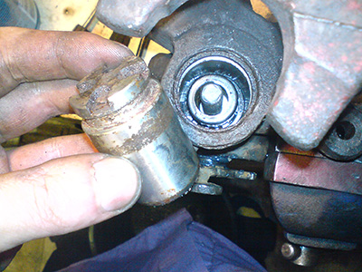

paul, perhaps give both of em a full on overhaul.
these rear calipers are notorious for seizing from rust.
common issues I found with em over the years that causes a chain reaction:
  • the exposed shaft of the rotating handbrake lever arm on the caliper tends to rust and create a rough edge.
  • this wears out the delicate rubber shaft seal lip thats suppose to keep elements out the greased mechanism.
  • years of rain n dirt gets in through the damaged seal while grease gets squeezed out
  • contaminated grease gunks up
  • exposed internal steel with moisture rusts n mixes with the remaining grease till it all dries up leading to sticky handbrake mechanism and then becomes fully seized

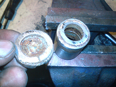

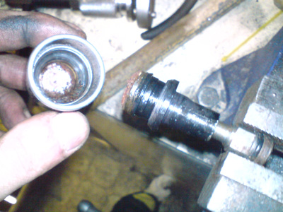

  • water gets between the exposed piston head and where the rubber dust boot meets the groove on the piston head
  • the piston begins to rust with the moisture and the tiny amount of brake fluid fed from a tiny feed hole in the groove is no longer able to provide enough lubrication & protection
  • the piston and dust boot begin to stick together from the rust, making it hard to twist/retract the piston when replacing pads
  • the rust gets in and blocks off the tiny feed hole in the piston/dust boot groove
  • rust spreads into the space between the bore inside the piston and the rotating female threaded block inside it (when u release the handbrake and apply hydraulic brakes the piston normally makes the female thread spin/unscrew closer to the disc like the drum brakes self adjuster. when you apply handbrake, the male handbrake thread jams the female block against the piston and the two flat faces lock together to prevent the female block from turning loose)
  • the rust locks the female threaded block to the piston so it can no longer self adjust the handbrake and when u press the footbrake to move the piston ur also fighting against the return spring for the handbrakes male threaded shaft before the rear pads touch the disc. And by the time the rear pads touch & begins braking, the front pads have already applied enough braking force. therefore the rear brakes seem abit under-used than usual.

  • and obviously the piston seal tends to corrode onto the chrome plated piston wall
