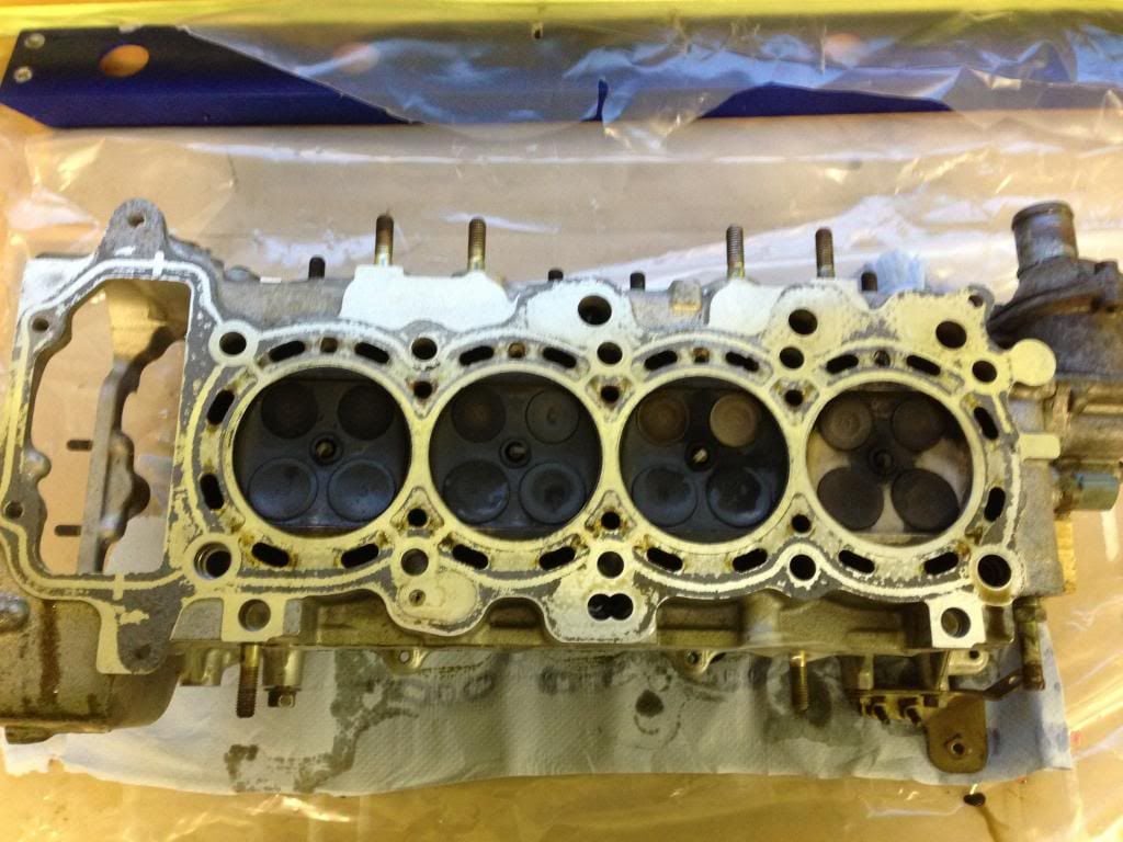

Cylinderhead removed, still looking clean after a few thousand miles, head gasket was like new! Now to clean it up ready to start building the CGA up
Also measured the head thickness and found its the full 121mm so there's room to raise the compression further (once my brain starts working and I can calculate it!)

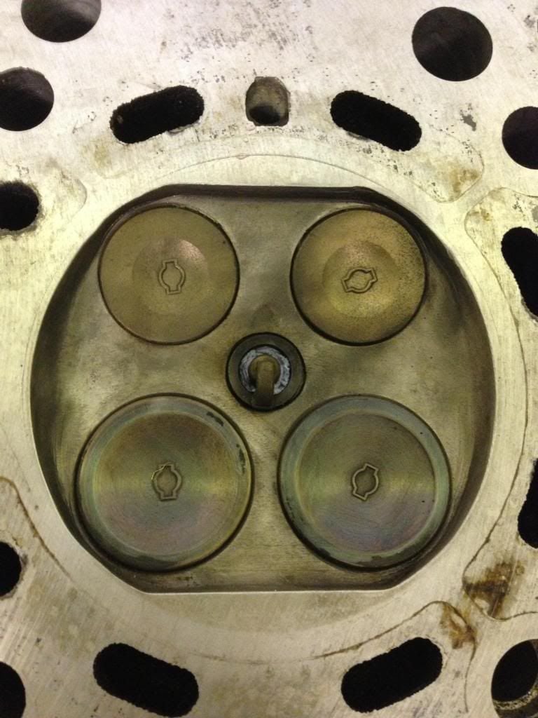

After a few hours chambers are finally clean. It will have a good going over with a straight edge but I might get a few tho taken of just to make sure it's dead level

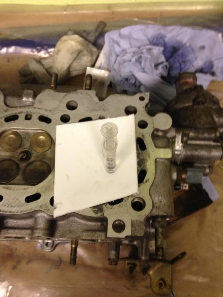

Had a go at measuring the chamber volume tonight, bunged the spark plug up, a smear of grease around the outer edge and a dead flat plastic square with a hole to accept the syringe. 3 measurements brings me to an average of 21.3cc :) now to work out the bore volume!
clear perspex will show if you have any bubbles eh paul, there are some pics of mine on my cisco blog (bandwidth problem there atm)
i think i got the stock chamber to 24cc ? and 5cc head gasket ?
Il have a dig around the shed Frank in sure there's an off cut from my binnacle, that makes sense added as much as I could before fitting the plastic on but a larger syringe would make it more accurate I'm sure :) rather than refilling this over and over

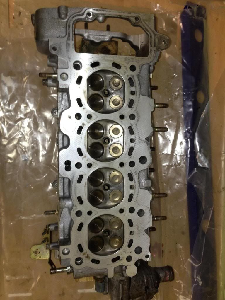

Looking at the chambers it looks though metals been taken from around the exhaust ports as my valves sit proud where as yours are sitting below. Must have been part of the head work it had
yours looks like its been matched to the fire-rings and polished to me paul, so that will have dropped it half a point or more, i would go for 1.5mm personally :)

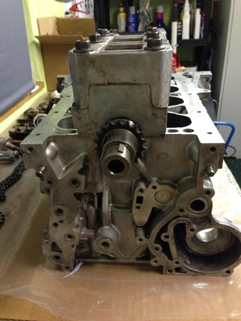

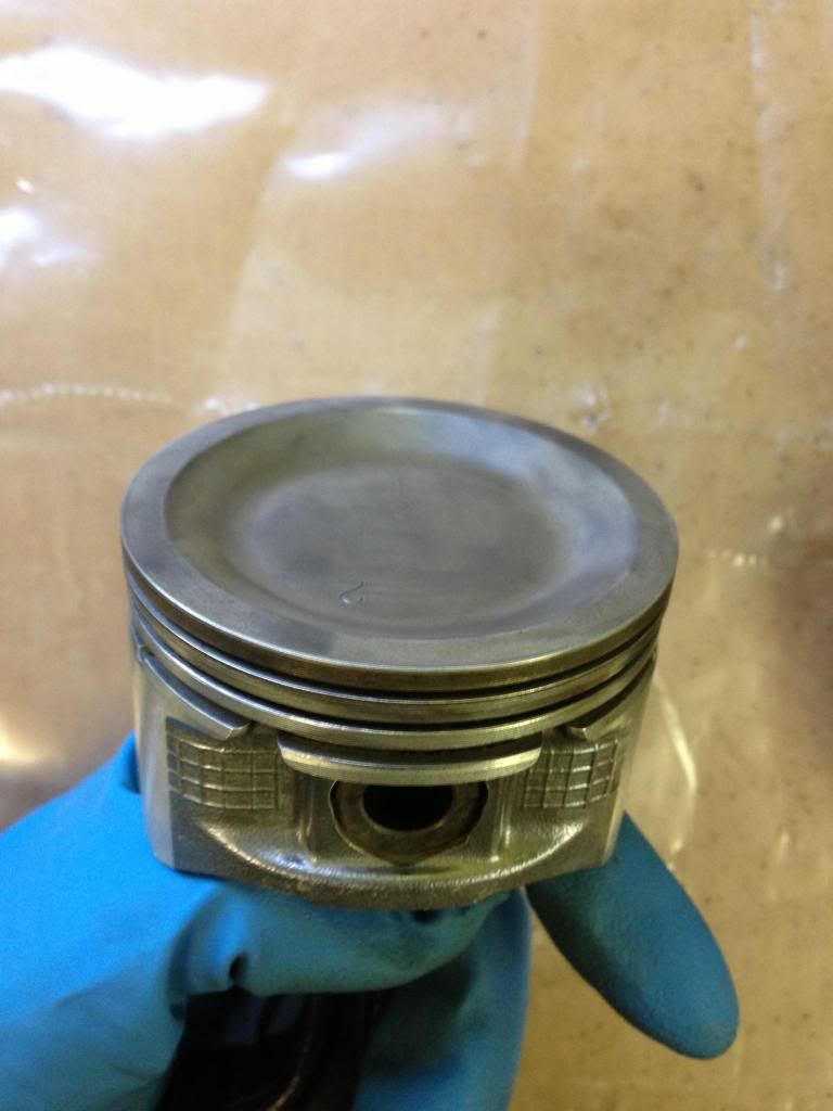

After many hows with a dremel & a lot of degrease the pistons are ready to go into the new block.

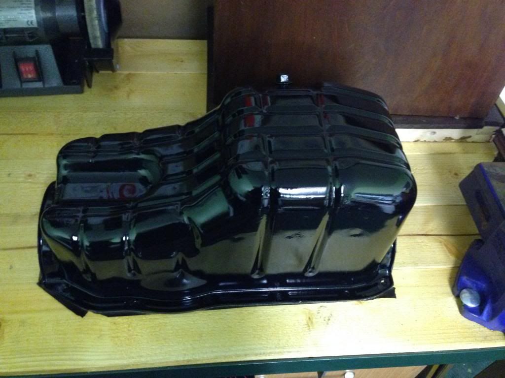

Sump has been tidied up & made ready for a coat of tough black.
Playing about with rough calcs until the short block is made up, a 40thou overall drop gives me a 10.7:1 Comp

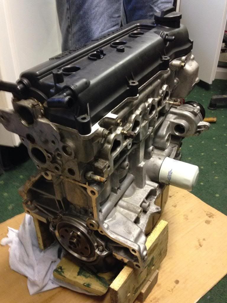

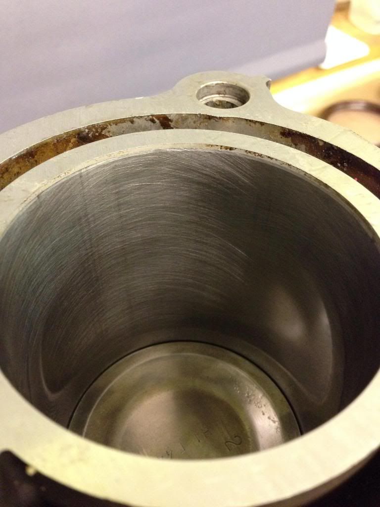

A little bit of progress to report :) pistons and rings all in, shells and bearings torqued and angles up.

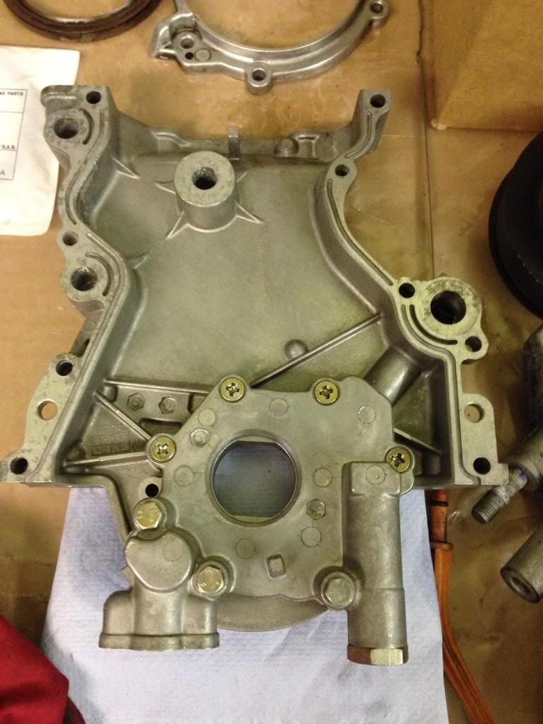

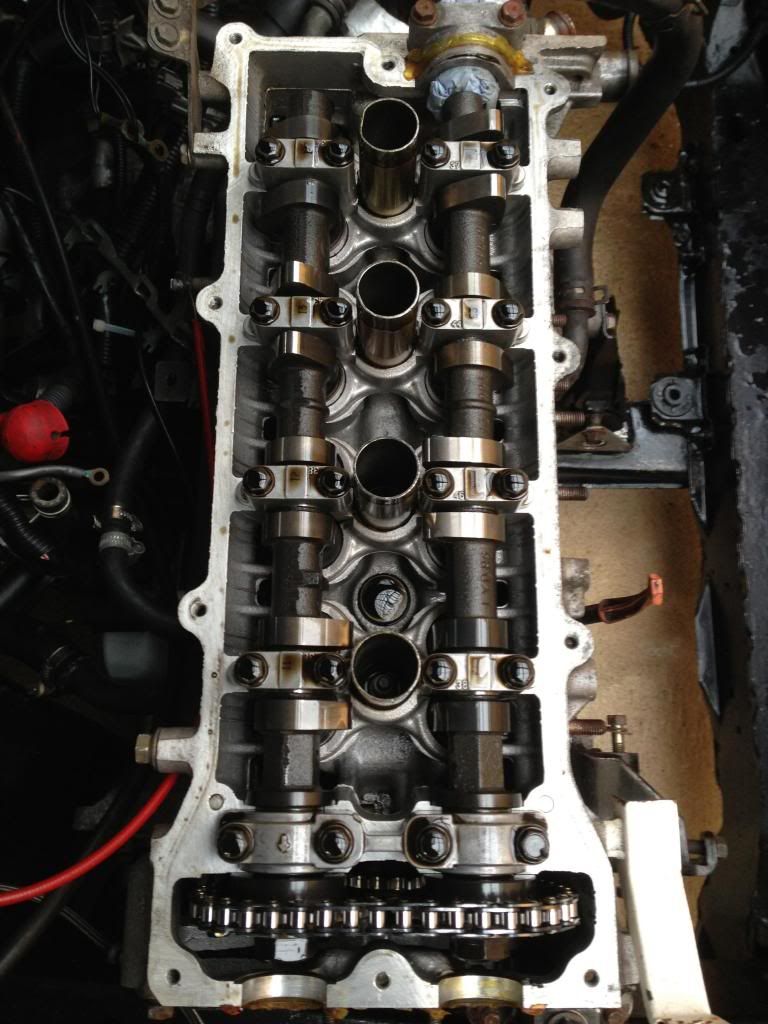

Oil pump stripped clean and re assembled ready to go. Hopefully all together with the head on ready for timing over the next week.
All engine ancillaries fitted.

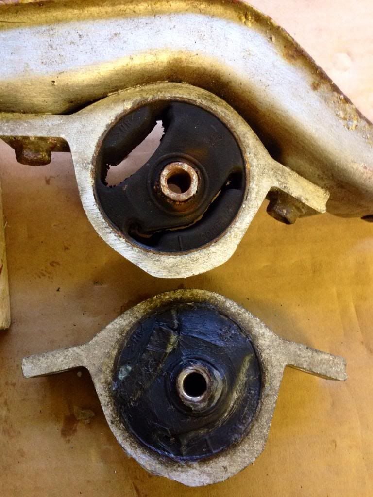

Rear gearbox mount packed with solid exhaust rubbers and urethane sealer.
