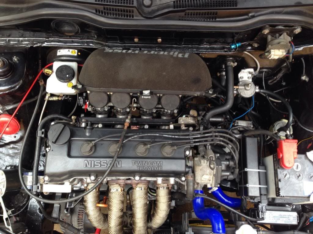

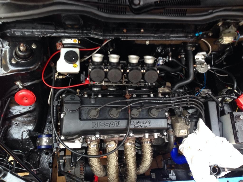

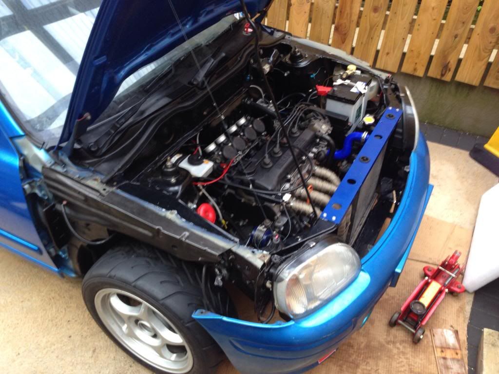

4 days to go until the hill climb :)
5.1 gearbox has been fitted with a new release bearing on the clutch.(old one sounding like a bad taller skate!)
Suspension has settled nicely and I'm happy with the damping. Will soften the rear ARB to try and negate the slight under steer on cold tyres.
Done filter fitted as well, a sniff fit. Not revved above 5.5k yet but it's pulling great, maybe it's me but the extra cc seems torquey compared to the last
O any the shift lights fitted as well ready to go

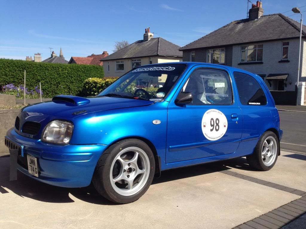

Thursday went very well with what I think was a class win :) will be sure tomorrow when the final results are in.
Here a vid of the fastest run, bit of a missed down shift & some more bravery needed but good fun! New engines going strong
