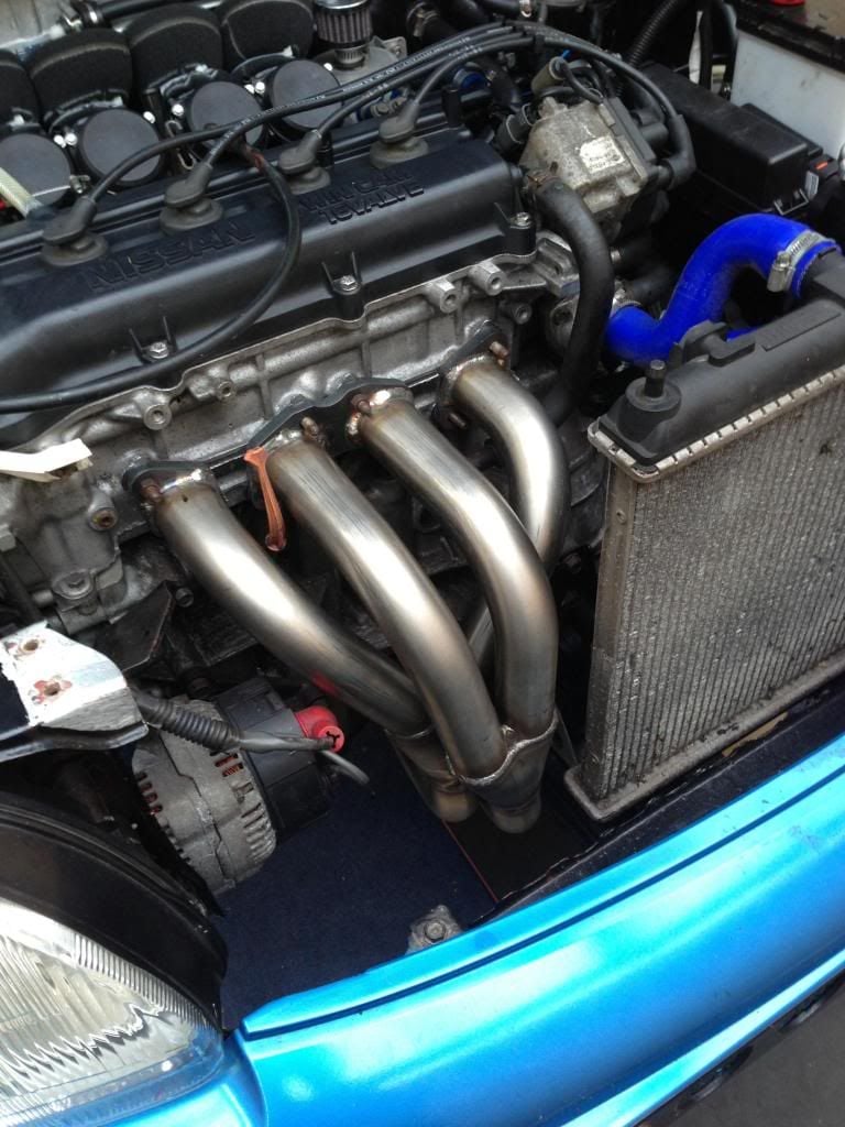

Alls running well except the Clearance in the exhaust tunnel at one point is a little tight and may knock on bumps so a little tweak of the exhaust hanger and we should be all good!
Stainless Decat to come in the week
Rev,s pick up a lot lot quicker than they used to, might have been a little strangled with the fast road mani with carbs on it & the cams :) breathing well now
Carnt wait to get it on the road for a run
if you get the rubber exh hangers a bit stiffer,stops a lot of movement.
i pushed bits of rubber in the holes of the mid rubber cat hangers,,,no more knocks :)

Ta Paul , yeh my rear exhaust rubbers have jubilee clips round them to keep them solid, the centre hanger is pulling the new exhaust up till its within a few mill of the tunnel I'm just going to extend it down :) nowt worse than rattles and knocks eh

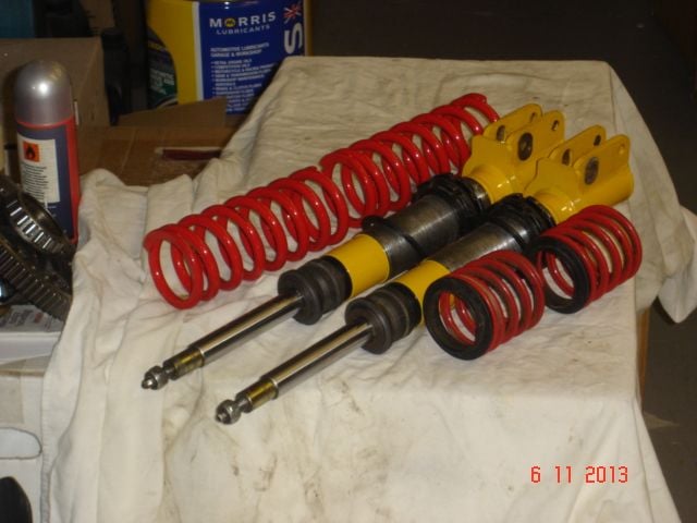

Not had any chance to work on the car while I've been getting myself back on my feet but did get plenty of time online..... so internet shopping got the best of me & id been looking at upgrading the front suspension.
Full plan over the winter is to take my spare lower arms, weld them up, pollybush them & fit new ball joints.
If all goes to plan Spax coilovers will replace the current dampers / springs (up for sale over the coming weeks) & will be paired with rose top mounts. Mounts are away at the minute so a suitable sleeve can be found to fit the coilovers. This should lower the front down nicely but might require a bit of an arch roll :)
