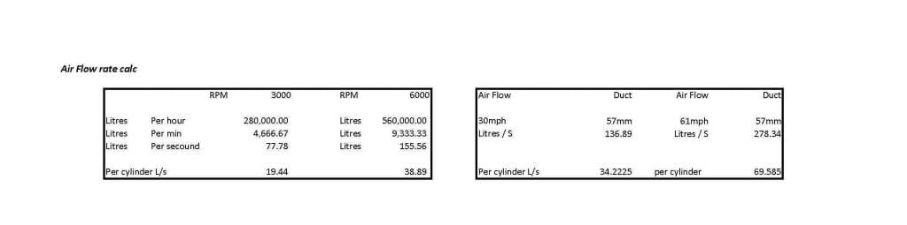

the notion of air rams took my fancy the other day so ive had a look into it, done some sums (internet references might mean im waaayyyyy off the mark here but it was interesting all the same)
Ive taken a standard 4 cylinder engine air consumption & gone against 3k RPM & 6K RPM for my setup breaking down to air consumed per cylinder in litres per second.
Thats 1.3 gearbox, 5.1Final Drive, 195/50/15 Tyres
From this using 3rd gear at 30 & 61 MPH a duct of 57mm diameter (which is the size of the plastic lips around the carbs each cylinder would get roughly double the airflow.
I've yet to work out the pressure difference this would make over the atmospheric the engine would use but it looks worth wile giving it a try :)
Quick question peeps, would the best way to measure if any ram affect was taking place be to measure the intake mani pressure?
If the pressure rises with a duct on the there is some sort of affect i guess?

Awesome ta Frank, i imagine il only have very minamal amounts to register but its worth a go for the price of a bit of hose.
Do you think a hose with a lessening diameter say 80/70/60 would help the air gain speed or is that not going to work over only 15 inches of pipe?
a MAP sensor will meter pressure, a MAF wont tho surely ?
I guess either would do Frank, im just curious to see if the pressure or flow will see a worth while increase ducted right to the trumpet & by how much :)
Though the Draper gauge would be handy for balancing the carbs too!
i think you would need an intake the size of a windscreen, and a very slow taper to gain 3 or 4 psi @ 100mph personally paul.
a bellmouth and bit of ducting would hardly register on a gauge like mine ^ :)
a ram air setup probably helps intake flow when you hit the throttle and have vacuum conditions in the intake, but once the airflow is up to speed you need proper boost to have any real gains
Riteo Frank windscreen intake it is :)

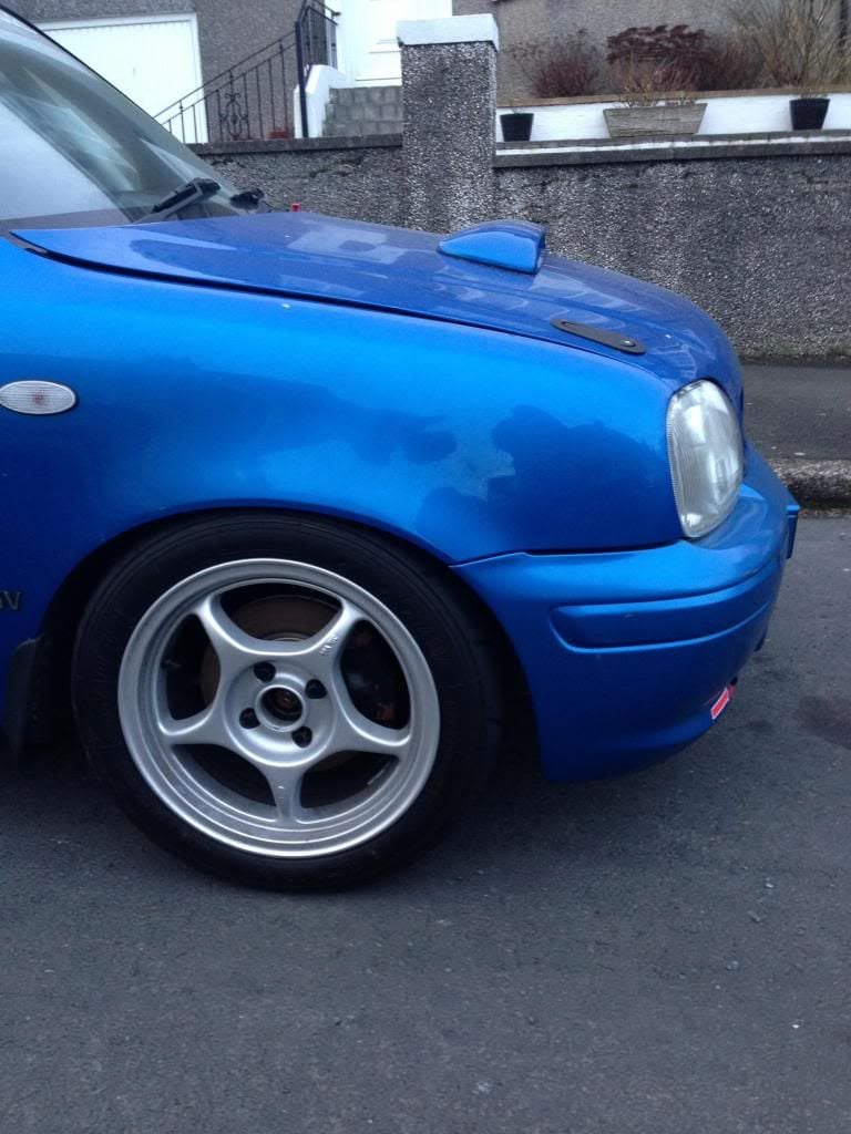

Front coilovers fitted at last :) bush that was under the top mount was swopped to being over it.
Only problem is the top adjust is touching the bonnet very slightly so the bush will be cut in half and located either side of the top mount for clearance :)
Felt a little strange to drive as the only give seemed to be in the tyres!
Them springs a tad stiff mate?
These are the 285lb fitted at the minute mate, but yeh when I drove up the edge of the Kirb (only an inch high) it felt like it bounced up and wobbled on the tyres to be honest.
Tyres are set at 30psi on the front but il need to move the bushes about before a proper drive so the bonnet doesn't get damaged
Looks a tad low for proper driving too ;) do you get tyre rub now?
Could be mate, it's basically going to be a circuit setup for what it will get used for :) there's about 10mm of clearance on full lock but it will go higher once I've played about with the mounts a bit! Nothing on this is for form just function :p
