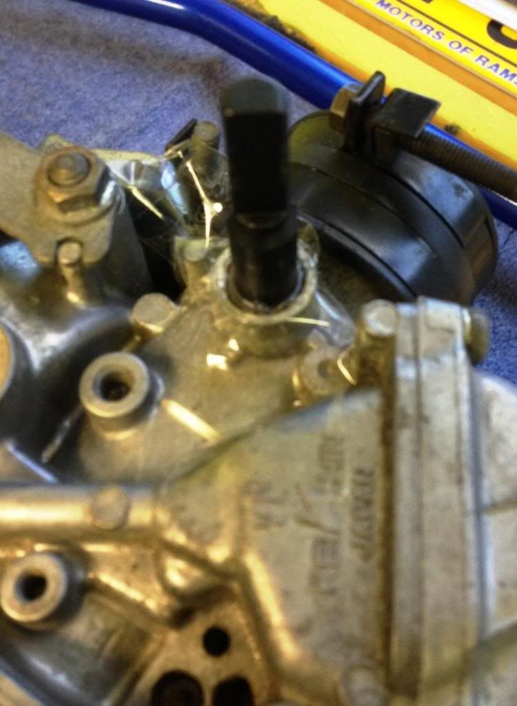

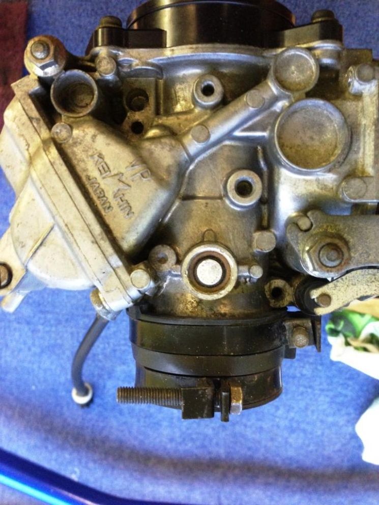

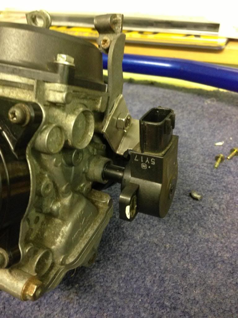

Well the TPS is ready to be mounted up, brackets made just waiting on some metal adhesive to join the peg I'm using to turn the TPS to the carbs.
Once it's in and working il get the datascan plugged in to see what's what. Hopefully emulating Franks readings under load ie less advance under loaded WOT :)

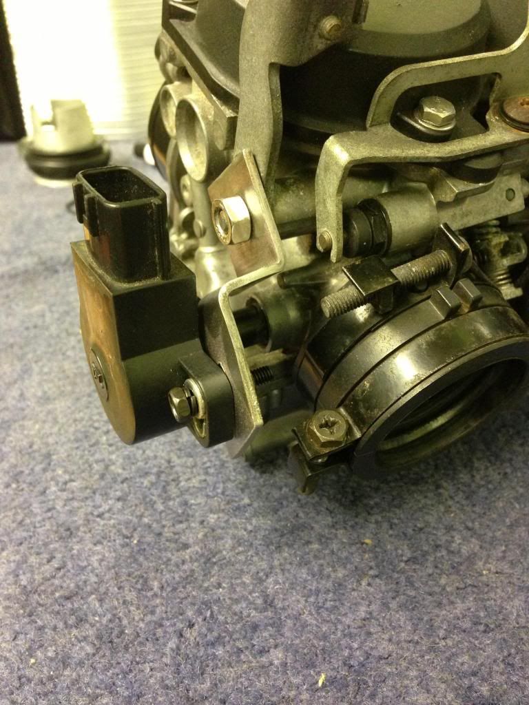

Little bit of progress made, TPS sensor cam (or whatever you want to call it) is attached & turns spot on with the butterfly spindle :)
Next up to mount the sensor (ditched the first bracket too flimsy) will need to be adjustable to its reads WOT at the right point. Might compromise the idle as it will read that the throttles a little more open than it is (shouldnt have thought this would cause any problems)
P.S its not stuck on with sticky tape that just to keep the excess epoxy out ;)

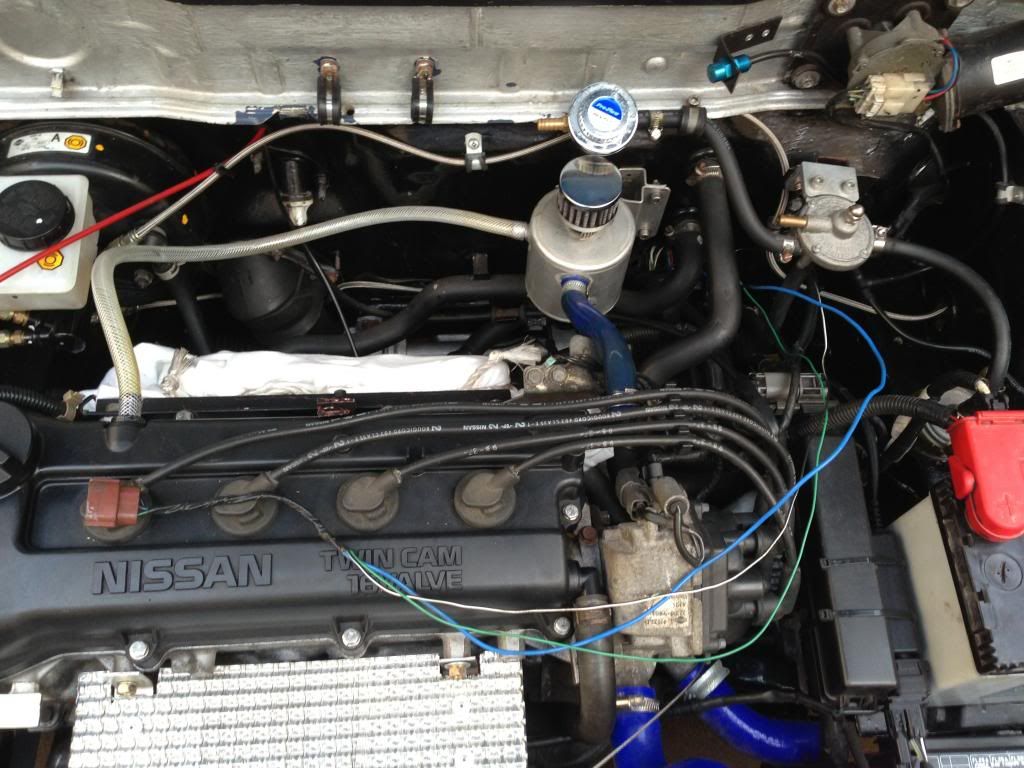

Unpicked the wiring tonight (again grrr) routed the TPS loom to where it needs to be :)
Plan for the weekend, get the laptop out and reset the timing to 15deg at 650rpm, then plug the TPS in and give it it's first test run :)
Idles reset to 15deg at 650rpm (drops to 600 with the TPS unplugged)
TPS reading at just over 4 kilo ohms at WOT which I think Haynes is telling is about right

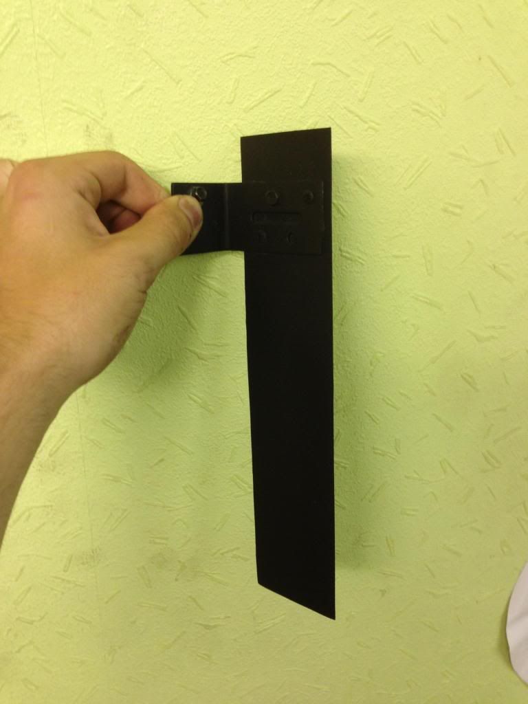

Sorry mate I think that's what I meant... The black rod things, timing struts i thinks the other name is?
I was caught out for mine being too high, so I'll just make a new one, No worries :)
That's them mate timing strut/ beam splitter, that's a pain u got caught up on it
Think the minimum height is 18cm but no higher than 20cm, made mine 19 to be on the safe side.

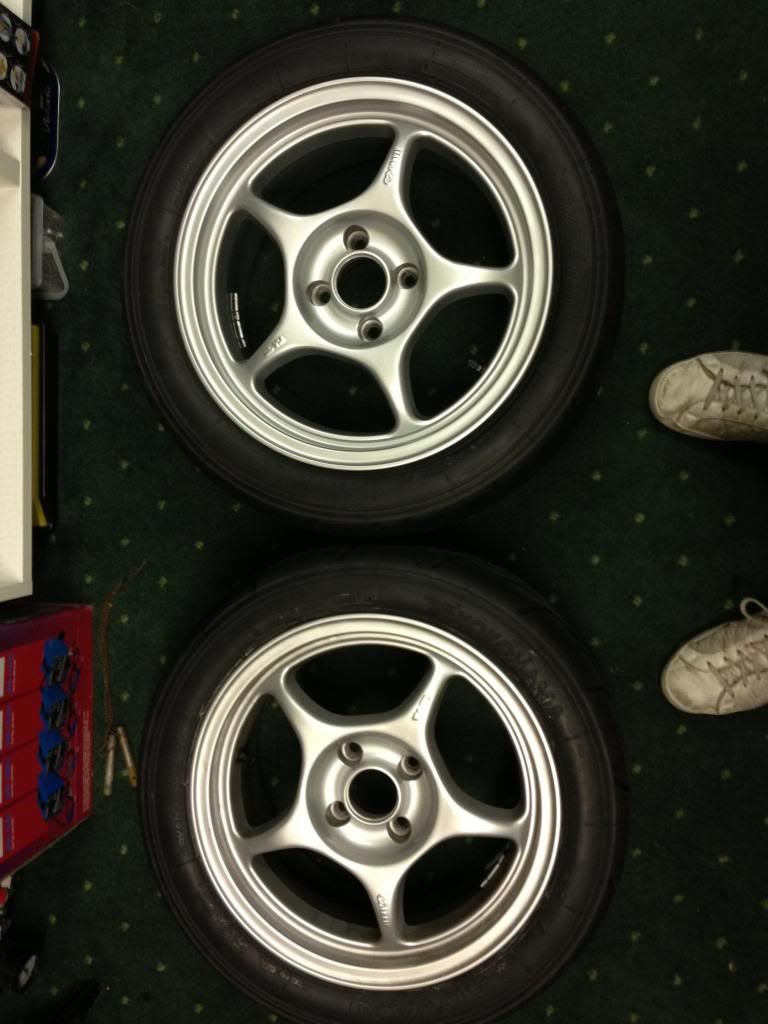

Since I never got around to tidying the wheels up since they went on thought it best to get stuck in with the drag and drift coming up.
Tar and break dust must have been on a good while, white spirit and 4 hours of scrubbing!
Few coats of polish on each will hopefully make washing them in future the future dam easier
