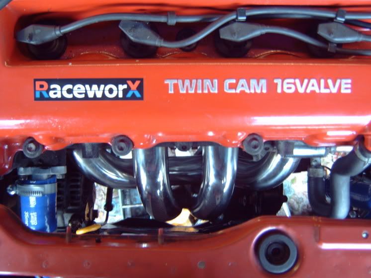

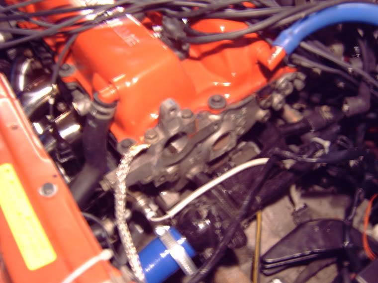

got the maifold fitted and also fixed the induction kitn properly! now all i need is the DTA for the engine to be finished!!

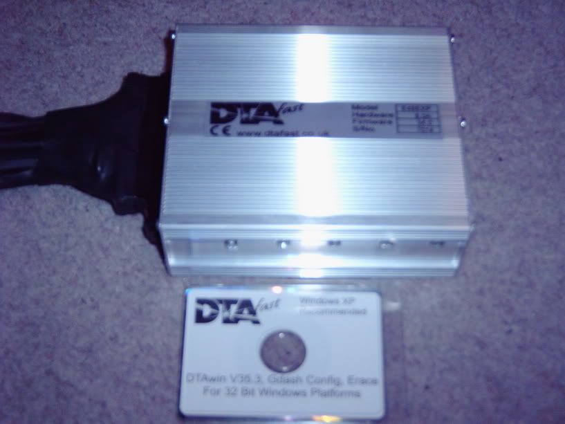

bit off a delay since i last udated but thats because the last few bits are the most expencive... like 1 a month on my wage!! so this is what £900 gets you in terms of engine managment systems a full stand alone DTA ECU on to the pics!! :-

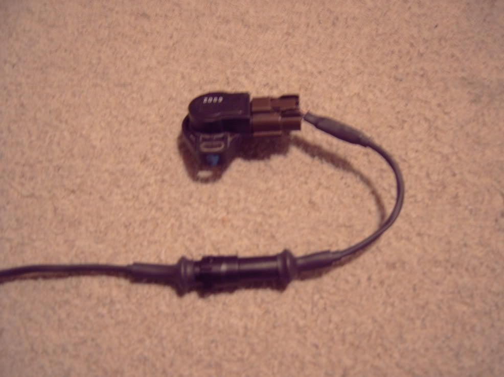

had to re-wire the normal throotle pot :-

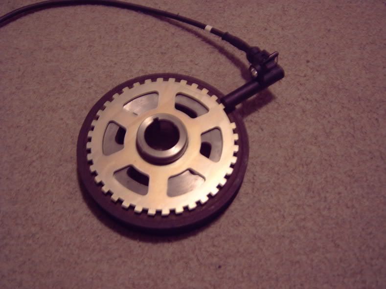

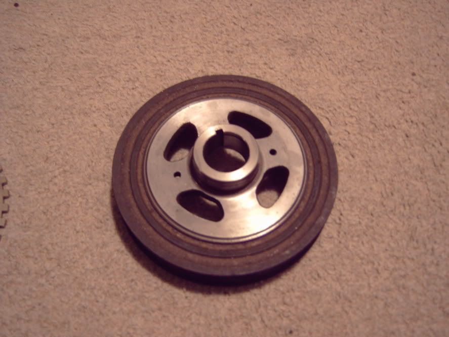

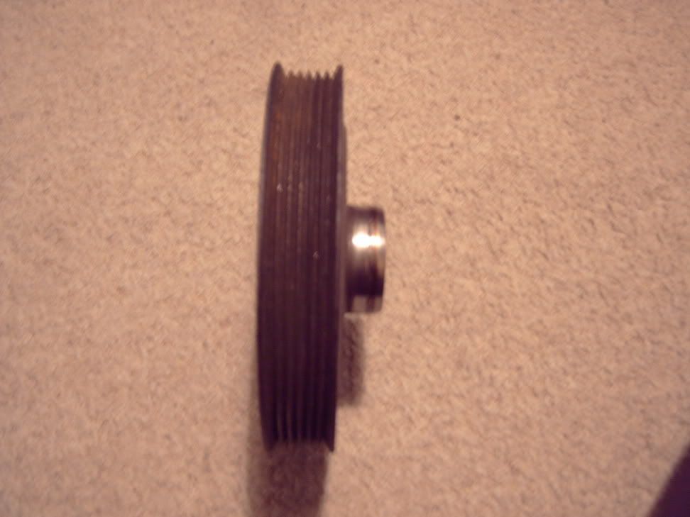

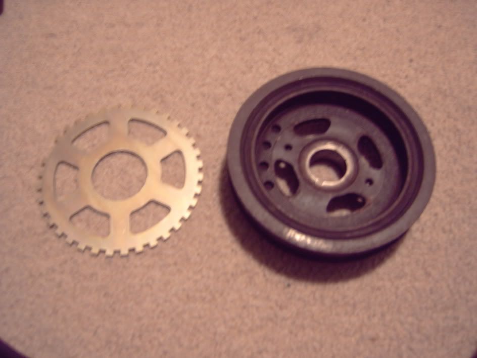

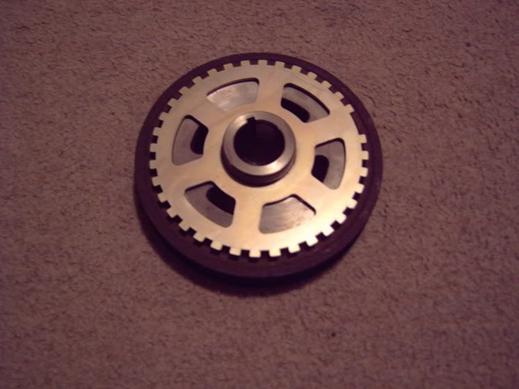

the biggest thing is how do you mount a toothed crank wheel onto the SR20 pully?
you remove the Water pump and power stering bit of it!
allowing the wheel to sit like this (its going to be fixed as son as iv got the positions of the sensor sorted :-

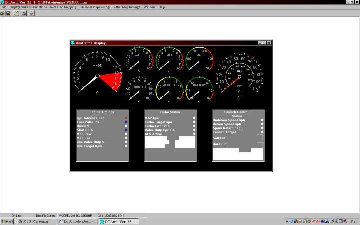

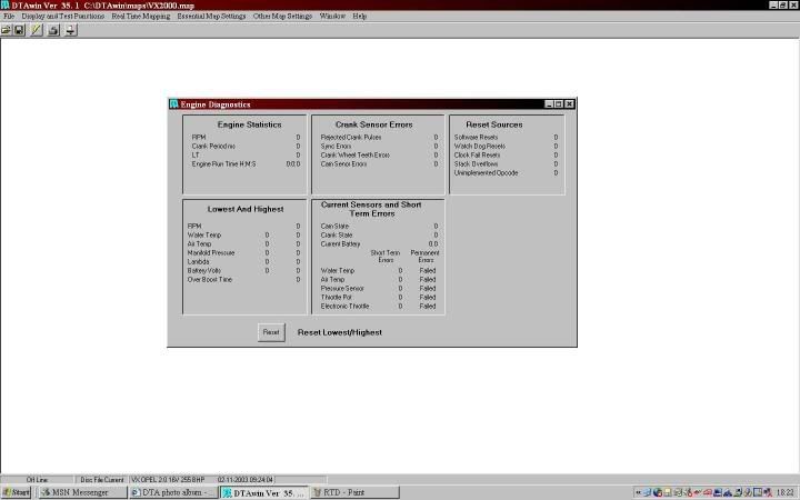

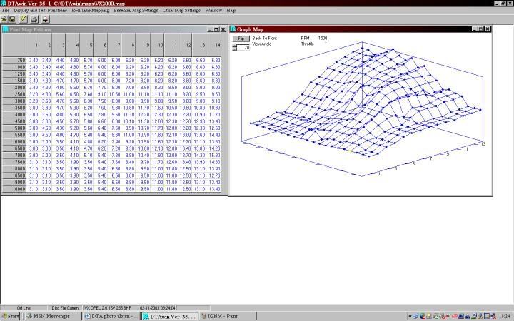

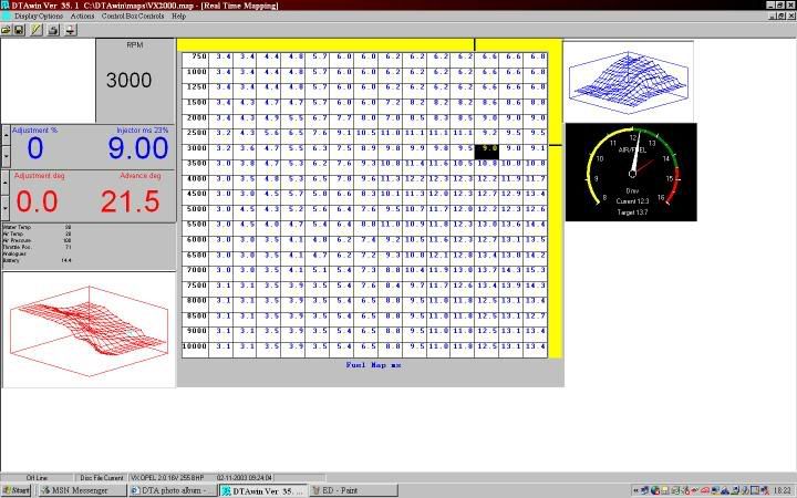

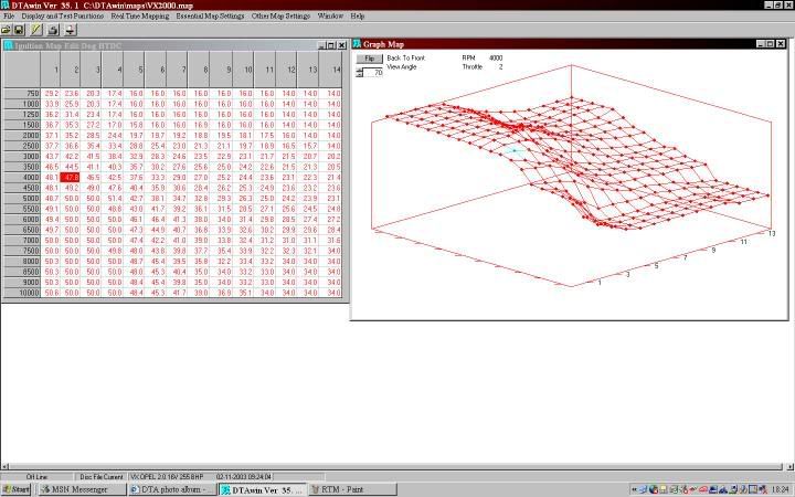

and to finish a few screen shots of the Softwhere :-
Real time info :-
dyno mapping screen:-
System check :-
ignition and fuel maps (these are notmine just demo ones) :-

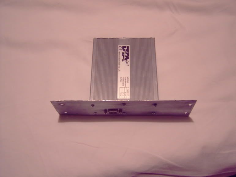

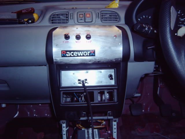

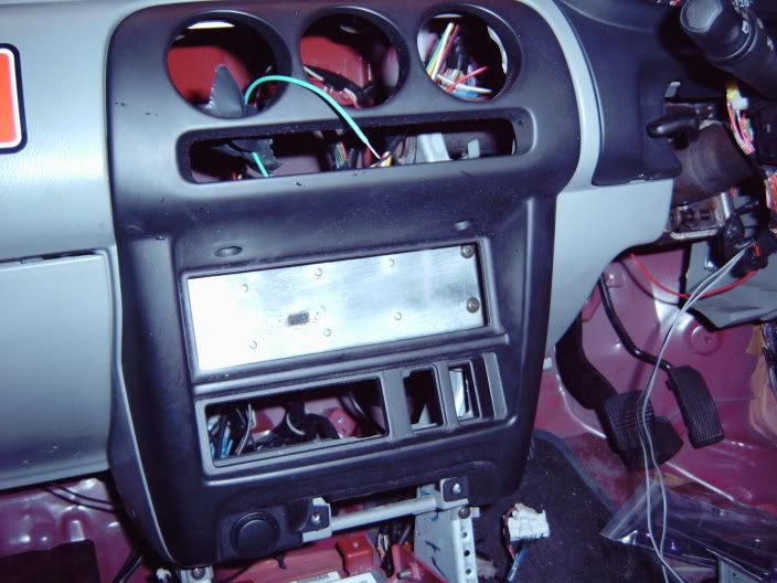

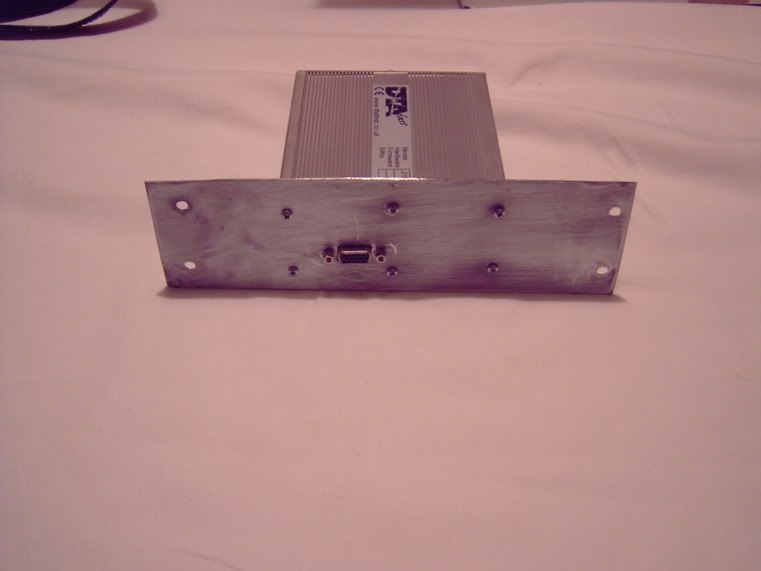

well iv mounted it up now in place of the headunit the steel is abit messed up but it works.. means i can plug the laptop straight in rather than crawling around pluging wires in :)
just need to finish the switch mountt o cover the heater switch holes..

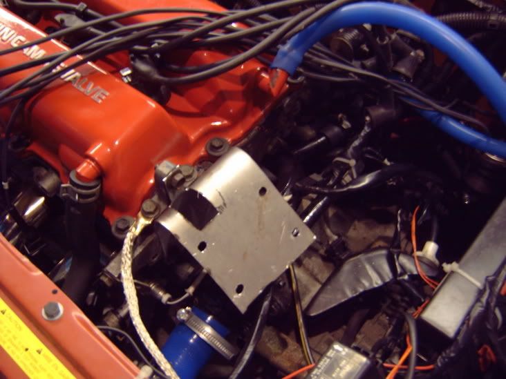

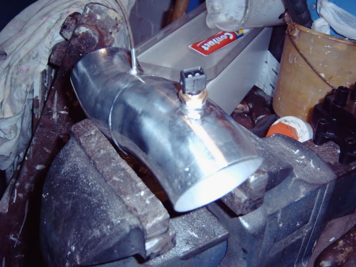

had to make another mount/braket and tap the inlet for the air temp sensor...

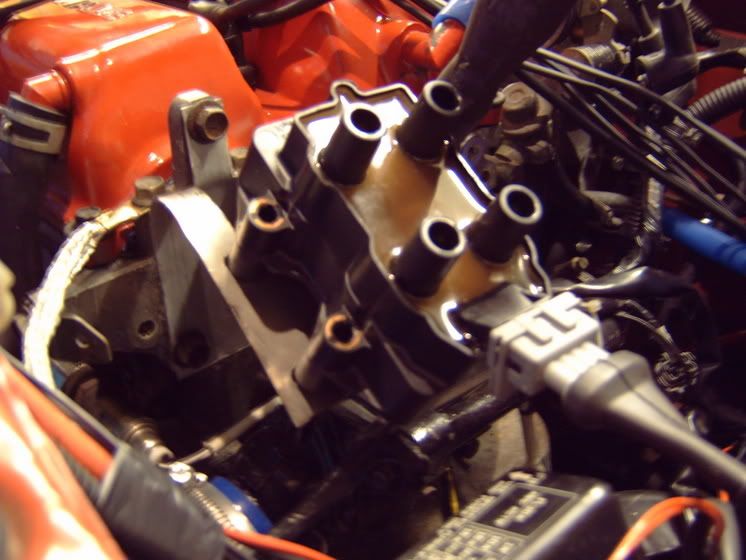

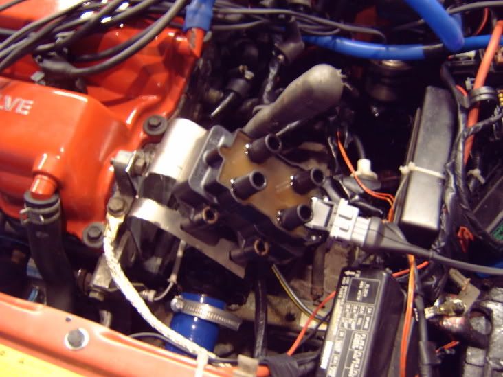

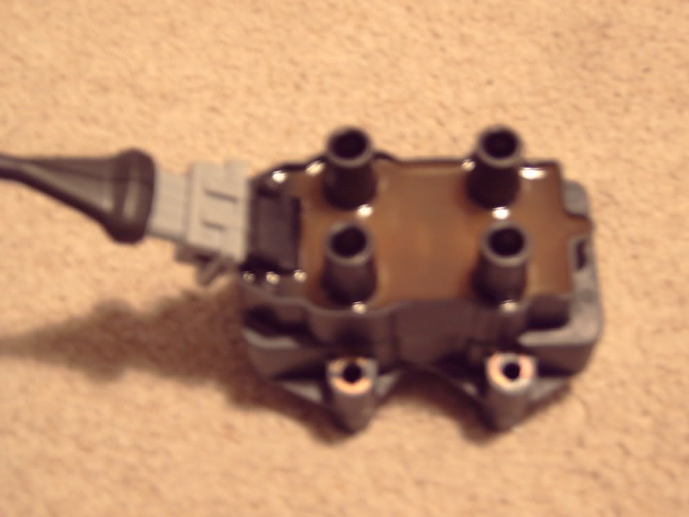

you can see that with the distributer eremoved theres a nice hole for oil to come out of so i needed o block this as we as mount my new spark box, so i thought why make two things when 1 can do both :) :-
just need the cash to buy some bolts to hold the ign box on!! lol

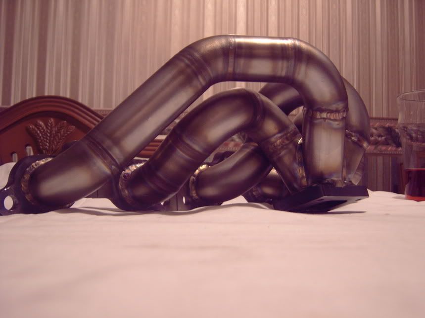

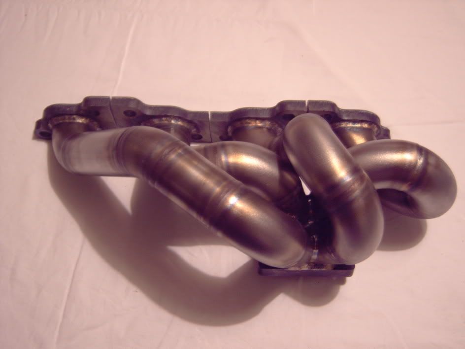

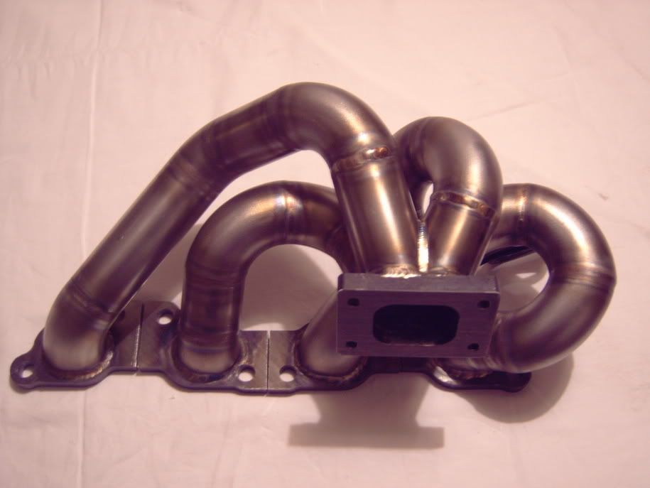

also im fairly happy as a freinds manifold arrived today :- made in the US if anyone nhas any freinds want to buld really mega power cars IE 8sec B16's then send them my e-mail
this is a low end manifold for street use for a pulsar.. not for there drag spec kits. just to clear any confusion

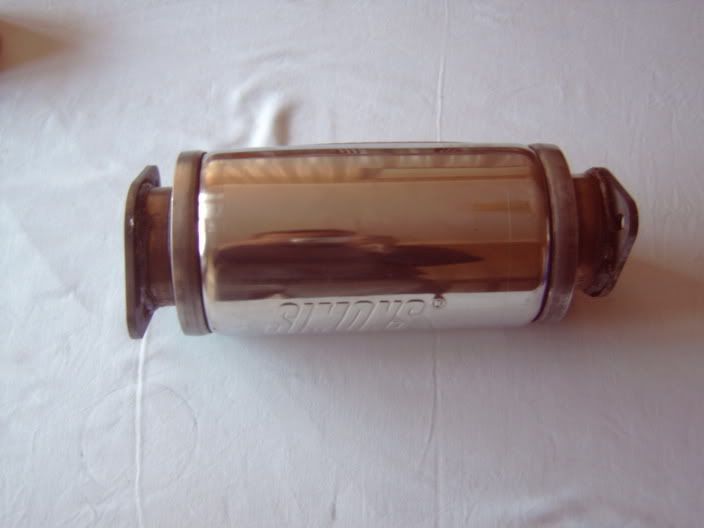

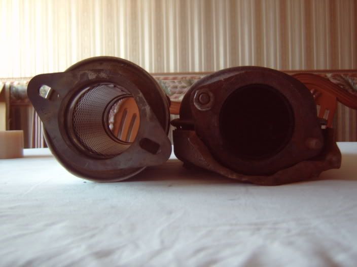

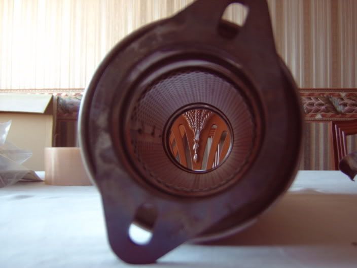

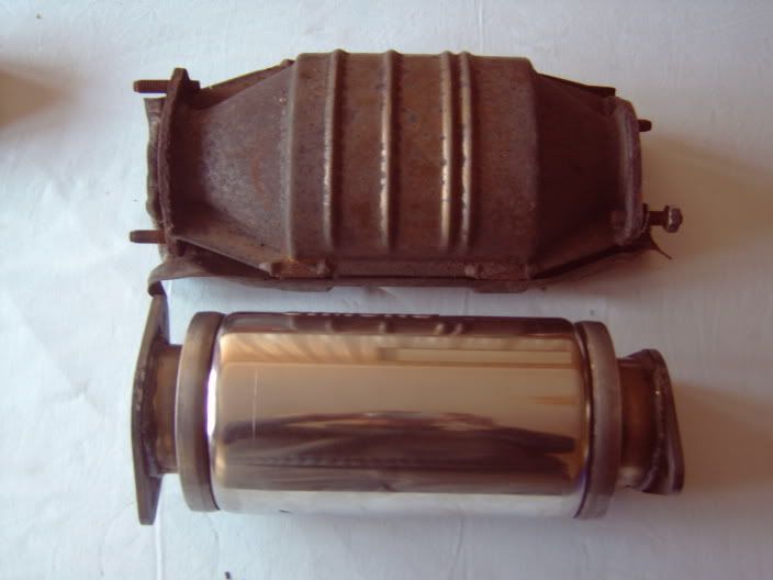

fabed up my boxed de-cat.. if the police do a spot check and look under the car then it looks like theres a cat on it.. its 3" internal diameter so itll flow alright :D also order 3" pipe for a side exit ill fab that up next weekend when im back at college. anyway some pics :-
your going for side exit? how come..any reason or just a personal pref. id have thought you would want to keep it in the std location especially with how low your car is gonna be. surely it will be lower to the road on a side exit.
decat lok very nice indeed :)
its not realy that low.. im not having it as low as possible want ground clreaence and handeling really the centre of gravity is low anyway due to there being nothing of any significant mass above the centreline of the car anyway..

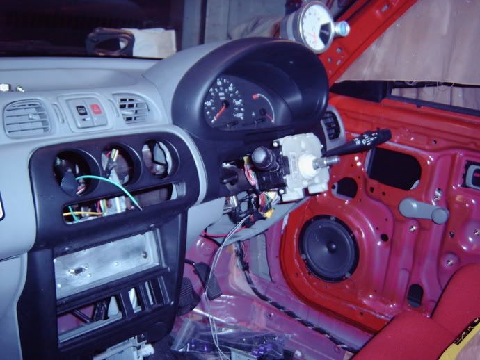

finished the internal wiring this morning :-
