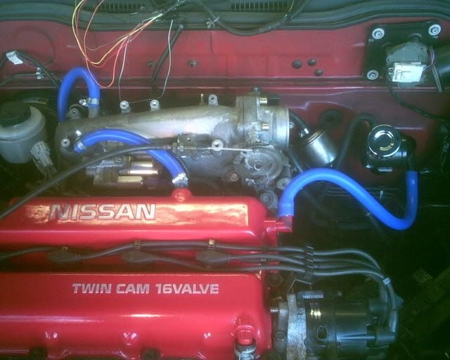

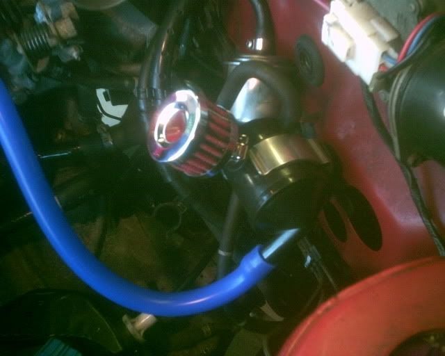

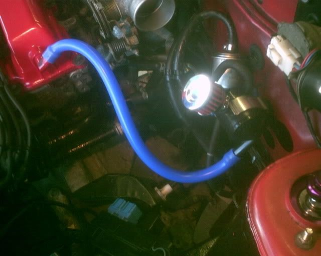

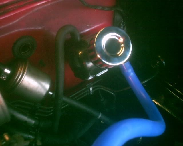

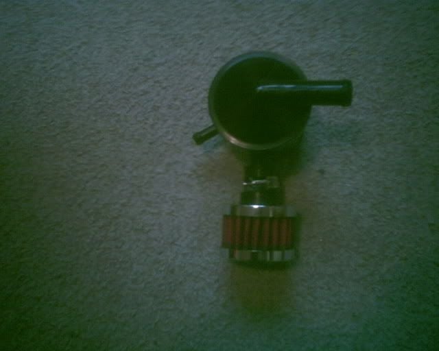

well whilst browsing halfords for my altornator belt which they didnt have!!! i saw a few oddments and cobled them together to form an oil catch can and petrol vapour catch can.....
pritty self expanetry...how it works really :p
Noy bad for about £20

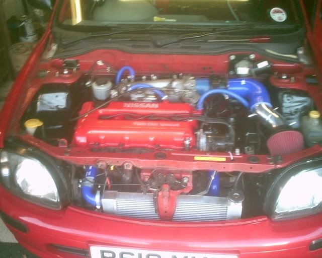

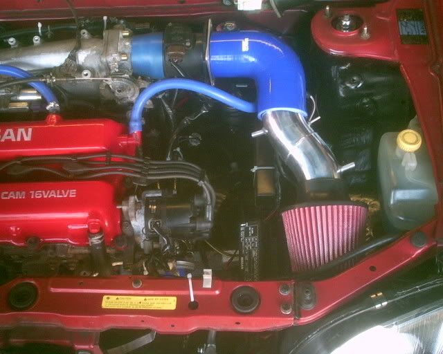

well whilst im waiting to get info on the ECU i started to look at a cold air intake so purchased a setup for a 200SX of e-bay for £30 trouble is the top hat that was sent doesnt fit but were resolving that and i had to buy a nice 90deg bend but other than that looks a good fit :) and is right where the old cold air feed is!

Your Micra is looking fantastic, Its very neat and look almost factory IMO. Love the paint job on the rocker cover im very impressed mate. I have started to break my GTIR as I cant sell it lol, so its going to be a definate SR20 DET in a K11 but my K11 will be an old U0 series round about an N plate as theyre cheap as chips to get hold of.
I really could do with the info on how exactly you managed to fit the DE engine as there really isnt much difference in terms of the engine mountings locations they shoud be the same tapped holes in the blocks. I expect im going to have to cut out the bulkhead to accomodate the huge plenum on the reverse of the DET engine that isnt a problem though I will enjoy fabricating a new bulkhead.

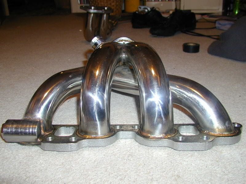

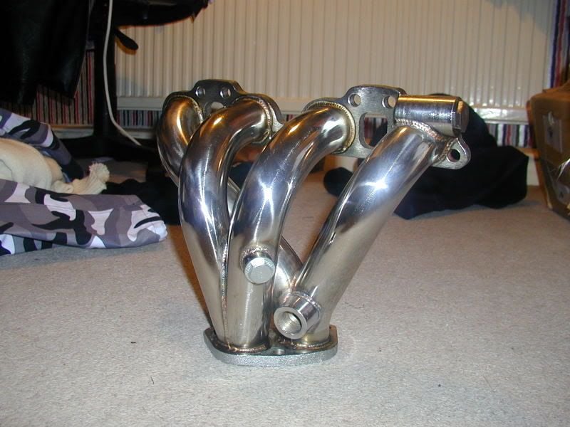

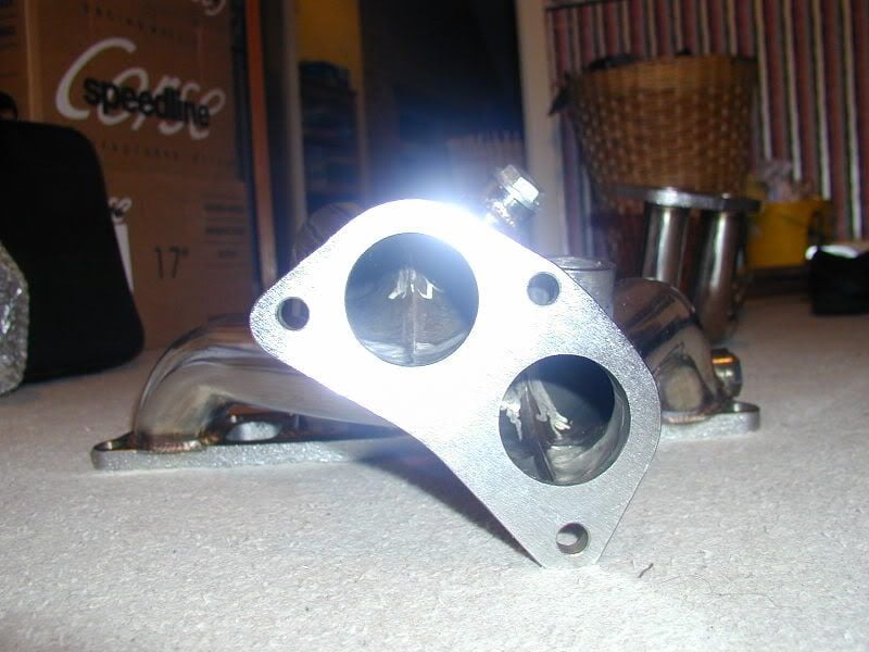

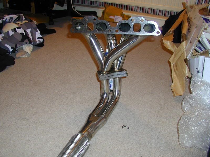

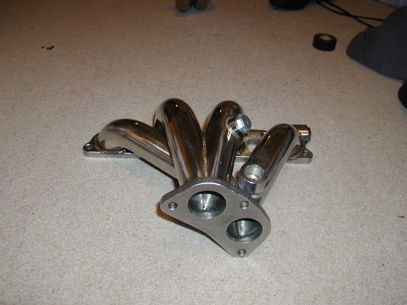

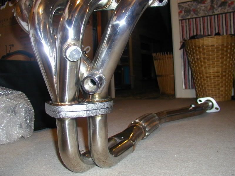

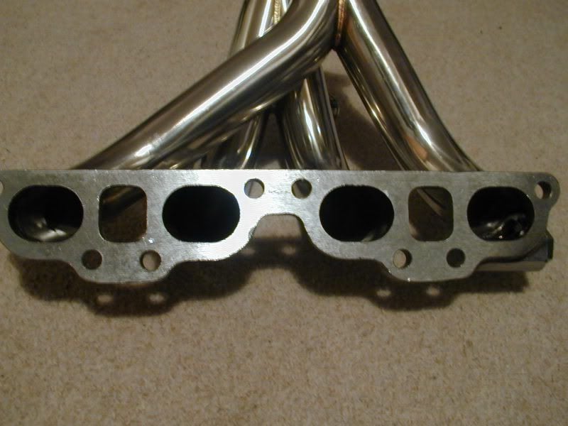

well the header arrived today... pics dont really do it justice... all for only £100 + £30 shipping form the states..
:D
looks like you've had christmas early this year! lol. are those 17" speedlines in the back ground for the micra?
