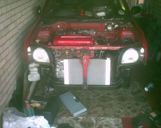

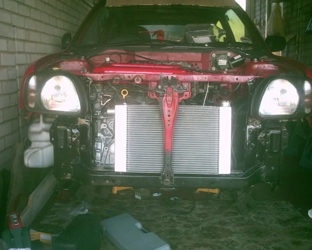

got abit more done today got the headlights in rad mounted and trial fitted the electric water pump.

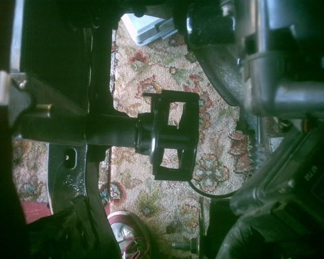

the pump :-

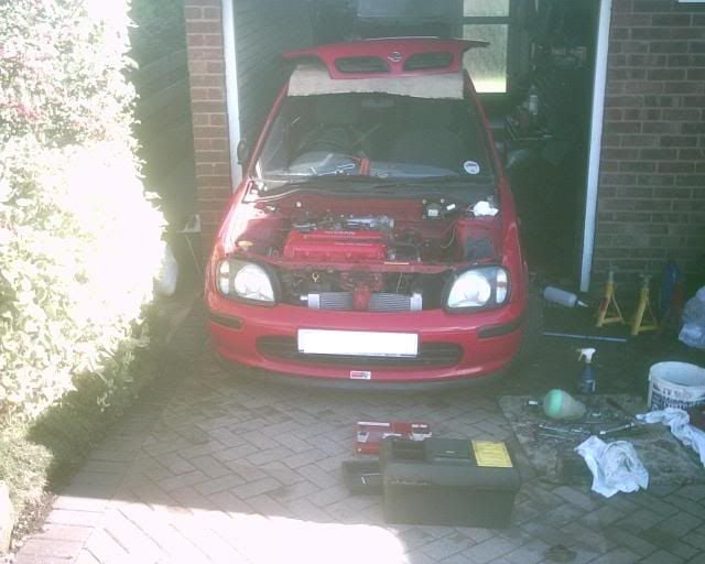

hopefully tomoz ill get the bonnet re-taped and the bumper on and the brakes on ready to tow her home

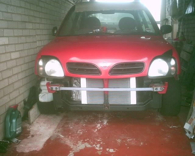

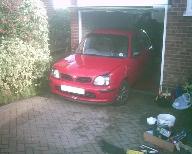

got more done today :) bumper back on the wheels and brakes are on, track rods were a bastard and needed re-threading. just needs towing home so i can get the electrics done some pipes and the shafts putting on :D
sooooo close!!!

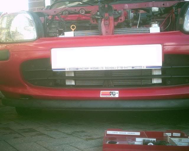

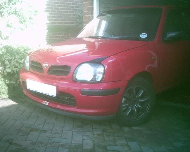

i know the shear stupidity of me askin this with all the other lots of interesting work that you have carried out but a) where did you get the splitter from and b) where did you get the black grille from as i have a gawdy chrome one and want to change. that is some real nce work by the way and i realy cant wait to see how it goes.
lol no problem man :-
A) the splitter is a laguna splitter of a renalt laguna i saw in the scrapyard £20
b) the the grils are the chrome ones sprayed up black i did it miself cost £15 in paint
c) to do the front lights you need to heat them in the oven prise the glas off when the glue is hot then spend time painting the bit inside black, then seal it back up.
