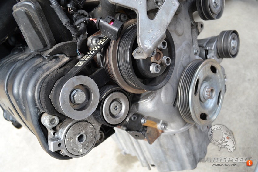

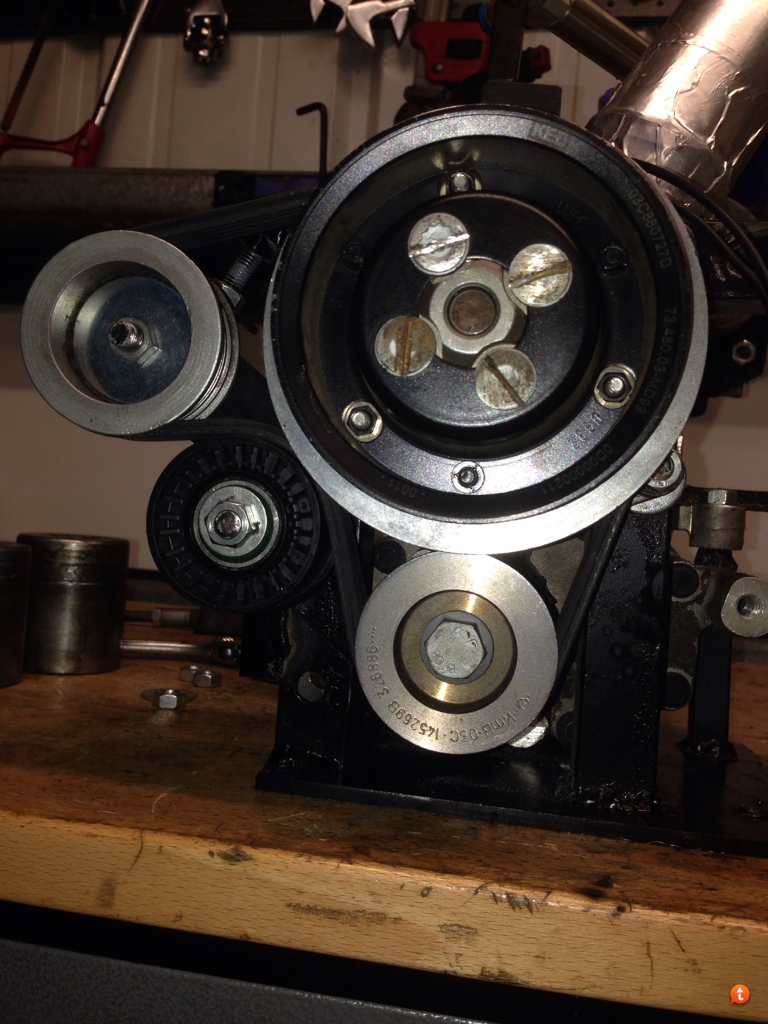

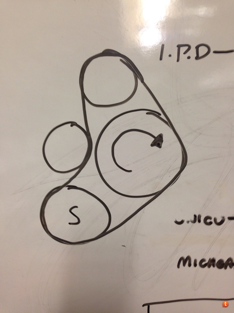

It's between 3 pulleys, clutch charger and belt tensioner
Bit tight down there!
I think your onto a winner though, never really considered the amount off contact needed

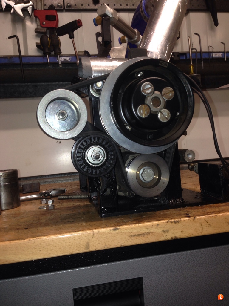

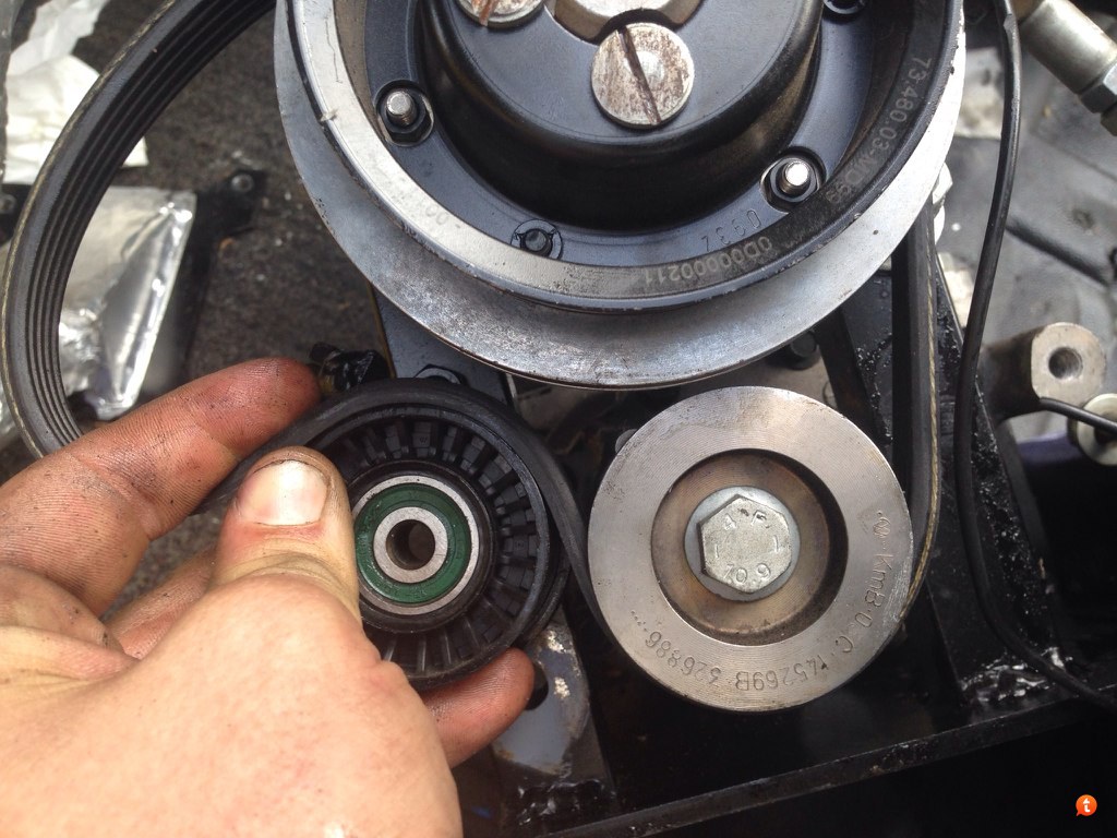

Baby and mrs asleep, so had an hour spare to myself and went about removing the supercharger assembly

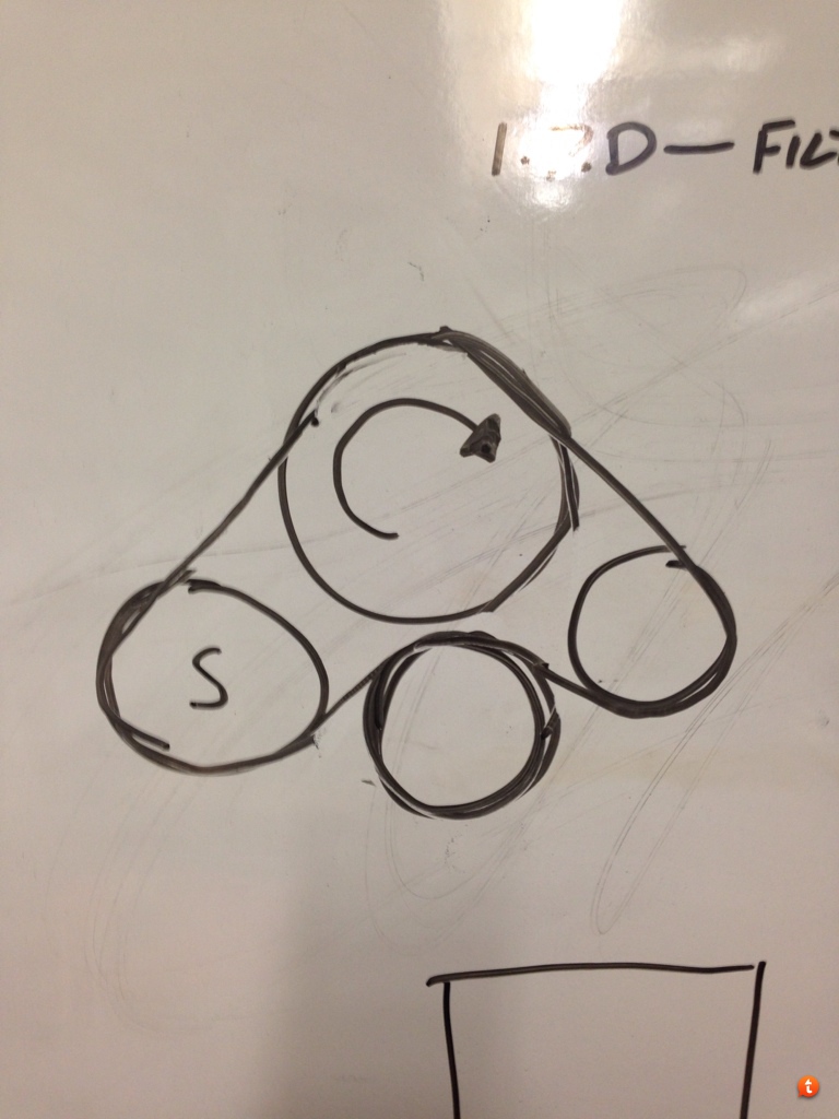

If you can imagine it, the original belt line wasfollowing the diagonal line off black/primer paint, jus left of the supercharger pulley
I can fit an idler pulley here, and move the tensioner pulley, without to much hassle
......will this be enough belt contact? If not in ginna have to redesign rhe whole thing :(

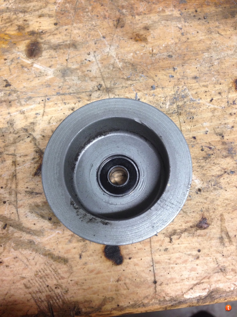

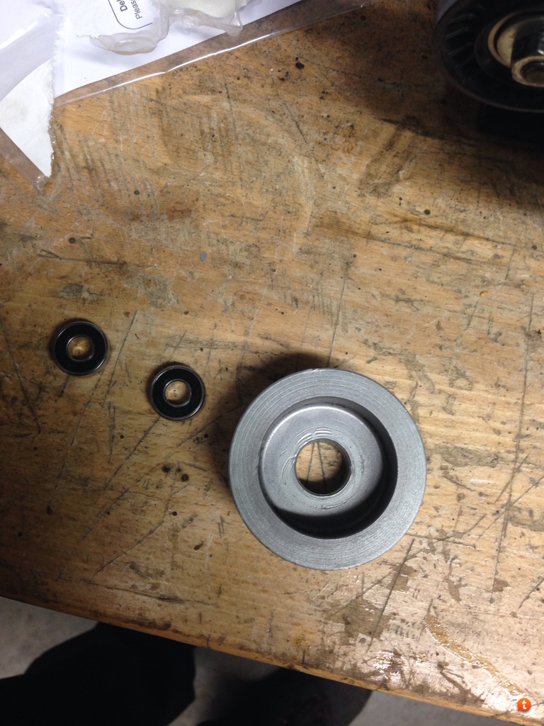

Got bearings for new puller from old alternator
Cut out middle to take bearings, pressed in

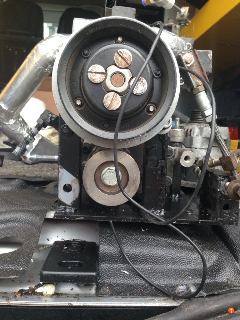

All tensioned up.....loads more belt contact to supercharger pulley now

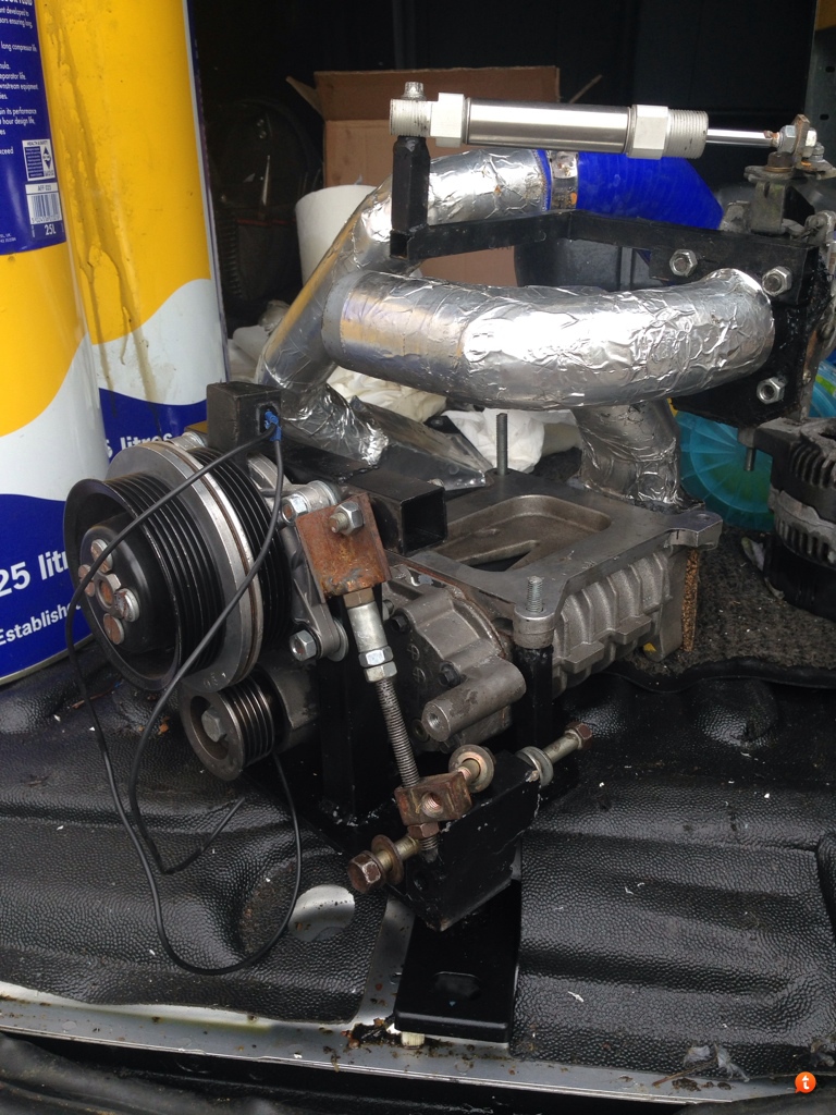

Well it didn't work :(
Here's a vid of it slightly holding the throttle, then jamming pedal to the floor
Opinions?
The faster a belt goes, the more centrifugal forces stretch it out and lose you grip. I'd now look carefully into the vw setup. Check what type of tensioner they use, how much belt contact is on each pulley, how tight it needs to be... Remember you're running more load than on the sc than vw ran, so you might even need a wider belt/larger pulley
Well, at least you've learnt a few things:
Degrees belt contact
Spring tensioner
Belt speed
You also need to look at whether you need to tension the tight or slack side of the belt (load or non-load) for best grip.
