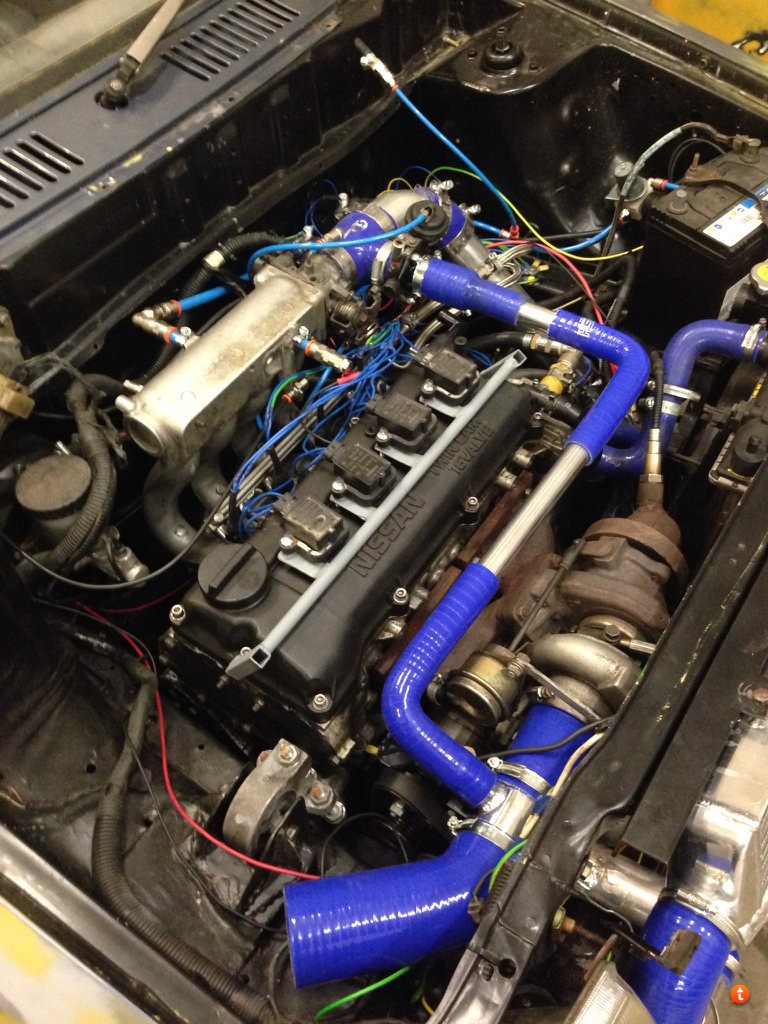

Porks bike carbs and boost project
I think I might have to move my throttle body to before the supercharger
with the belt super tight, it squeals, at idle it's ok(bypass open),
But then blip the throttle and it slips the belt
think the build up of pressure is stalling/slowing the blower compared to the crank rpm, skipping the belt
If I rev it standing still and then off throttle, the force if the air that comes out off the bypass valve is crazy! Il have to put a pressure gauge before the throttle to see
Anyone got any thoughts on this?
Wanna get everything right(ish) before mappikg

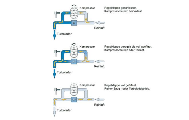

If doing twin-charging the only reliable way to switch over between chargers is using re-purposed flyby-wire throttle body controlled by ECU.
Failing that you can use waste gate actuator to open the bypass throttle on the supercharged when pressure from the turbo reaches certain point.
This is how VW does it:

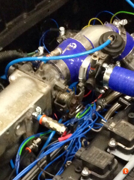

With my engine, I have the turbo going into the supercharger, the supercharger is from the vw golf engine you've mentioned, I also use the electromagnetic clutch from the golf too.
The changeover from supercharger to turbo is controlled by a throttle body attached to an air actuator..,,,.,.
....and instead of a blow off valve, I'm using a vacuum operated bypass valve from a BMW mini, (40mm hole)......
