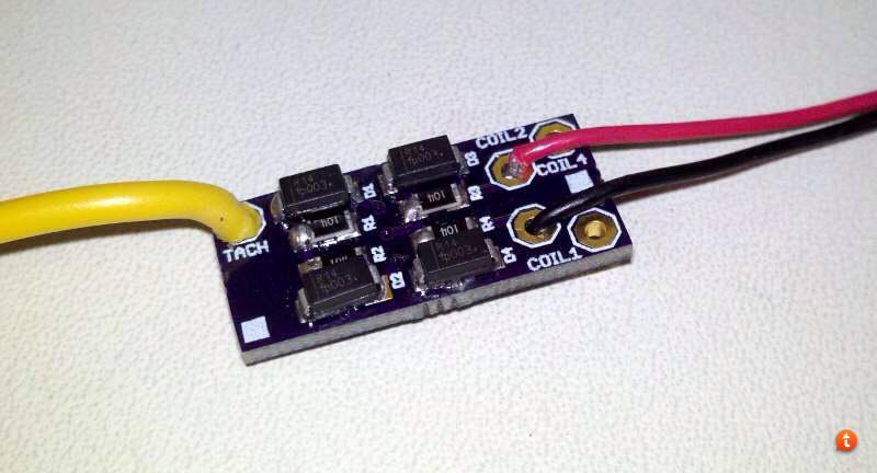

Well it'll be a digital signal, so just like you did with the shift light, run the signal to a mosfet transistor and have it switch a 12v feed from the lighter socket circuit?
That looks like what I'm gunna have to do
Unless there are dedicated rev counters that work straight of an exu
