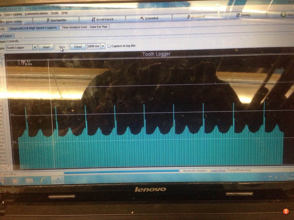

Correct trigger wheel input?This is the live tracking off my trigger wheel...... But why does the laptop gauge read it as 5000 rpm?!?![]()

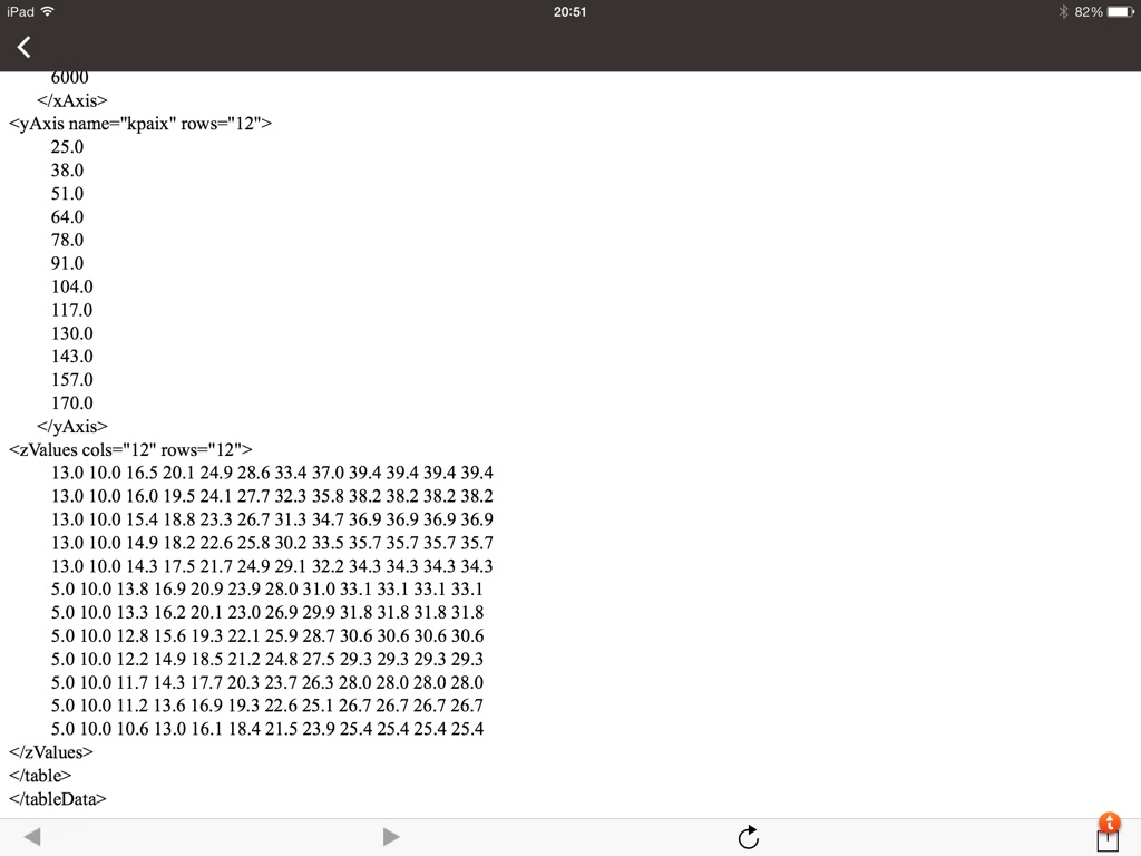

To get you started? Probably not, pick a low powered car though, will probs have a tamer spark map which'll be saferIs there anything wrong with copying spark naps from google (let the abuse rain!)
post up your finished table eh neilYour to kind!
That's a handy tool![]()
i think this area of high torque (probably 2.5 to 6k with your turbo) is the high risk DET prone region, baguete runs very low timing numbers there i believe (many years of 1 bar boosting, and yet to blow an engine apparently)I take it if I put that table in, it'll go boom pretty quick
Guess il have spend a few hours browsing other maps to see what suits.........then save up and get it fine properly lol
dunno neil, pull the timing even earlier maybe ? i think the torque curve closely matches the cylinder pressures curve, BMEP thingy,sAny 'speacial' considerations for the added supercharger? Pretty much instant boost......or doesn't that matter
you have to bear in mind that the load table and hp figure are apples and orangesMy brain is gunna det at this rate lol,
