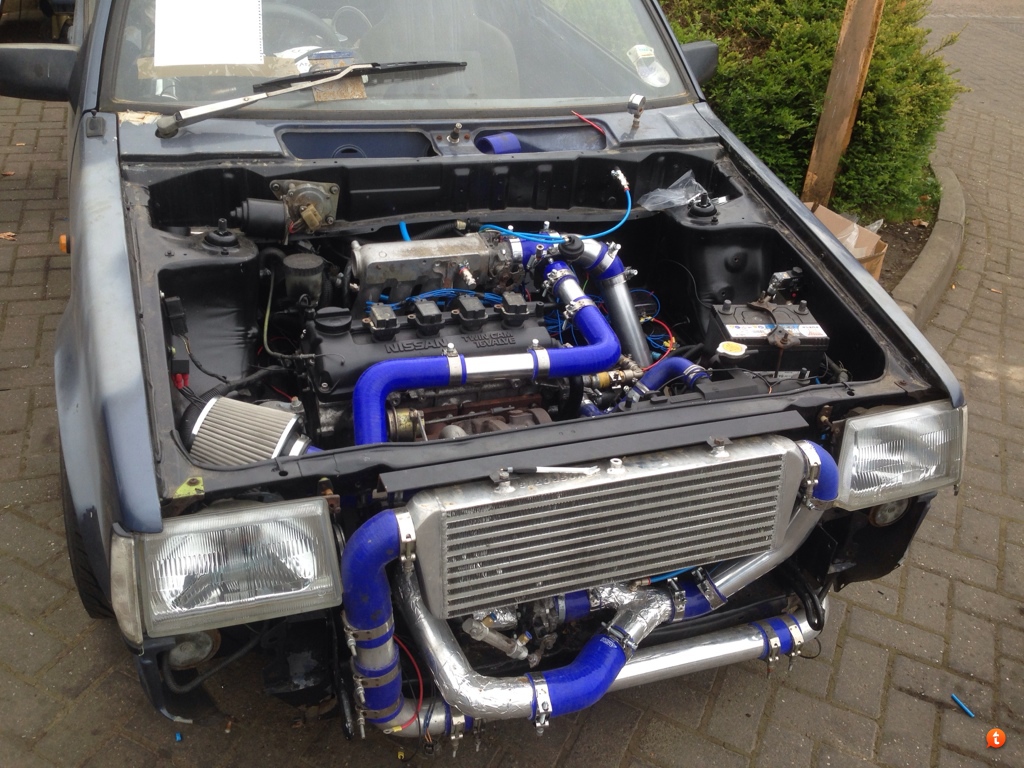

Making some progress again
All birds nest tidied up, wires in correct holes (I hope!)
Relays for fuel pumps and stuff done.
All that's left is to wore in fuel pumps (4 spades! That's all I need and don't have)
Maje plug for where dizzy was
Still havnt welded on trigger wheel!
Still havnt got the rubber sleeve bits for injectors lol
Tiny little jobs left......feels like it's taking forever!
Looks mad though

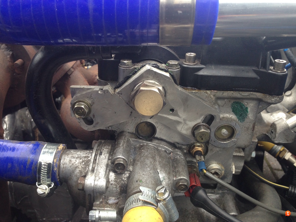

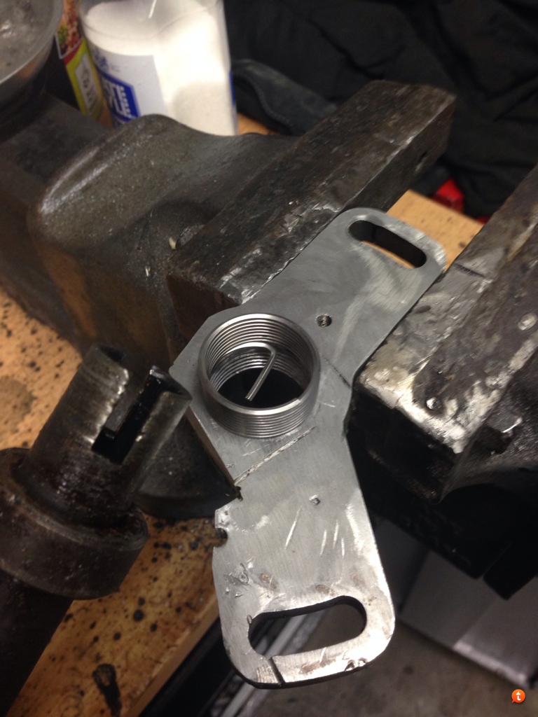

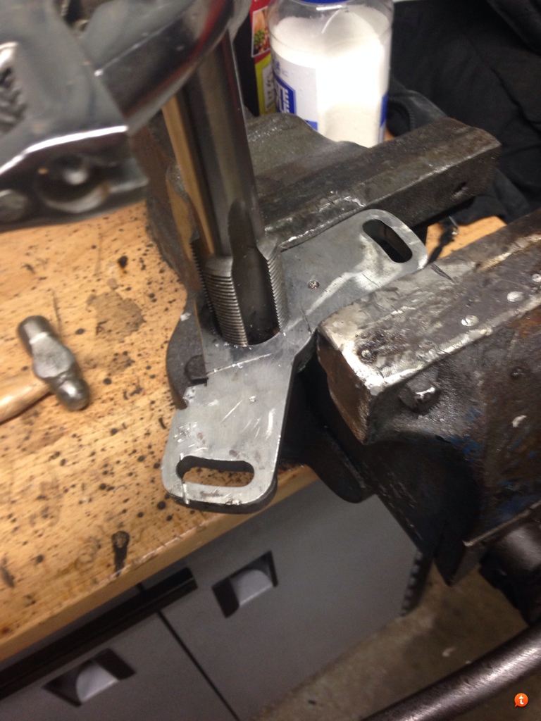

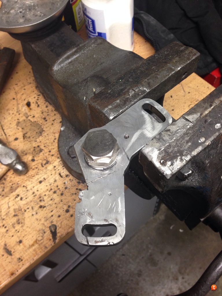

Sorted out a easy/quick fix for covering the dizzy hole in the head
Using the cg chopped up dizzy flange, cut helicoil thread (original hole was a smidge to big, from where ma10 dizzy was used inside it)
Turn on coil
Put on a 3/4 plug.....done

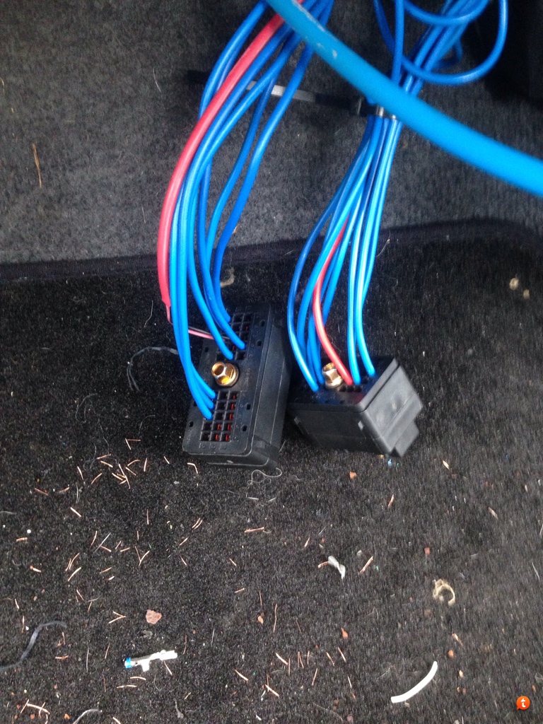

Spent an hour stripping back my loom to find 1 wire I put in wrong place !

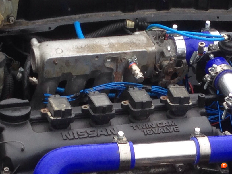

Novice question coming up again :D
I need a timing light/gun, but I have coil on plug.....plugs.
Would I need a certain type of light/gun
How would I hook it up?
You can get ones which plug between the coilpack and spark plug, not sure how well they would work with wasted spark??
You can use the signal wire off coilpack no1 on a normal timing light no?
Not sure about that. The induction pickup for the gun is designed to register the high current and voltage or the spark. Signal is just the switch dir the transistor or whatever is in the coil
It'll just flash twice as often, you should still see the markings ok they'll just only appear every other flash.

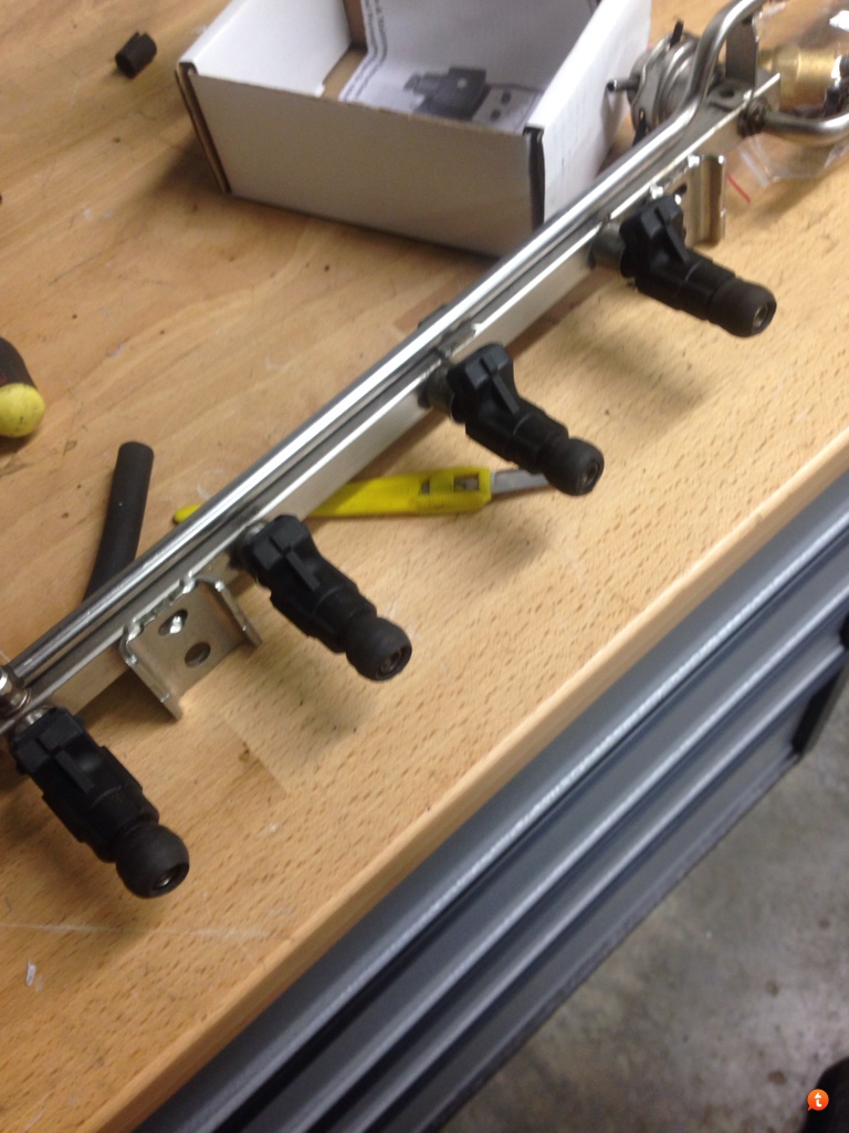

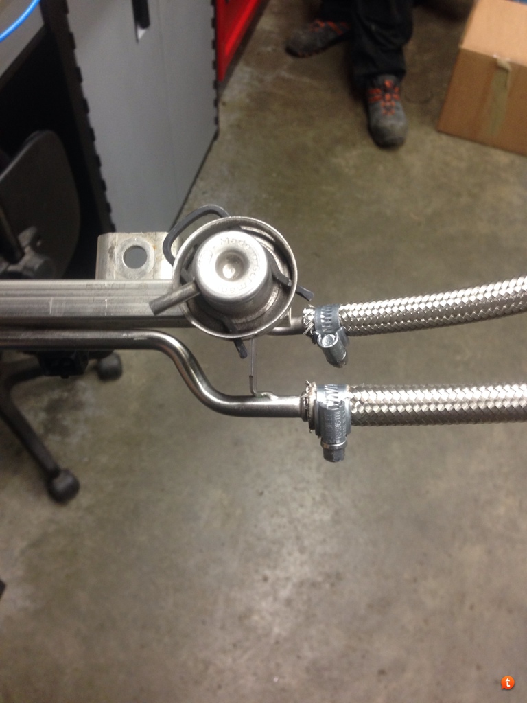

Found some rubber for injectors
Just to maje sure......which is fuel in with these 2?
I think it's the bottom
Bloody electrics!!!
Don't know what I've done, but I've got no power to most things.
I've got........hazards, horn, and lights
I don't have any thing when I turn the key, none of the dash lights come on, nothing, all fuses ok
Any suggestions?
Fusible link on battery Neil?
I was jus fishing out that manual you kindly gave me, and came across that too.
Il check it tomorow now.

Good call, worked a treat, engine cranks over, all lights and gizmos back.
