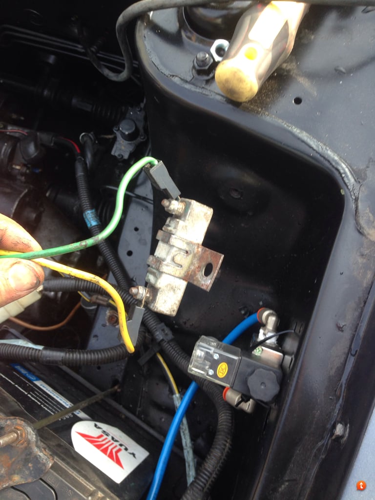

no preheat feature neil ?Yeah, ecu jus needs these 2 wires apparently.
so you,re just gonna run the wideband only ? and no maf ?That's all done by the lc1 controller, this is jus signal to ecu![]()
ahh yesIt's got built in map sensor
with siamesed wiring tho ?Already asked, and yes I can with this![]()
the ecu can do it np, i dont know if the coils can run frequency x2 tho ? wont effect lower rpm i guessThe ecu has ability to run 12 cylinders on wasted spark, I'm jus picking up the parallel ignition coil, so they are paired up .....if that makes sense lol
