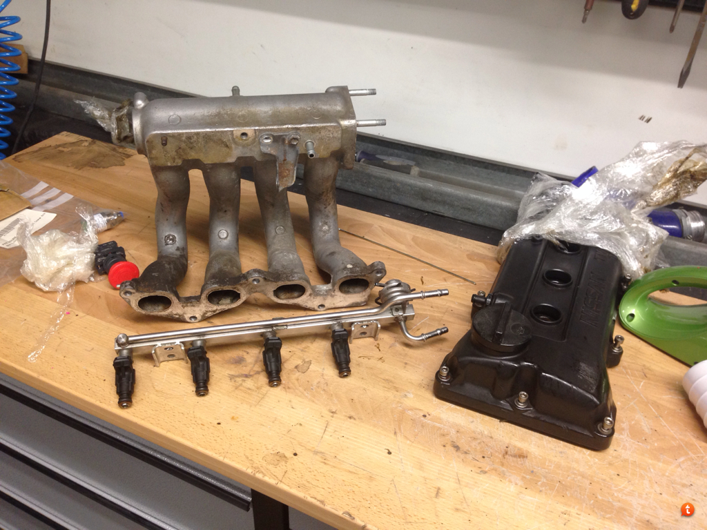

Got some parts thru for injection conversion
Top feed fuel rail (cheers frank)
Starlet mani and plastic rocker cover (cheers stani)
Audi 1.8t injectors
gunna cut flange and stick on k11 flange with the injector ports,
Hmm, £100 ?

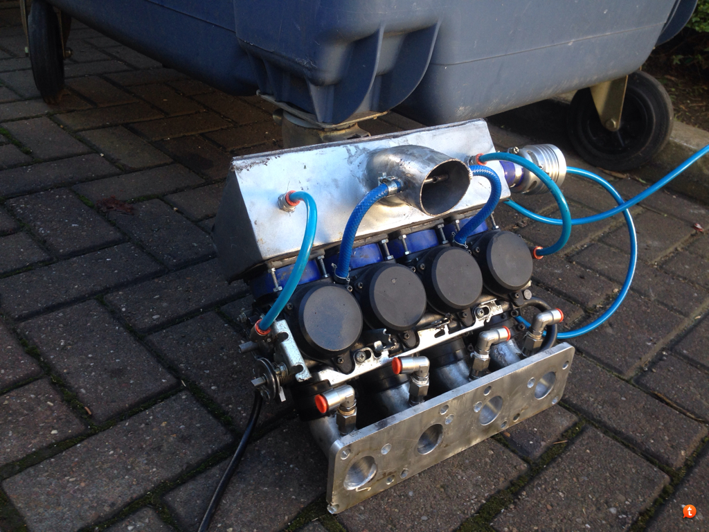

Carbs are good (very clean)
Bogg bro manifold (though, I have drilled and filled bits down to fit from ma10 to cg13)

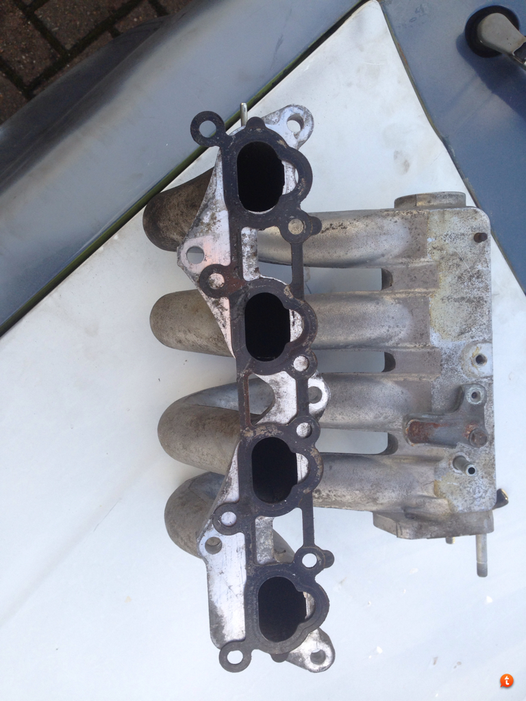

Paid for k11 intake mani week ago, still nothing and seller gone quiet!!
I'm giving till tomorow otherwise il have to source another
Has anyone got one lying about, if so I might have it
Found where the manifold was, idiot never put full address on, jus put my name and postcode so it's been in the depot for days!

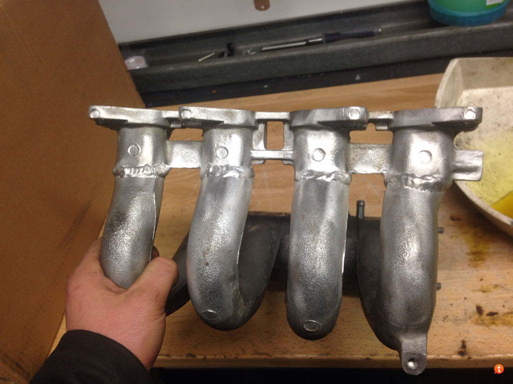

That's all been chopped up and given to somone to weld together.
Quick question, the injectors fit nice and snug in the fuel rail, but not so in the intake manifold, do I need differnt rubbers on the mani, or thicker o-rings on the injectors?
ideally you need the coilpack mani neil (smaller holes) but you can cut some little sleeves from the k11 sunroof drainpipe as collars (nice snug fit :) )
Dam! Should off asked that before I sent this off to be stuck together, Oh well.
