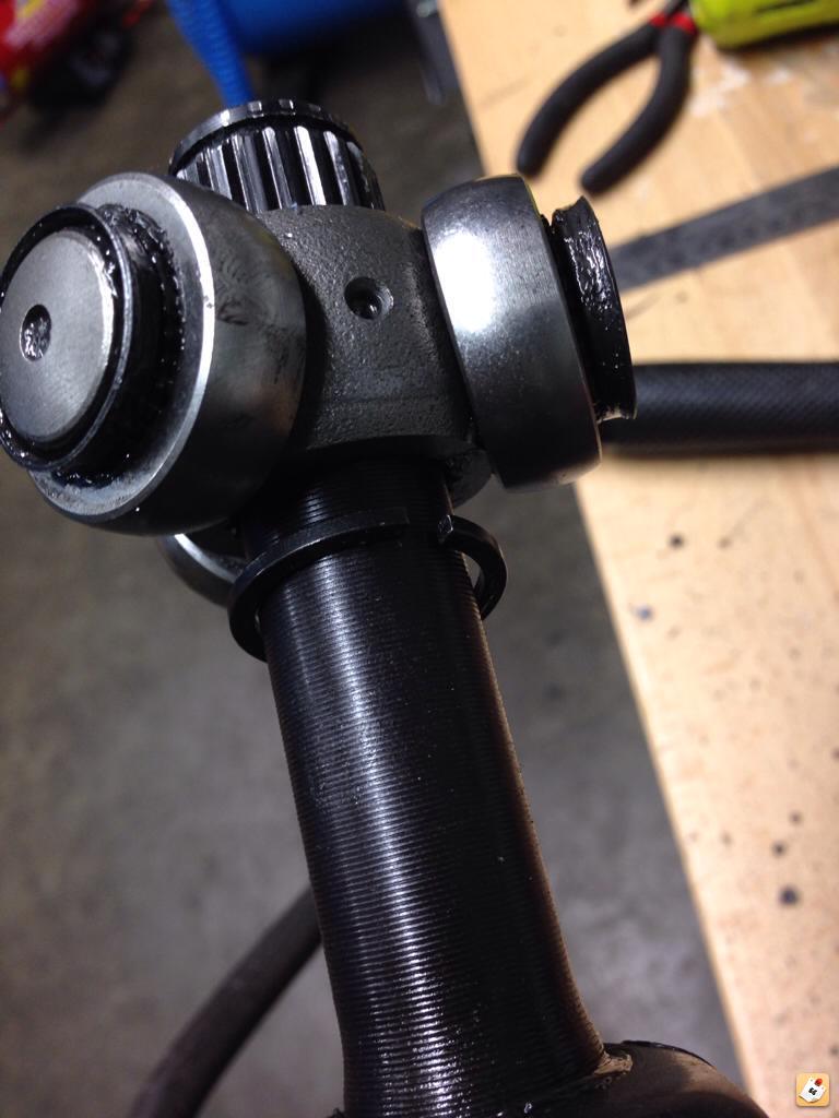

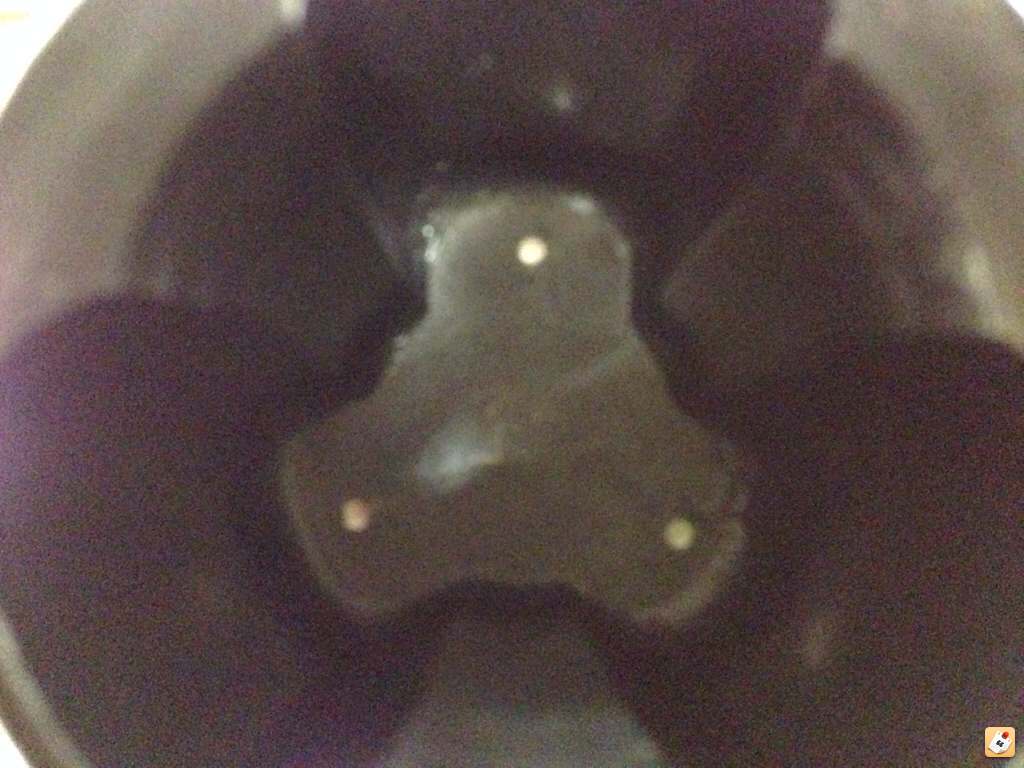

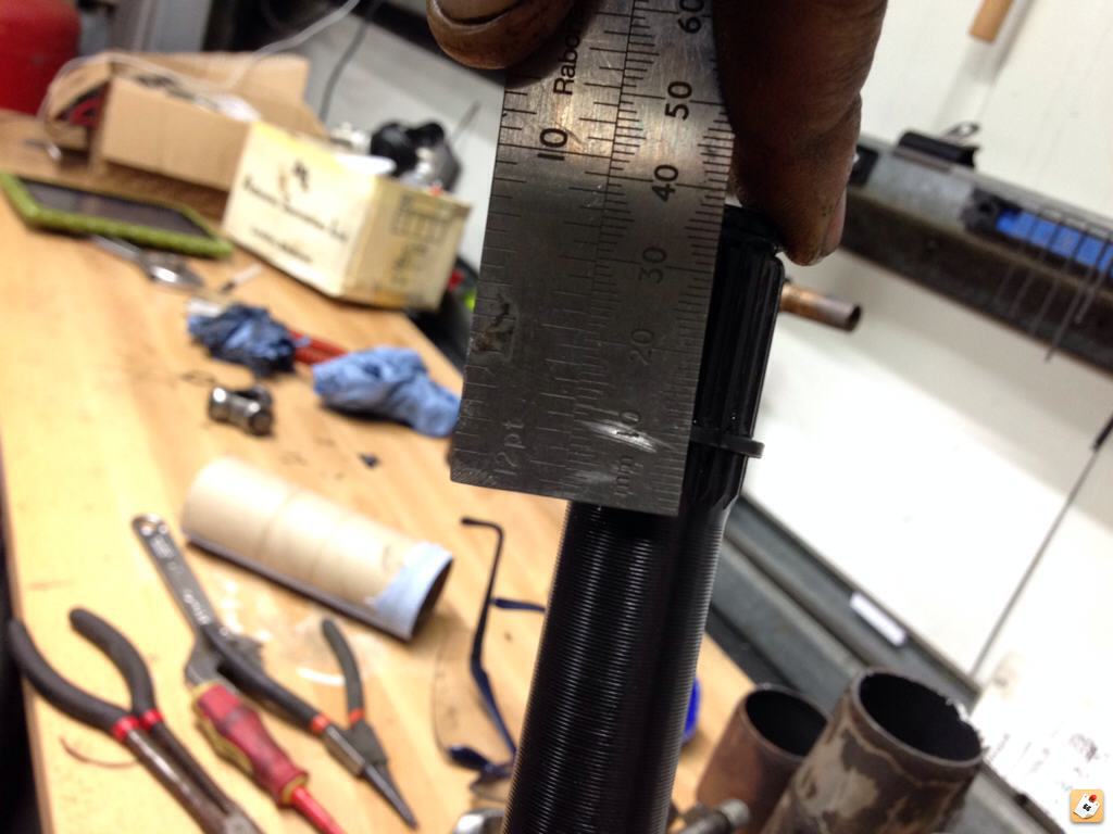

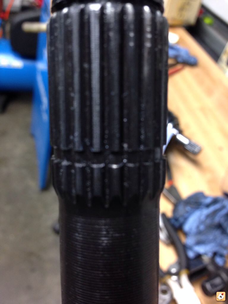

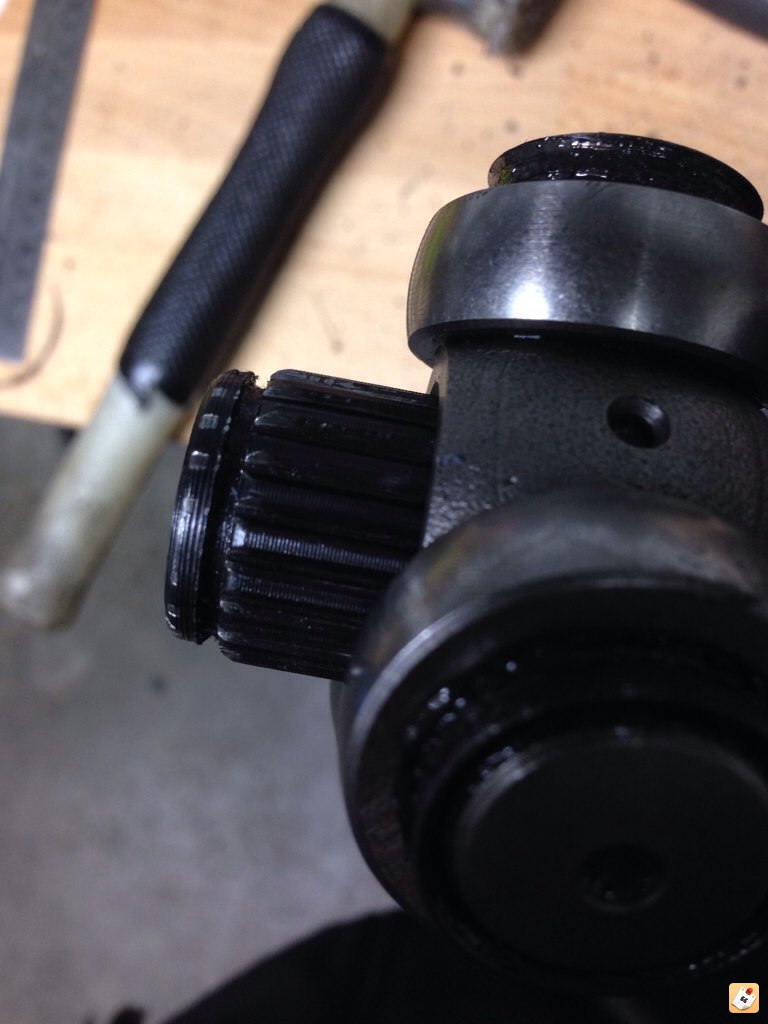

So driveshaft off, I guess these marks are where it's been binding
I've got 10mm of spline left to move it down
Questing is, do I stick it on lathe and cut in a recess for the circlip, or can I just weld it in place?
I don't, but can find one.
The lathe sorts the top clip issue, but not the bottom one.

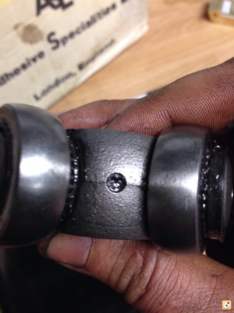

So I think the grub screw idea will work ok
Gunna have to scrap the screw idea , that metal is tough as hell and I'm not spending £100 + on a hardened tap.
I want the spider part here, so shall I weld (if possible) the original bottom clip here....
Then cut recess for top clip here and trim the excess shaft off?
Only 10-13 mm. That should be enough,
I don't really trust my welding enough to mess about with wishbones
If shaft brakes, not as bad as wishbone failing
Have you ever had/seen a driveshaft fail.... nasty mannn :p
I still think wishbones is the best and safest option in my honest opinion
