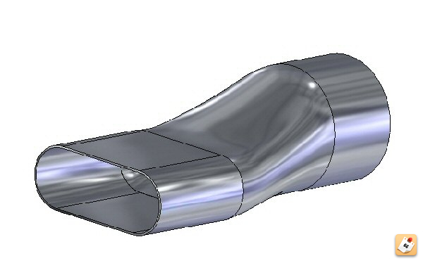

Been thinking about what to do with exhaust, I don't wanna go all way to the rear, so was wondering about a side exit, but the cars really low (coz it's badass) and worried about it hitting everything
So was considering making something like this......
Then carrying on the flat square pipe out to the side, should be ok, right? Obviously I dint want it to be restrictive in any way.
The cross sectional area is reduced when flattened Neil

Just wont you dont burn youreself getting in our out , evebs if you put heat gaurd mesh on it you run the risk of someone burning themselves or you burning yourself if you park up somewhere with loads if people
run it along the gap between the tank and heelboard like mine neil (where the stock one goes) mine is a few inches short of the sill :)
i did this style side exit on my last micra. followed the std exhaust along past the bend after the mid silencer, then carried straight on out the side of the car from there. i failed MOT because i was plowing exhaust gas onto my back wheel......... i failed on lots of other things as well though!
