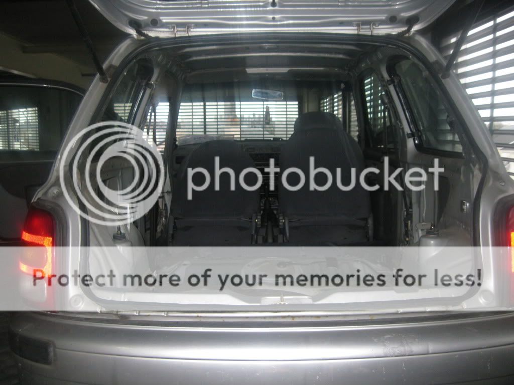

It was useful, won't have trouble with loading the car especially with 4 people as currently this is how the car stands....
But with 15" wheels it would certainly open up my options for tires as well as currently the best i can seem to find for 14" are Yokohama A048's at €130 a piece :eek: but I would probably make due with only two at the front and some budget tires like T1R's on the rear as I doubt the arse of a Micra is prone to stepping out
