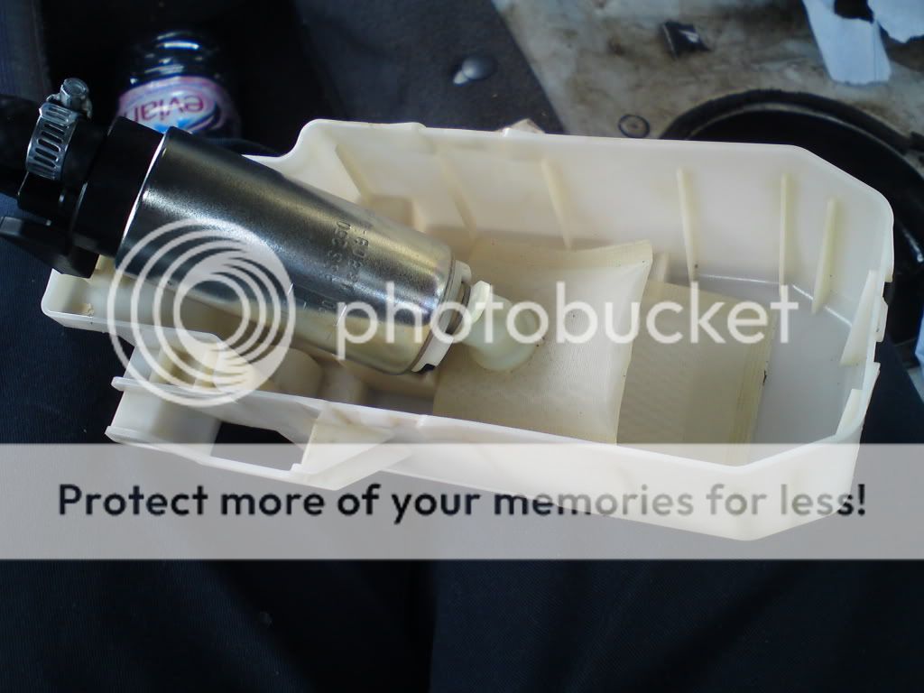

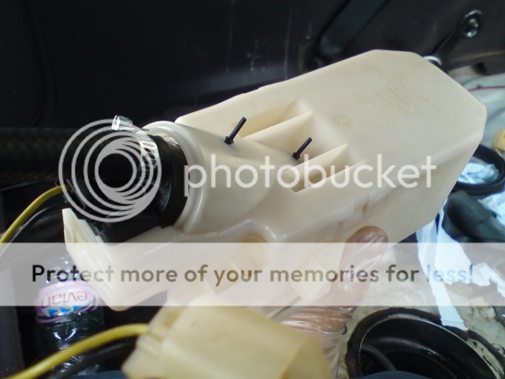

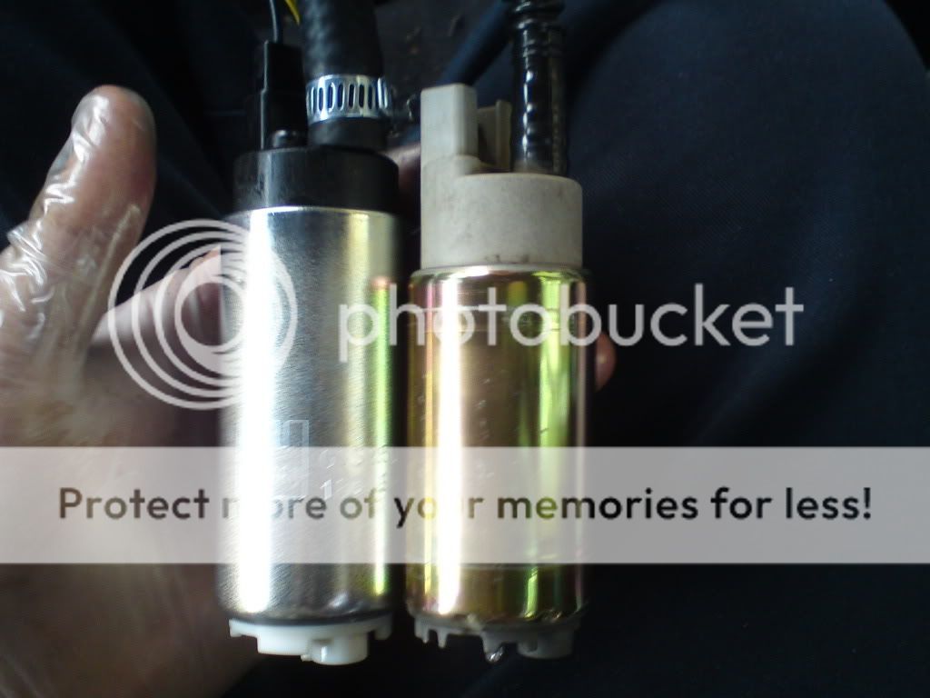

day finished, went over to m8s house to discuss bout the car n we figured the afr issue i'm having might well be a lack of fuel supply at peak load pointing to the fuel pump. i'm thinking it can't keep up at max load maybe cos its getting old? (tis a used gts-t pump eh) or cos i tend the run the tank till red and overheat the pump? or maybe cos of the octane booster that could contaminate the pump?
drove home i will need to to check her over tomorrow
just ordered a new walbro 255 fuel pump from rallynuts for £121 delivered asap
http://www.rallynuts.com/walbro/sytec-walbro-motorsport-fuel-pump-kit.html
