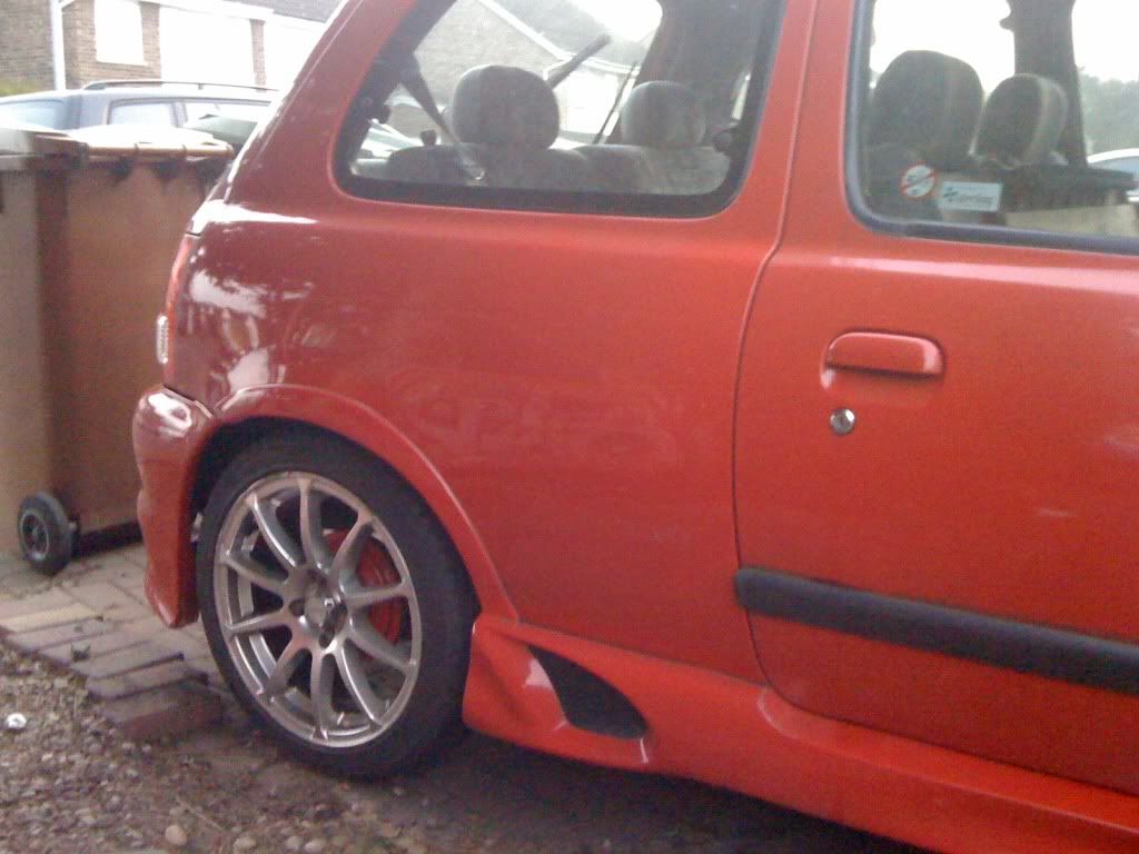

I have been on the forum for quite some time now and decided now is a good time to start my blog.
Here is a little history on the patriot. She started out as a 1 litre LX that had been sitting in a puddle when I first bought her about 10 years ago so needed new brakes all round and new front crossmember. Apart from the Union Jack on the bonnet she went many years with no modifications, then about 5 years ago i got the modding itch and began. As always I started off small with simple mods like a sound system, induction under car neons, spinny hubcaps, aftermarket steering wheel, lowered and induction kit.
She was broken in to and the sterio system was nicked and someone (believe it or not) stole the spinny hub caps which actually did me a favour. lol.
I decided I would go more extreme I decided the alloy wheels were need so purchased them on here from an old member ben and they are still on her today. I then went for a turbo charged engine making my 1 litre a very satisfying 116BHP which was awesome especially after the intercooler was fitted. However I got to carried away with the boost controller and managed to blow a piston ring and crack a piston. So i got in touch with Matt Humphries and we decided on a new engine.
The New engine will be and currently is a 1348cc automatic block with manual gearbox. So i delivered the car to Matt and believe me she just got there it pretty much died as she got in Matts work shop. Whilst in with matt she had a new uprated clutch, port polished gas flowed head, high lift cam, Lower ratio box. I also supplied a body kit i had sitting in my garage awaiting the right time ( this was Now ).
She came out looking amazing and it was a definite pimp my ride moment. lol. with a loud powerflow exhaust she looked and went amazingly well. This is how she stayed for quite some time before getting the itch again, and having a shiny set of 42mm jenvey throttlebodies made. So back to Matts again for the throttle bodies to fit with an omex 600 ecu and new coil packs fitted, after a whole day on a rolling road and messing she produced 128.9 BHP which was incredible with 105 lbs of torque. She ran beautifully scaring alot of bigger cars as well as being easy to drive and live with.

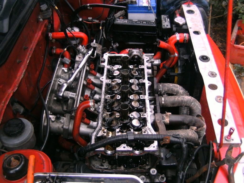

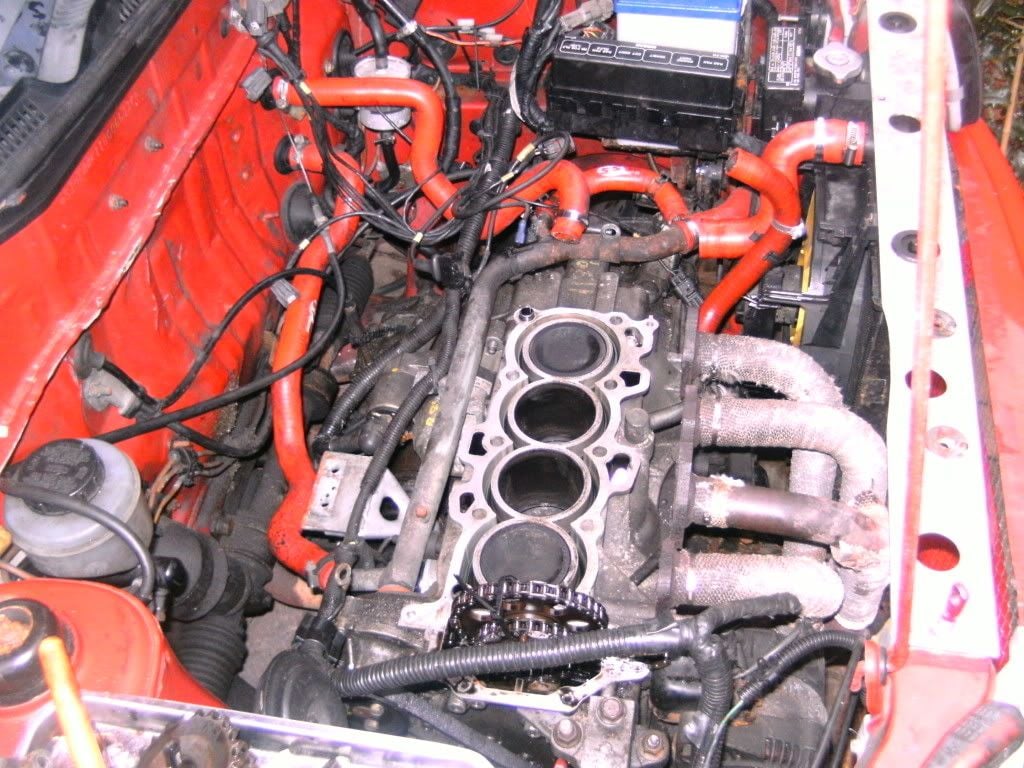

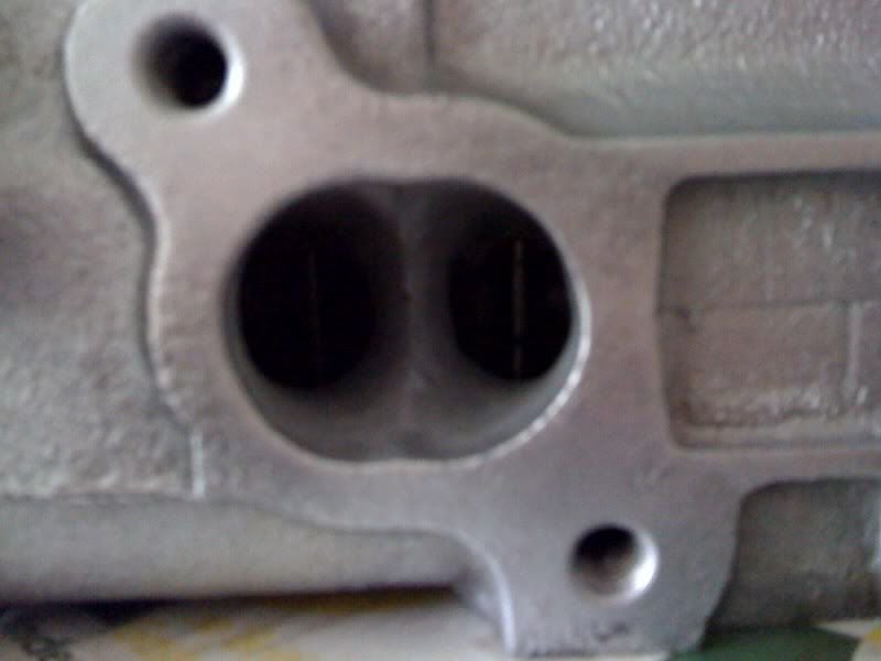

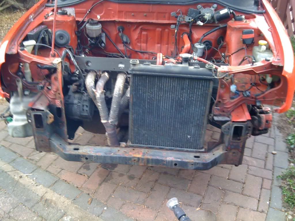

I have removed her head, this is in scotland currently having a stage 3 modification by hiflo heads and in the mean time i am tidying her up, and will update you of all the odds and sods done. I recently rubbed down the inner rear arches and undersealed them which was a job worth doing. I have new rear hubs just in case the old bearings are getting tired and new front 100 nx calipers to fit but wann paint these first.

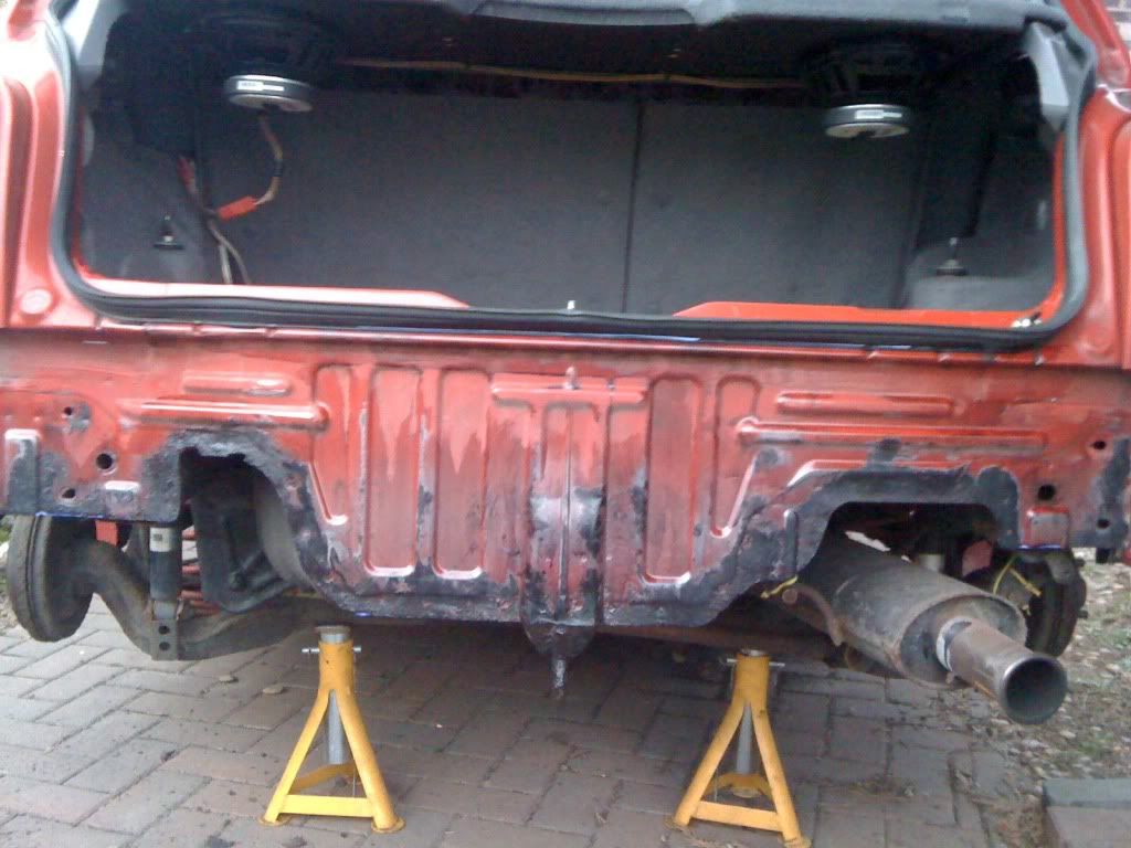

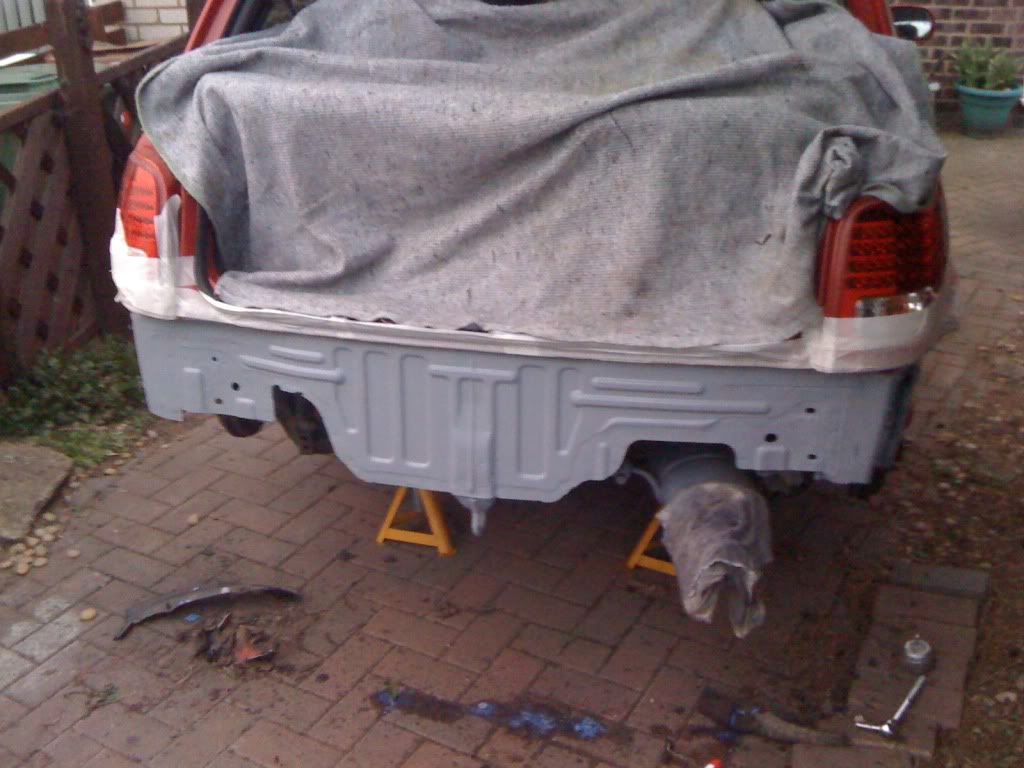

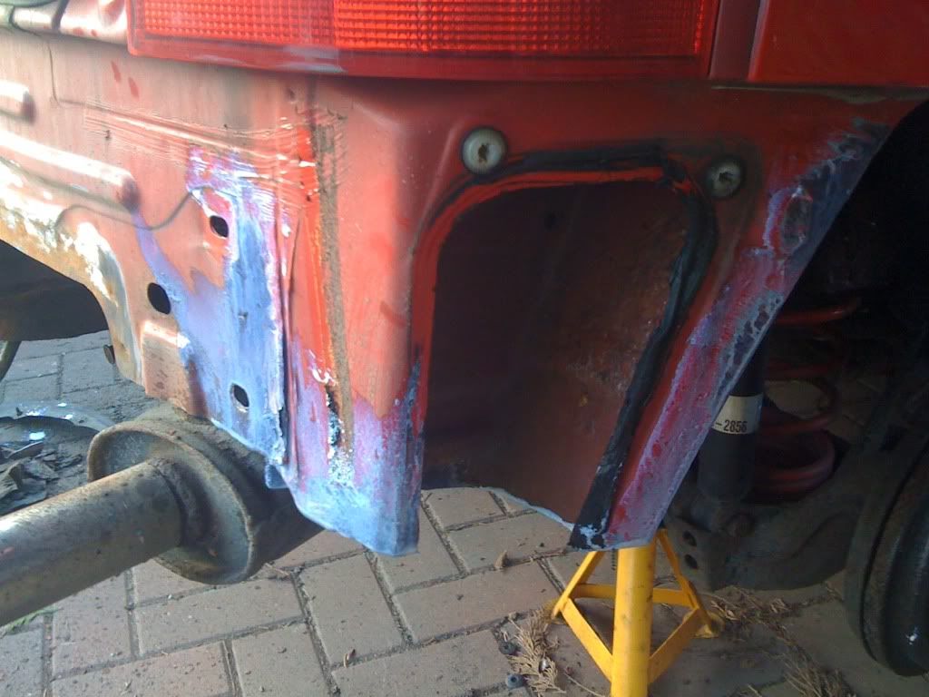

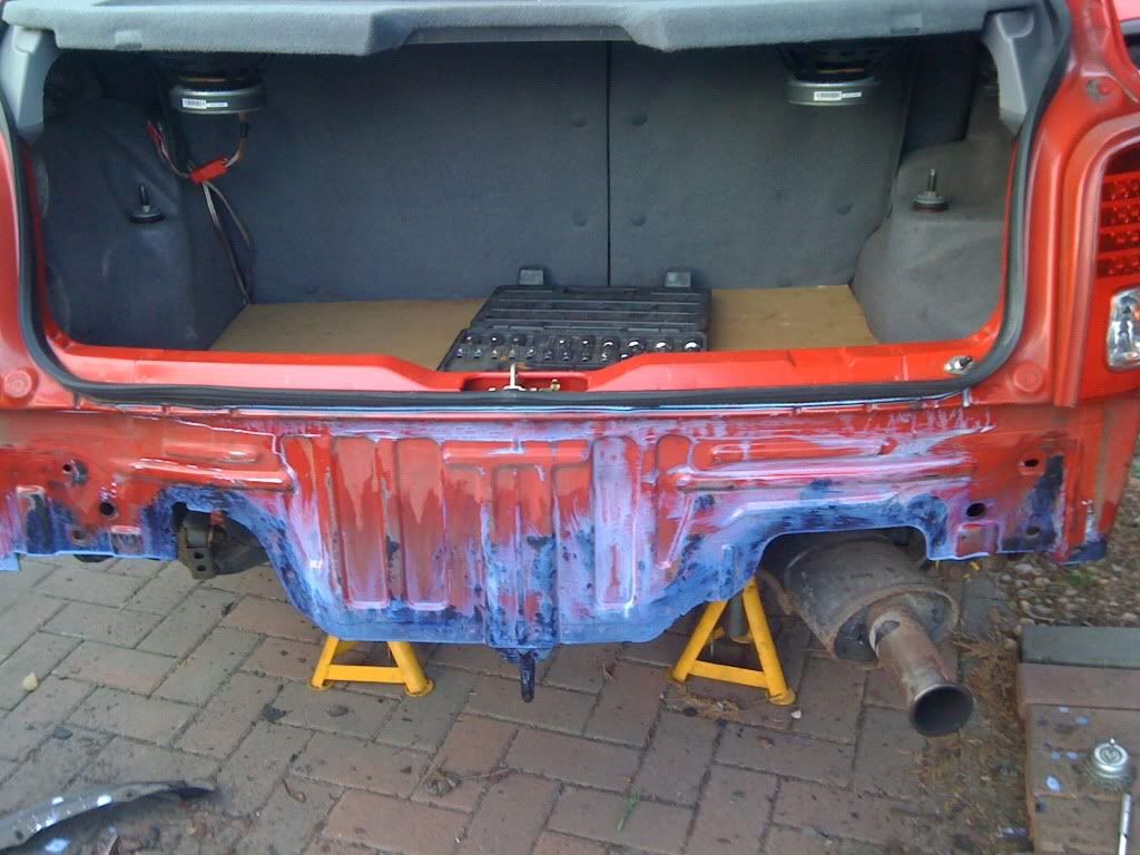

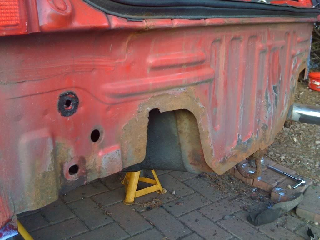

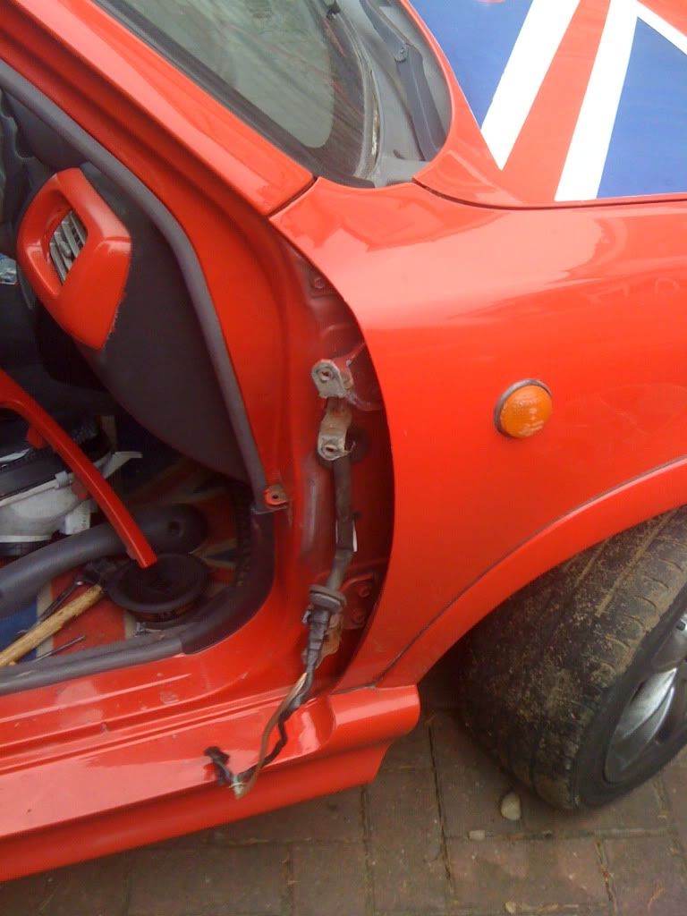

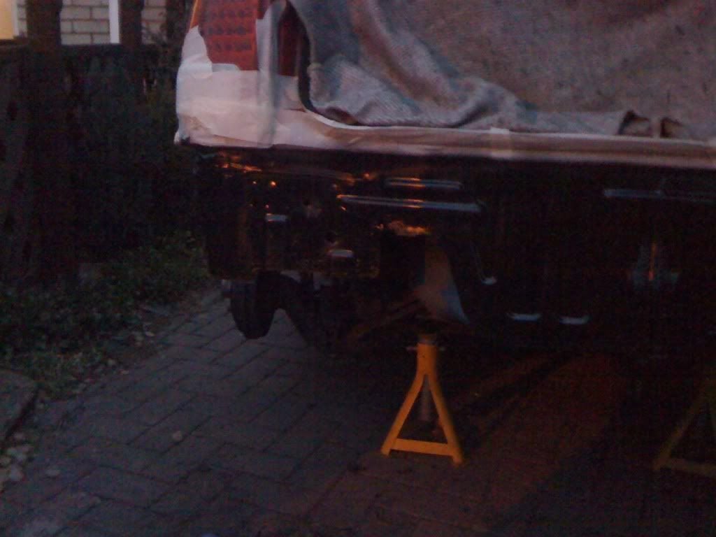

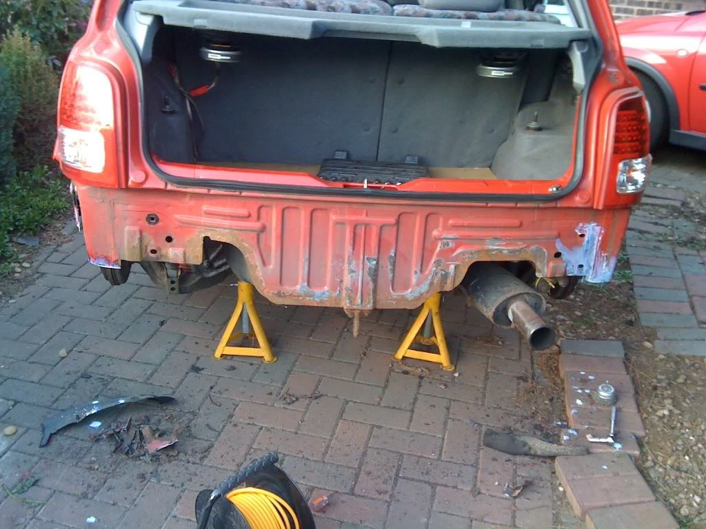

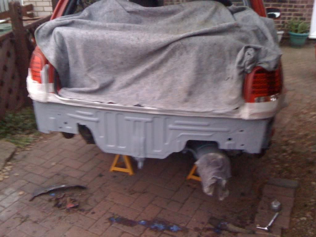

Yesterday I thought i'd take the back bumper off and and clean up the rear plate as these get a lot of surface rust which i thought would be good but although i found surface rust i also found rott in the rear ducts so have rubbed the surface rust down cut all the rott out minus some surface rust that has run into the bottom of the rear arch this will require a proper body shop. The rot was aweful though i tapped it and my finger went through. I have treated all areas with Kurust, undercoated and sprayed with stone chip paint. This week i will also get the new rear hubs fitted.
I will get some pics as i go along i had been taking them on my iphone but the last update crashed it loosing the photos so i have now learnt from this but will post new pics up.

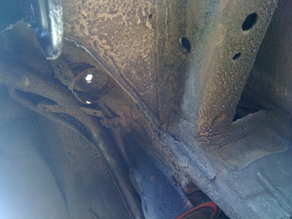

The power was at the fly wheel i think and will hopefully reach the 135bhp but maybe more. The rust is a pain in the bum but will sort it the rear panel is now done so the front bumper will be off tomorrow to see the front crossmember and what surprises lay within. But worst case i'll weld a new one in if it needs it.

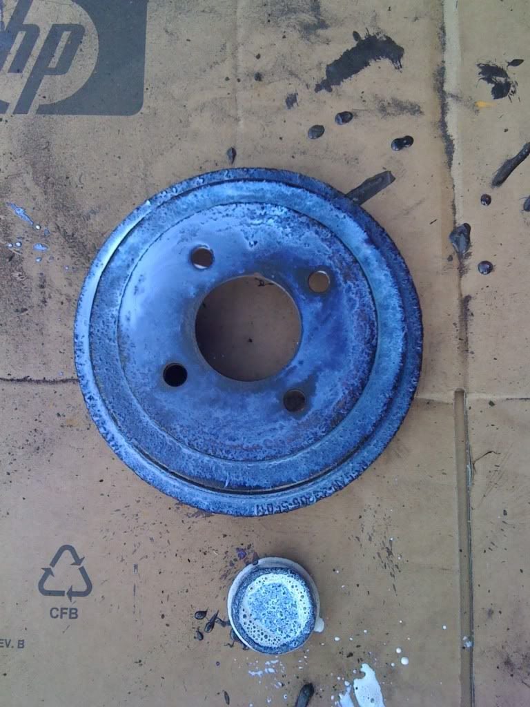

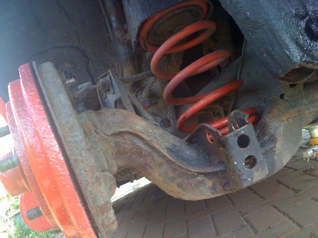

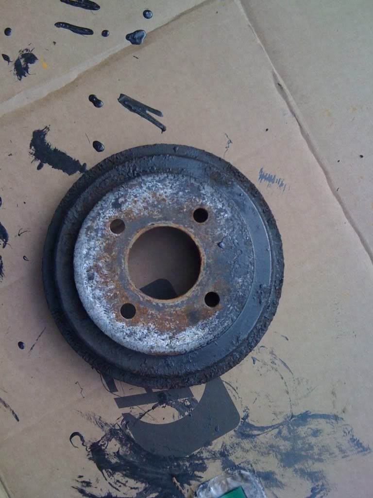

Today should see the hubs back together, and the underneath (rear half) wire brushed back and painted in a stone chip rather than underseal but this should be better protecion than nothing. It will be treated with Kurust first as well where required.
nice mate, paul smith is a proper british name so you suit the union jack flag,
rear drums painted black = win, painted red = fail. thats just my opinion though mate.
alot of engine work, hope it holds out this time dude. (Y)
Well I do like my name and your right a proper british name. lol.
The Union Flag is absolutely awesome
I did contemplate black rear drums and was going to do them black as I thought the red would look chavvy and abit over the top but then i thought i'd see how they look at the minute i kind of like them but i'll see how i feel after a couple of days.

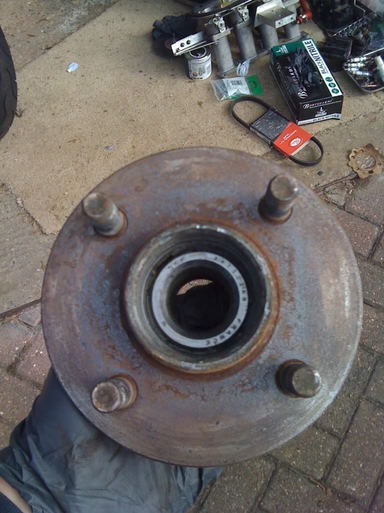

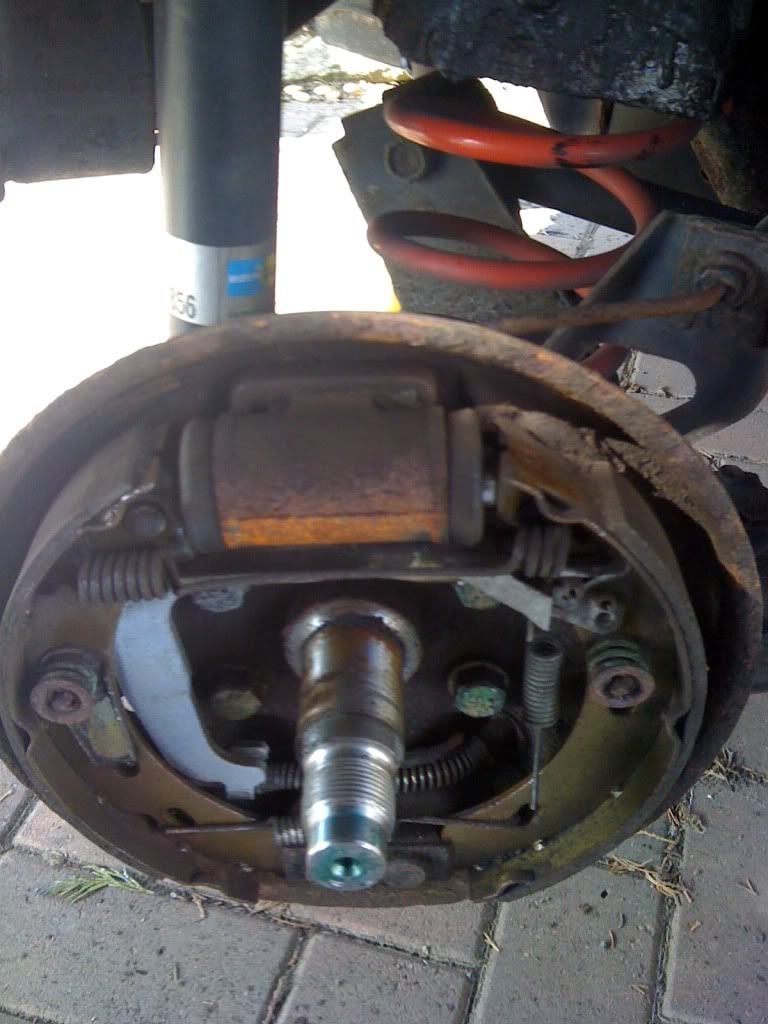

More work done today new hubs fitted and new rear bearings greased and fitted. I treated underneath up to the fuel tank and paint that black which looks all neat and tidy. Took the rear dampers out as i'm playing with suspension ideas. removed the front headlights and will go and remove the front bumper tonight.

The micra I refitted the bilstein rear dampers and went from gmax springs back to 35mm apex springs i have as these were a far nicer ride height. I don't have any apex springs to use on the front but if anyone does have any then i'm willing to swap the 60mm drop ones i have for them. I fitted the rear bumper back on and rear wheels but then lost the light. I'll try and get some pics up to day to show the ride height.

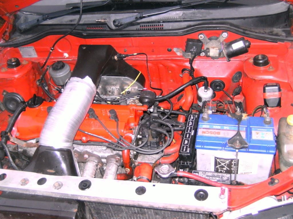

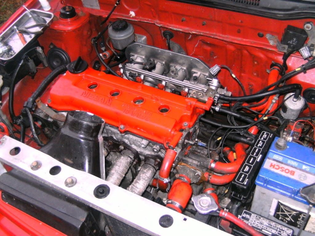

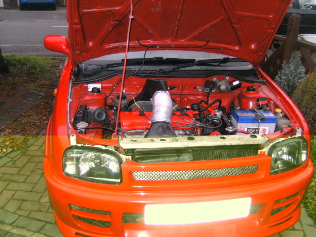

With regards the throttle bodies vs turbo. There is no out and out winner. This is what I found.
Turbo - Was really good fun could play with boost, making the dump valve noise, and being young and having something a little special. However when zooming around always had a feeling of cheating in the back of my mind.
The Jenveys - You don't get the boost power as they are far more refined than a turbo but do make an awesome noise when opeing her up and the speciality of not many others about. Without a sense of cheating but I do mis the dump valve noise.
So in my opinion there isn't really a better or worse it completely depends on what sort of power delivery you are after. What you want is the jenveys with the turbo :grinning:
I am looking to have a play with a supercharger with the throttlebodies soon I think so i can compare all 3.
With regards the firewall at Matts yep that was required for the throttlebodies position and room as was removing the brake servo to allow the 1st body to fit. So I am going to have the joys of tinkering when the head is back at freeing some space up and fitting the servo back on as I miss having brakes. lol

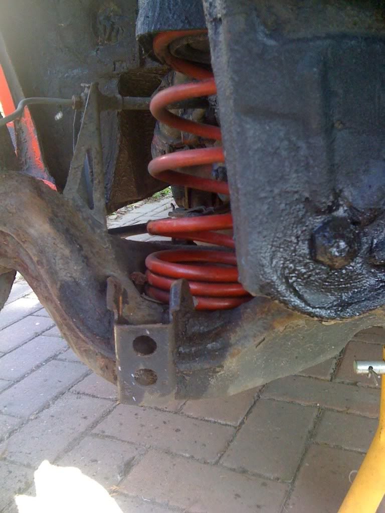

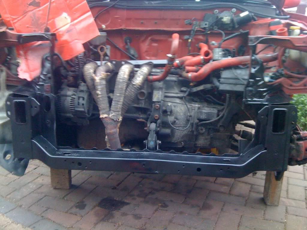

So far this week I have removed the inner wing liner, front bumper and suspension. I have treated the front crossmember after a rub down which is in ok condition and will be spraying it over the weekend making it look nice and i will be rubbing back and spraying under the car and the inner wings (treating if required). I am in the process of buying a new spoiler from a super S (the full rear window spoiler) and have order a head gasket set which i will collect later today. The head gasket is going to a local company to see how much they will make me a solid copper gasket for if i'm not happy i'll fit the standard one again and hope it'll last. I think I know the problem with the last gasket so this time hopefully I'll be ready. Talking to a few companies they all seem to think the power i'm running, the gasket should be more than comfortable with. Only time will tell.

A few jobs done, i fitted apex rear springs and removed the gmax ones as the apex have given it a tidier ride height the Gmax were to rigid. I am in the process of rubbing the under neath of the car back ready to be undersealed. I replaced the dented door with one from a scrappy and am in the process of removing the bump strip but need to get some sticky stuff remover and have rubbed back and treated the front cross member and sprayed that.
I need to paint my new 100nx calipers as my old ones have seized on 1 side and refit the front anti roll barand paint the inner front arches as well as finish the other started jobs will probably aim to get these jobs done over the next week.

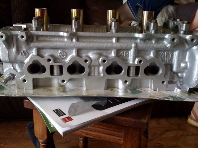

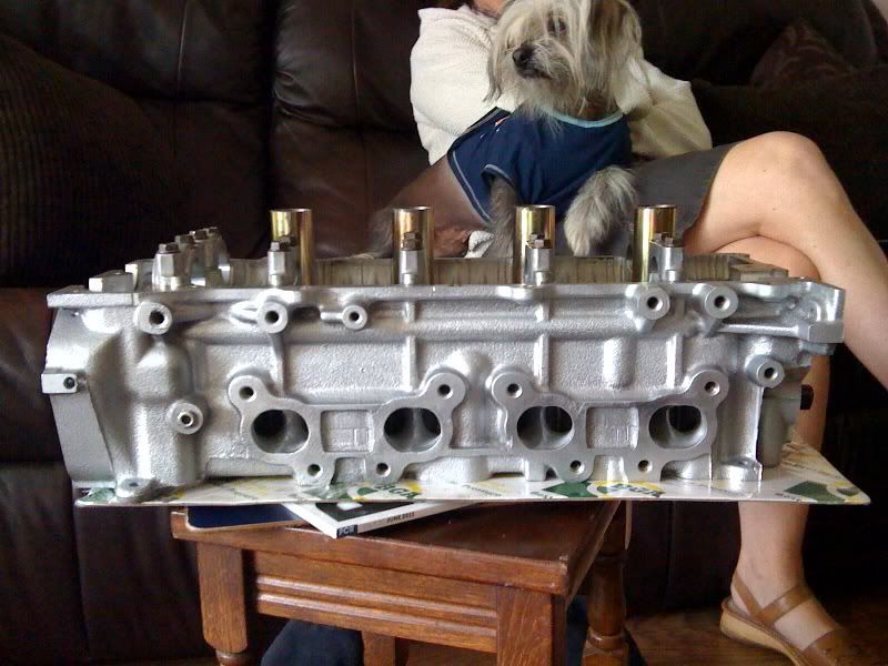

Ok another update, finally my head will be ready by thursday which is nice.
I have cleaned and painted the sills, inner arches, removed the janspeed manifold, and found something very interesting as the pics will show. I have also removed the alternator :laugh:
and whats this, ive stripped and given a light rebuild too, but seems good

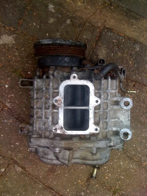

I fitted the charger last night along with the alternator. I have had to turn the alternator 180 degrees which still sit it higher than the base of the sump and allow the pully to remain in line. I then modified the bracket holding this and mounted the supercharger above the alternator this meant a bit of angle grinding on the bracket and parts of the charger so they would slot together. She seemed sturdy and although she will have to come apart again for some slight moding and tidying up it means I can make a bracket to support the upper weight of the charger.

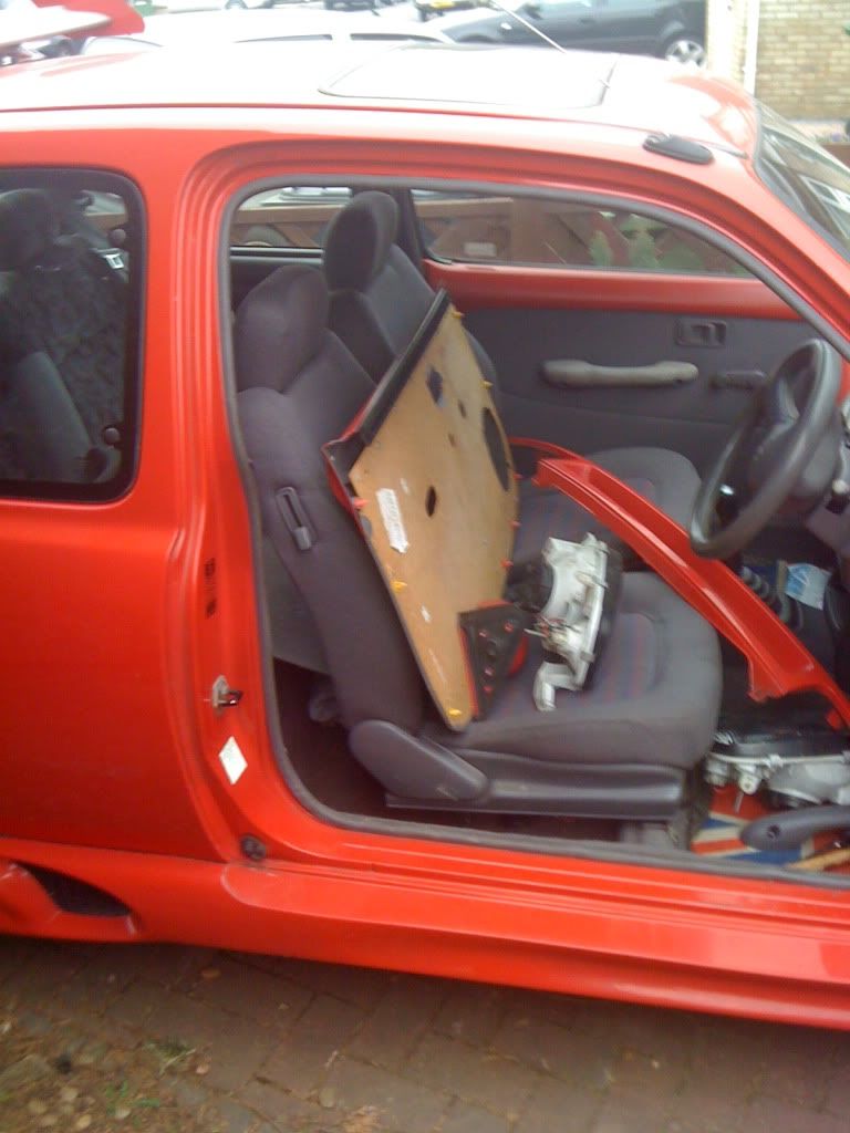

Also over the weekend put the drivers door interior together, painted my new calipers although these need another coat, and cleaned my engine bay which now looks alot tidier. I have to make a new list of jobs to work through as there is still lots to do, many jobs being delayed by the head and head gasket that I am still waiting on.

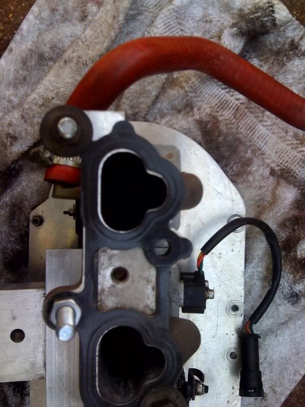

Sorry for the delay as far as I can see they are parallel bodies.
Opps, missed your reply. I was in the UK last weekend sorting some things out. We run taperbore throttles, 48mm inlets which taper to the required 42mm of the inlet manifold, so I expect yours will be the same.

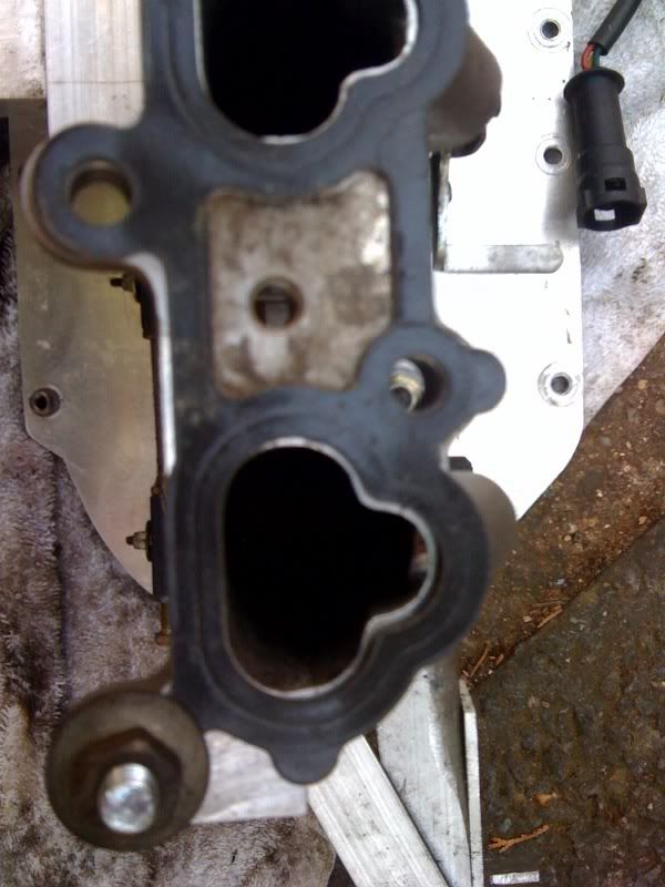

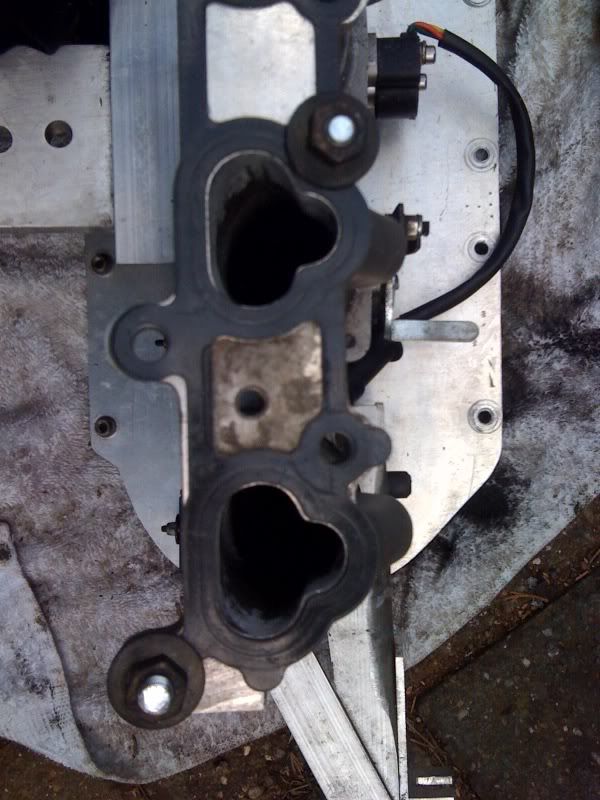

The head gasket turned up with the head bolts last week and it looked really nice and shiney and new, the head turned up monday but was missing the buckets and shims but they arrived wednesday, the cams were also missing but they are on route. I decided to line the parts up yesterday but discovered the head gasket set is similar but not right. It fits beautifully around the chain and the pistons but does not have any gasket around the outer holes so i will need to return this monday which was a pain.

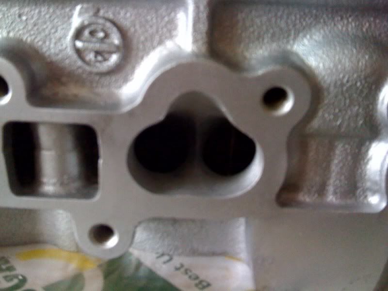

So I decided to look and doing some porting myself. So i clamped an old manifold gasket to the throttle bodies and ground out the excess metal from there hopefully giving a mildly better air flow. I am also very pleased with the work done to the head she is looking very good indeed.
I have ordered a gasket set from matt today so will definitely have the correct parts this time, don't know why I didn't call him first. So thanks again matt saving the day :)
