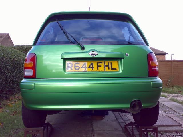

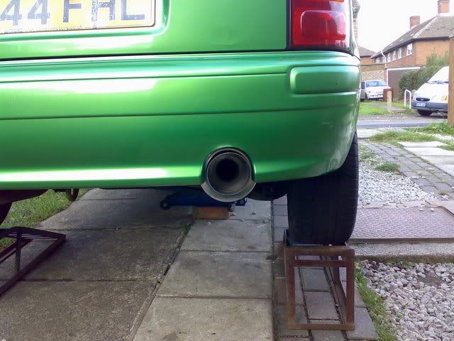

here's some work in progress pics of exhaust.

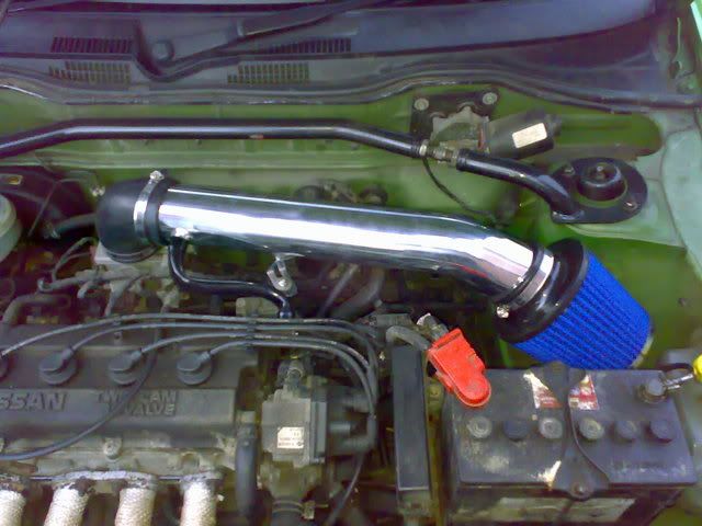

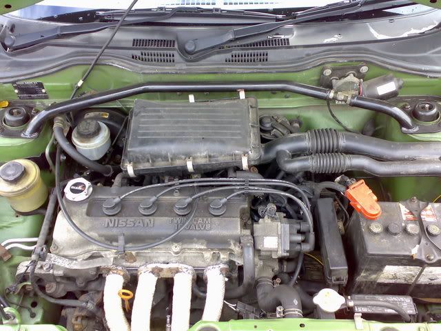

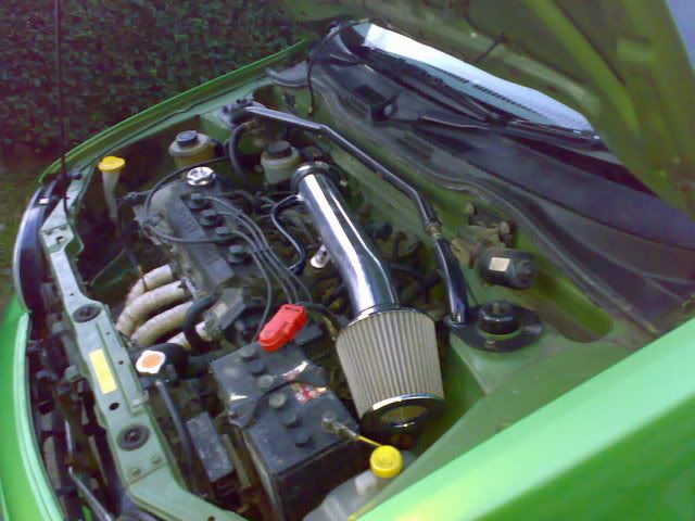

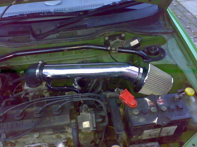

here's the pics of the new intake. it's a little larger than i thought it would be. about 3" diameter pipe and also longer than i'd hoped for aswell. it required a little modding to get it to sit right, bending brackets and moving battery as far forward as possible on the tray. i might try and shorten the length down a tad. it seems to have made a noticable difference though. pics up well and also sound awsome.
with the filter it came with
with my stainless steel mesh filter (same dimensions)
here's the link i got it from. it's taken less than one week from germany. top seller :). shipping was 13euros. it's possible to get them a bit cheaper than the £56 i paid all in, but i used buy it now cos i couldn't wait 9 days for auction.
http://cgi.ebay.co.uk/ws/eBayISAPI....m=280170444576&ssPageName=STRK:MEWN:IT&ih=018

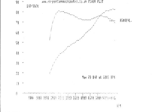

been on rolling road today for power run. went with the npoc to RE performance in bury. the dyno only gave whp figures and didn't calculate bhp at the fly. well it acheived 79bhp at the wheels. using this site for reference. http://www.dyno-power-run.com/dynocalc.shtml
it got near as damn it 99bhp at the flywheel. that's an increase of 25bhp or almost 34%, which equates to about 116bhp per tonne. i'm happy with that.
i'll try and upload a vid of it. and try and scan the print out.
was a good day :) ran a helthy 70+ at the wheels and near 100bhp at the fly...really seems to pull strong with the new exhaust and 'tuned' length filter ;)

thats 79 at the wheels ;). the power at the fly is about 99bhp
and yeah 1.3 Si
where did you have your's dyno'd at 100bhp?
the standard figure of 74bhp is quoted from the flywheel. then there's the transmission loss.
i havent :glance: (an educated guess from beating a 106 rallye phase 1) but i would like to!
but i was just wondering what the actual increase was for you with those parts? whether it was 4bhp, which i cant believe it is, as it should be more!!!
cheers
now i understand. wow...awesome!!!!! 99 at the fly is top job!!!!
i was looking back at what antony got when he had his dyno'd and he only got about 75.5bhp at the hubs (which is different to @ wheels because it doesn't take into account wheel weight, inertia or tyre pressures etc.), ed guessed about 70bhp at the wheels.which is around 89bhp at the flywheel.

yes second cat. yes it was me that failed mot. that's why i decided to heat wrap exhaust to cat, and see if it passes next year. if my manifold hasn't crumbled away by theno_O
the extra heat is causing a problem regarding "corrosion" (usually more factors required for this to take effect)?? or not that at all??
the extra heat doesn't help. Low Rider said his was badly corroded, and beyond repair after removing the heat wrapping, but I don't remember how long his was wrapped for
oh ok!!!! can you not coat the manifold in a heat, corrosion, rust free paint / spray etc and then heat wrap it!! or is that defeating the object!!! possilby making it worse!! not sure??
to get that to work, it would probably need to be done from new and you'd need to coat the inside too, as that's where they rot from - the condensation from the engine etc.

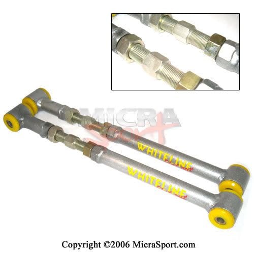

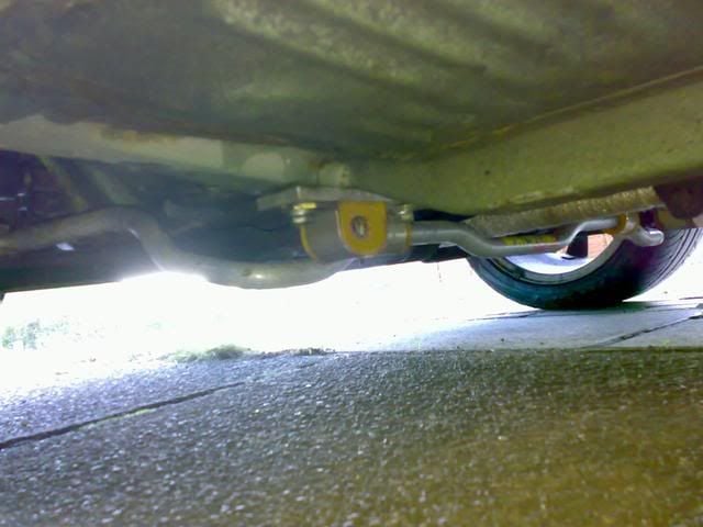

just bought these bad boys. whiteline rear trailing arms. to make it easier to fit my rear disc axle ;)
to go with my other whiteline stuff, castor/anti-lift kit, front and rear 22mm anti-roll bars (when i recieve 'em) and adjustable rear panhard rod. :D

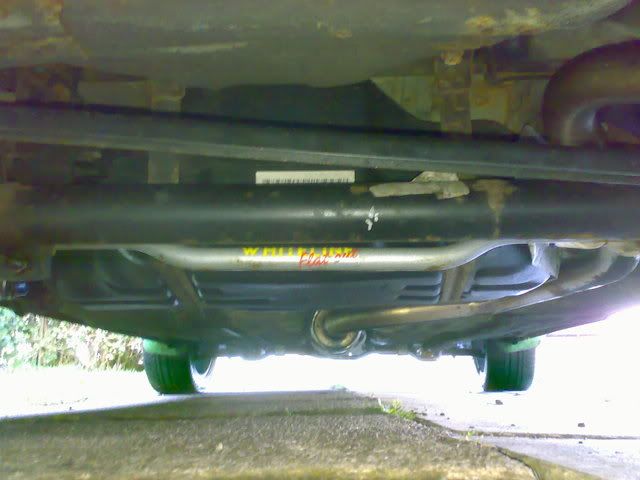

front and rear arb's are now on, i was going to get 'em sand blasted and painted black, but i couldn't wait to fit 'em.
but i've not really been able to test them as the roads are wet!!!
hoping to do a track day this year with it now, well after i sort out the n15 gti brakes and rear disc axle. it's just not the weather for an axle swap. lol
front
rear

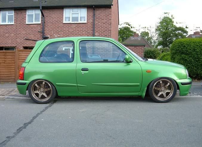

here's a quick shop i've done with the wheels. i wanted a rough idea about the style of the wheels and the colour. and i like these :). although i won't be getting volks, i will hopefully be getting the rote grids in bronze i think, as they are volk replicas.
i was also thinking about getting 195/50x15 tyres instead of the 195/45x15's that i've got on atm. just hoping to make the ride a little bit more comfier with them.

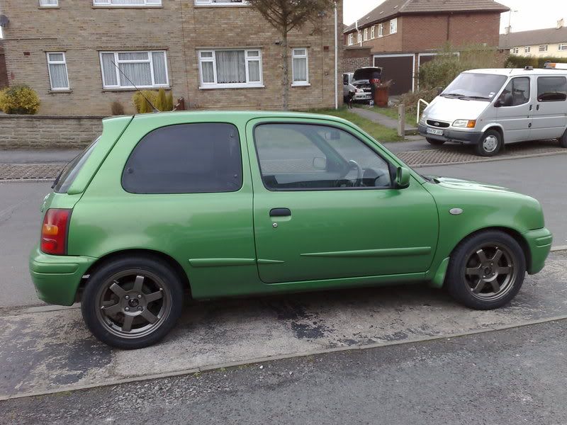

quick shop by my bro (p11sr20)

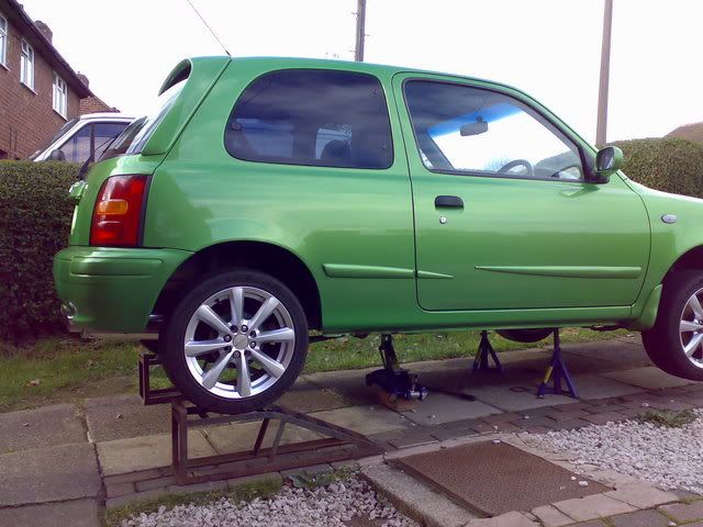

the wheels arrived thursday last week. they sent the wrong nuts first, so here's a couple of pics with the std nuts on. they now have black nuts fitted now though, just not taken any new pics.
( it normally sits lower at the rear, but it is stripped out atm ready for the next rwyb @ the pod. it was raining yesterday :( )
Look pretty good!
They were a better colour in the photoshop though..
i actually prefer the darker colour, looks less gold imo
Very! very nice Swiper! (Y) fit perfectly with the colour!!!!
is your rear window tinted?
thanks :),
no, the rear window isn't tinted, i haven't got round to it yet, i just tinted the side ones myself for the kids really, i hate them stupid suction blinds people use.
