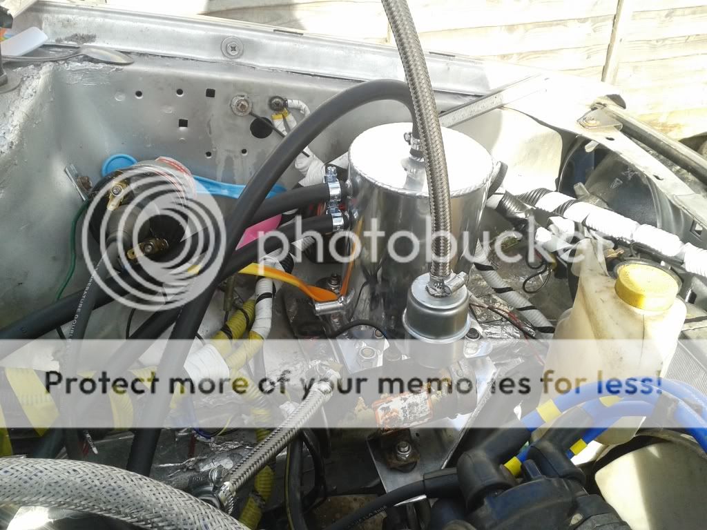

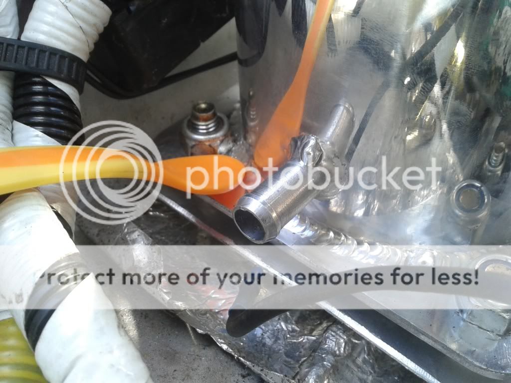

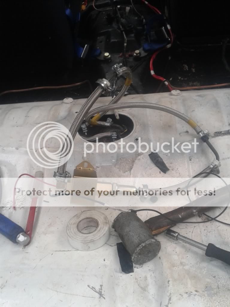

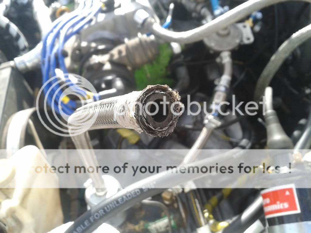

Has it got pipes going places inside? Or they just ports to the inside of the canFrom the top down
Breather
Flow from tank
Return
Flow to engine
That's the breather mateyWhat's the hole on top for.?
Just simply ports. No fancy tricks on these just a mini shiny fuel tankHas it got pipes going places inside? Or they just ports to the inside of the can
Well moo youI am less impressed haha
Sort that out and I will then respect you.Well moo you
The moo'ing or the swirl potSort that out and I will then respect you.
Your lifeThe moo'ing or the swirl pot
I'll get my swirl pot in firstYour life

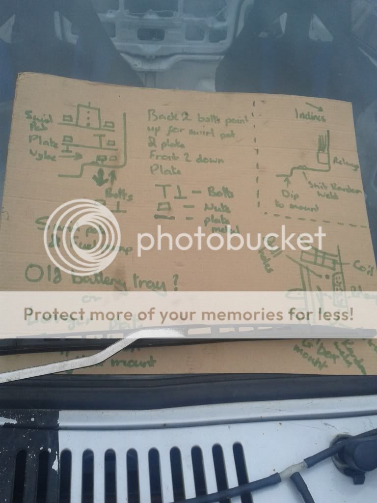

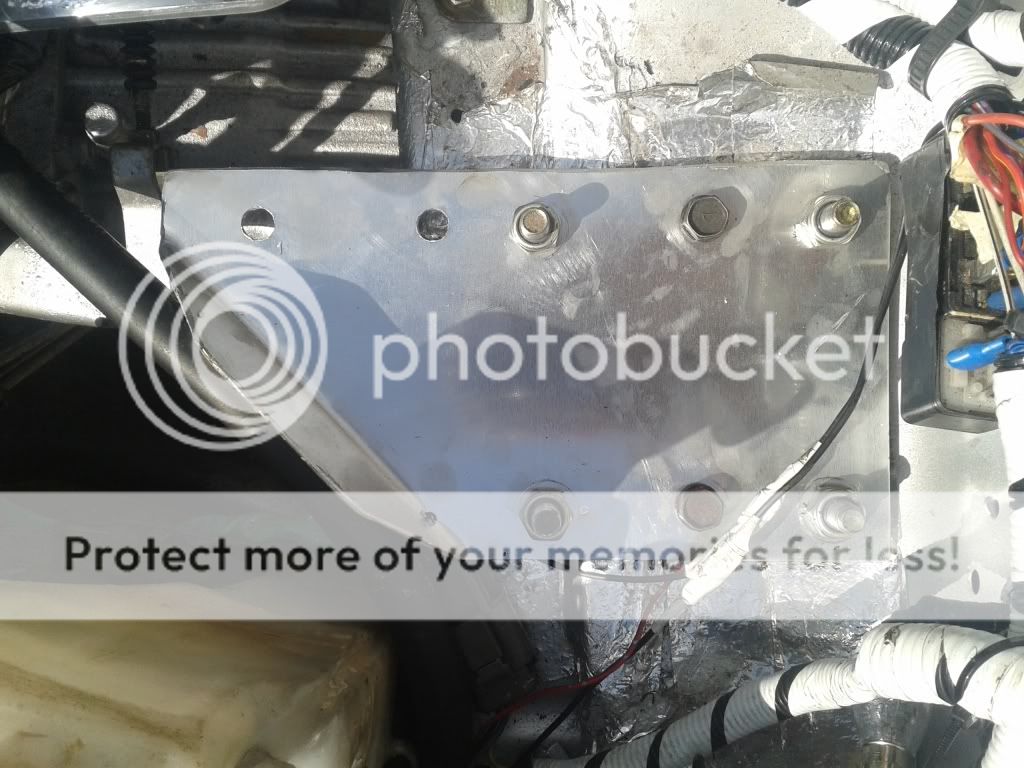

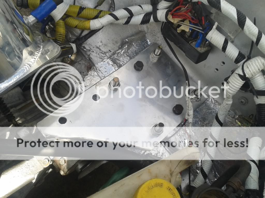

Thanks Ade that's what I was struggling with earlier. Then finally worked out that plate after taking 5 mins out to thinkLooking good Andy

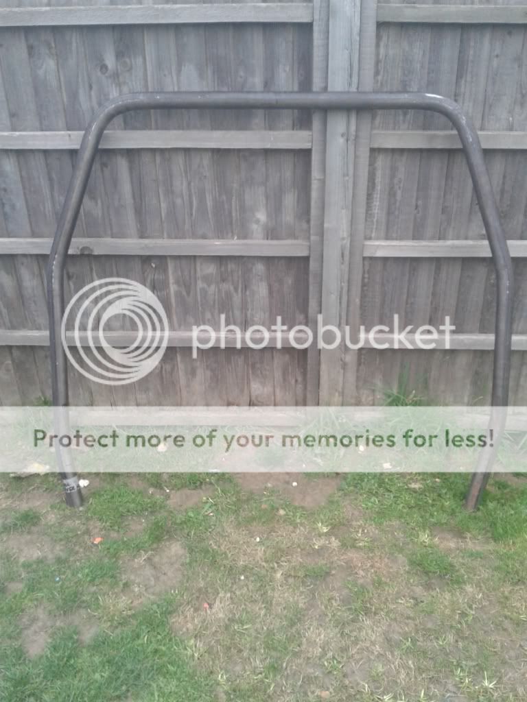

I thought the same. Thought I'd need em mandrel bent. But regs allow some ovalising so I went for it and that's the resultYeah, Iv seen them, I was just under the impression that they mess the pipe up. looks like it has done a good job to me Nice one!
Its about choosing senaible wall thicknesses and bend radiuses ehI thought the same. Thought I'd need em mandrel bent. Butvregs allow some ovalising so I went for it and that's the result
Absolutely that's a 2.5mm wall. Of course despite wall thickness you can still deform it with the bender incorrectly setupIts about choosing senaible wall thicknesses and bend radiuses eh
Aye. Cowboy cage builders put people's lives at risk.. This upsets meIts all about choosing the right professional to send it to lol
