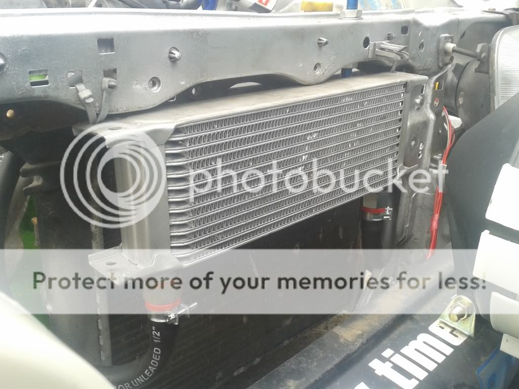

Next update.. Oil cooler

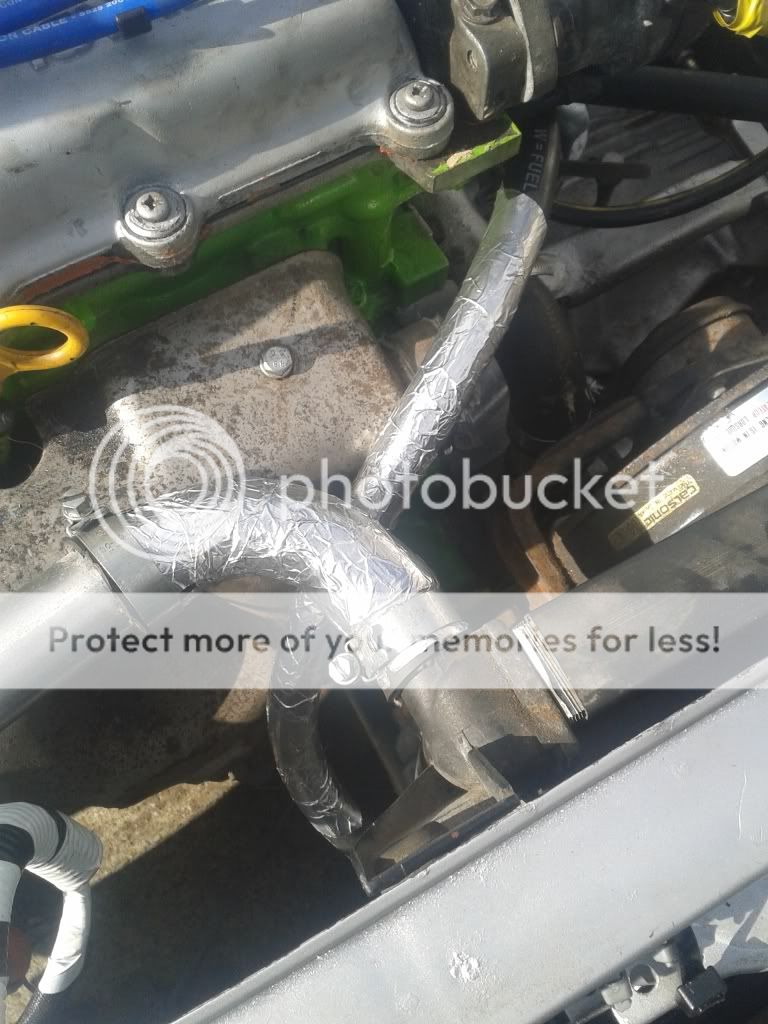

Had a fight with my pipework but got em on
It sat here comfortably. And didnt move much so cable tied it on and its sturdy
Heat wrapped the pipe near the exhaust

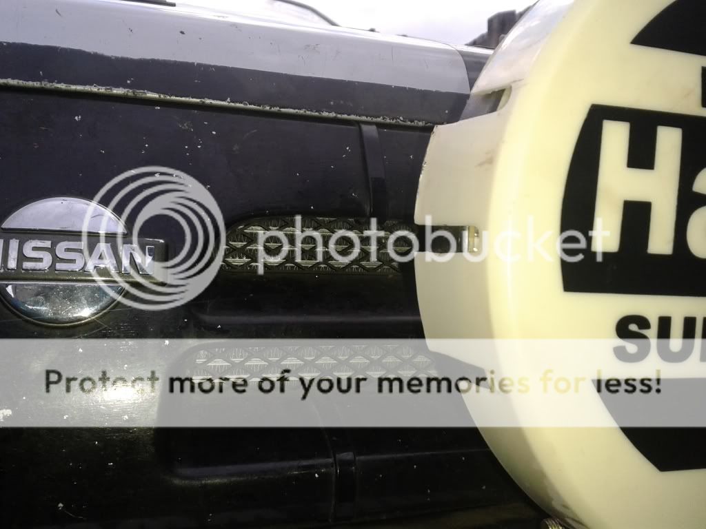

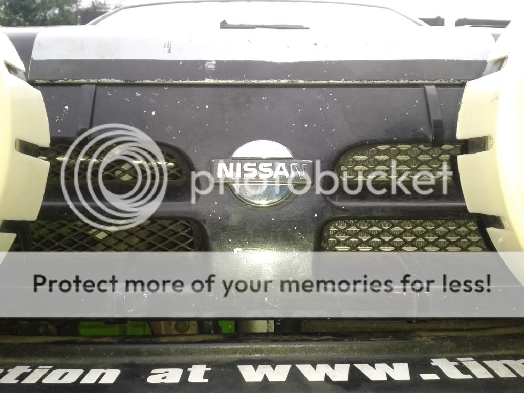

Replaced grill

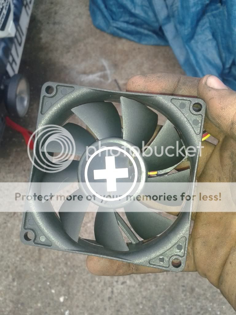

Bought 2 of these too, to mount behind it
Haven't fitted em yet. Making an ally mount... or cable ties. We'll see

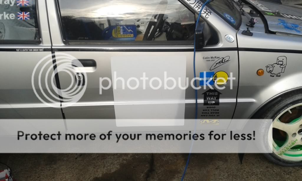

Then stuck new stickers on :)
Coz I'm part of the crew ;)
Competition number square

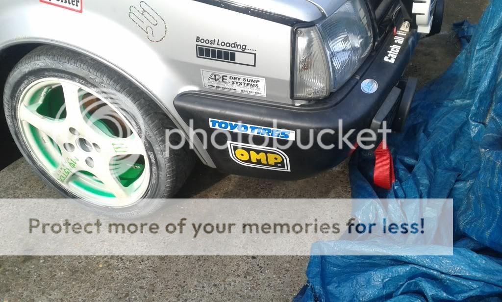

Finally replaced my old Time Attack set too.. for my own personal ones

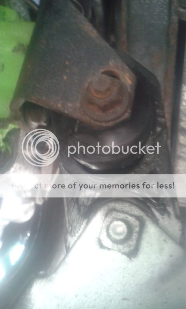

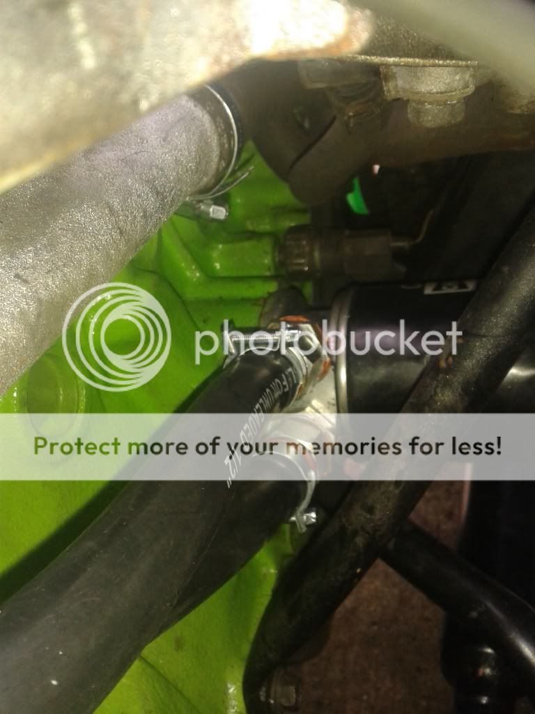

I polybushed my front and rear mounts but forgot to take pics. So I had to dive under and get this one... with grease on my camera lens

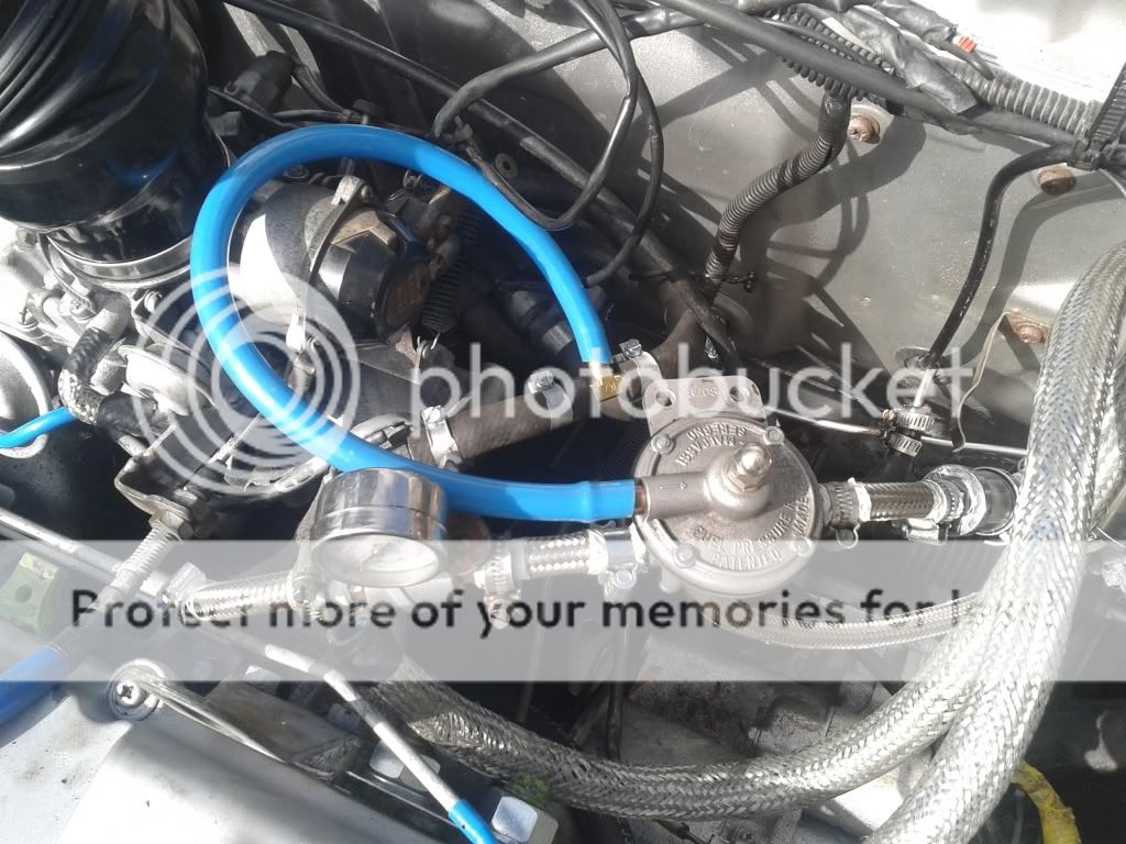

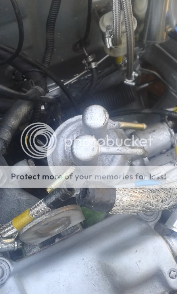

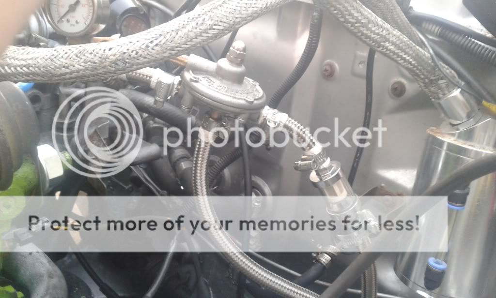

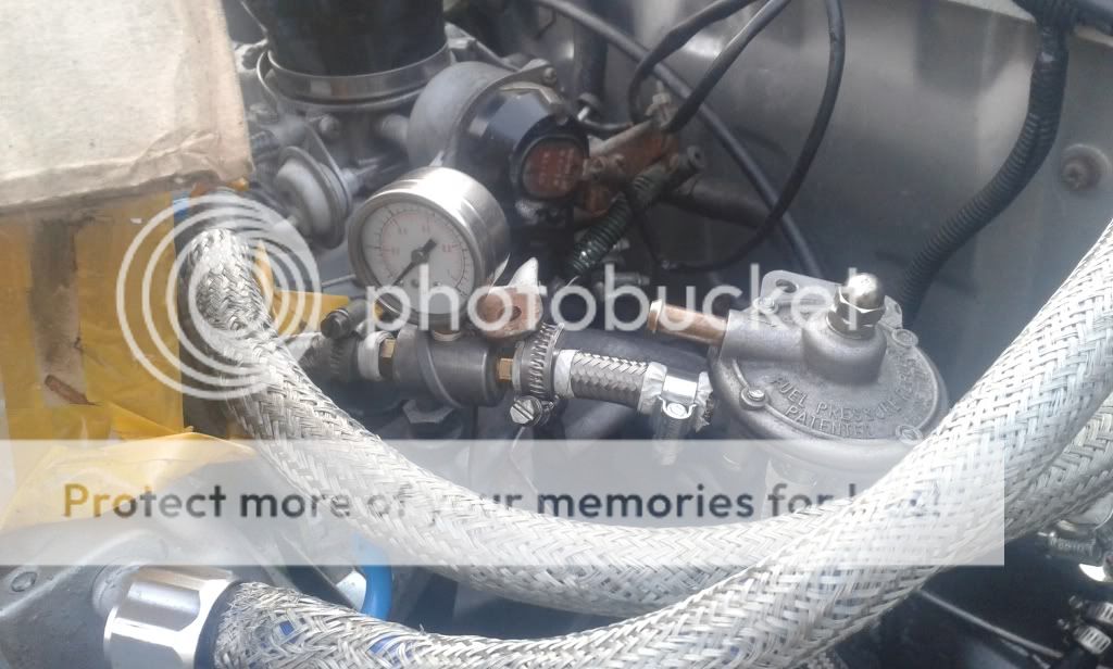

Removed the mech pump today and stuck the regulator etc in place
Mech pump
Replaced with steel ;)
So I went on to put the regulator in place. Not happy with it but it'll do till my swirl pot turns up
When I can be bothered to make a manifold :p

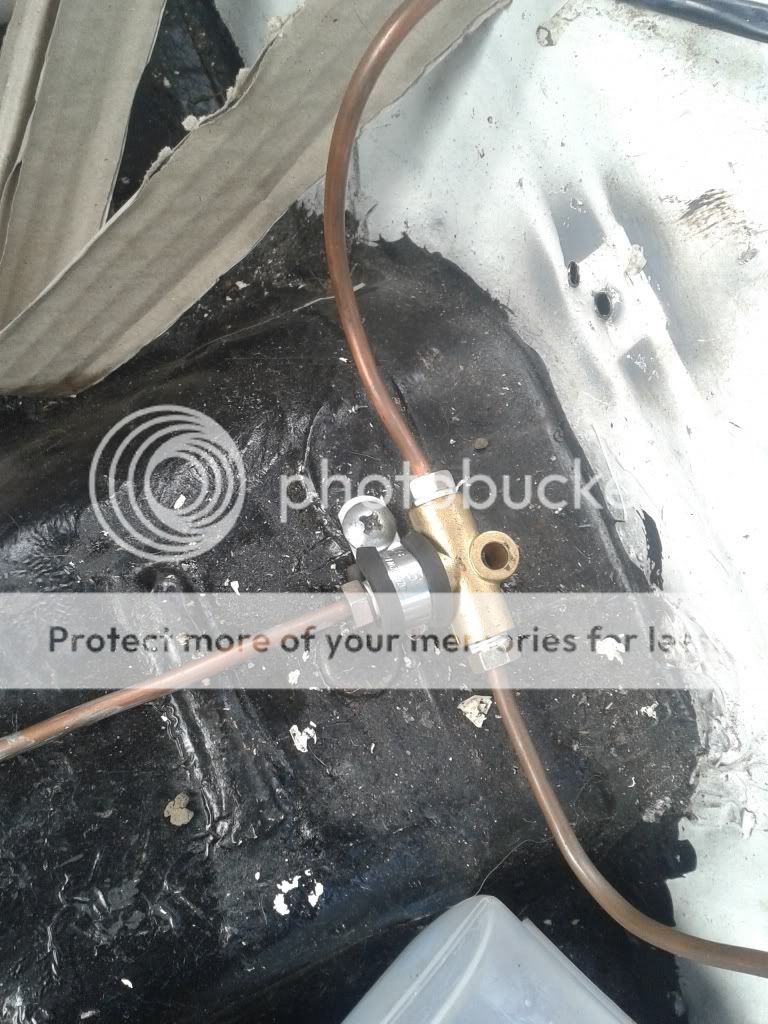

-Made bracket for bias valve
-Put vibration dampers on brake pipes
-Finally changed my brake pipe join for a midway bleed point

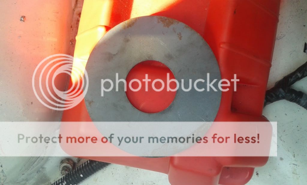

-Made strut strengthening plates

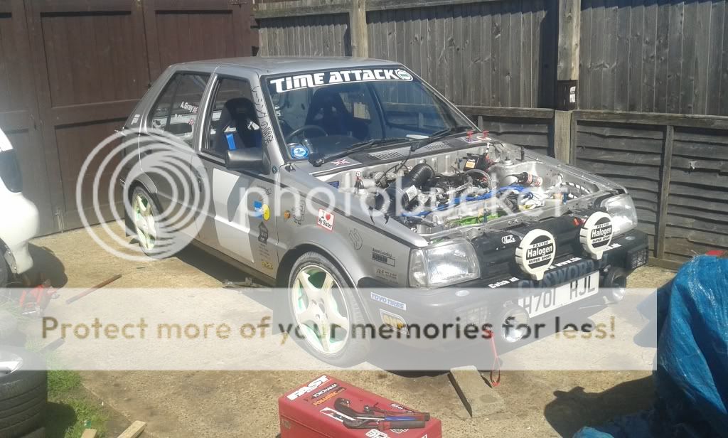

New track rod ends :) and an overview of my setup
Brake pipes fixed
Yes brake fluid stripped my paint off when I changed the fitting to a hose
Using spare hose to protect the pipe

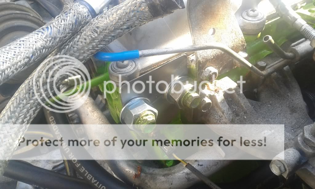

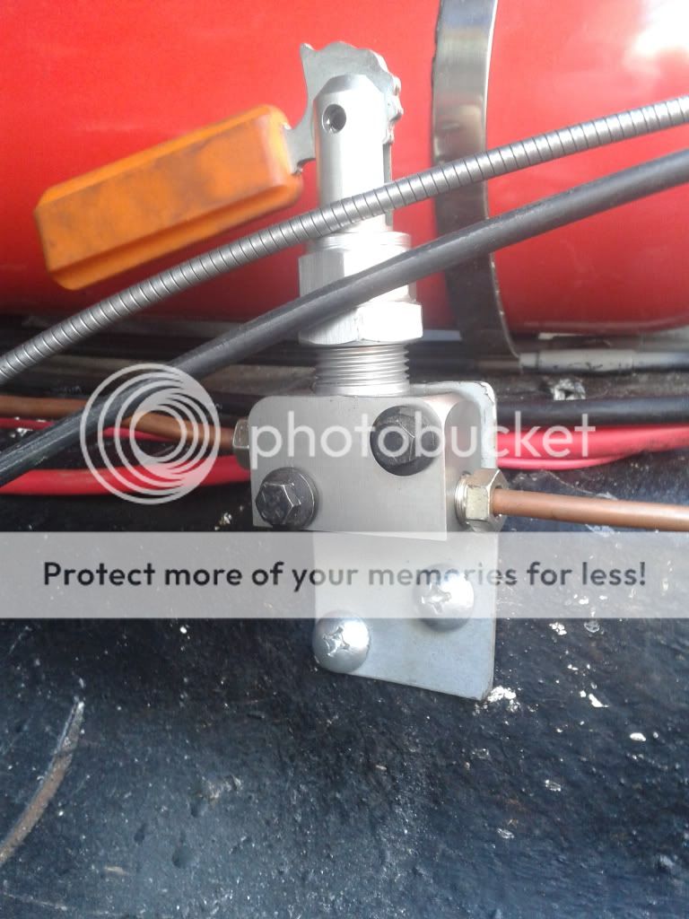

Bias valve bracket
T'd into a suitable vacuum for the regulator.. still no bloody swirl pot

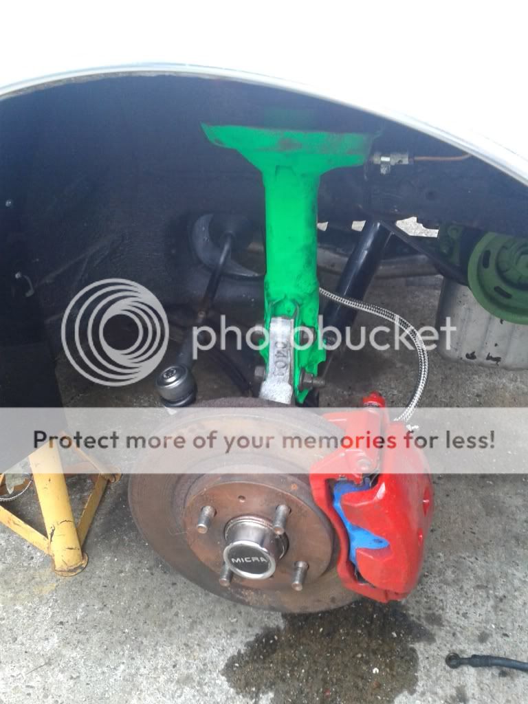

Steel discs to strengthen strut tops
