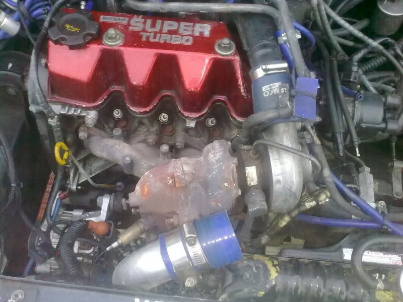

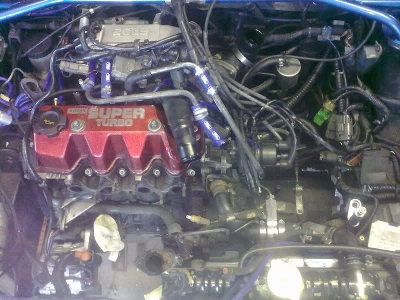

Well I've decided to make a start on this , turbo has been sent to Turbo Technics today to be rebuilt as there is nearly 100k miles on it roughly I think.Exhaust housing is cracked to ####. Allot of play in the shaft.
So should hear back from them next week.
Other plans are recondition the head,valve seals, seats , clean up ports etc
And also a set of piston rings. I will inspect the main and rod bearing for wear but they should be fine.I am going to modify the oil pump for more pressure also

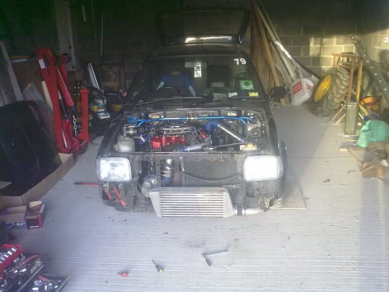

Here's is a few pictures of o the work so far

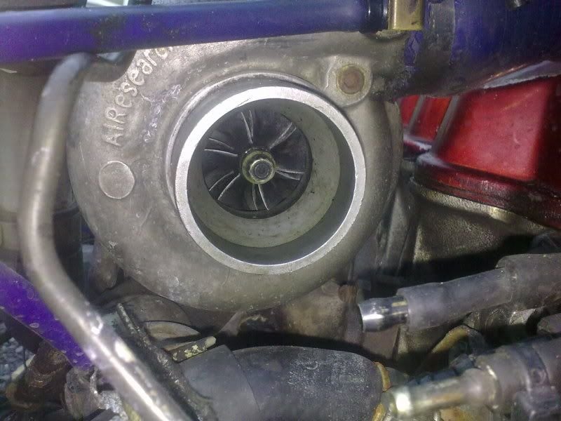

So I got a call from turbo technics with a full report on the turbo.:mad) Compressor wheel has foriegn object damage i reckon from rubbing against the compressor housing, journal bearings worn,competition 360deg trust bearing worn, piston ring(oil seal) groves worn, wastegate hole cracked and a broken stud,that will have to have a few hours machine work done on it, so basically a full rebuild plus a new compressor wheel and shaft. Price is mad but I need to get it done , I reckon there is about 100k miles if not more on that turbo, it was built by them back in 2002 I bought in 2007 .

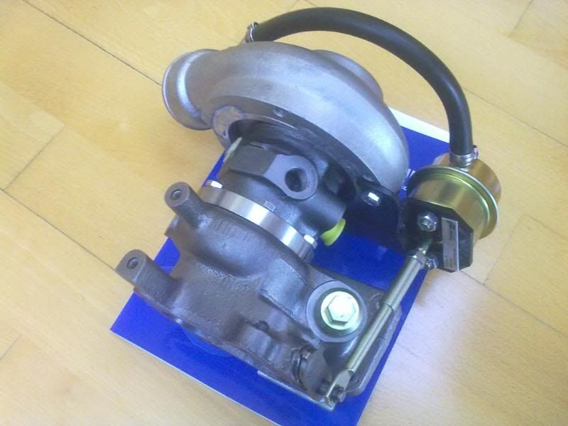

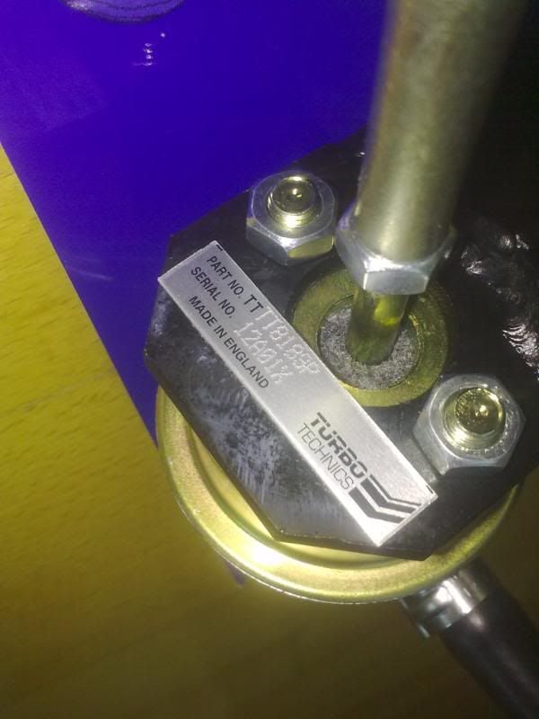

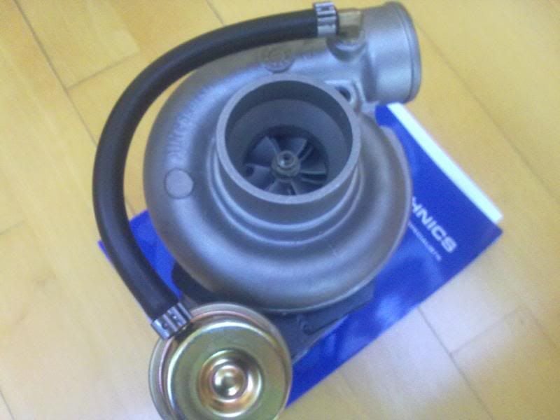

This box arrived this morning, very impressed with it, basically a new turbo:D

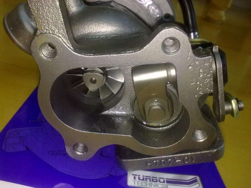

They had to use a Ht07 Exhaust housing which they failed to mention so I phoned them and they said they machined the housing to fit. Im not so sure the downpipe will even fit. My Ht10 housing was beyond repair

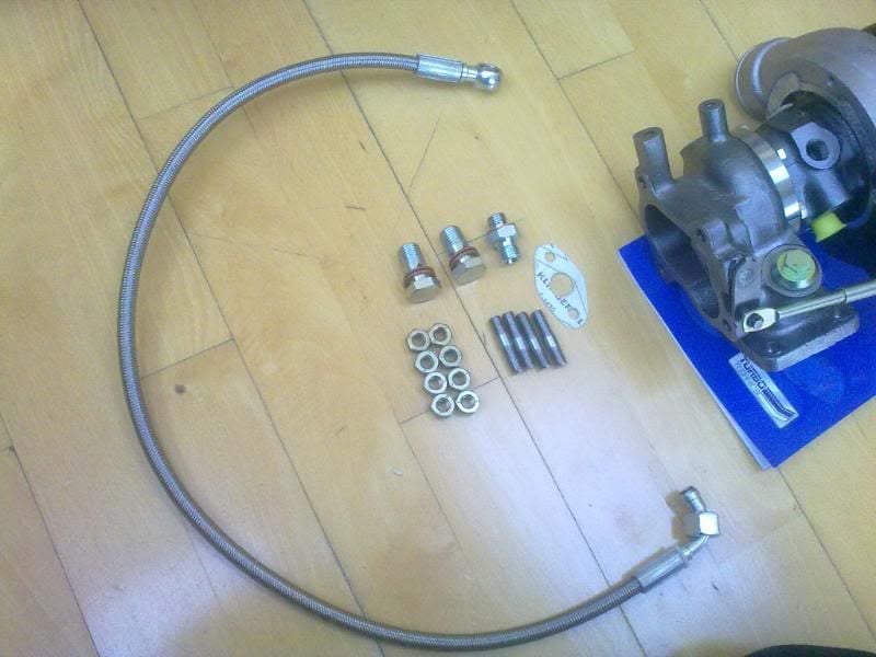

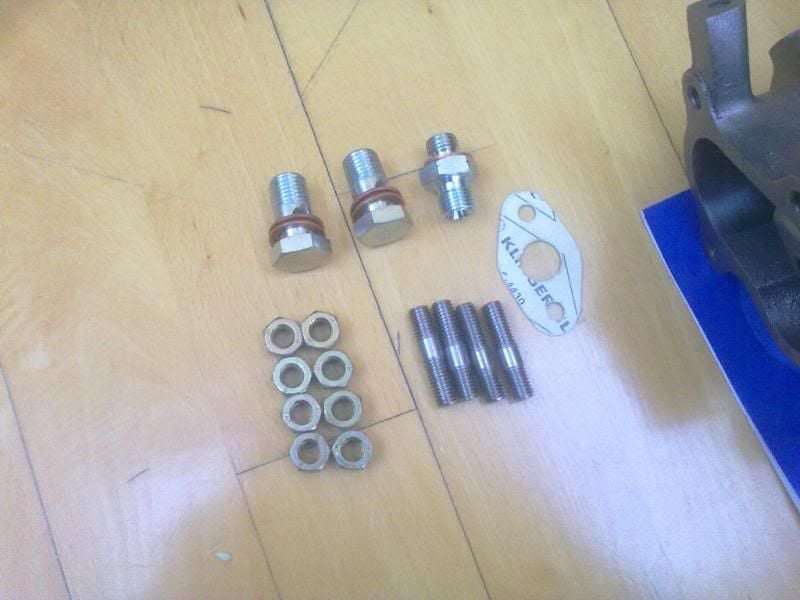

New studs, nuts, water and oil feed, copper washers and oil return gasket
HT07 and HT10 should be the same. Same spec as before?
Exhaust housing smaller from the outside for definite but he assured me the internal dimensions are the same.
Same spec as before although looks like more modern parts used or maybe just that its very shiney:laugh:
look like a nice complete job and kit. the external housing size only matters in terms if whether it bolts up OK, and if necessary new flanges for exhaust manifold and dump pipe are readily available (just cut and re-weld the flange)
Nice one man thanks
Sweeeeet.Looks like a brand new hybrid.
Basically is bar the tubine wheel and compressor cover:laugh:

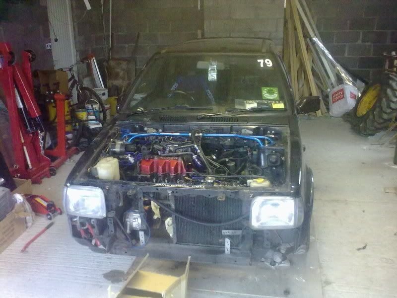

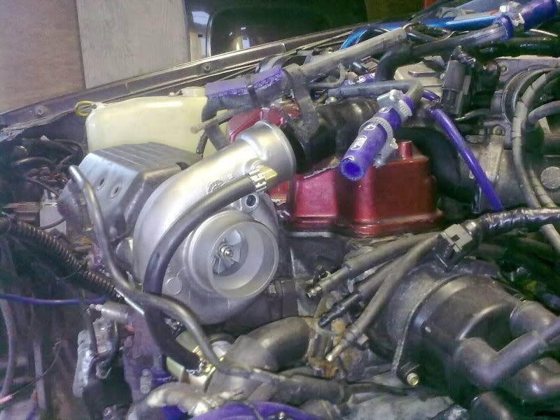

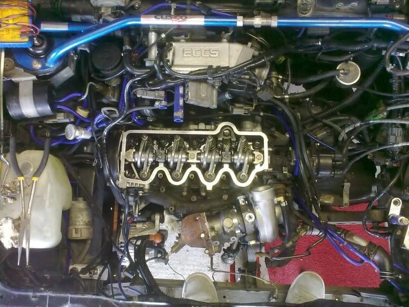

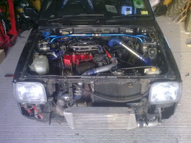

Small update, Ive refitted the turbo and cleaned underneath the rocker cover as looked sorry for itself. I have bought a head gasket kit aswell just incase it is actually gone.

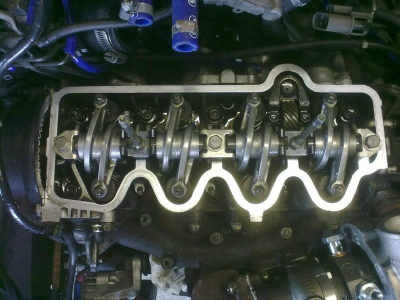

So I had a bit of a bad feeling leaving the engine untouched so I removed the head and found the gasket to be leaking slightly and cracks across the plugs hole to the valve seats so got it pressure tested and it for the bin unfortunetely:(
Luckily I have found one so Ive dropped that in to get skimmed , new valve seals and the seats recut, should have it back Friday. I also bought 2 sparco fixed bucket seats for the car as I will only be using it on track from now on really

If I look to your photo's it seems the upper cylinder gasket (the one with valves init, don't know what you guys call it since I'm from Belgium ^^) looks strangly familiar with the normal K10, I thought the MA09ERT had a direct injection system with injectors on top, but I can't see them anywhere? What are ur future plans with car (about upgrades etc)?
