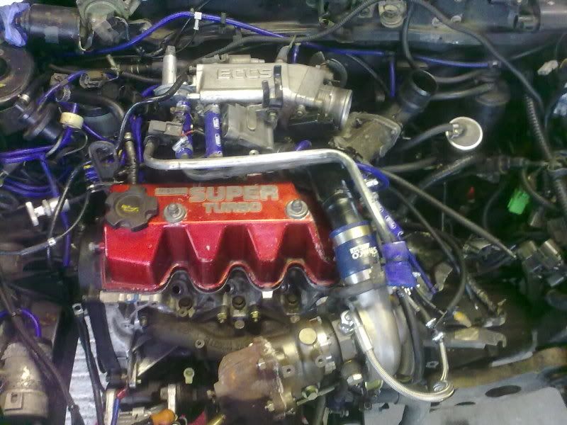

The 4 fuel injectors are underneath the ECCS part of the inlet manifold.No huge plans for it really at the moment, focusing on getting it ready for a few track days, may address the cooling system with a better radiator and tidy some un needed bends in the boost pipework.

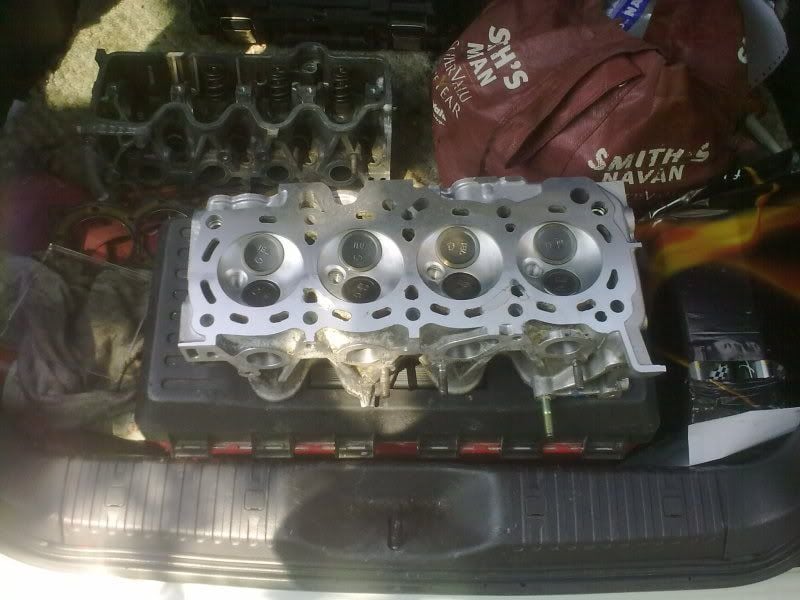

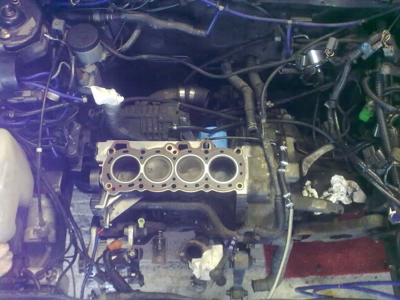

Well its a good thing I removed the head of my engine. It was cracked , and I mean seriously cracked, its a miricle the car actually ran before and did trackdays lol.
Anyway I had an old head that I had stored annd forgot about, I got a full recon job done on this , light skim ( to keep compression ratio low as possible ) new valve seals, seats cut etc. I cannot wait to hear this run again

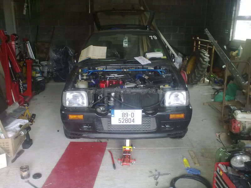

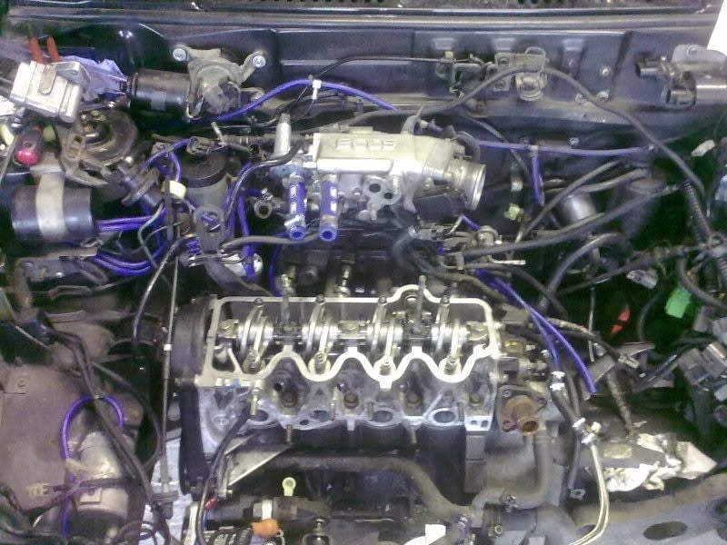

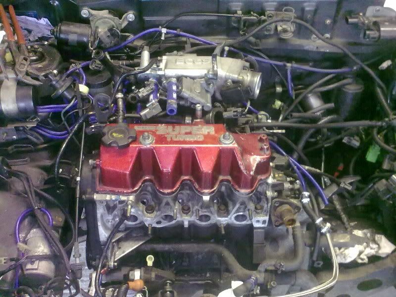

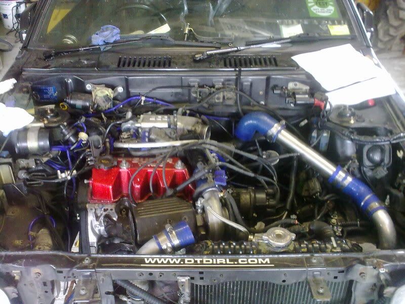

Got some time this weekend to cross the other side on the country to work on the car.I got alot done ,I fitted reconditioned head ( new valve seals, valve seats recut,light skim).Got the timing belt in, valve clearances set, inlet and exhaust manifolds on with new turbo, intercooler refitted and piped, air box in also .Nearly ready to fire it up I just have to chase down my vacuum pipe diagram, fill it with fresh oil and coolant and modify the seat rails for the new seats.
Headgasket
New cylinder head
Shame to fit a filthy rocker cover

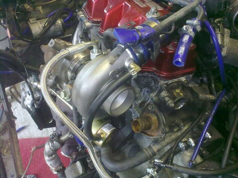

New turbo

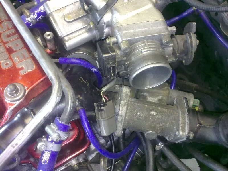

Bypass valve the controler the change over between super charger and turbo
Some boost pipes in position
maybe mate spend some money on exhaust manifold rather than this turbo and new inter cooler pipes in better shape and position. wish you will get the best of it
Well the turbo needed to be reconditioned so thats where I spent the money, It would cost 600-700 euro to get a manifold made and I just dont have it. I agree though a manifold and maybe a full new exhaust from the turbo back would make some job of it
i just propsed it to you baz because u love this car, it runs great and with that love and money you can make it even better. hope in future u will upgrade it. my manifold cost 550€ and turbo (wrong digit sorry)680€ brand new. consider as your next step. nice work keep it up! will u run on factory boost?

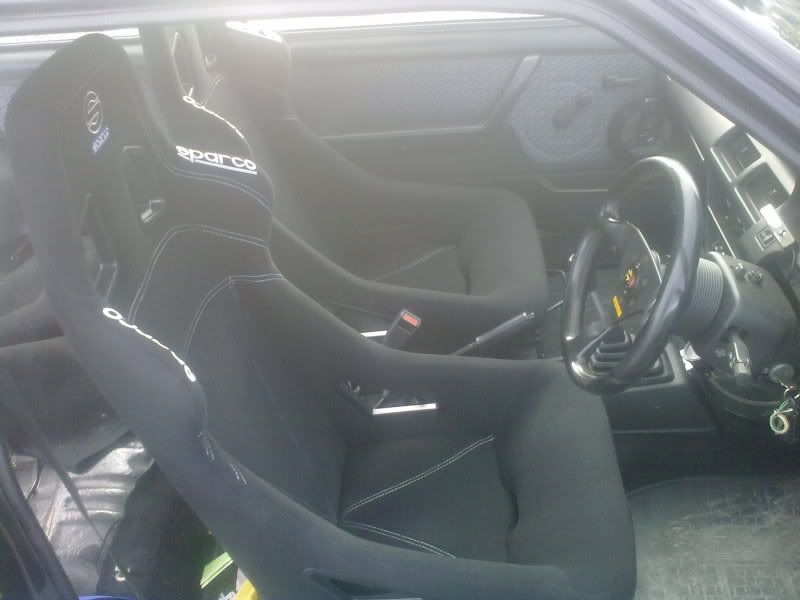

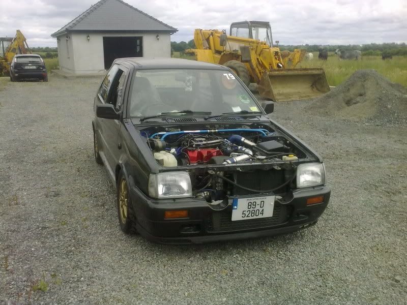

Fabricated rails for the seats
And after a spin:)
