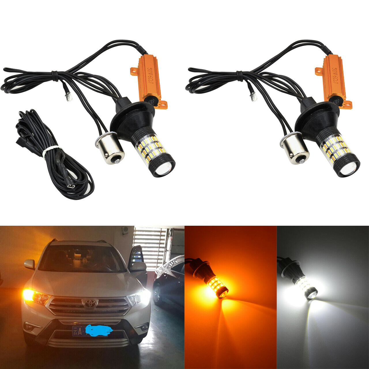

Just an idea for DRL to front original white turn signals => Mika's Micra K12 DRL's, was done similar to this eBay => 2X P21W 1156 BA15S White & Amber Car LED DRL Turn Signal Switchback Light Bulbs.
I cut socket off from this kit, because it doesn't fit to Micra's wire harness plug and connected red and black wires with connectors to turn signal wires of Micra wire harness.
White wire to constant 12V supply when ignition is on. My case to headlight marker light bulb wire via relay.
Here in the Land of the Finns we have law, some kind of lights on 24/7.
Here in the UK road users do not require these but from my understanding these can get you a discount for insurance probably not worth the effort for this purpose but they are great in that people can see you more easy.
About 1 or less in 10 run these I am interested to try them out the only problem is they look like they have drivers to cable tie in and this could become messy or confusing as an install.
I personally would like DTL preferably installed in the headlights.
The indicator DTL does look good though.
Out of interest how bright are they?
Or are they just illumination and not projected.
Sent from my ASUS_T00P using Micra Sports Club mobile app
About brightness, see this video => Mika's Micra K12 DRL's they are bright enough to pass Finnish MOT.
If you mean brightness of spot lights, I don't know yet...
The indicators do look quite bright I was asking because on our corsa they light up the fence at fee feet away as though they are headlights its great for low light conditions here in the UK such as fog because it can help us to be seen more easy on certain days and while fog isn't an everyday thing heavy rain can be.
Thus car also could do with decent set of fog lights as the bumper has the fog blanks and that makes life more easy for an install.
I heard that the LED main fogs however are not so great they need to be halogen as these prevent a build up in really cold conditions.
