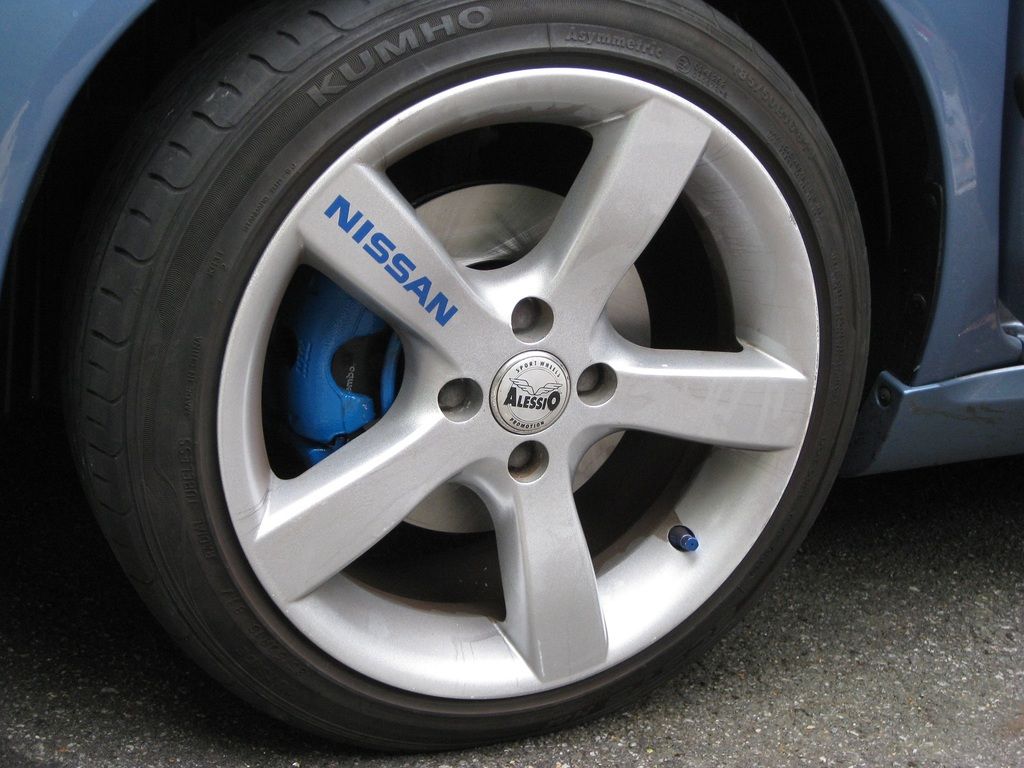

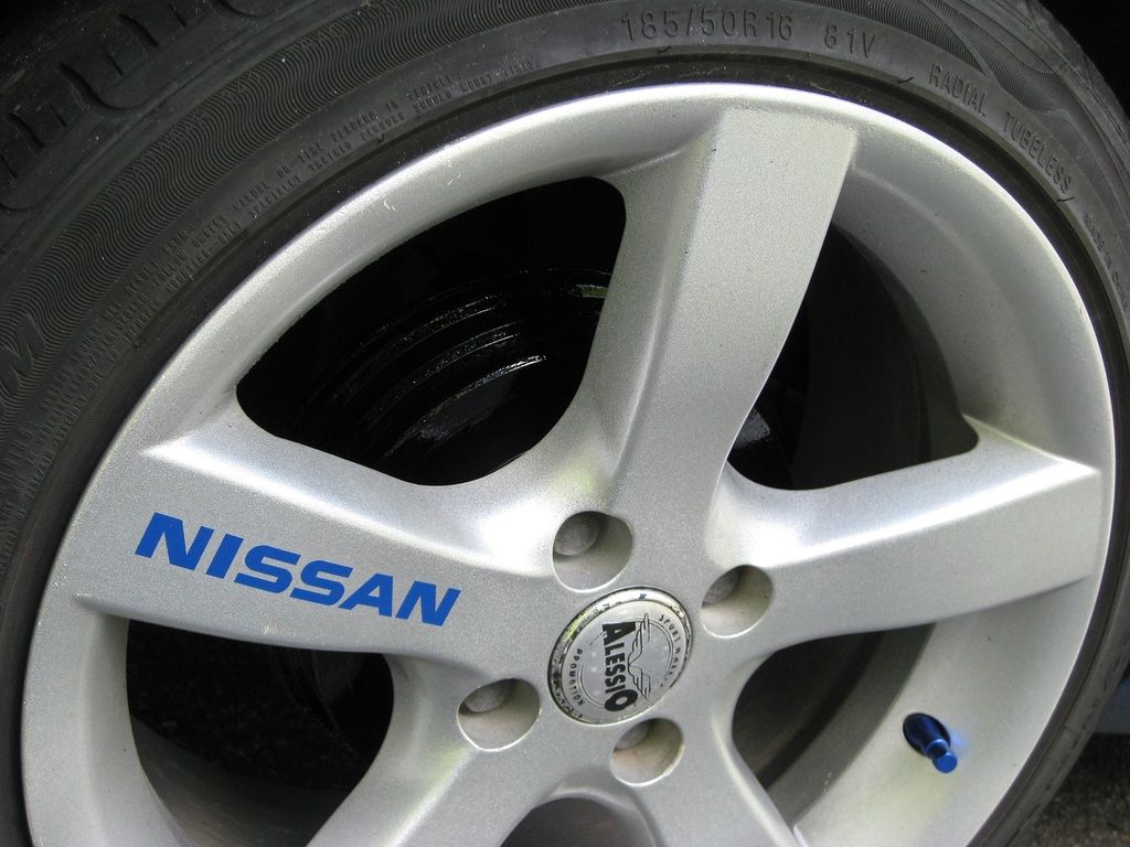

Done, brown ugly round thing is camouflaged. I added blue 'NISSAN' decals at same time.

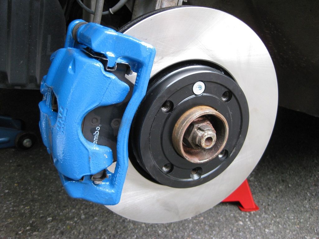

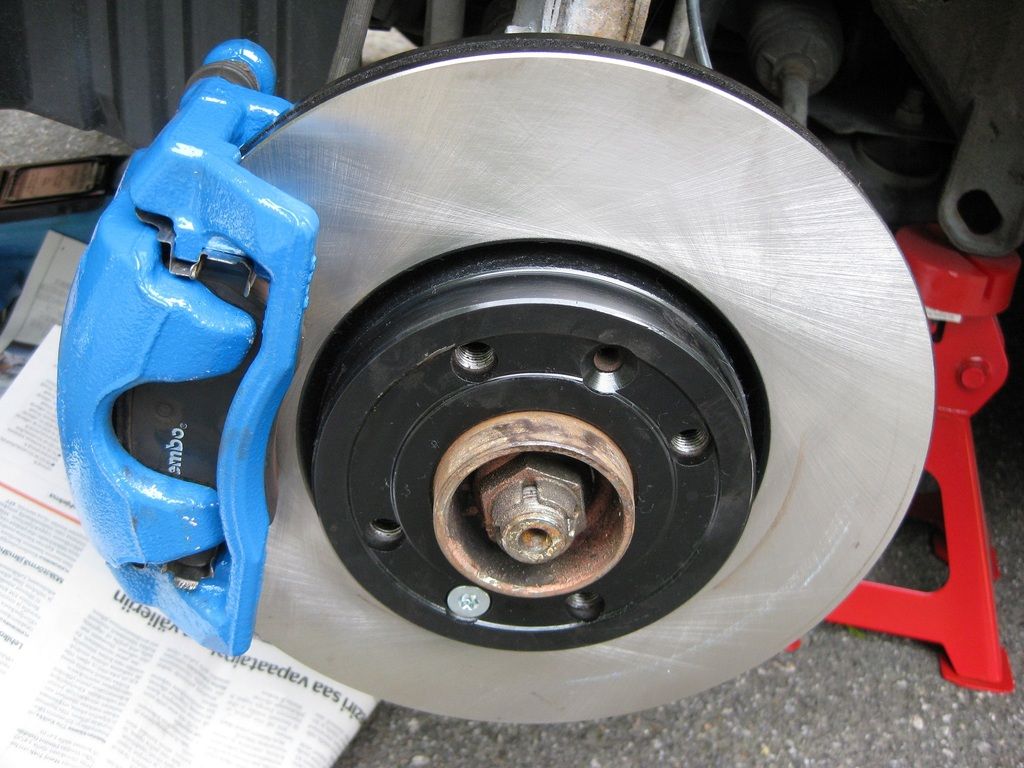

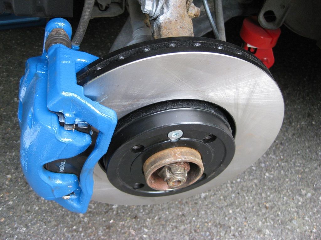

And front calibers:
"Front calibers done, ducking cool! :cool:
Changed new discs and brake pads at same time, disches were worn under tolerance thickness. Discs were ordered with black paint from Germany.
