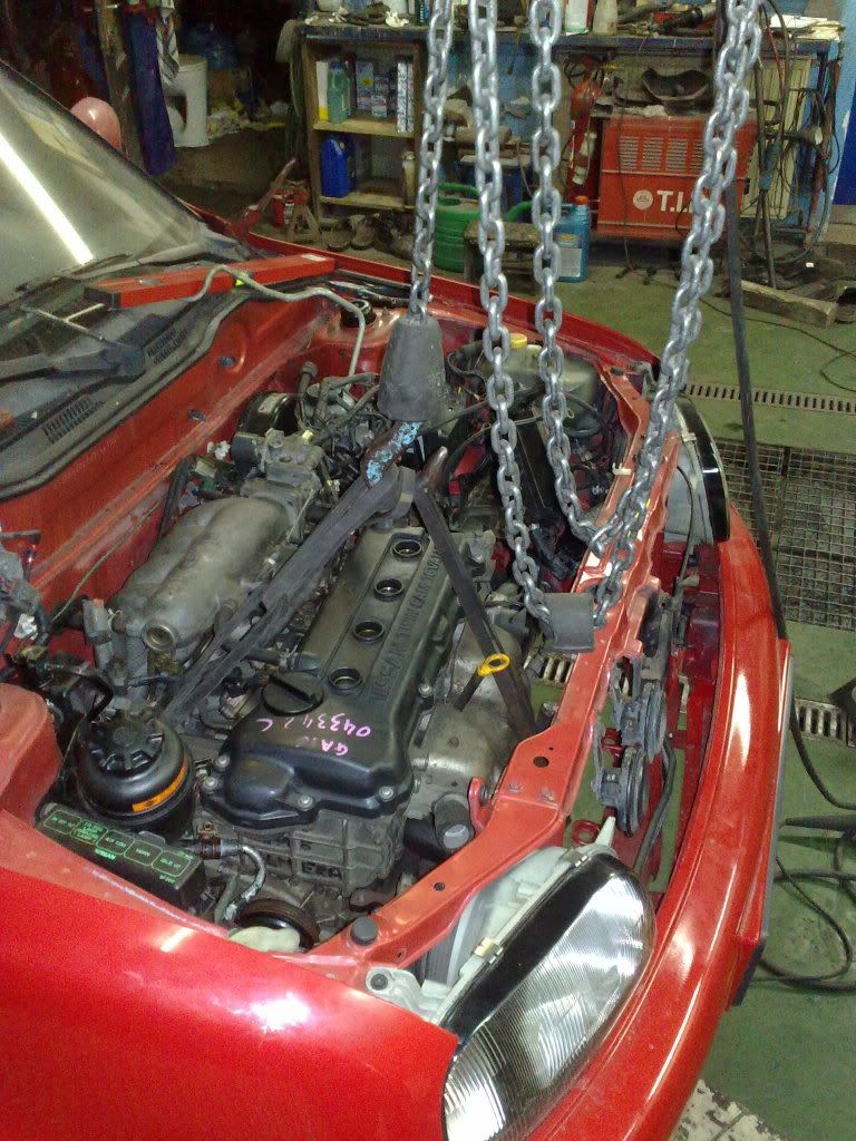

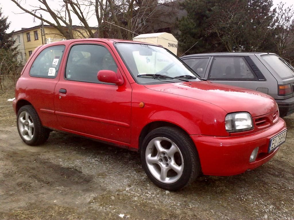

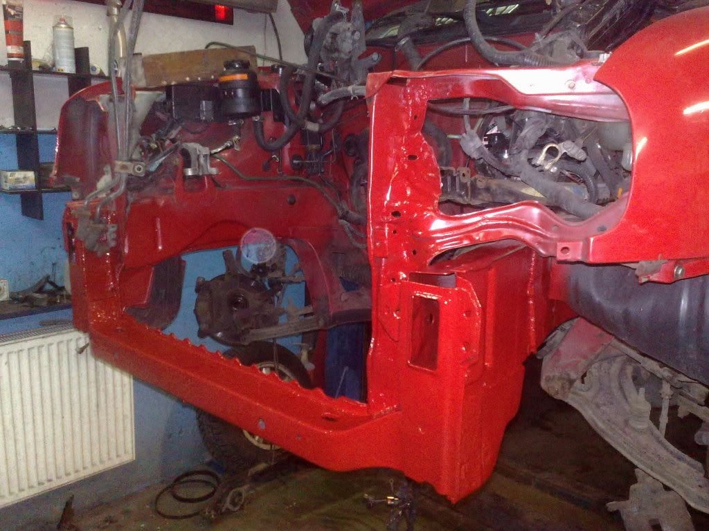

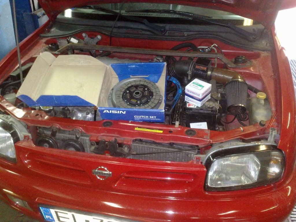

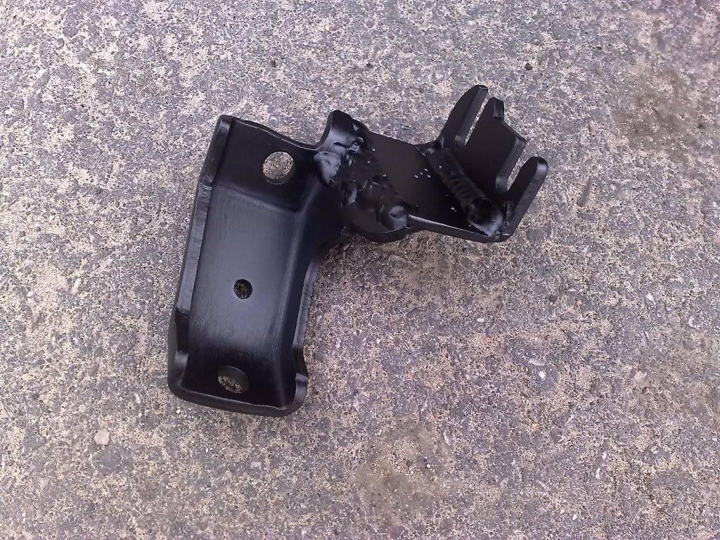

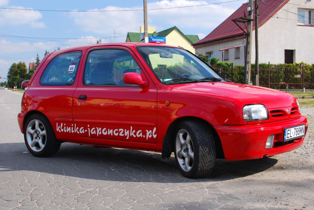

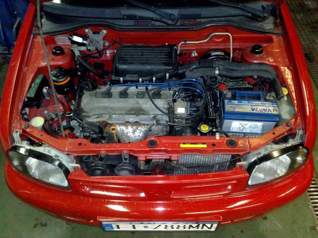

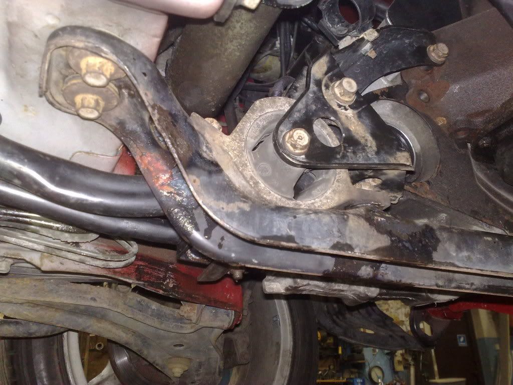

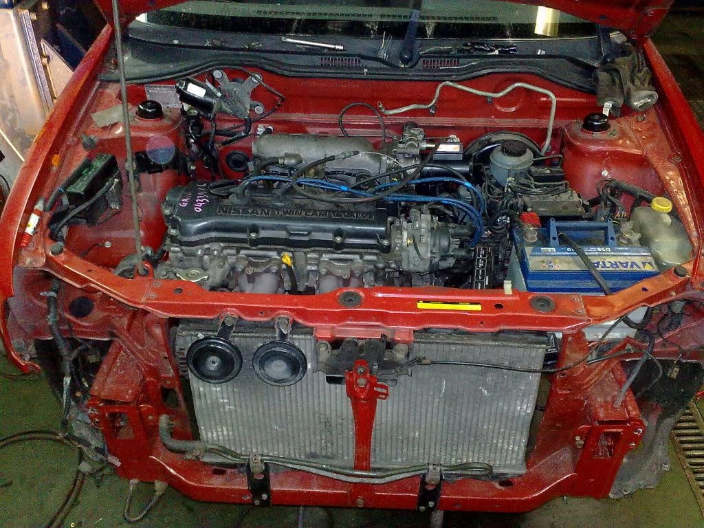

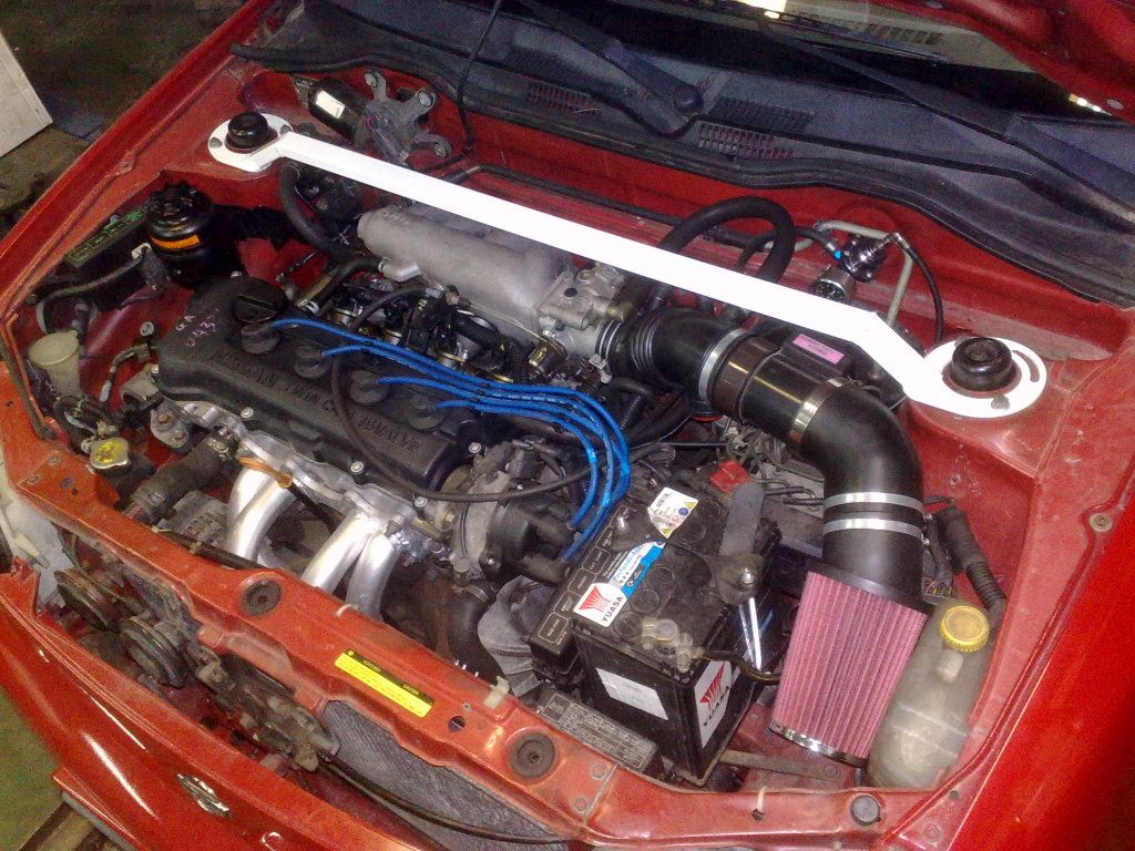

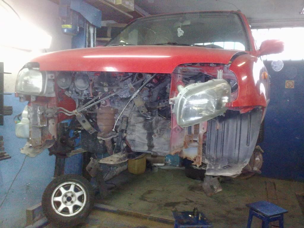

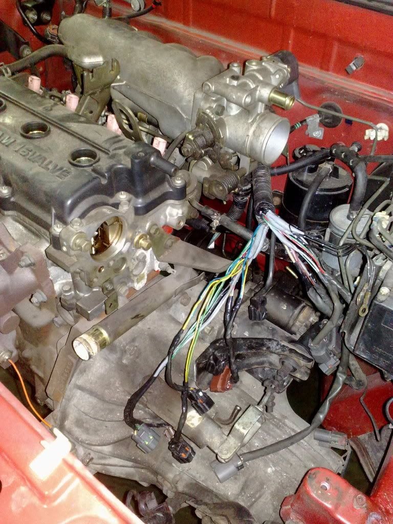

engine cushions are mounted in other locations. Beam under the engine is adapted to GA16. Throttle body is from Maxima QX 3.0. Hmm, you have a full description

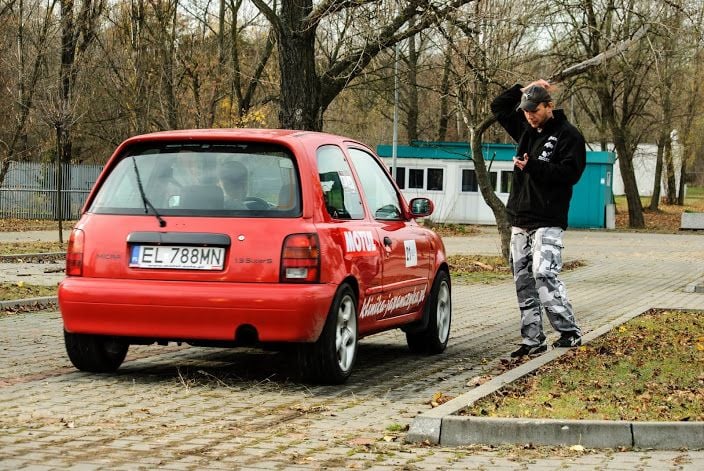

pics are actual, and holes are in the left side on bumper to install fender flares - wheel arch

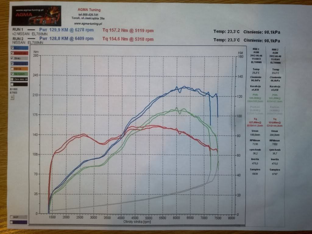

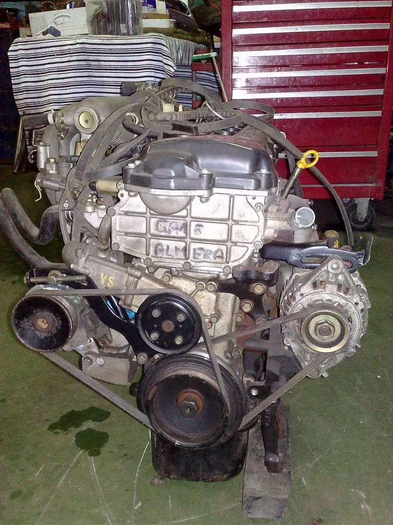

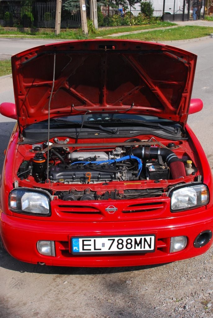

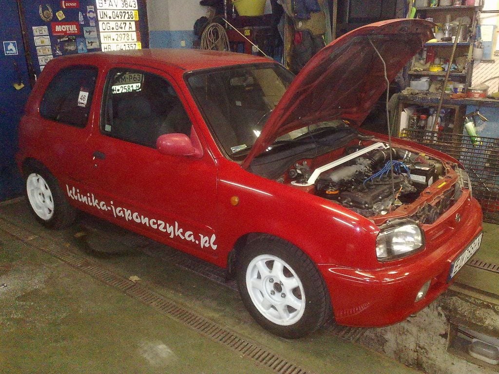

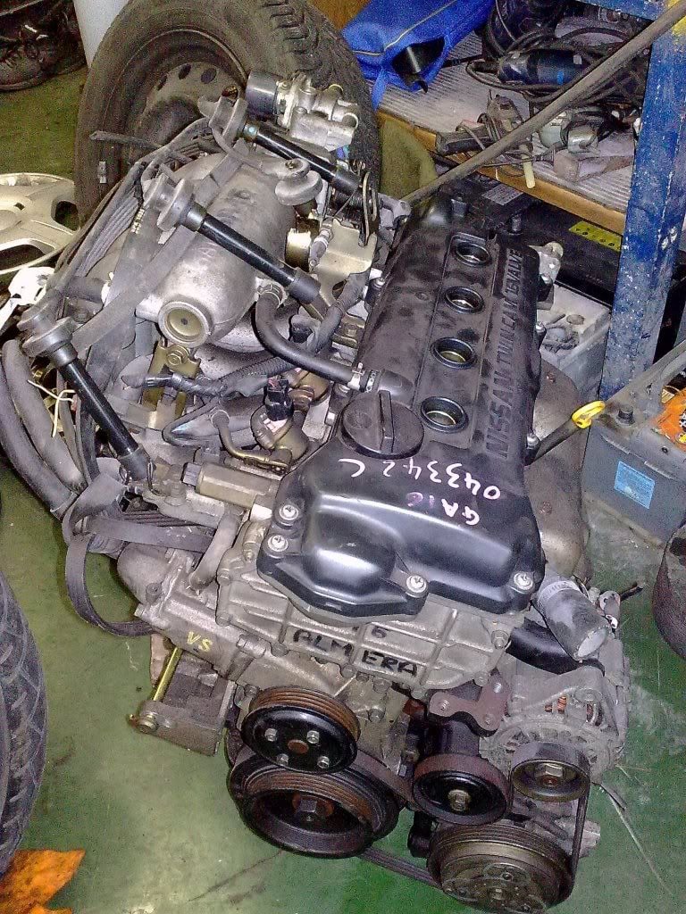

ENGINE: GA16DNE NVCS
POWER: 135HP 165NM

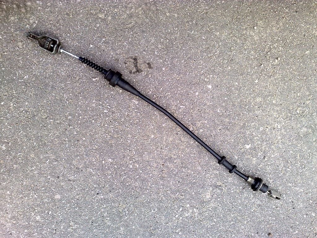

TRANSMISSION :

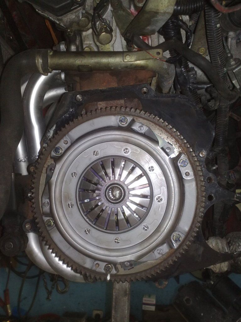

- manual transmission from CG13
- lightweight flywheel
- Aisin- clutch

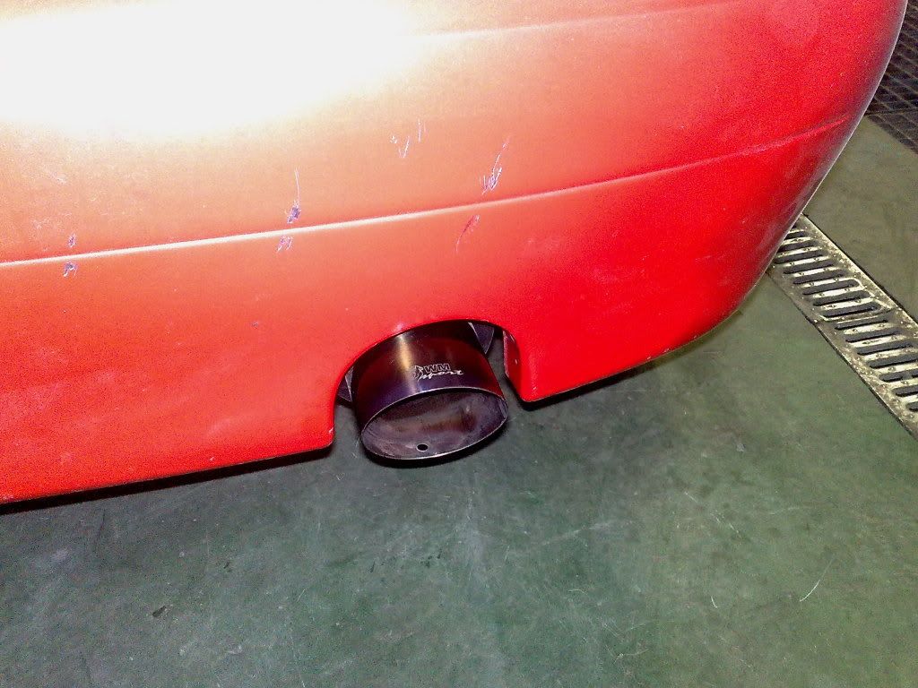

EXHAUST SYSTEM :
- collector 4-2-1 with 2 " output
- The rest of the exhaust 2 " based on two silencers

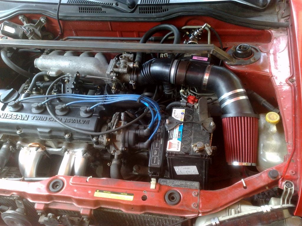

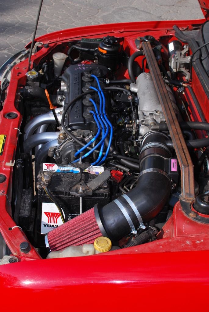

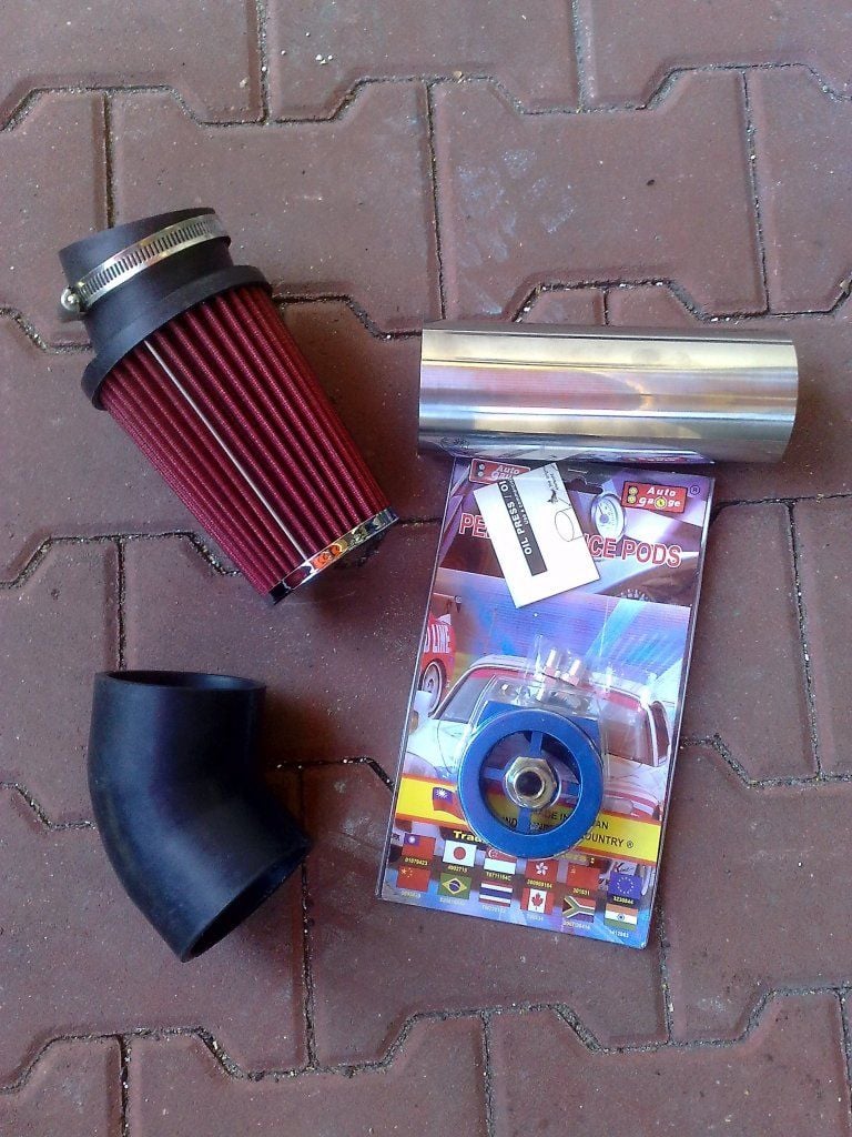

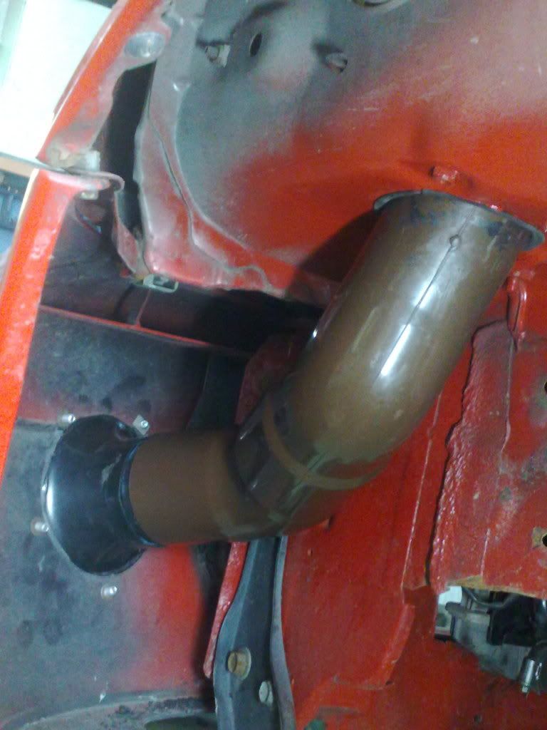

INTAKE :
- 60mm throttle VQ30DE Maxima
- maf sensor from VQ30DE Maxima

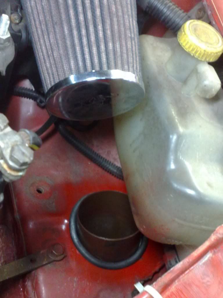

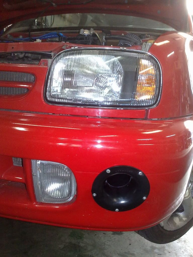

- a custom intake with large filter
- CAI - bringing cold air from the bumper directly on the filter
IGNITION :

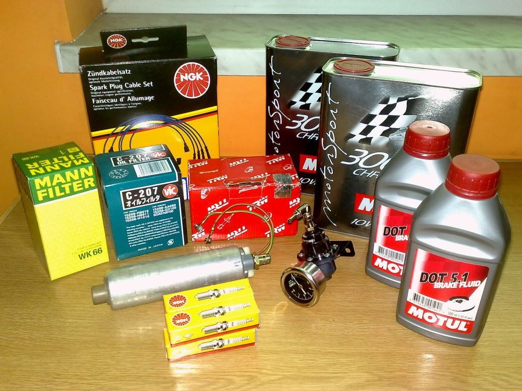

- plugs NGK
- NGK spark plug wires
FUEL SYSTEM :
- 260cc injectors VQ30DE Maxima
- fuel pressure regulator Tomei
COOLING SYSTEM :
- large cooler from primera SR20 + Suzuki fan

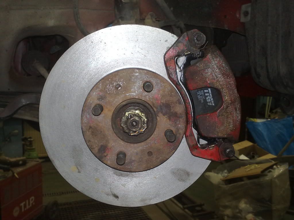

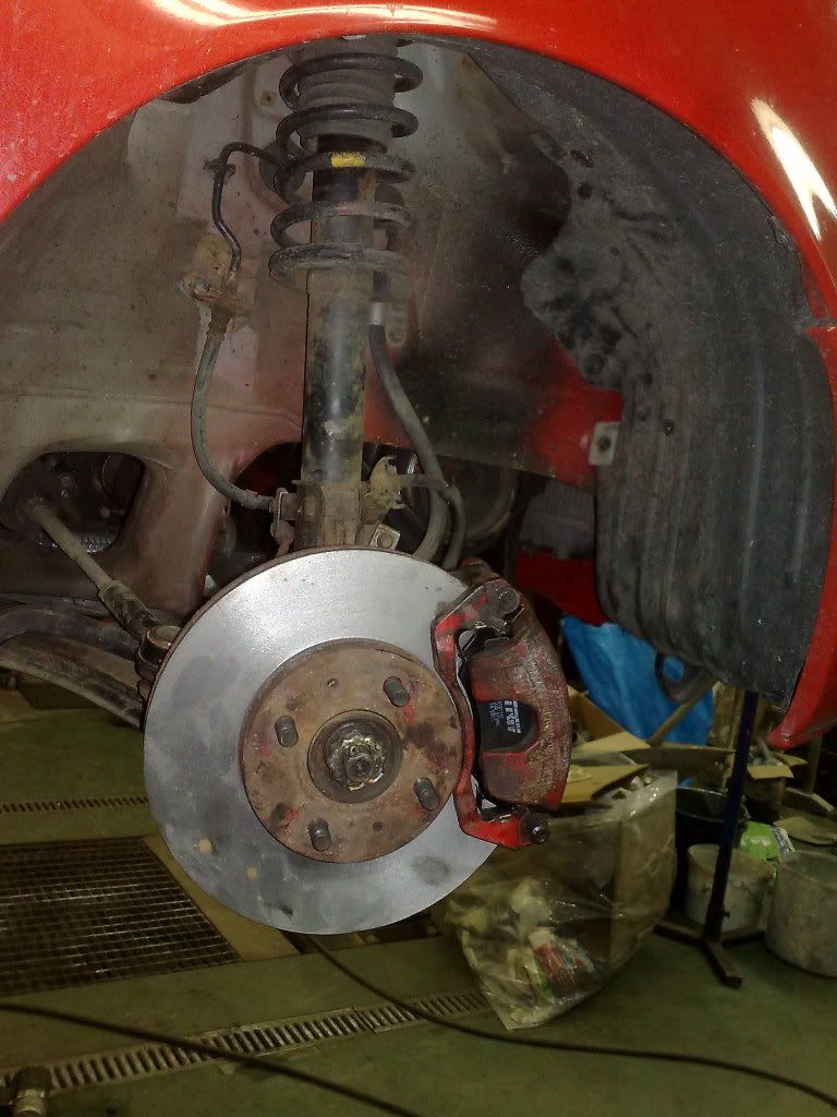

BRAKES :
- Front of the Almera GTi - 257mm discs + pads TRW
- Rear discs + pads ATE Series
SUSPENSION :
- Eibach springs,
- polyurethane front suspension

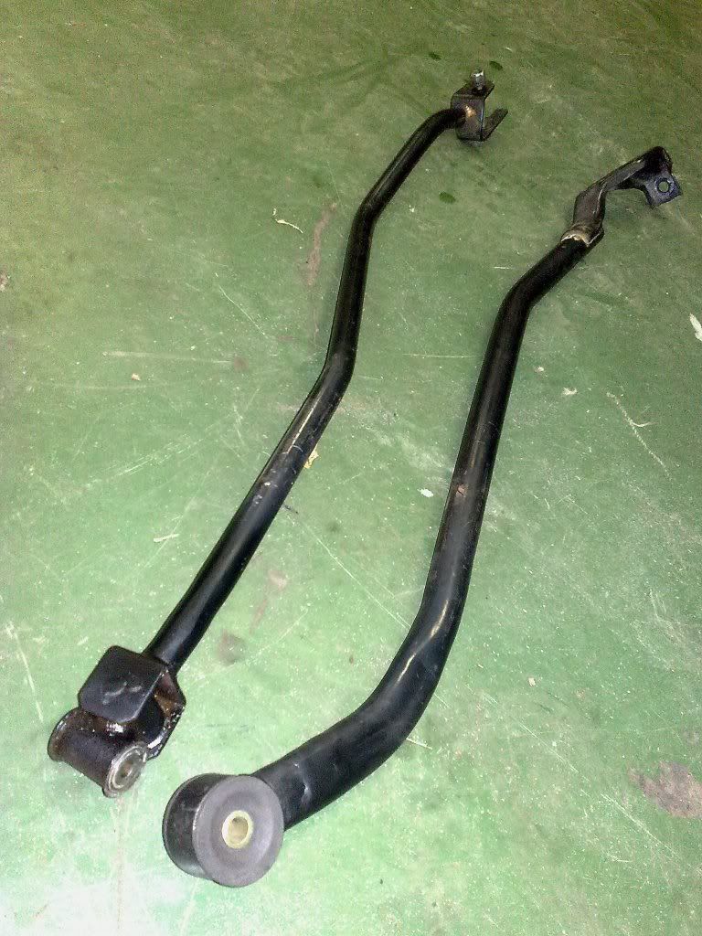

- adjustable Panhard bar

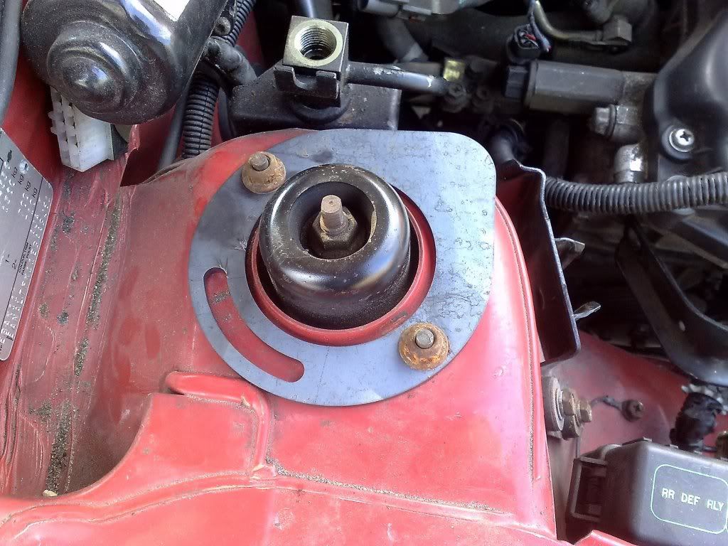

- upper strut custom cups
WHEELS :
- 15-inch OZ alloy wheels with 195/50 R15
INTERIOR :

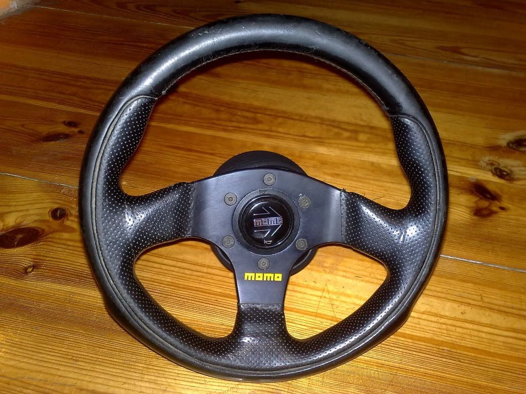

- Steering wheel Sunny N13 GTi
- Bucket seats Series
AUDIO :
- Originally 4 speakers including 2 mounted on the shelf

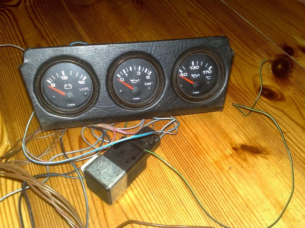

ELECTRONICS :
- piggyback EcuMaster DET3
- in the cockpit : oil pressure , oil temperature and voltmeter
DESIGN :
- Series Super S + black headlights
Acceleration 0 -100km / h in 6.5s .
