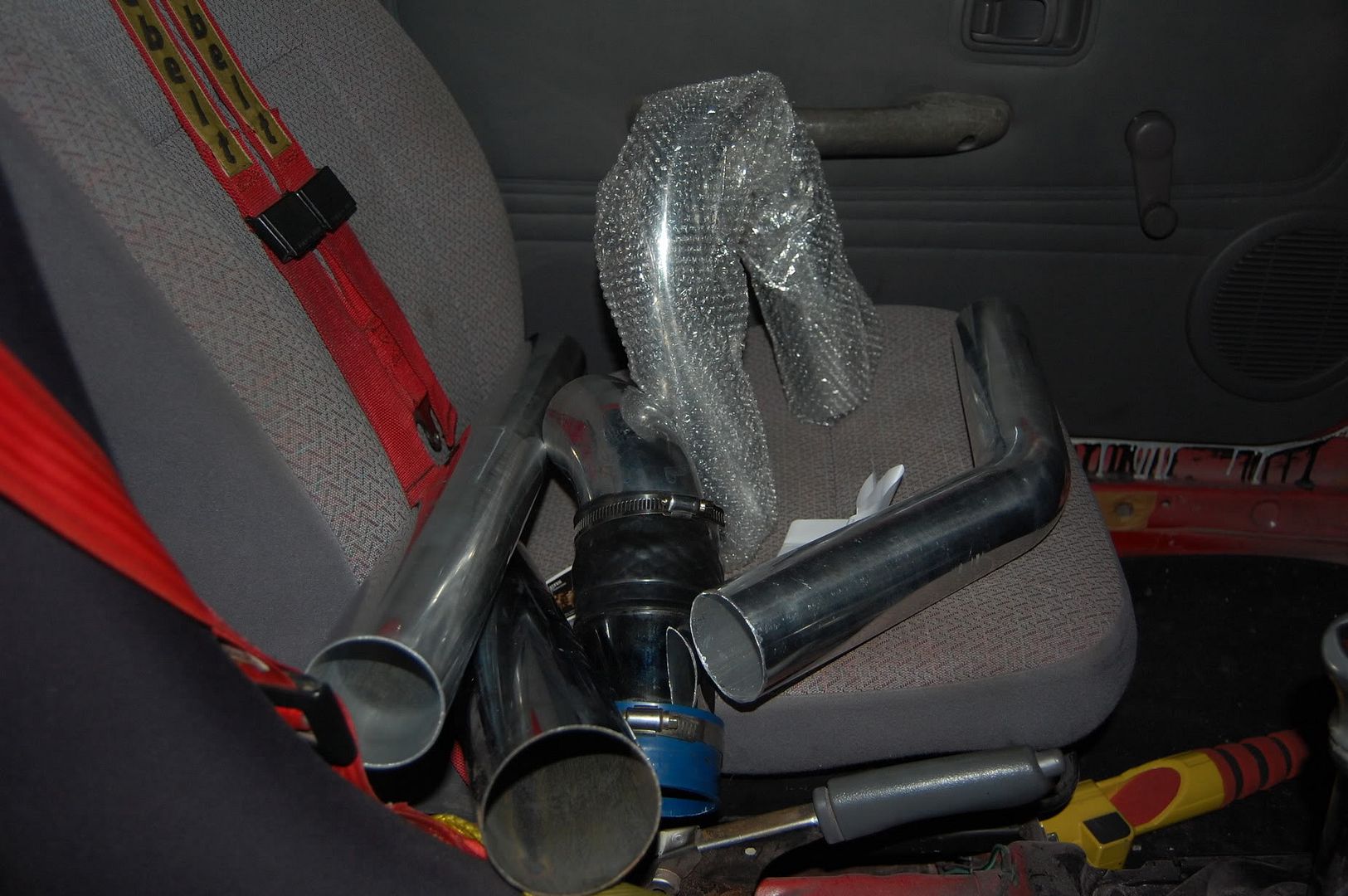

he also dropped over some spare intercooler piping that he had left over from his conversion
cheers mate(Y)

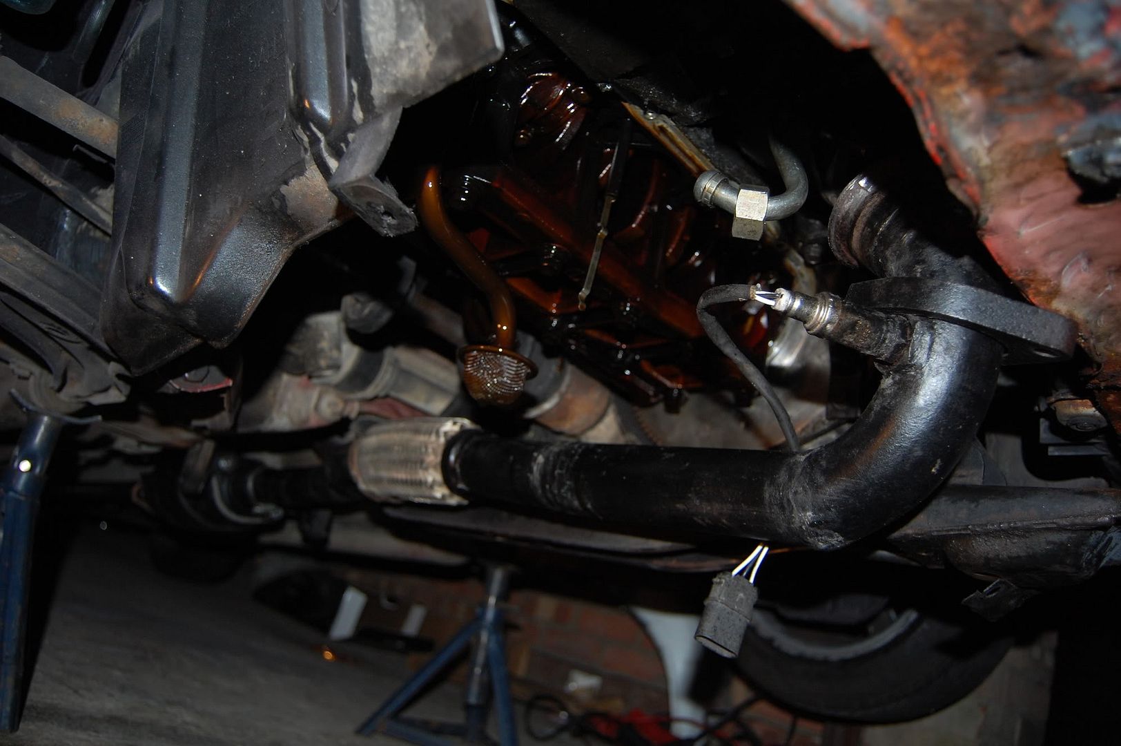

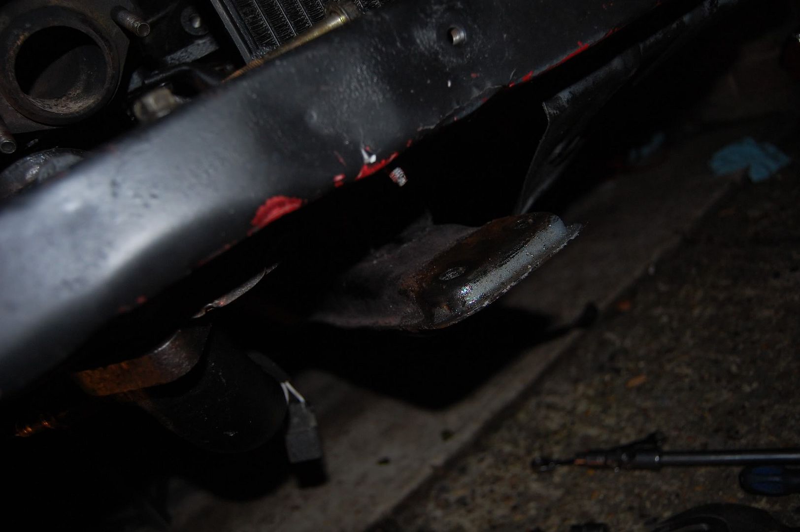

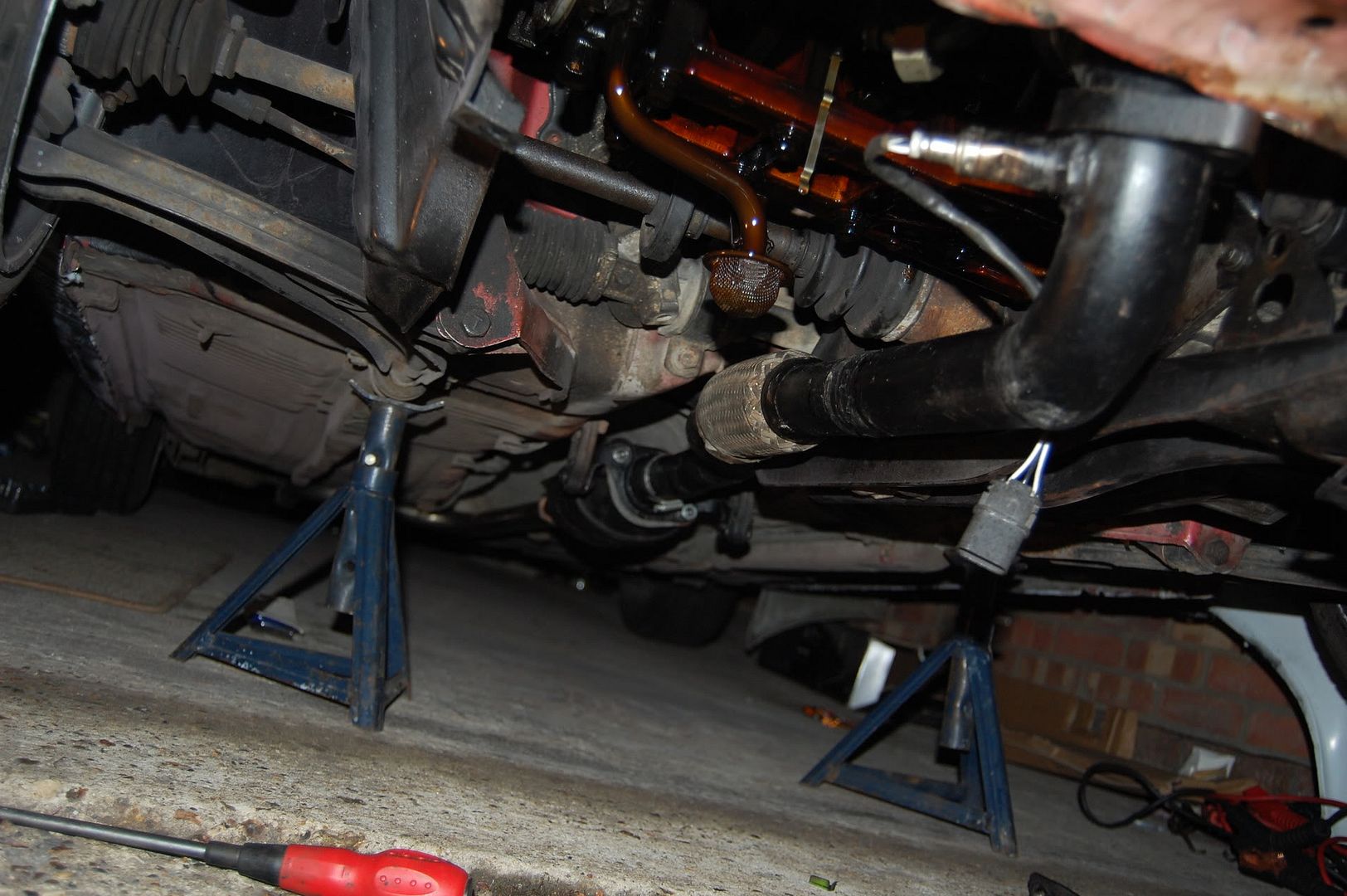

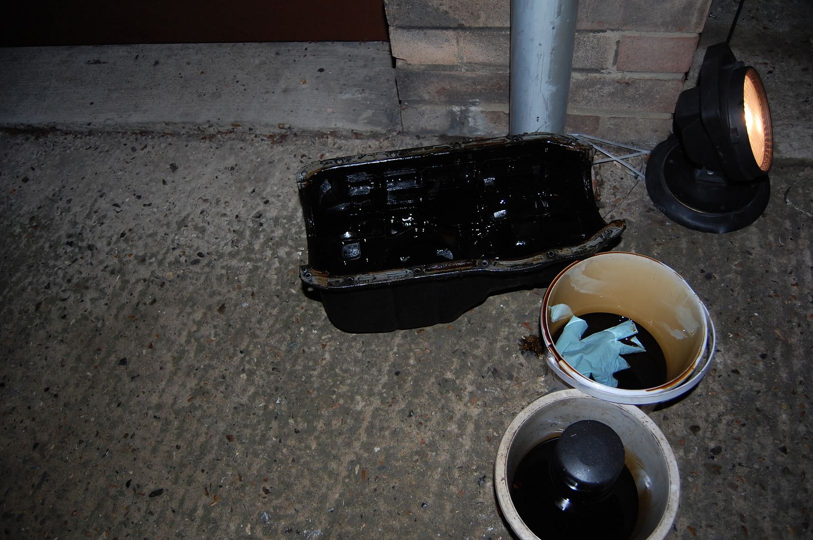

today i decided to remove my oil pan so i can get cracking with the oil lines and had some fun:)

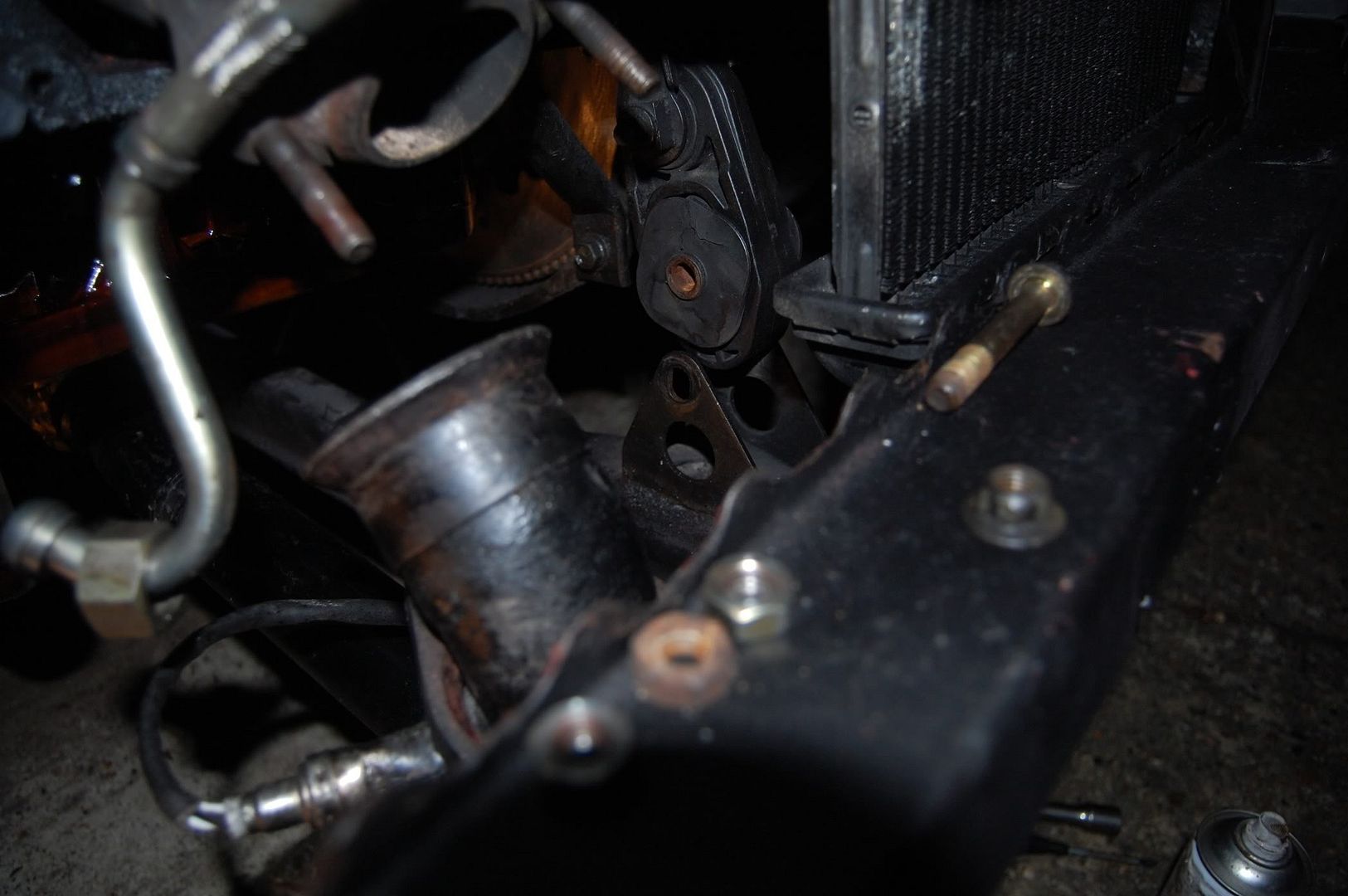

for anyone wanting to remove it you dont have to remove the whole centre member like the haynes says
just remove the two front bolts and lower part of engine mount, with some jiggling and pushing down on the centre member its out
also just wanted show the awesome frankspeed exhaust system

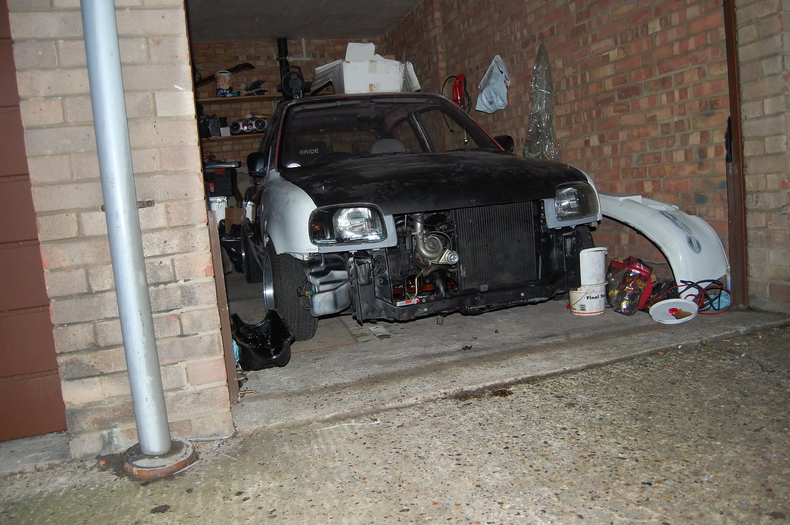

how shes sits, i think ive taken the front bumper of more times than ive started the car!!

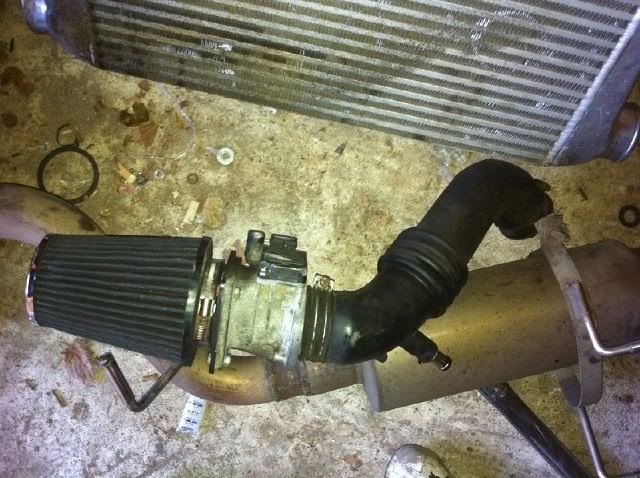

s13 afm with k&N

question for ed fusion please
is it possible to mount the air flow meter backwards
i have a 3" 90 degree elbow coming off my throttle body that i would like to use but will need to buy a reducer to fit the s13 afm as its smaller ithink 2.5'', on the other side i need the same reducer to to take it from 3" to 2.5 as thats what my intercooler piping is
can it be run backwards so i dont have to buy two more silicon reducers mate?
anyone? cheers

I dont think so, the AFM has a hole for the air to pass through so it can meter part of the airflow, if it is mounted backwards the airflow wont "hit" that hole...
