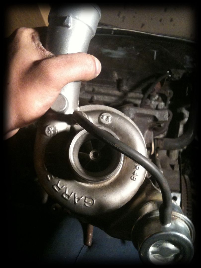

Been toting with the idea for ages bit seeing as cars getting full makeover it would be rude to not stick a rocket up it's backside :) fiesta rs garret hybrid t2 , still collecting bits but should be on the car and connected with oil lines and intercooler within few weeks :)

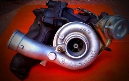

I had 1 of those turbos the other month before selling it looks similar if not the same as the one off of a Connect van?? they do 75/90bhp and 110bhp turbos.
no diesel turbos here.... rang turbo technics today to confirmed the id plaque and it is a fiesta rs turbo t2, no shaft play whatsoever so all should be good

The turbo looks really interesting... Whats involved in fitting one of those? My car is currently totally standard and needs a "rocket up its arse"...

As for the turbo it depends on the parts you get and how much you can mod to fit by doing the work yourself, then the mapping, that's were I think it gets more serious

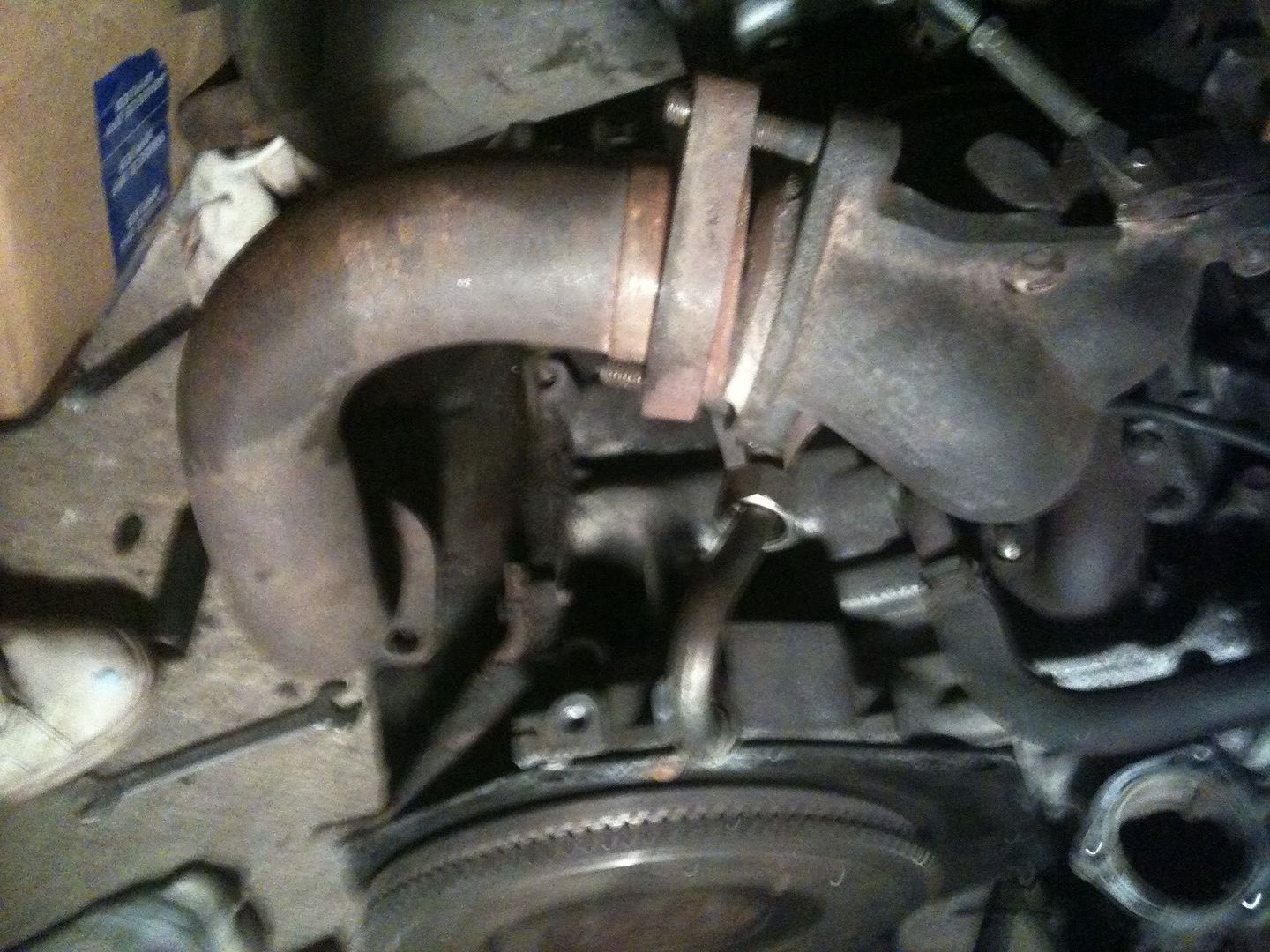

How's the fitment on the downpipe??
Anychance of a pic some how from the side?? Cheers maaaaaaaaate !:)

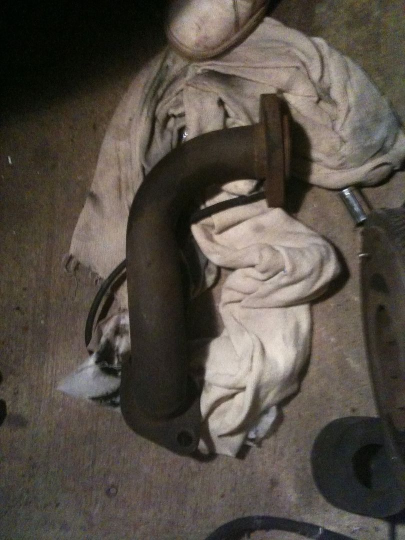

we,ll have to increase the curve in the downpipe eh mart

Looks tight thou mate :)

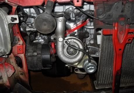

Could the turbo be put with the turbo on the left and down pipe on right as per original but Put the flange at more of an angle to clear alternator? I can move the radiator out no worries, just think it may be difficult to get the down pipe onto the flange?
Like photo???

there,s plenty of clearance from the alternator mate, and the downpipe lines up ok (needs a sharper bend tho eh)
