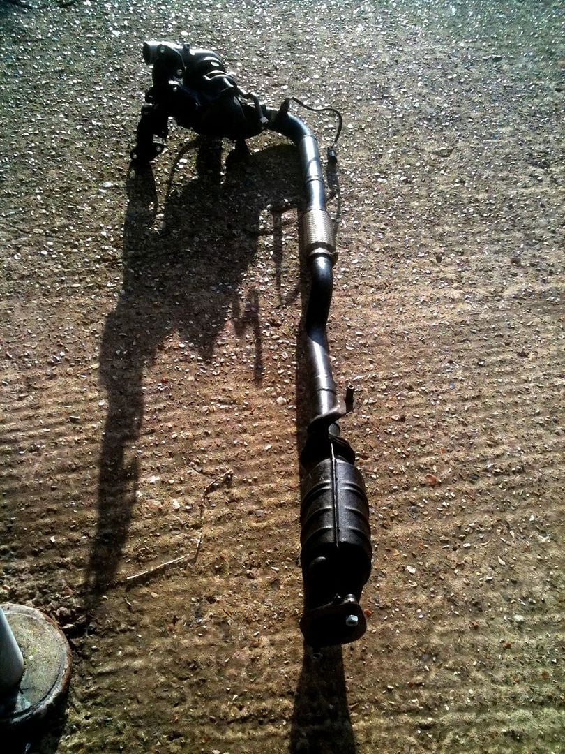

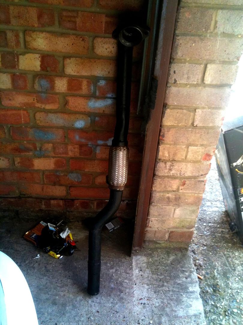

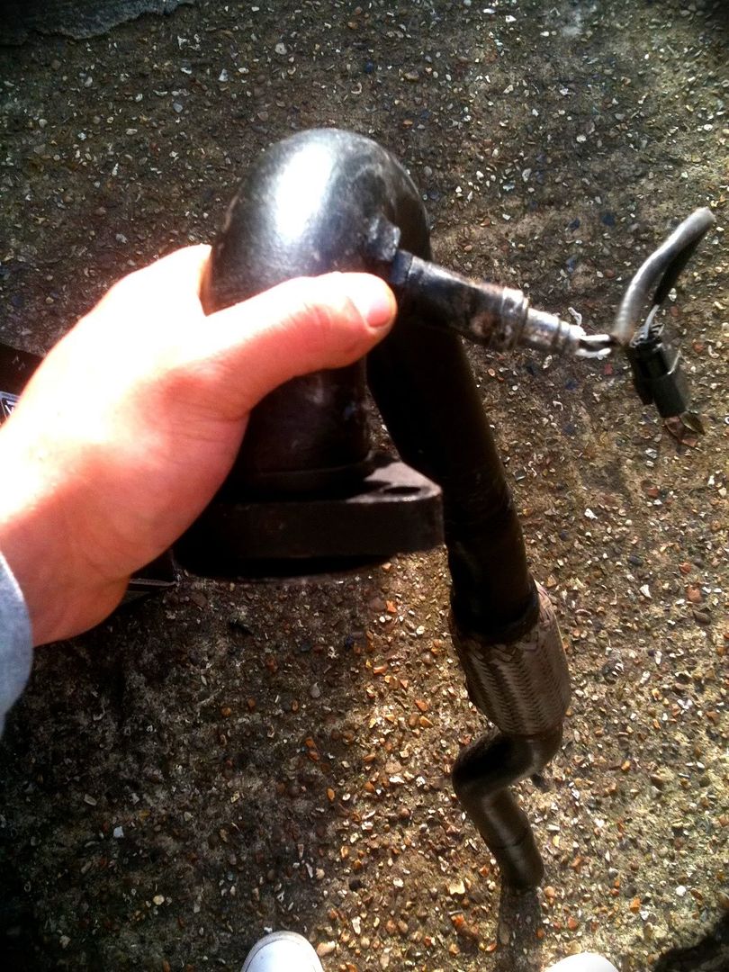

You could bypass the original downpipe flange and use the whole fiesta one and continue it to the second cat I.e a whole new bigger down pipe? I coupe pay you more mate? :)
that was my downpipe in the pic mate, we should be able to rework the fiesta downpipe and fit the lambda thread and a flexi then the 2nd cat flange :cool:
Youve lost me fwn
I was saying that keep the whole fiesta downpipe and continue under the car and make a new bit to join on to it and on to the second cat
What did you mean mate :)

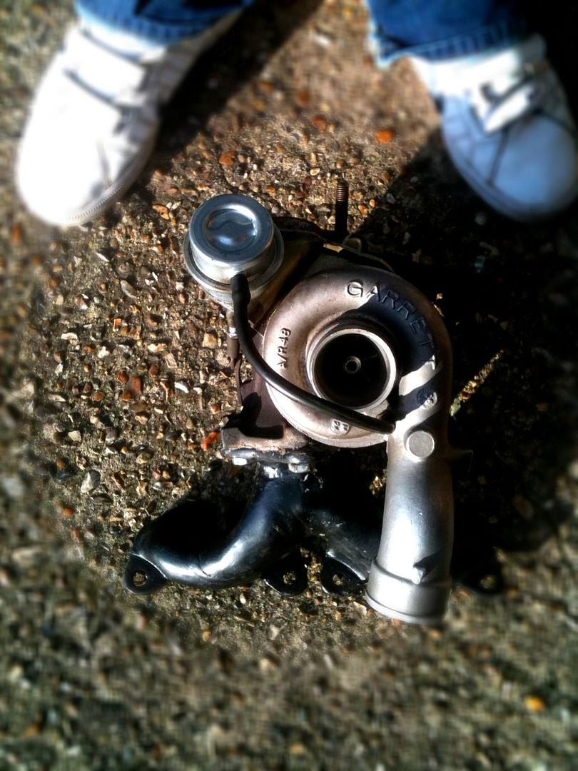

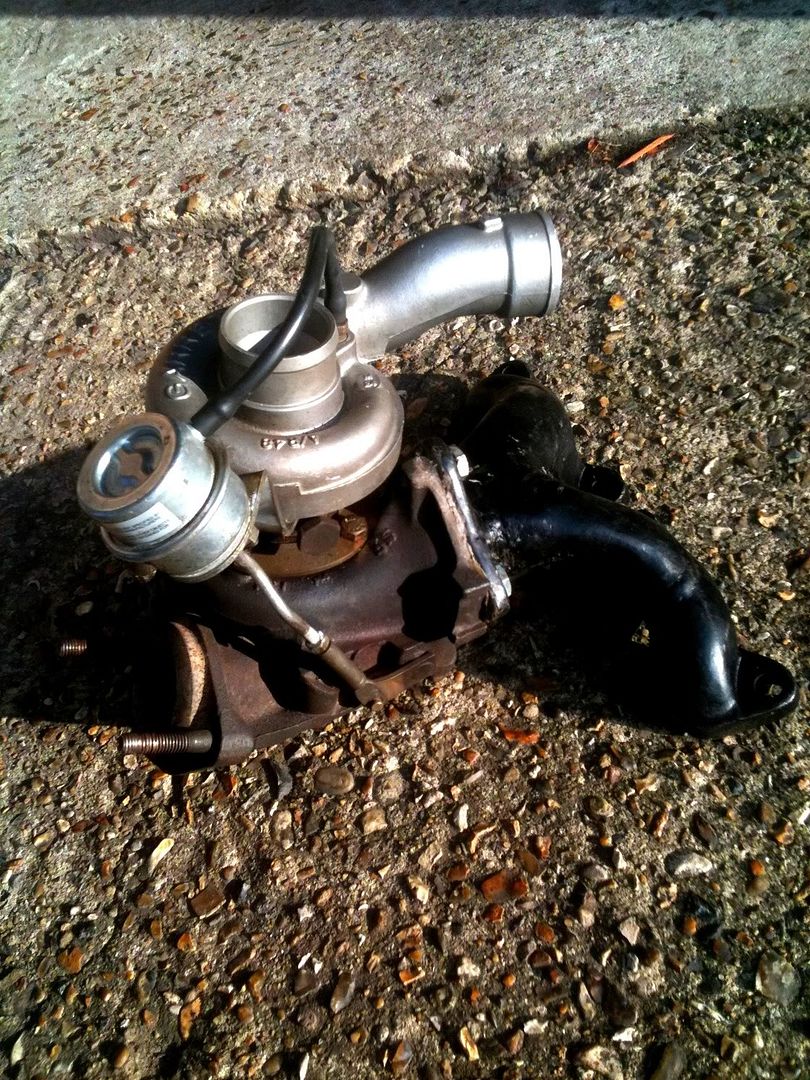

Turbo technics t2 from fiesta rs turbo :)
Frank any chance of making a decat aswell for a price please, would need to mount up as per original as need to swap for m.o.t emmisions , let us know please mate, I have a 45mm system so would like to try and keep that throughout?
Think fiesta downpipe is 2 inch, would you be able to do a Frank special in 45mm from there to second cat with de cat aswell?

You've done a grand job on that turbo fitment frank! Looks great, the downpipe should be much of a problem eh. Could always alter the position on the diwnpipe/pipe to cat flange. How you getting on with the oil lines mart? Whip that sump off:D

Baguete - 6psi stock, seller said never been ran over stock boost(if that's true!?) but the quality is spot on, there's no shaft play at all and looks in very good condition
Not sure on max psi but I'll be running at 10 psi, some mini guys run 22psi so not sure :p dont want a massive surge at 5ooo rpm as want drivability not figures also running stock compression so will feel like a supercharger as there be no lag and fast spool up time.
Kristian made 163 hp and 134 whp at 10 psi on garret t2
My target is 150 hp with at least 120 whp

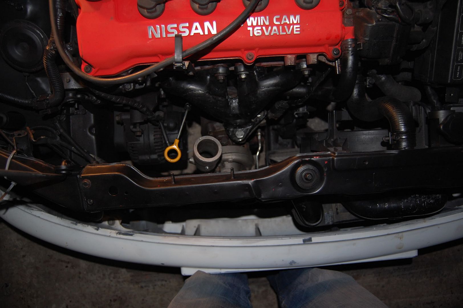

Here's my turbo kit franks made for me and he has completed it to an excellent standard :)
It bolted up a treat in about half an hour with no messing about

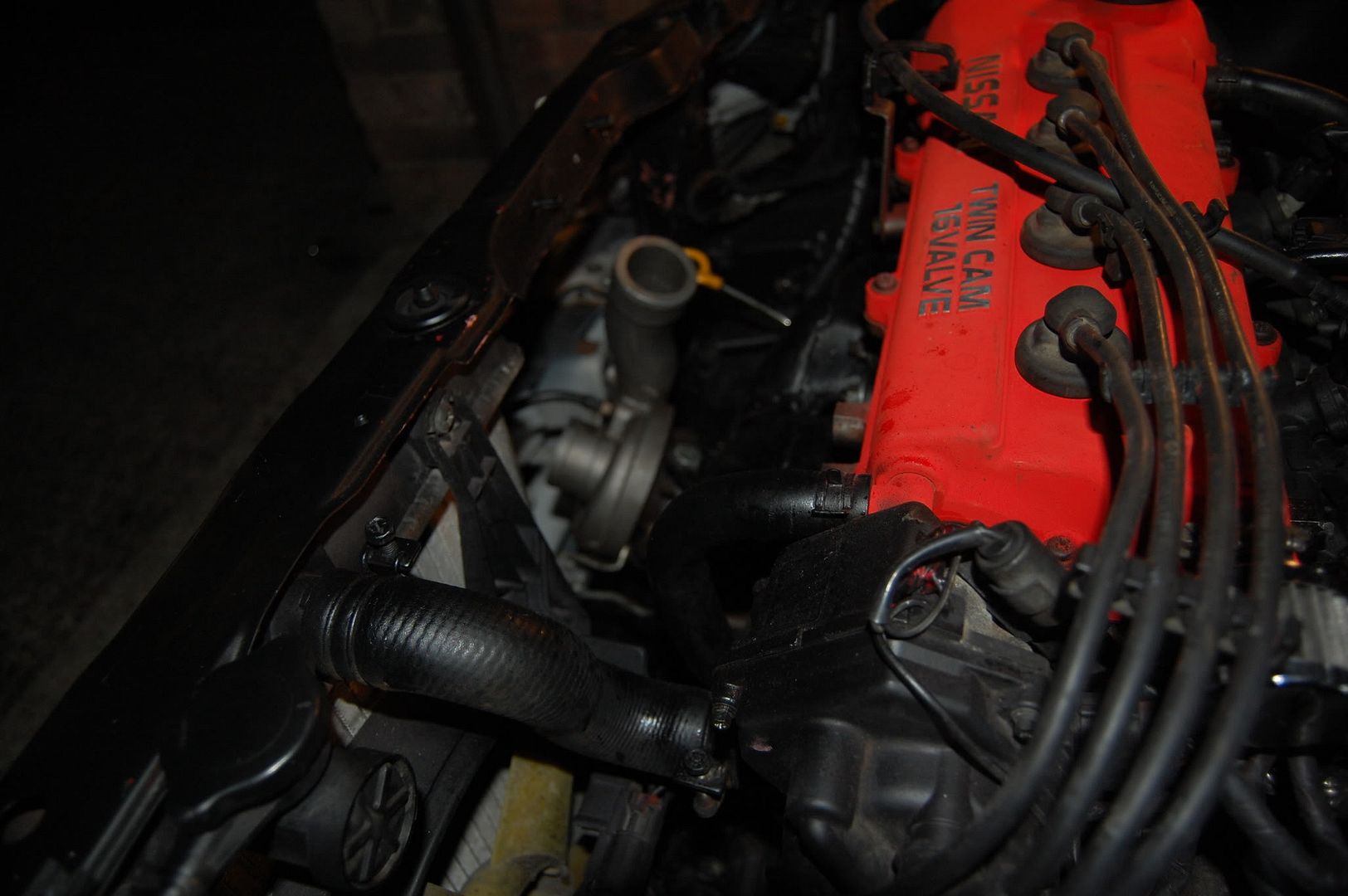

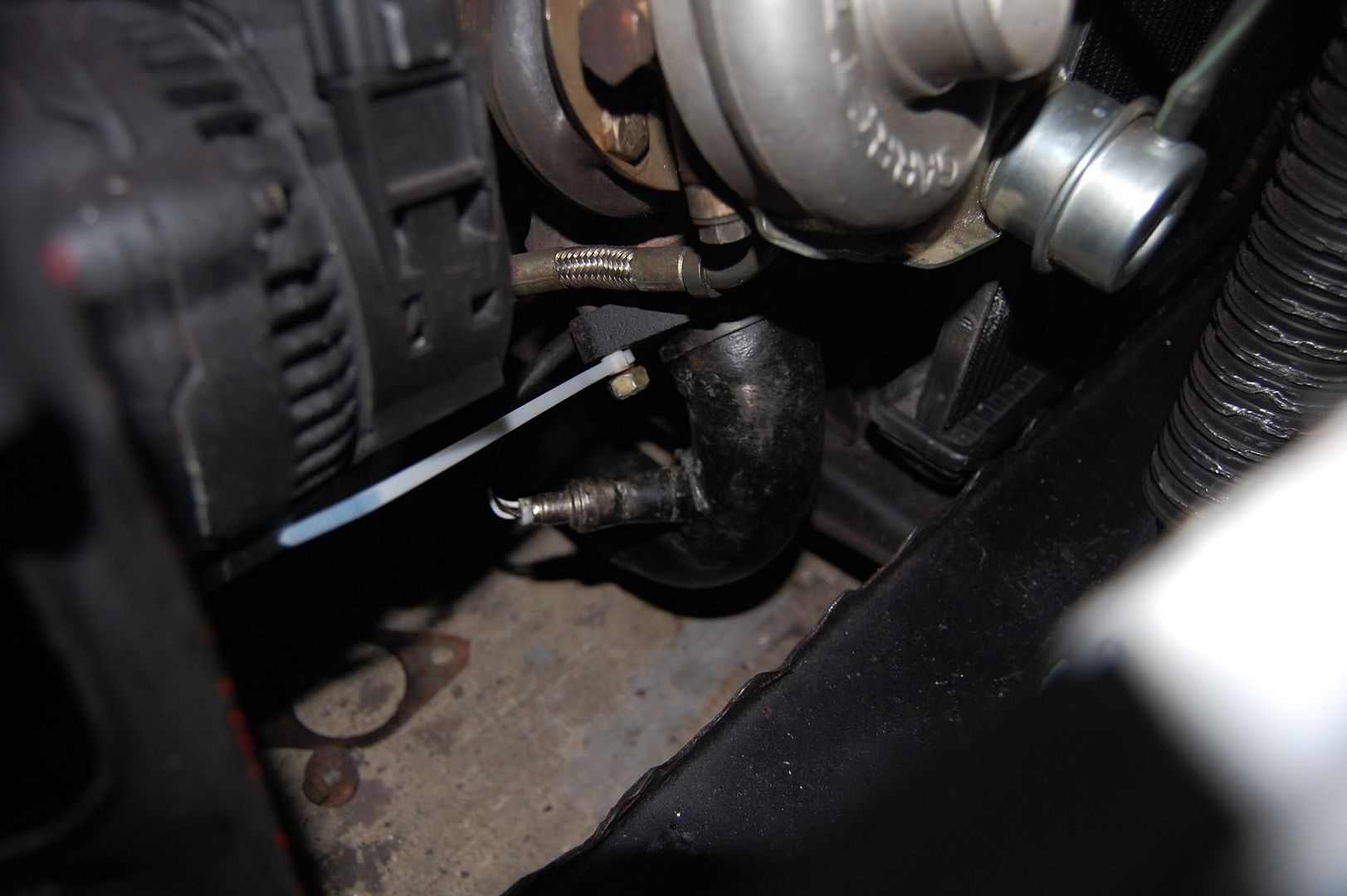

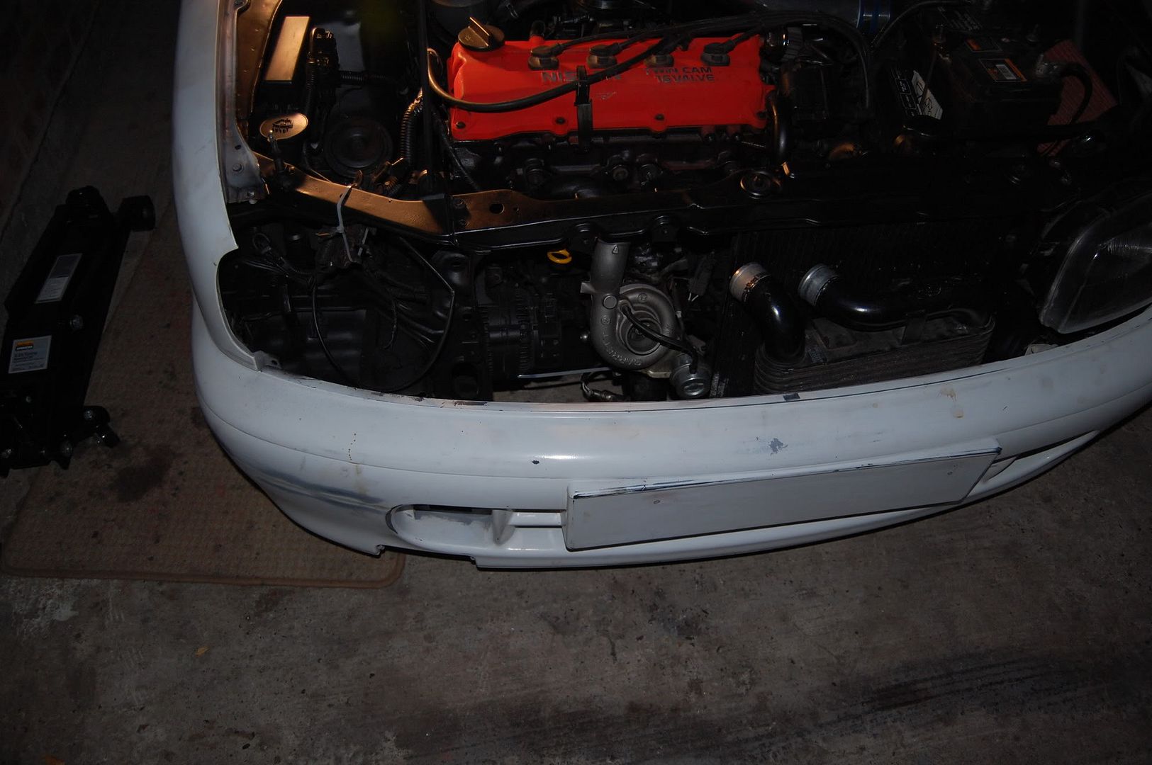

heres a few pics i just took fitted
really need to get the nuts ordered to hold the downpipe to the turbo elbow
got a massive box of nuts and bolts and yep ... you guessed it .. none fit!:down:
this is the turbo feed im ordering

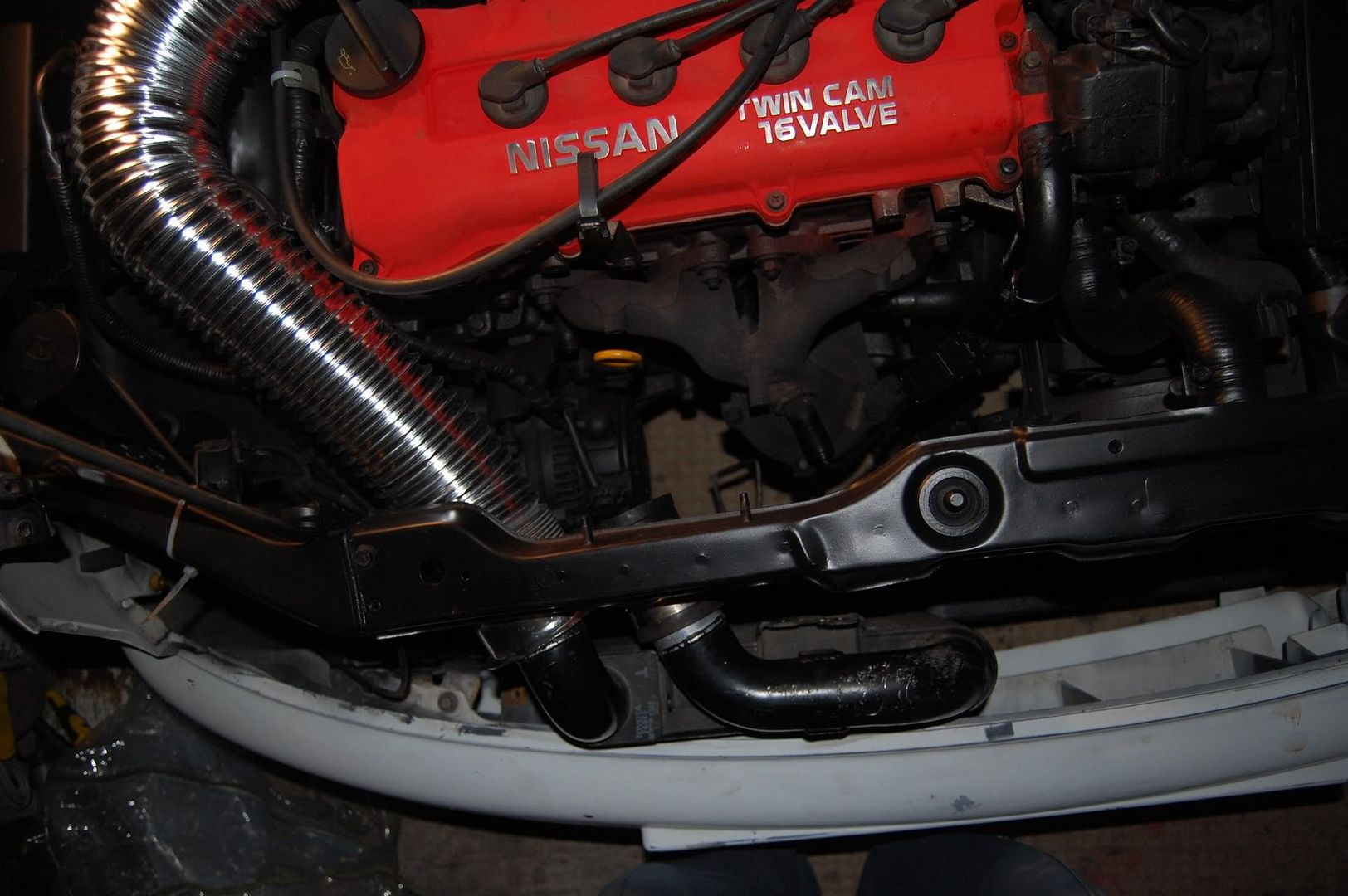

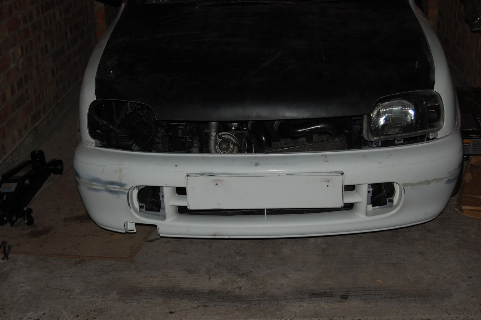

heres the intercooler route mocked up with some ducting, its an mr2 turbo one

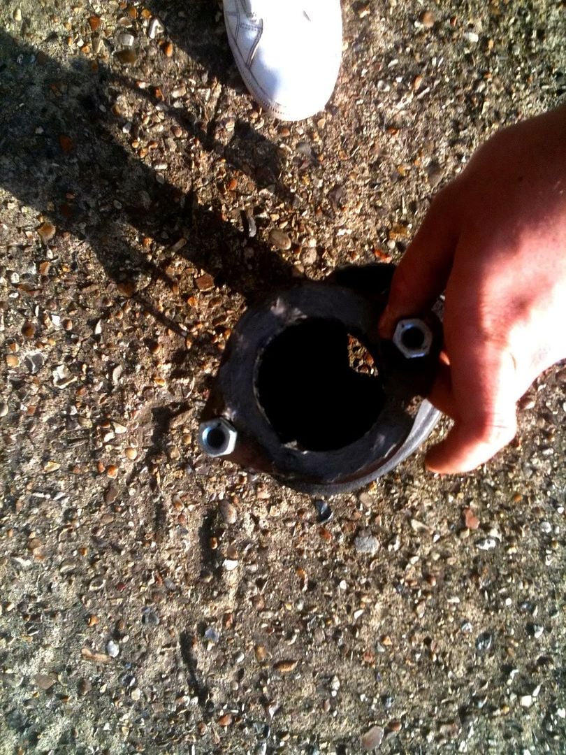

Mint, on the off chance I just popped into to go and look at there nuts and bolts, ended up buying a set of m10 nut and bolts for £2 and the nuts fit the turbo elbow bolts!! Well chuffed considering I'd have to order them from ford at 75 Quid a set of studs and nuts
Gonna do it all proper tight later and makes sure there's no blowing:)
