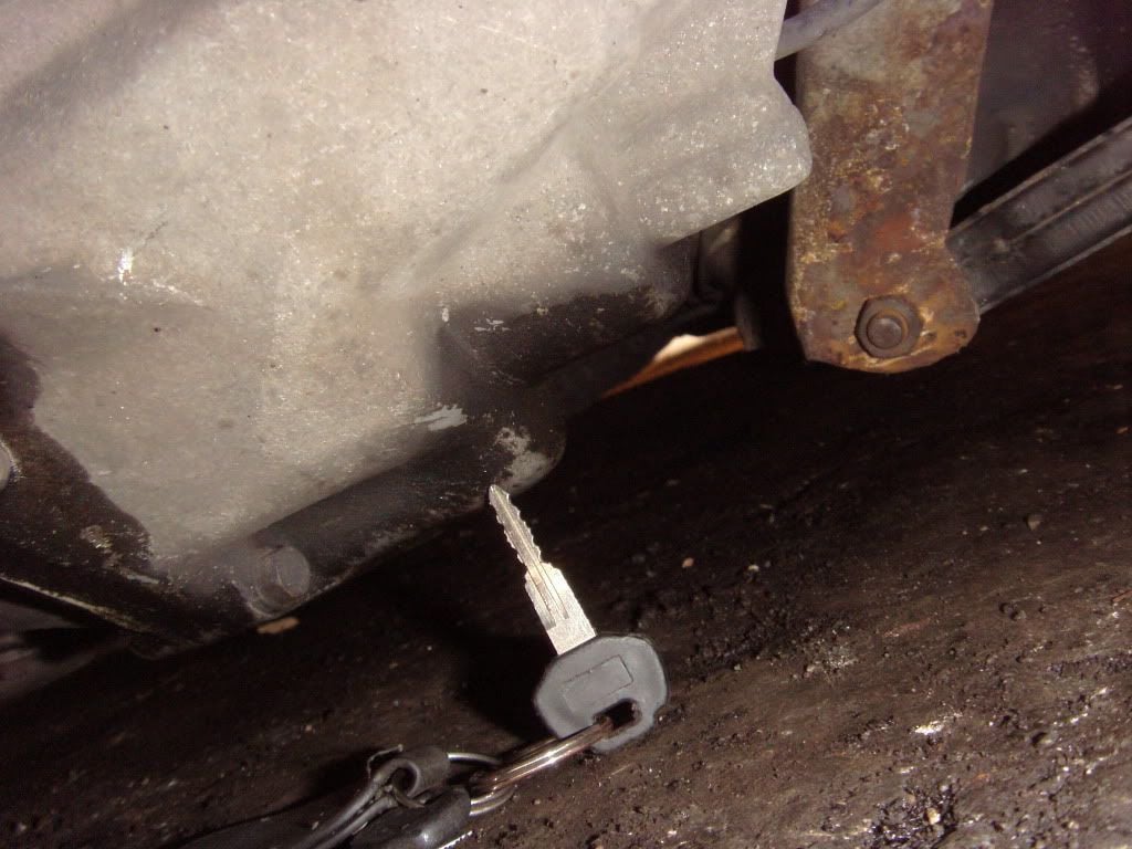

my matiz legs are about as low as you can safely go imo (you can see there,s only 60mm of clearance on the engine support/cross member :eek:)

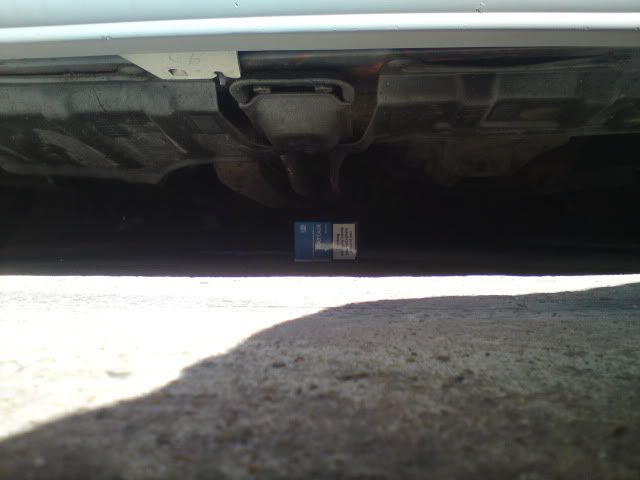

Whats unsafe about slammed rides? fwn Mine sits about the same height as the strut bar (3 fingers) with the strut bar removed (the strut bar sat an inch off the floor, LOL)
(ill get a proper pic tomorrow)

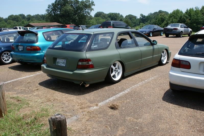

Are they all can jobs? Really good finish on them all if thats what they are. I dont know why but i'm really liking that last pic of the nato green estate!

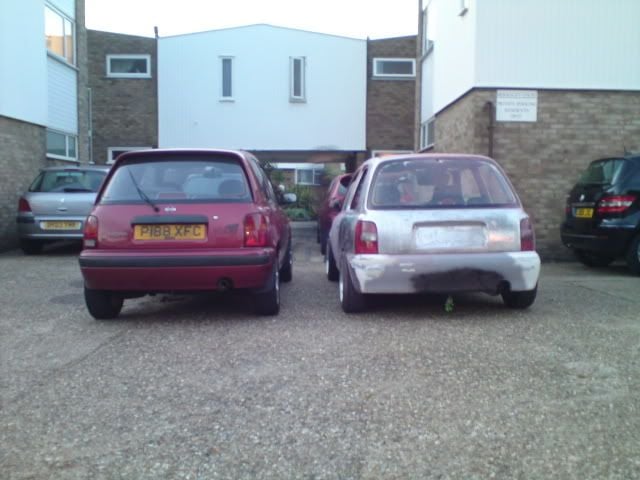

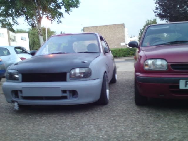

scopez popped over so i thought id take a photo next to his
Excellent progress Marty. This is probably my favourite blog thread (Y).

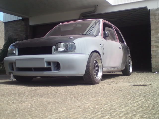

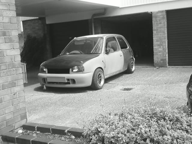

got some 165/55 fitted on rear yesterday, looks much better and have rim lip which i think looks better with stretch
just the fronts to do but they suit the wheel and arch much better:grinning:
front needs them and to come down another 25mm or so

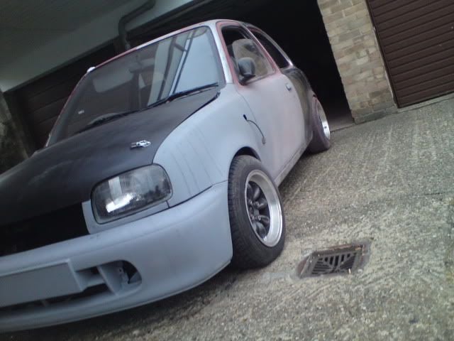

I can't decide which tyres I like best. (i've been contemplating 165/65 for a bit). I do love the tall 175's but theres no doubt that the little 165's look the business as well.
your right the back tyres match better
and what do you think bout the eye brows for the bonnet
it does look mean as is
The 165/55's are a whole lot better mark,get the nankang of camskill,only 26 pound a tyre and come with rim protector and look really good,how a stretched tyre should look, weirdly makes the wheel look much fatter. I got mine for 12 quid each part worn,except they haven't been used really the tread is mint! I'll see if I can a better comparison picture later :)

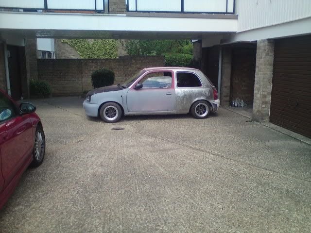

got some more done tonight
cant spray cellelouse or 2k paint over acrylic primer so wiped the halfords cack of with petrol, amazing how easily it came of, washed it after and went over with a light wet sand so she good to go

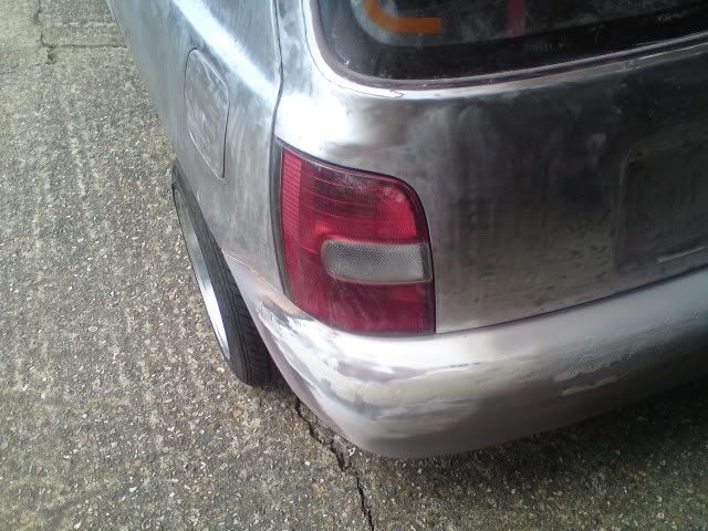

also filled rear quarters dents and imperfections and started to finish off bumper smoothing in :p

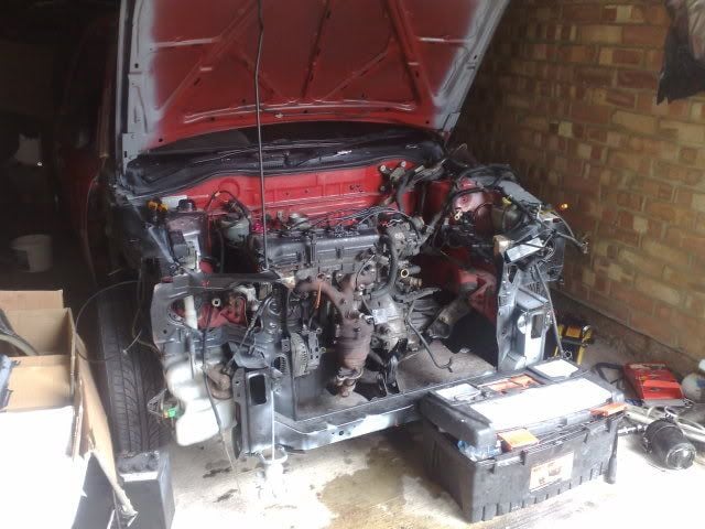

though id start on the removal of the 54 bhp piece of poo, following the foot steps of frank and gonna leave box and shafts in place, move it over and hump the lump over,
today i removed all panels,radiator,wings etc and the wiring from the engine and disconnected all ancilleries, got nothing holding the engine in bar 3 engine mounts now so well pleased, oh and few more gearbox bolts and one exhaust mount bolt
just thought i d tell you ive got absolutely no experience in the engine apart from basic servicing so quiet pleased im doing this with no guides just what ive learnt from the website, so thanks to all the info!!
