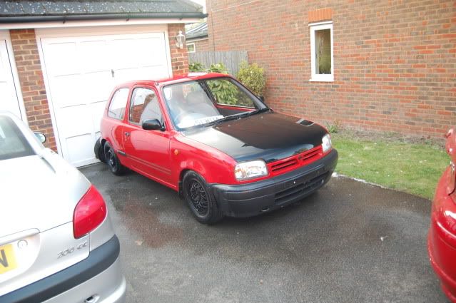

sleeper ss is dropping off the car this week so i thought id get started on a few bits whilst im waiting

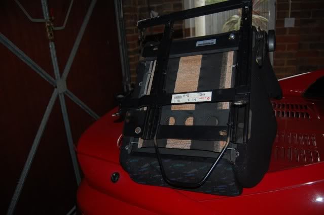

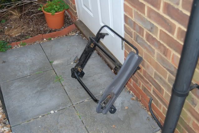

swung by today and managed to save a seat rail from the depths of the crusher!!
sleepers work collegue and me butchered it until we were left with this
my recaro and s13/14 bride low seat rail( from japland) too wide and long and too expensive to start cutting so i removed it
the last stubbon rusted on allen key bolt that gave me problems on the bottom left!! Grrrr! breaker bar and friends allen key...sorted

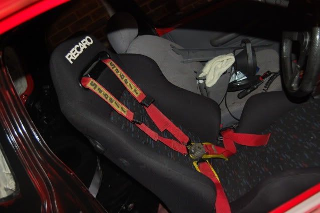

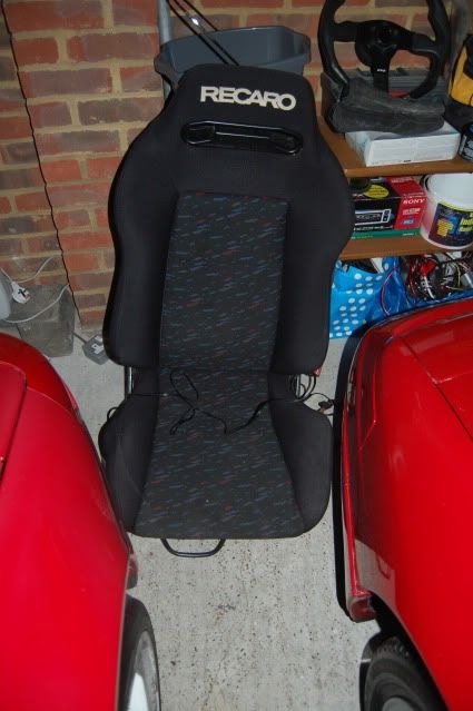

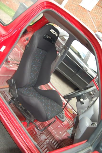

the recaro, damn comfortable and sucks me in like a babys buggy seat
luckily the front two bolt straight in!! the rears are held on with pipe clamps for now but will get welded when i come to use the car properly. but for now , whilst the car is being "overhauled" it will hold fine
more soon....

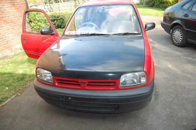

firstly many thanks to sleeper ss for delivering it to me on his flatbed truck, much appreciated mate
got big plans for this one but going more all out than before

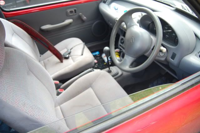

here some photos after delivery

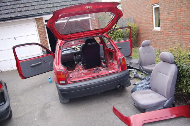

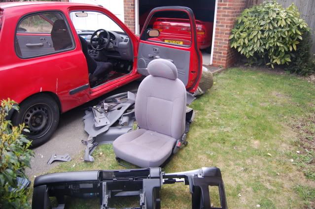

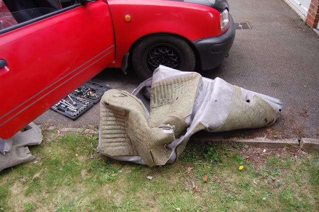

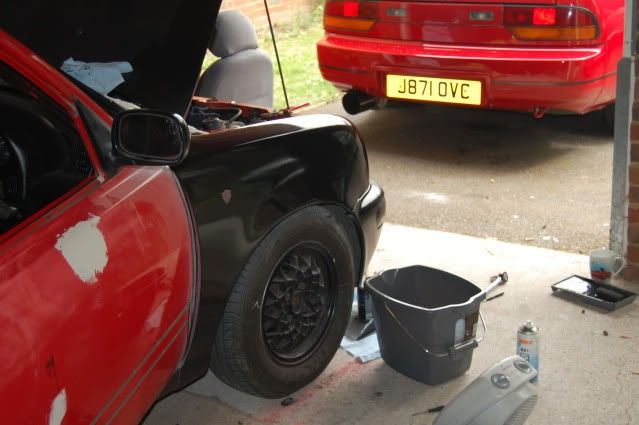

went inside made tea and armed myself with a phillips screwdriver, socket set and plently of fags
started stripping parts out :p

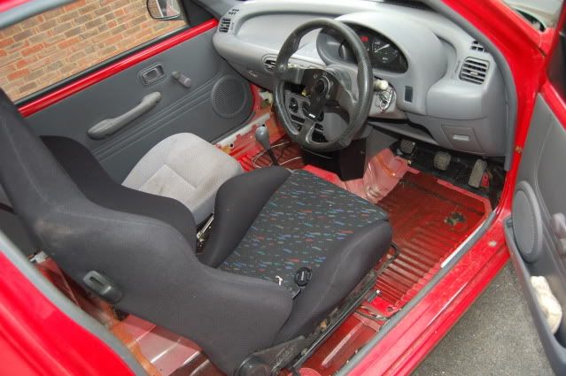

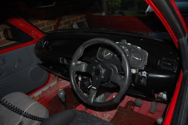

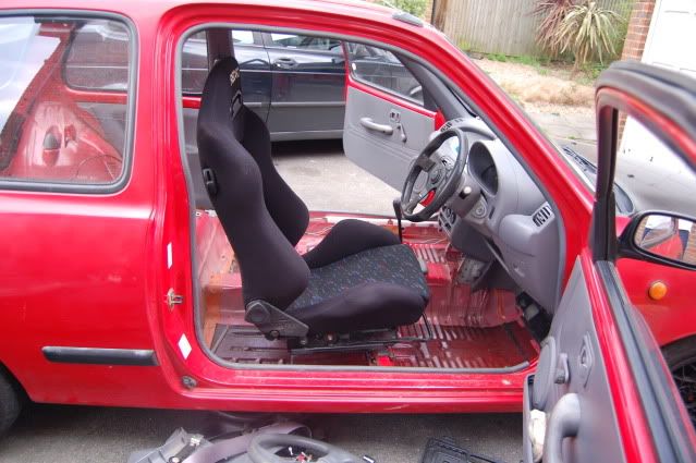

most of the unnecessary stuff out so recaro had test fit and steering wheel!

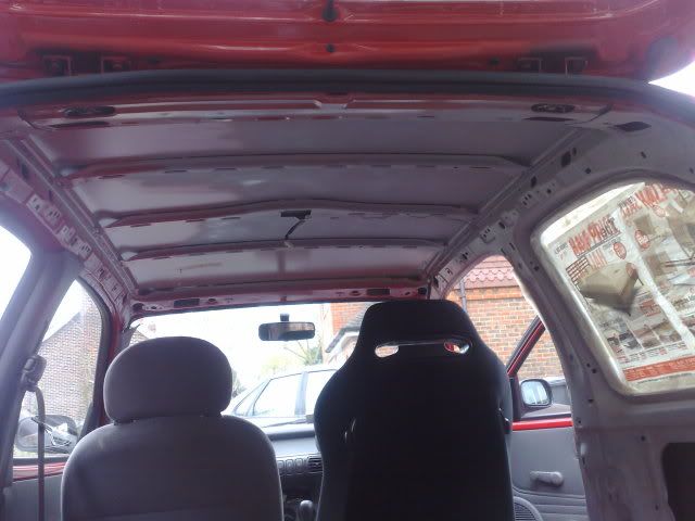

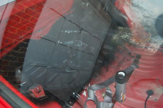

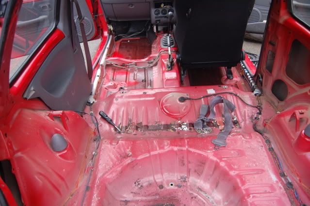

rear of car after most stripped out

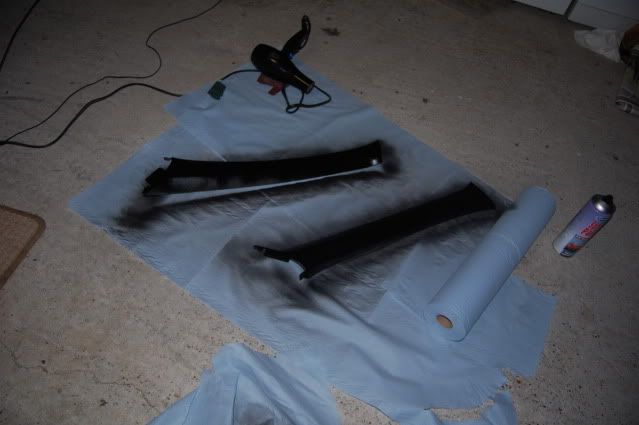

and also started on the satin black inside

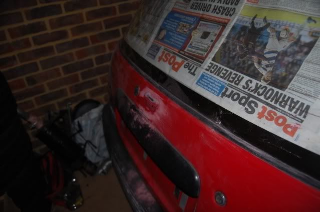

got some more done today,masked out windows, wire tucked the rear and sanded more of the rear and covered in grey primer, just gonna do the whole car inside with primer then spray in satin
some photos bit later
later on...
maybe some more later or tommorrow
right got stuck in last night and sunday for a couple of hours,damn satin spray,im literally breathing it ffs!!

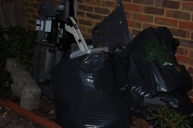

anyway most of the stuff from the car im not keeping all bagged up and ready to be binned!!

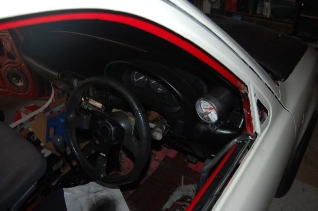

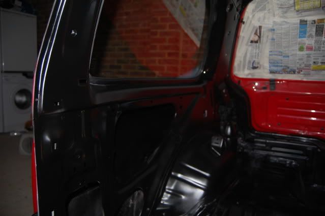

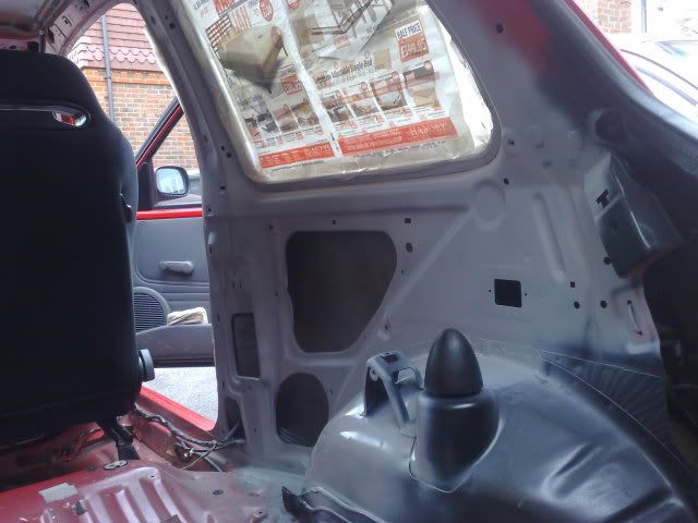

fitted black dash and sprayed surround etc, took loads of sound deadening out from behind the dash

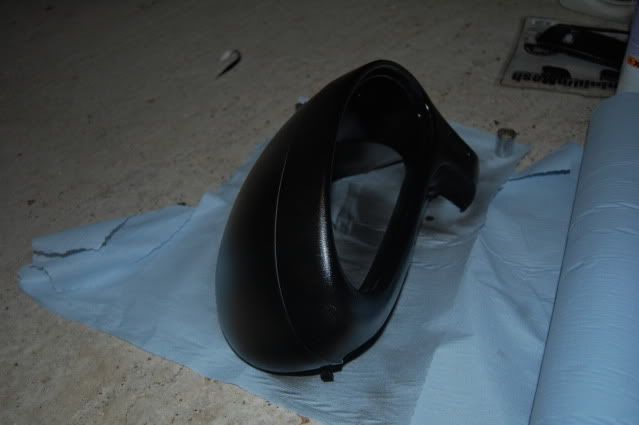

few more satin black parts

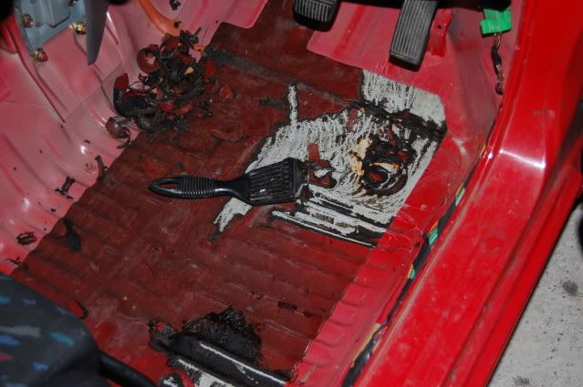

and the dreaded sound deadening in the floor, got started with a hairdryer and scaper, so time consuming!!

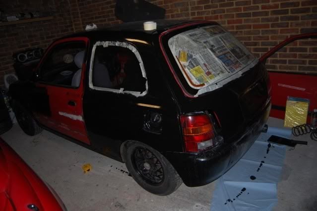

started my $50 dollar paint job with a test of flat and blocking and compounding after 2 coats and was well impressed.
its rustoleum thinned with white spirit, thin coats wetsanding throughout the grades every 2 coats with a final 2000 grit wet/dry and a buff
really happy with progress although have no photos of it buffed just after i put another coat on
looks real bad with alot of orange peel but all that gets sanded out with the flatting back, needs the 8 or so coats so that when you do flat it back your not rubbing through the paint

the rustoleum job was going ok but so much effort has to go into it what with the prepping and the wet sanding betwween every two coats

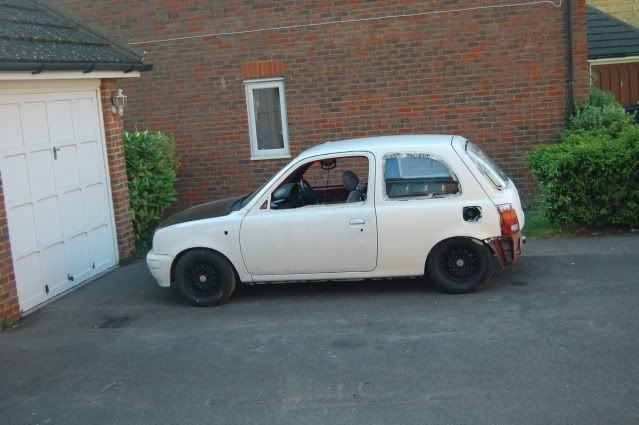

heres the latest
began to get the hump as blcak shows up every imperfection and scratch etc

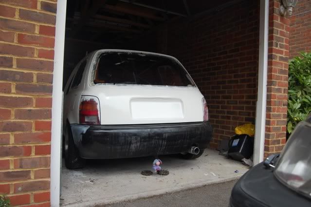

i ran out of paint and whilst in the paint shop i had a change of heart
so i thought sod it and went white
if i had 1200 for proffesional full respray then i would have black but i dont so here it goes.....

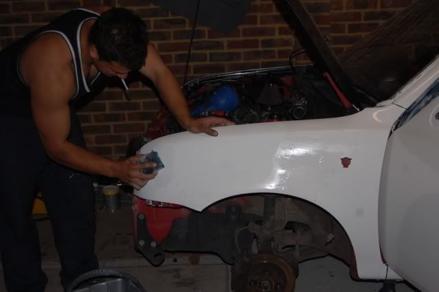

me wet sanding

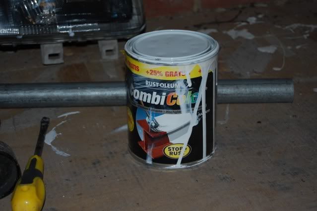

the paint
rustoleum combi colour

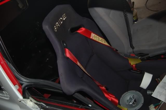

hello all, the recaro has gone and now have a bride holding monster seat, its a fixed seat and have managed to get the s13 seat rail to bolt to the floor, very please as im practically about 1 inch of the floor! driver postiion is spot on as i adjusted the steering colomn bolts with spacers so i now actually ressemble sitting in a go cart

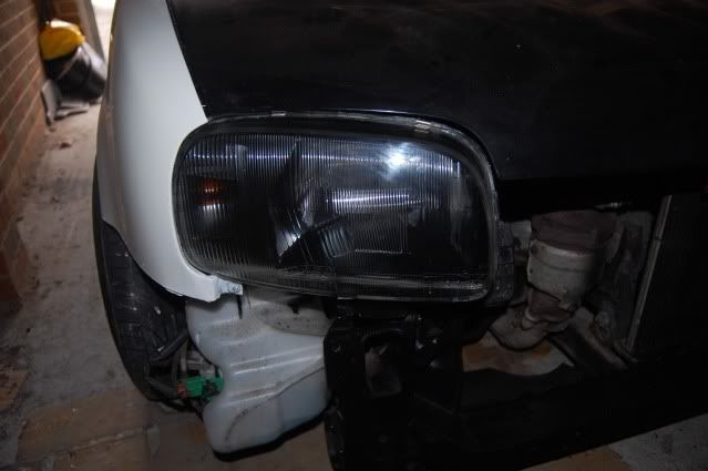

finished the front lights but have used satin spray instead which has worked alot better

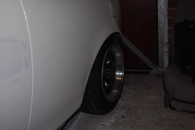

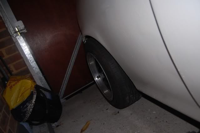

All wheels and tyres on,perfect offset really with the 175's on, could do with little more slammage,but all in time me thinks will be REFURBISHING THESE SOON and they will look good as new

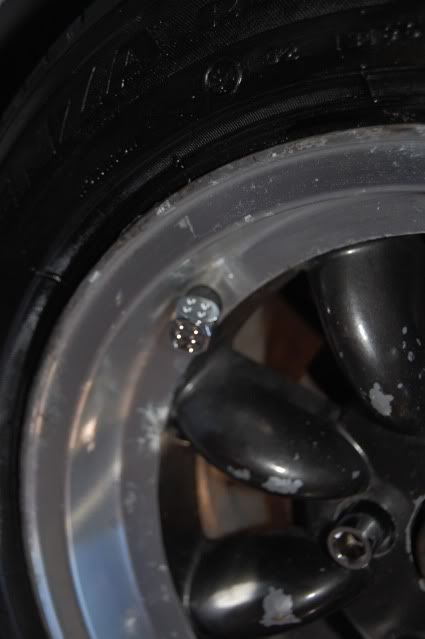

also got my new 'tuner wheel nuts' from the bay which im pleased with, 20 quid delivered
still need to get panhard rod as my axel is thrown to the right giving me tuck one side and poke the other!
oh yeah, photo without spring on the bump stops,
looks rude but unsafe unless done properly so spring back in and now this stance

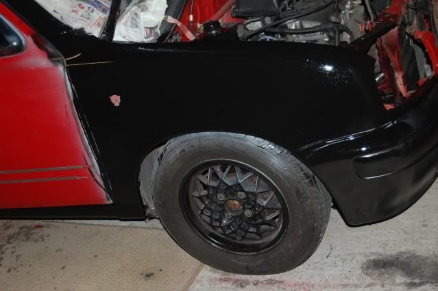

got my bumpers of shero this week, many thanks mate top notch, have started smoothing the rear, fronts just held up on car looking nice until
smoothing and respray begins

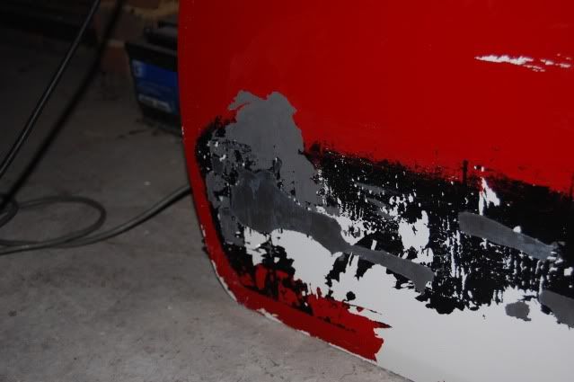

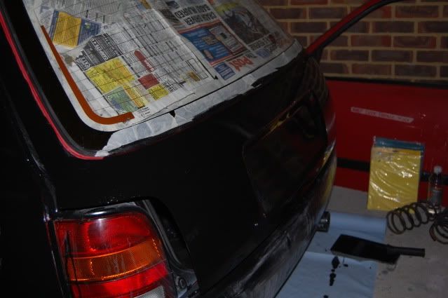

went out last night to the car, paint has been curing on boot for over 2 weeks, bone dry and hardened
peeled away the masking tape which pulled the damn paint with it!!, not impressed
tryed the side window,same thing

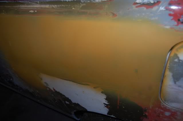

so dissapointed, major major set back as now have to sand back and start again, this time im not using rustoleum, gonna do my orginal plan of satin black.,....again

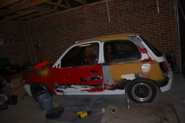

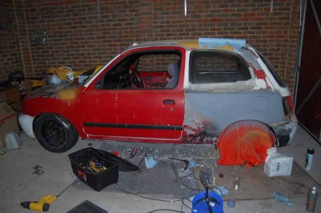

this is current state of affiars

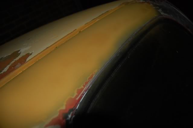

the yellow is primer filler, just seeing if i can bring up to level with exicisting paint
i used nitromors to remove paint and jet washer to blast it off
Talk about 1 step forward 47 back!!
damn poxy car!
pics later:(

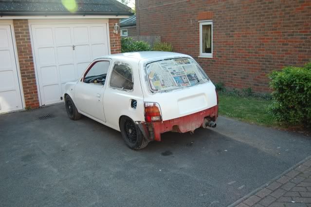

small update and good news really, managed to swap a door this evening which will only require the bump strip removing and alot less work than the last one,
going to replace the front wings and drivers door too as that will save alot of time getting the other paint off
finished a patch today to see what it will be like with the primer etc, all level and smooth
car should be totally prepped in few weeks people, finally it will start to look less embarassing!!
some pics

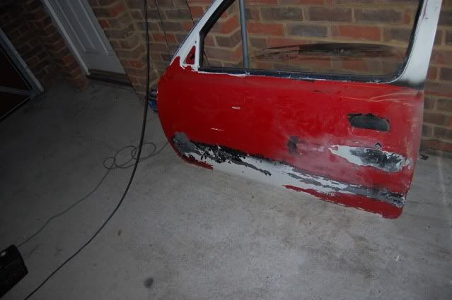

so much work to do on this door its easier to just replace it with a spare!
cheers(Y)
how about going back to bare metal where the paint is all uneven?surely then all you'd need is primer and paint? or have you got filler or poor finish on the metal?...just a thought! same thing happened to me when i pulled my bumpstrip off my door,all the paint came with it! was such a pain using filler primer to build it all back up again!
the door was a joke, check the pictures, not worth the hassle, ive 240 wet sanded which is taking it all smooth on rear quarter panel, two coats of primer filler, 1500 wet sand that, then two coats of grey primer seems to be doing the trick at the mo
if i can get the rustoleum of without damaging the original paint its far less work to do, my sanders not great either
tried nitromors but that has eaten some of the red paint aswell and sanding takes to long,any suggestions?
cheers
oh and yeah have filler in some places, the door i took off had big lump of it, might just get a wallpaper scrapper for the roof and use my heat gun again!!??

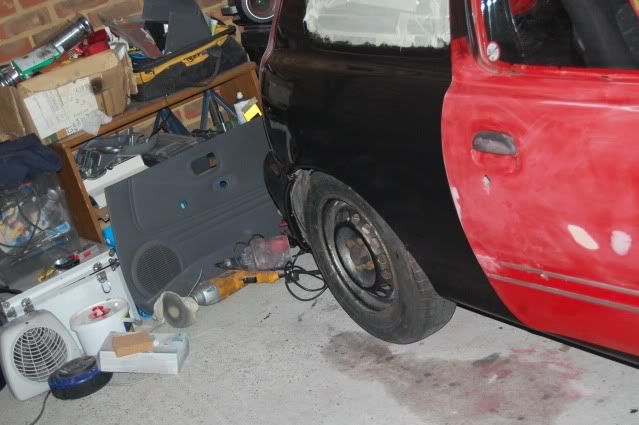

i was in the garage tonight sanding away whilst lying down (low bit on rear quarter) and actually fell asleep, around half hour later(i think) i woke up all confused and just shrugged my shoulders and carryed on sanding (yes im weird, i know)

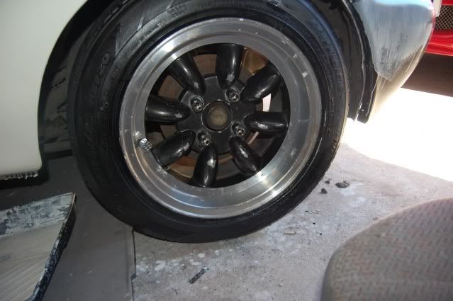

wheels are 13 x 7 minilite/superlite replicas i wanted banded steels but the vw boys put the price up for them so didnt bother, like them though but will need refurb to be mint

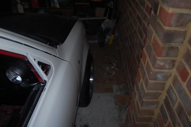

swung by sleeper ss today and got me two front wings in white, fitted near side and prepped and coated in primer,looks mint
sr steve,with my ride height,offset/wheels boot and jdm lights mine will be looking the same as johnzuko;s bar the spolier, i like silver,just need a cheapo job, ill keep thinking guys,cheers

im gonna spray it myself, i know how to spray with cans and get a decent glossy finish
nex ask any proffesional painter about orange peel, you flat and block it out ie wet sand the orange peel out, no painter in the world can put a decnt thick layers of paint without it happening
its having the know how to overcome and perfect the finish
im by no means good at it but i can spray as i said to a ACCEPTABLE standard and can prep the car to a decent finish
ill have some more photos later or tommorow, things will slow a little as moving next friday so will be busy with that but shouldnt be much longer now
couple of hours a night will get it done
oh and don t believe the ####ing yanks on paint jobs, the 50 dollar paint job is not as good as they make out
cheers
