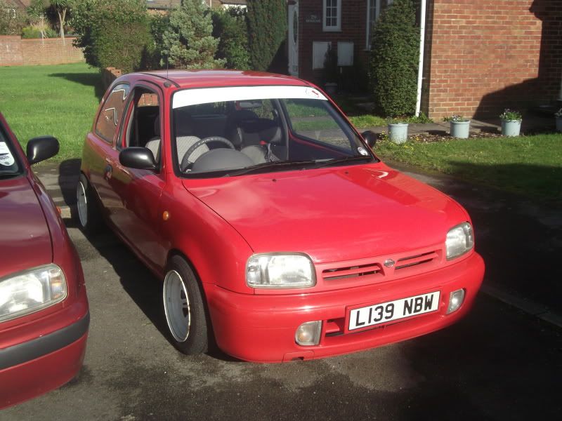

They will be staying white for now, the white is growing on me. I have a few ideas for changing the colour but I'll have to see what takes my fancy.
I've always been rather taken with the enormous boiled sweets stuck on the wings. Though I think combined with some crystal headlights and tail lams that worked along the same lines they could look good.
I bet that looks so good in person, they make the car look all light/ quick even standing still. Nice :) If you refurb them are you keeping them white?

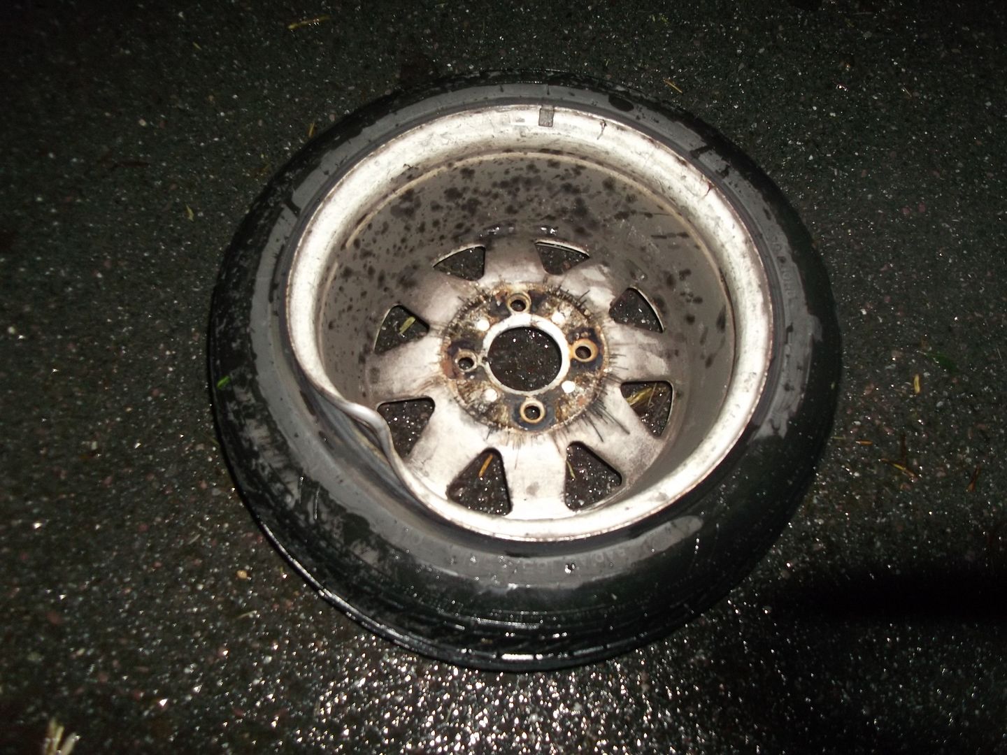

On the way out of Lewes I clobbered a pot hole. While pulled over formulating a plan I noticed two similarly stricken cars also stopped to change tyres. Fortunately they were carrying spares!
Outside of the wheel didn't look too bad:
Bit of a ripple in the rim.
The inside wasn't so good:
Ah, that's where all my air went.
Fortunately not too far away from the barn, and with one remaining fully sober driver still there I was able to be rescued - with the wheel from a Corsa - CB issues overcome with a slip on spacer.
Got tuck?
Which got me mobile again. After which there was a pause for Cider, deep fried turkey and general talking rubbish about cars.
Some time later I got working on getting home. Starting with a lump hammer I started getting the rim back to round. It was also suggested to try a bottle jack on the inside which pushed the wheel into an egg shape, but working round the inside we were able to get the wheel with in a few mm of being round. It was filled with air and left over night.
It was still pumped up in the morning, so I gave it a try on the car. No adverse effects were felt, and it's still on and holding air now. Winner.

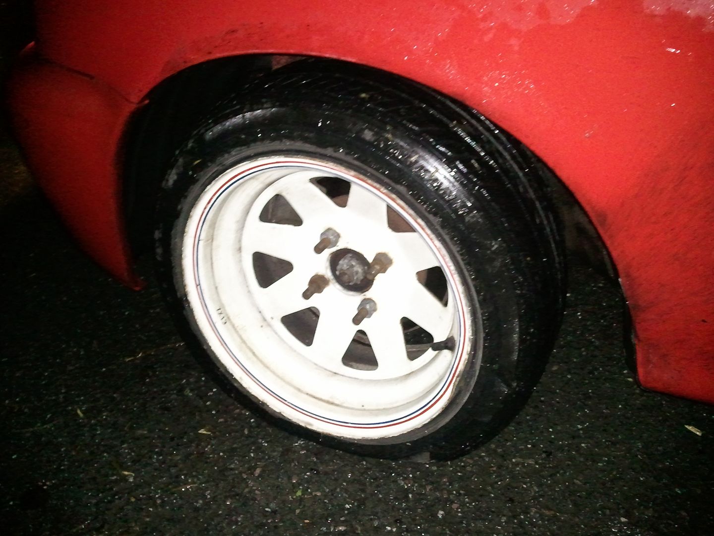

This happened again. :( N/S Front.
But after some persuasion with a variety of heavy objects I had this:
So headed offout for a test run, and found that the ballance had not been upset :)

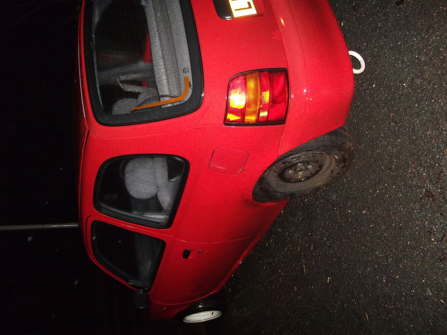

Then had a blow out :) N/S Rear - most likely caused by damage from the last pothole incident,
So, still having no spare, but knowing I had a tyre at home I grabbed the bare wheel from the boot and wandered the mile or so home from where I'd left the car.

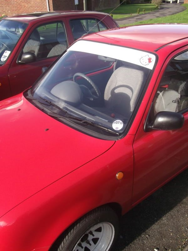

Got this making a return to my car, having been through two other members since I passed it on before:
