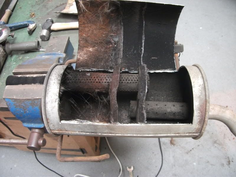

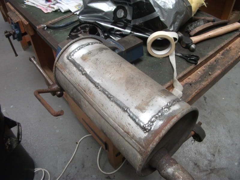

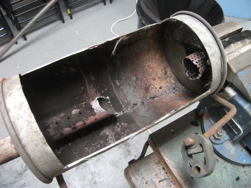

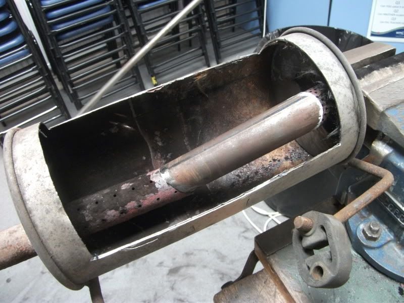

How to make your car sound silly:
Remove back box, an slice open like a tin of sardines,
Get rid of all the gumph in the middle,
Badly weld in a link pipe, (I'd have used perforated if I'd had some).
Pack with roof insulation - to hopefully dampen the sound a bit, and sew back up,
It goes Prrrrrrp Prrrrrrp etc.

There was a little burning when welding - it got fapping hot of course. But I shouldn't think theres going to be enough heat to burn it from the exhaust. It's pretty much the same stuff that was in the last section anyway - you can see the remnants in the first pic.

Yeah I was hoping for something a bit more subtle - but i may as well have just welded in a straight peice of pipe in place of the back box - there would have been less turbulence!
I was hoping that the stubs of perf would help a bit, thats why i filled it with glass fibre insulation.
