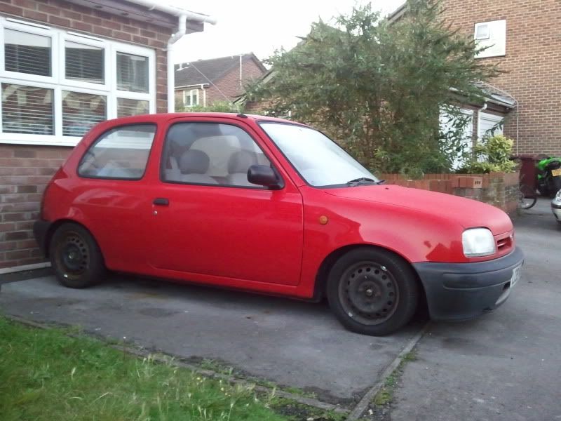

I grabbed a couple of pics while out and about today.
When I got home I watched a set of 7x13 Superlites end on Ebay for under £90. Wrapped in 175/50 Yokos too. Unfortunately they were collect only and in manchester, oh yeah, and I have no money. :(
The car still looks awesome even without any fancy wheels :D I'd definitely keep an eye out for some Superlites though when you can afford them, they'd look gorgeous on a Micra.

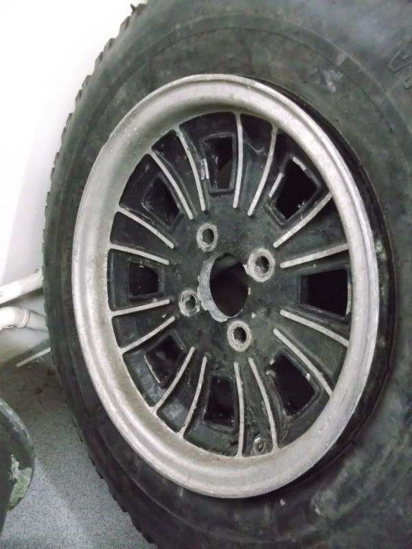

Over the past couple of months I have been weighing up some wheel options. I've been offered a couple of sets of wheels on long term loan. The first are a set of Astrali in either 5 or 5.5 x 13, in a fairly low offset, which currently look like this:
They are pretty battered and I'm having a bit of a mare getting the huge gravel spec tyres off of them. They will be hard work getting them cleaned up to use and several of the raised veins on the face are dinked and will show up when polished.

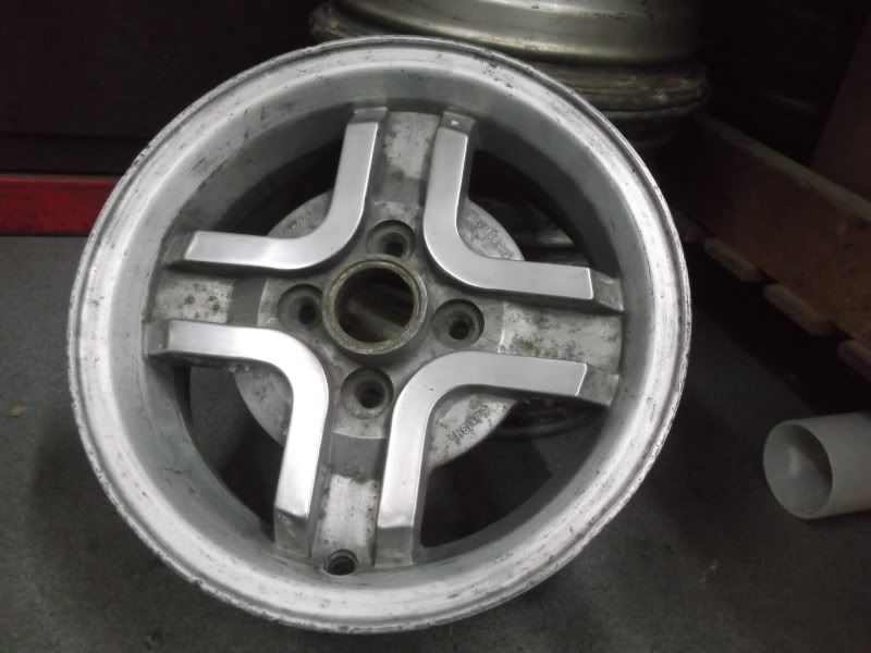

The others are a set of Cromodora, in 5 x 13 these are in much nicer overall condition and will look cracking with the face of the spokes and the lips polished. I'm thinking gold for the background colour.
I've started the polishing on that one.
Both sets meet my criteria price wise, but I'm unfortunately also severly lacking in time to get them looking good. Being 13"s of course they will take my current tyres so that keeps the over all costs down.
They each have their own centre bore and PCD issues, the Cromodora set are a not unsurprising 4x98 with a CB of 58.1 and the Astrali set are 4x4" with a larger than 59.1 CB. Each presenting their own problems.
I'm pretty much set on the Cromodoras at the mo, what do you guys recon?
