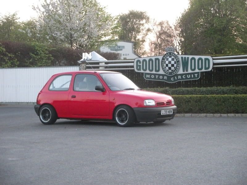

Just more pictures that indicate how much I could do with loosing at least another half coil on the rear.
But for the sake of the tyres, and the ability to carry anything, it will be staying where it is for now.
That looks ####ing epic mark!!
I'll see how much a set of rear corsa dampers cost, that will definaltely sort out the rear, another coil but with dampers that hold the spring in
I'll have to sort out that arch roller and both my and your arches sorted mate
Looking pukka though :)
I'm liking those pics, got style. I think your right about the rear, just that little bit lower may go a long way looks wise.

Looking low n' sweet there mark, just shows how getting basic essentials right makes all the difference. (Y)
Cars looking apserlutely fantastic mate, and the ride hide i'd say is perfect too, it cuddles into the arches just right, perfectly ballanced, one of my faviourites this one (Y).
Keep up the mint work.
so if that stock suspension on that how on earth did you get so low?
i dont understand it my ickle wheels look silly atm
Re-engineered (as HoodedReaper puts it) coils all round, fronts are wired into the cups to prevent them from unseating on drop. On the rear the shocks have been modified, welding mounting plate further down the shaft (essentially shortening it), with a sleeve over the treaded section at the top. Frank does it a lot - its where I got the idea! This prevents the axle dropping too far and allowing the springs to unseat.
This is by no means an ideal solution. The ride is pretty shocking, with the stock shocks not doing a very good job of controlling the bounce of the now much stiffer springs. But it was cheap.
I reckon giving yours a coil off, maybe coil and a half at the front, would be a good starting point, then see how it goes from there. Take a bit at a time, see how it looks then a bit more if nessasray.
