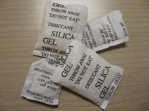

Dug the car out of the garage today to be met with mould ...
Oops.
Any tips on storing car?
Yup. You can buy big bags of silica gel pretty cheap online.
Have a few and rotate them now and them and place them indoors to dry out to be reused.
