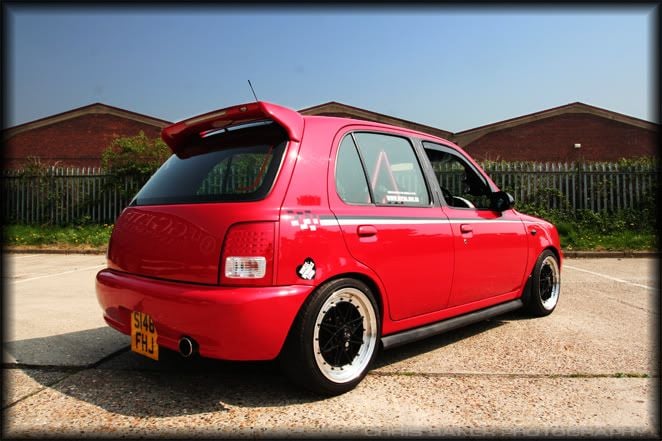

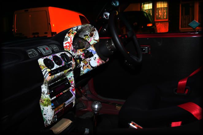

Heres another,played about with the flash tonight:

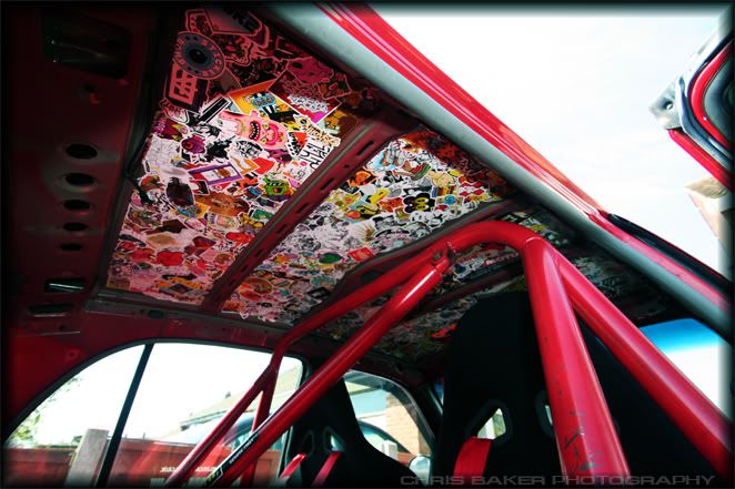

:eek:I like the stickers on the roof. The reflections from the stickers on dash in windscreen would annoy me though:laugh:
ps. I recieved the flywheel today pal, cheers(Y)
Looking awesome mate :)
Your photos are like frigging magazine quality mate, muchos respect to you
Maybe you should get it featured in banzai looking like this
Dont sell it Chris it will break your heart and many others

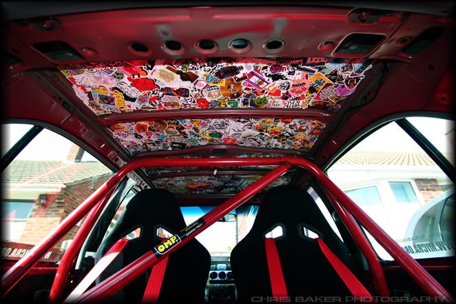

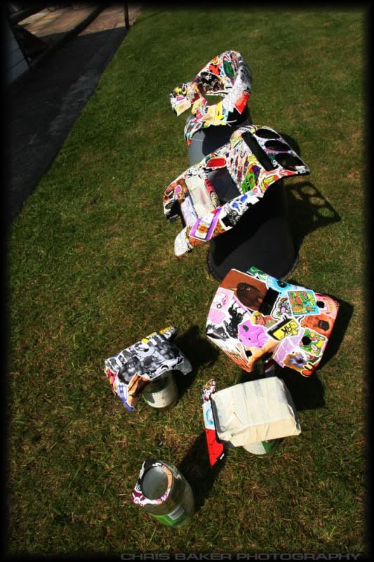

Been a very productive day! First job was to remove the new sticker bomb'd parts and give them a coat of lacquer. Didnt take too long to dry as the weather was lush!
Next job was to remove the seats,remove the remaining sound deadening and give the floor a lick of paint.
Another 1/2 stone lighter!
A few hours later...and SHA-TING!

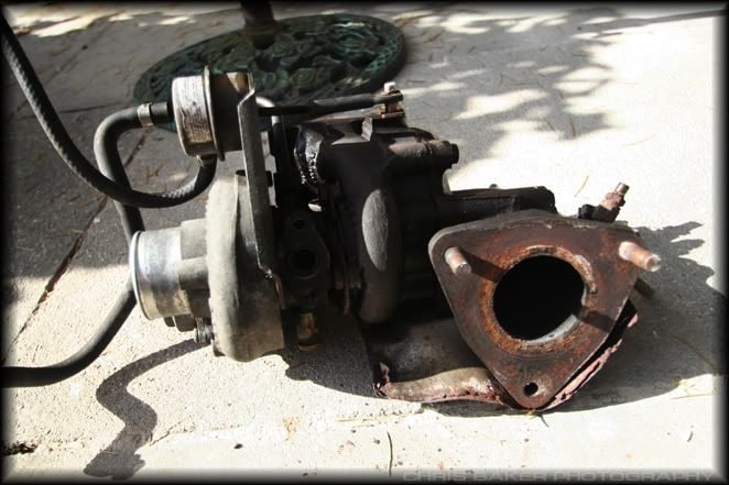

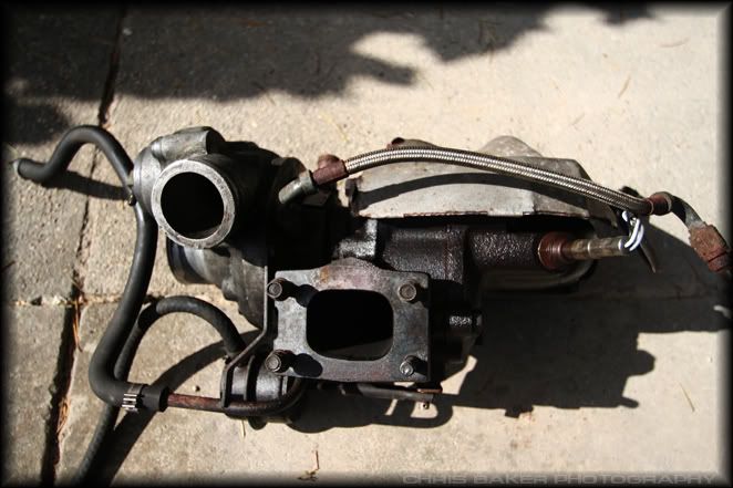

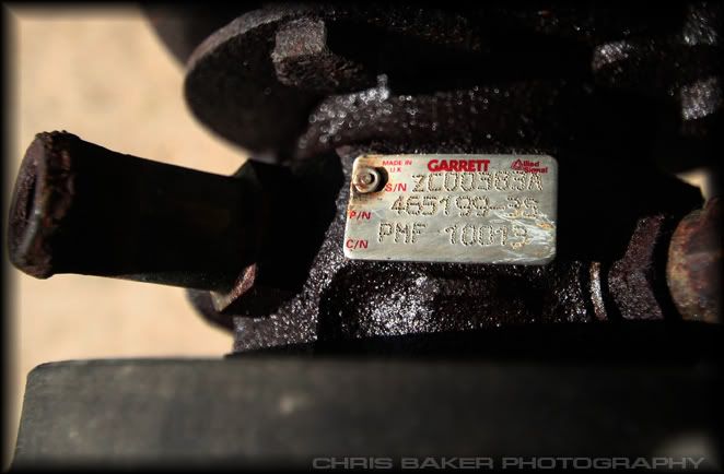

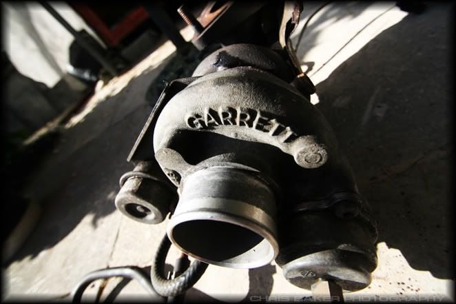

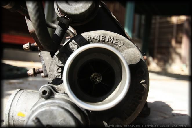

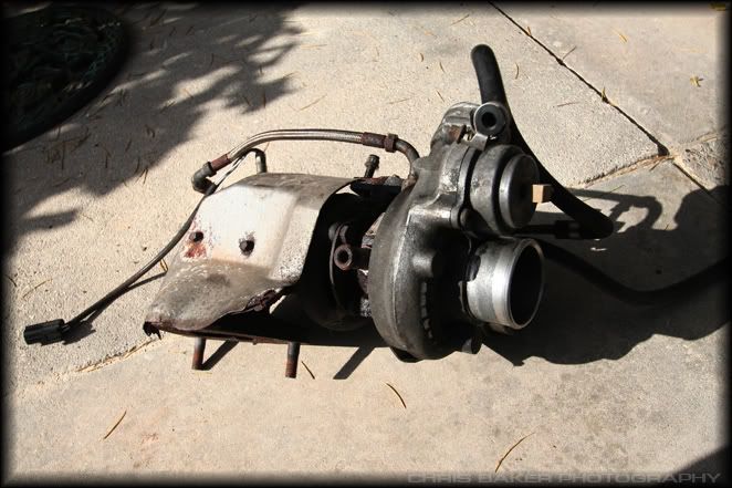

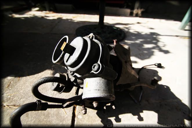

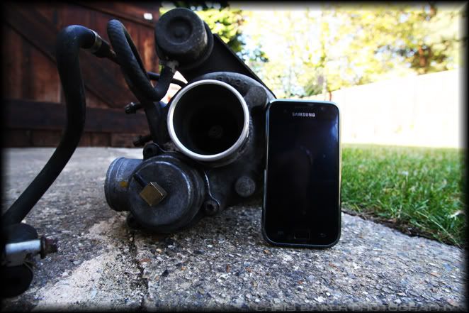

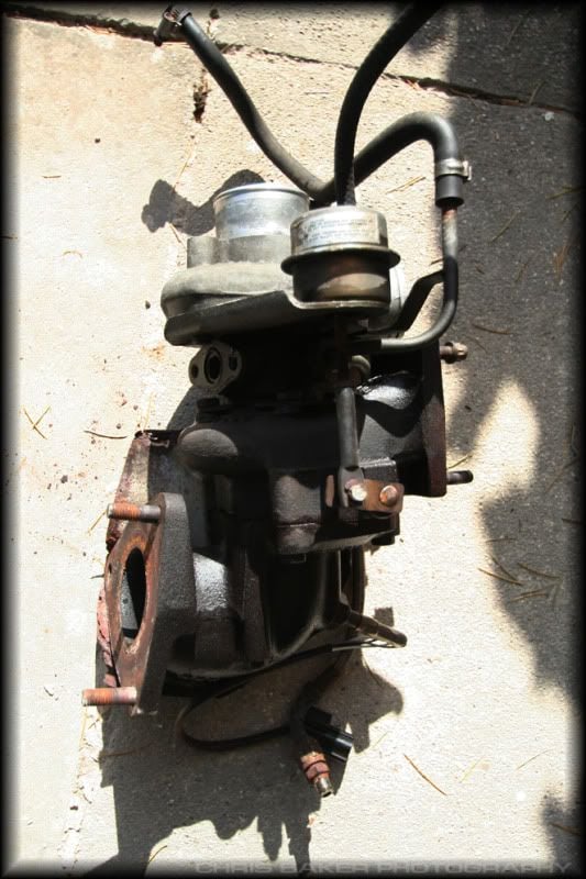

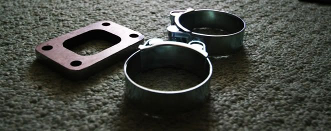

T25 then according to google?
Is there any numbers on the turbo?
I ordered a t2 kit and it didn't fit! Banjo was ever so slightly to small for banjo bolt and banjo bolt was different thread
Opened the banjo up by 0.8mm and used original bolt all ok
You need to ask the seller to confirm it really wouldn't want you to get wrong bits
Are you coming off head oil gallery or sandwich plate?
*edit just seen the numbers .... Duh ;)*
Email the seller these pics mate
She will be fine although I think you'll have to sit it like mine to fit
Frank will sort this for you though mo
Welldone though mate, first step made at least matey ;)
Hold fire on ordering oil feed, you already have a feed, you just need to know what fitting is on end of it then you just need 1/8npt to - 4an oil line and adapter for other end
