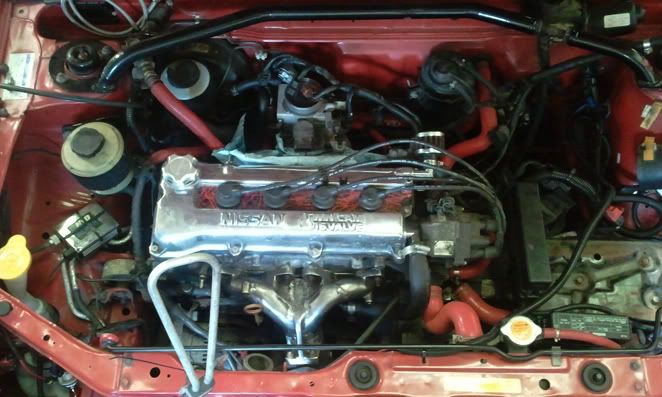

Went to the Jap Show today,was an awesome day! Acclr8 grabbed this photo of the Micra

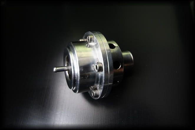

Now got my Dump Valve

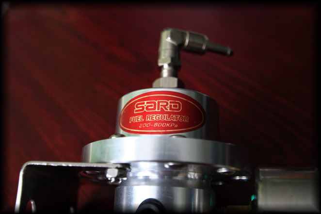

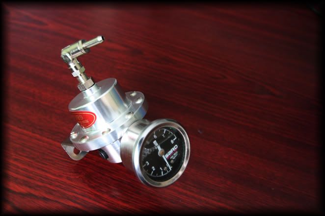

Also picked up a SARD Fuel Pressure Regulator at the show

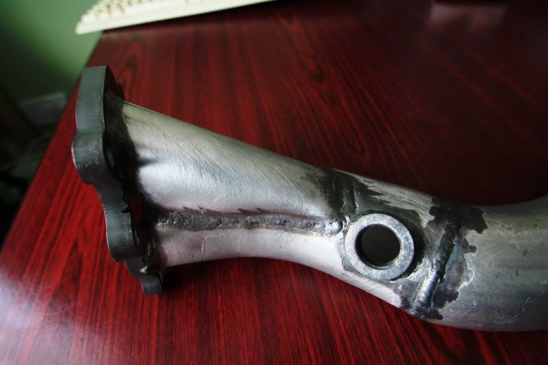

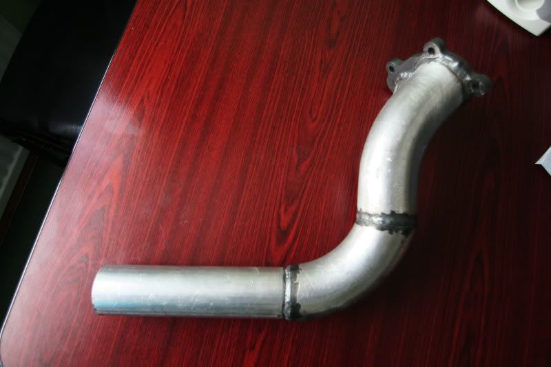

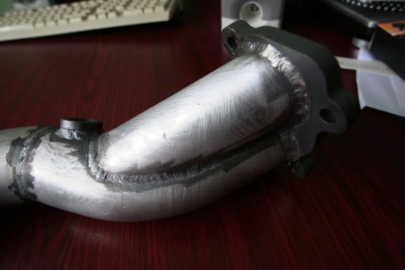

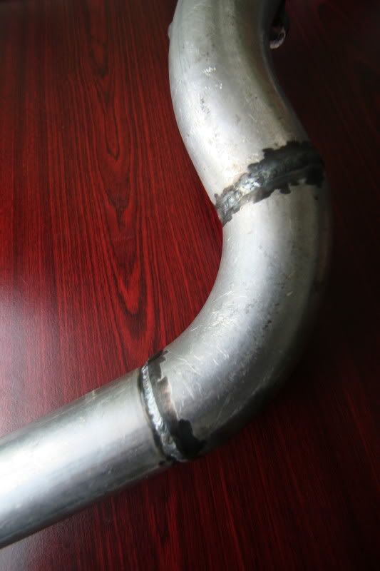

Down Pipe now made

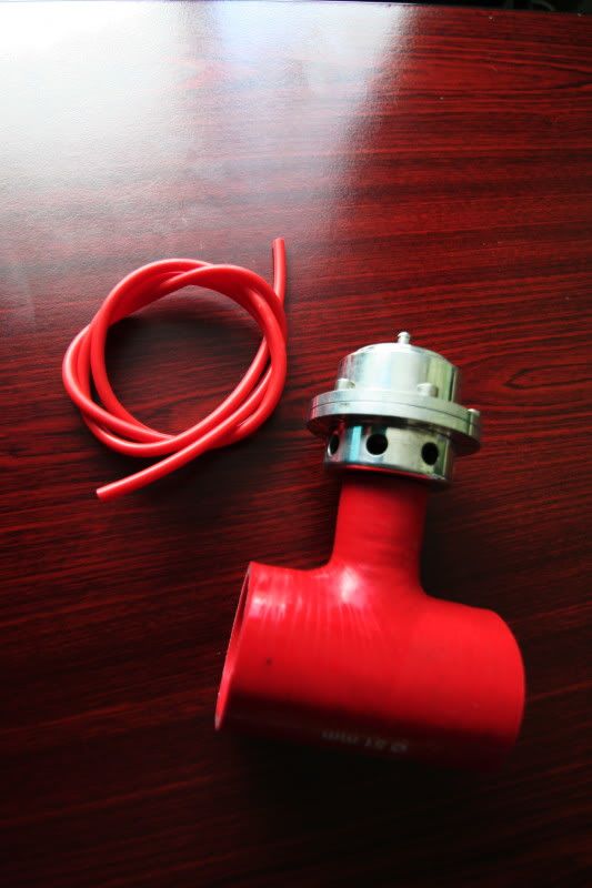

Dump Valve silicone Hose and Vacuum Hose

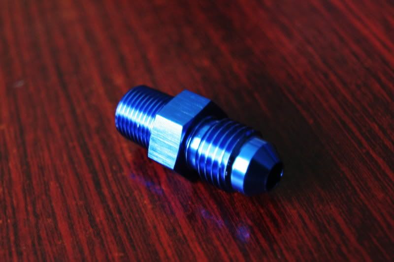

Oil Feed Adaptor

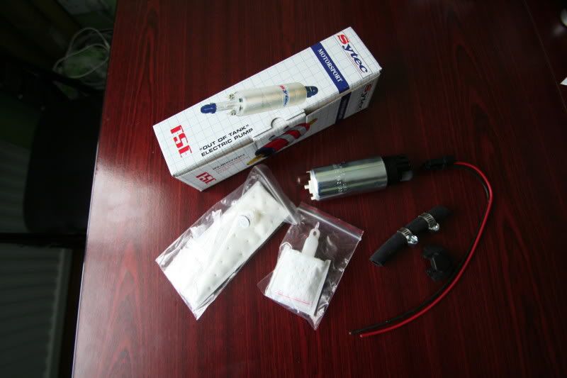

FSE Fuel Pump

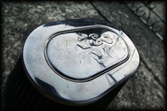

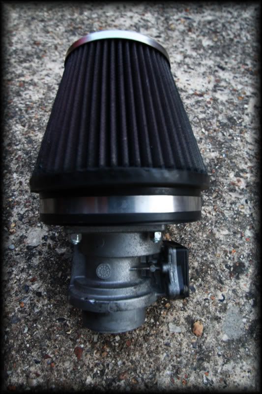

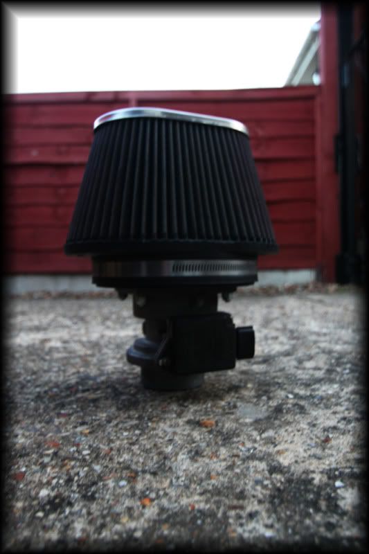

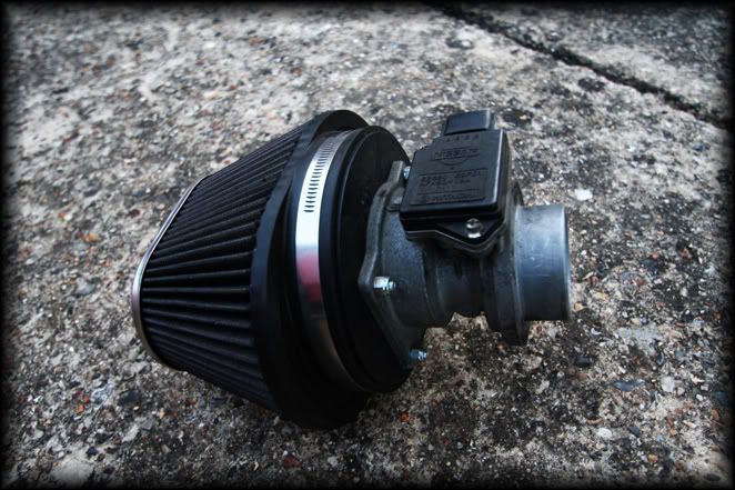

While at work today i rang Ed at Fusion Motorsport,had a chat with him about the set up and what needed to be done. He said i needed to get an Air Flow Meter from a 200sx,which i knew was gonna be a task by itself! While on the phone i booked the car in for wednesday 3rd August :D :D
Once off the phone,i was back on it and made a call. This afternoon,i had a Air Flow Meter sitting infront of me :D In this situation,its not what you know...its WHO you know :)
I picked up the Air Flow Meter and K&N Filter for £60.00

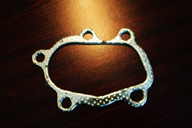

New downpipe gasket:

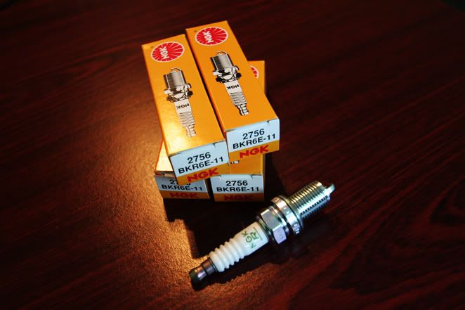

NGK BKR6E-11 Spark Plugs:

Brilliant chris! Do you defo need the fuel pressure regulator and air flow meter, does ed wire it in or do we need to get the loom/connector? These are parts i aint got so need to know cheers :)
Ed said i'd need the FPR as my injectors arent big enough. He was the one to mention about the 200sx air flow meter. He said fit it and he'll wire it up

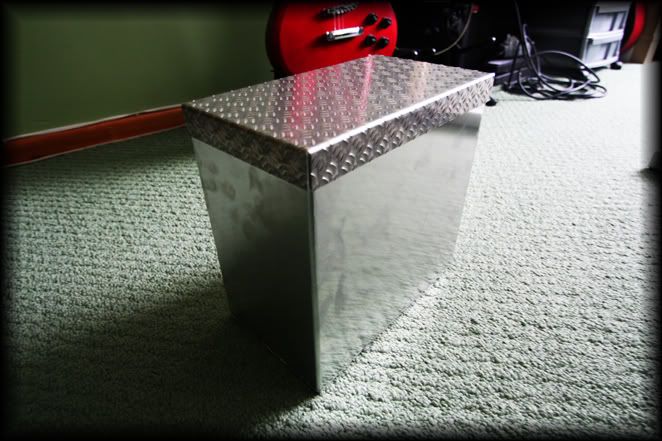

Collected my battery box last night:

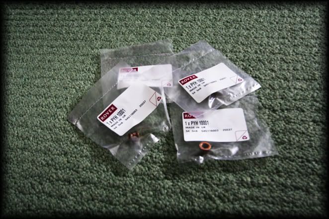

FINALLY sourced some M8x1 nuts that hold that Turbo to the Manifold,got them from Rover Main Dealer at a huuge cost of 14p + VAT each! So ordered 8... (only photographed 4 though)

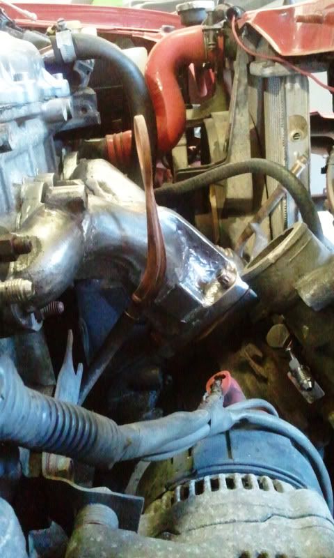

manifold and turbo fitted

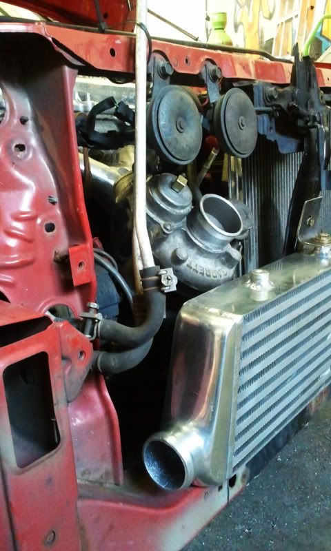

Came across a couple of problems:
As the turbo sits forward at an angle the intercooler doesnt fit,so will need to move the support bracket for the bonnet catch in towards the radiator to allow more room. Will then weld brackets to the cross member to bring the intercooler out further. Cutting the original (spare) front bumper to make it all fit nicely.

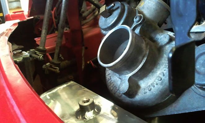

Got a phone call today at work saying that the turbo is physcially too big and fouls the radiator. The intercooler is also too wide and the pipe work is impossible to plumb in using the universal pipe kit. Only way round it is to source a T2 turbo and a smaller intercooler.
I think i've found a T2 which i'll be looking at very shortly,once checked out and it seems ok i'll be bolting that straight on. Because of the position of the turbo (inlet facing forward and up) its difficult to get the pipe work to fit for the air filter. Fingers crossed with the smaller turbo on,it'll allow us more room. Whether the current intercooler will fit,i dont know.

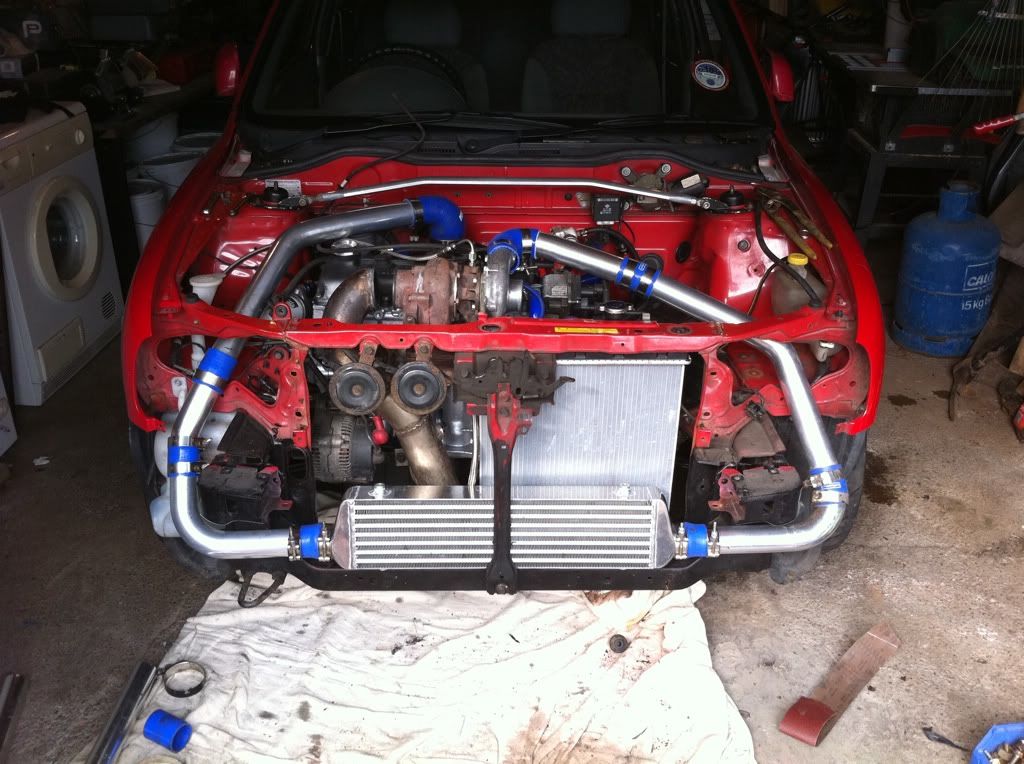

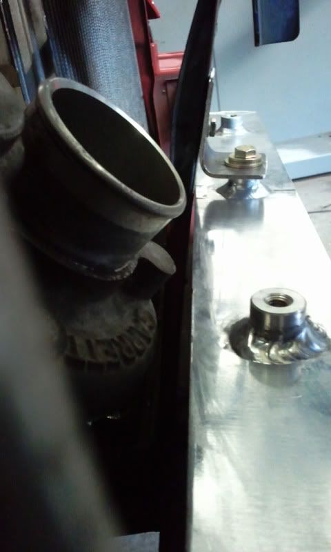

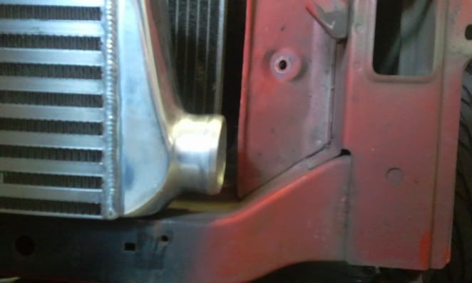

Heres the intercooler placement:
and the clearance between the intercooler and the turbo:
you could relocate the horns eh chris, and the powersteering cooling pipe does,nt do a fat lot in our climate.
will you not fit the filter directly to the turbo (behind the grille ?
Even with the horns moved i've still gotta do a 180 degree bend to get the filter sitting to the left of the engine. The filter is massive plus i've gotta get the air flow meter in there aswell. I could get a smaller filter,but would mean getting an adaptor plate made for the air flow meter (as its a square base)

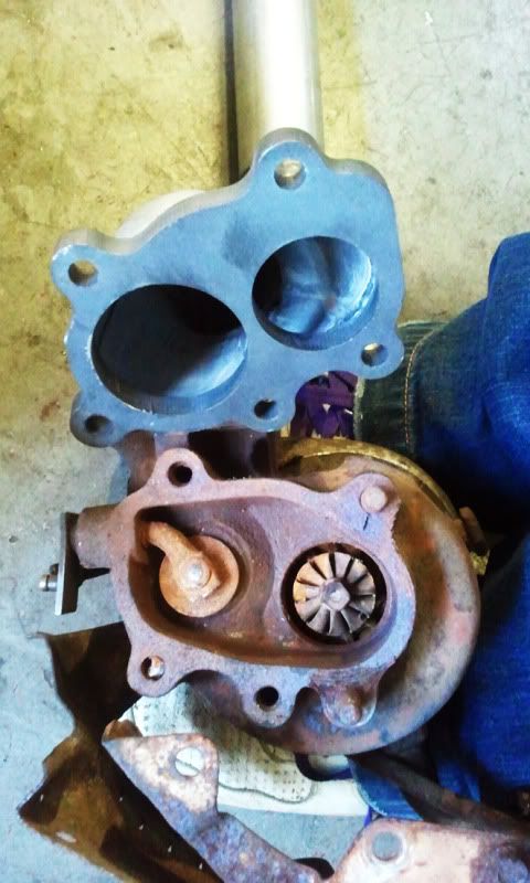

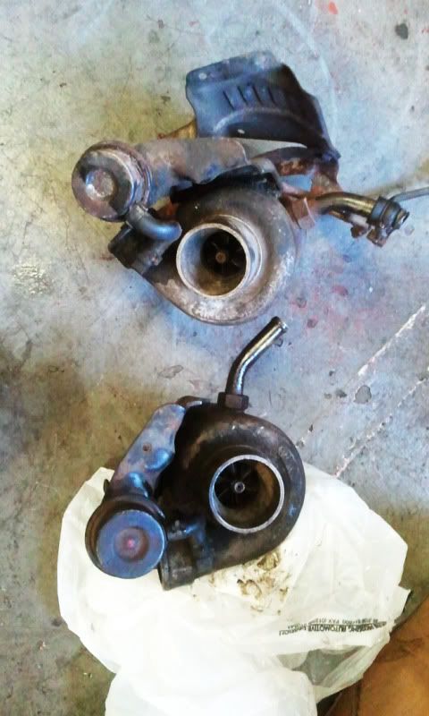

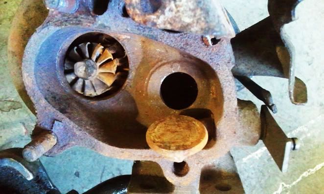

Finished work early today and headed over to check out the T2 turbo. The turbo was fine didnt have any play but it was damaged. Bare with me,i dont know the technical names so you'll get vague descriptions. Its the housing behind the compressor housing,where the exhaust downpipe bolts onto. Anyway,one hold was blown and cracked,luckily he had ANOTHER T2 there,but the opposite way round,the housing was fine but the impellors were shot.
Cracked Turbo:
Fine turbo:
I then checked the downpipe,with the T2 and T25 both having the same manifold flange,i wondered if the downpipe was the same or not.
Nope,its different...the piping is on the wrong side of the flange. Getting it cut and re-welded the other side didnt seem too bad,but thats just one of these lil things that happens.
So got talking to Fast Eddy who had happened to pop down to H&S Performance about the two T2s and he said to split both and make 1 good one,it'd need to be sent away for balancing and new bearings put in,which could cost about £200 (the T2 is/was £80!)

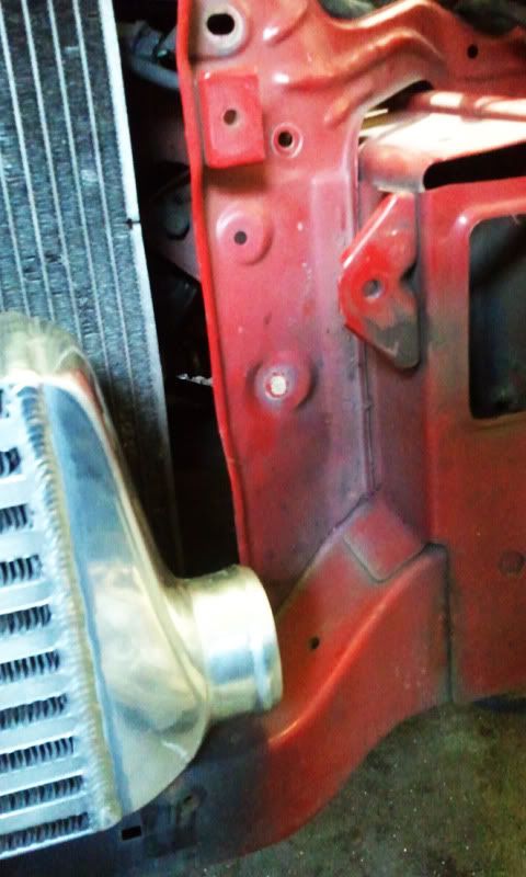

Intercooler outlet clearance:

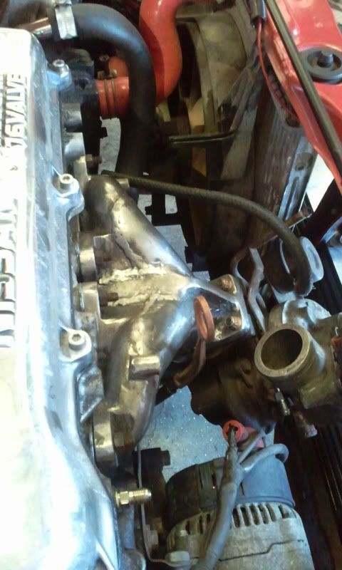

Even with the slightly smaller T2 turbo on (if i spent nearly £300) the problem still lies with the manifold. The manifold is angled too far out/forward which is making the turbo stick out further. The angle of the turbo at the moment clears the alternator,but it causes problems for the intercooler pipes. I'm not having a dig at Frank,who made the manifold,its just happens to be how the turbo sits. The manifold needs to be angled down more as apposed to at an angle. You can see from these photos...
My options are:
- Get a tubular manifold made and carry on using the T25 as planned
- spend nearly £300 on getting a decent T2 and risk using the current manifold
- sell the whole set up
As i said to the guys at H&S,i'm trying to do a conversion that isnt made for the car. I could get it all fitted and i'll have more problems waiting for me further down the line.
I dont wanna throw the towl in,but i cant physically afford to buy anything out,i can litually afford the fitting,remap,travel lodge,petrol to get trailered down to Fusion and THATS IT
I'm at a dead end at the moment....
