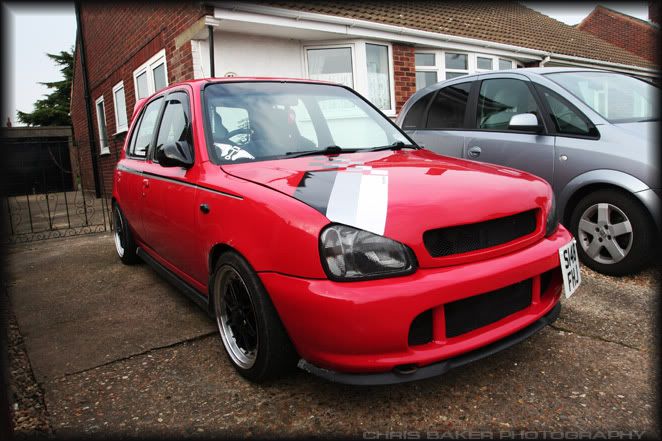

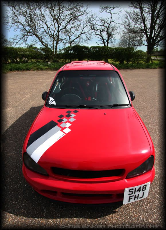

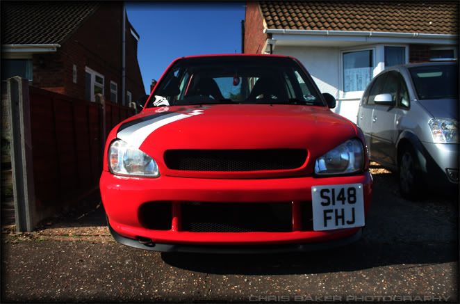

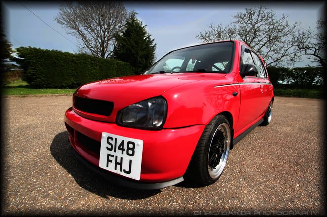

Got my smoothed bumpers back from the body shop after 9 months!
Average quality Galaxy S phone photos for the time being. Needs a bloody good clean though!

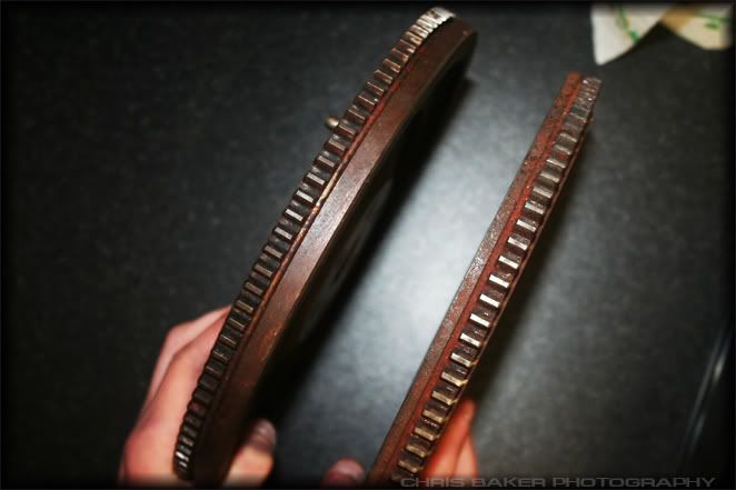

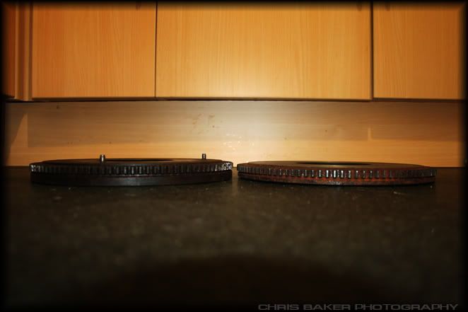

Yesterday i collected my new lightened flywheel:

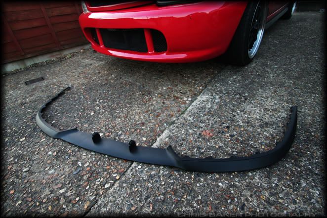

This afternoon i fitted my new Cupra R splitter:
I then popped down H&S to get the gearbox,flywheel and clutch fitted. Stripped everything off and matched up the gearboxes. FINALLY i've got the right gearbox! So off came the flywheel and clutch,the clutch fit the gearbox...but the flywheel was wrong!
The flywheel had came off a Micra the same year,so you'd imagine it'd fit right? The new one was missing a dowel (original had 3 new one had 2). Also the clutch cover holes didnt line up with the new flywheel. SO rather than messin about finding yet ANOTHER flywheel,i said just re-fit the 1.3 flywheel.

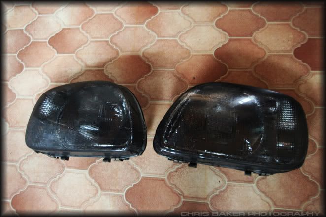

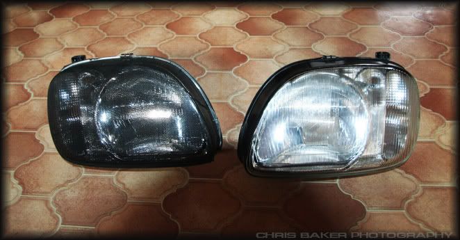

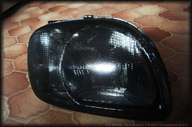

Do you have HIDs now fitted? I remember a while a go you've said you moved the HID kit from Polo to K11.
I wonder how is your headlight's light output atm, cause the flyeyes kit reduces it significantly.
Lights arent effected,well from what i can see:)

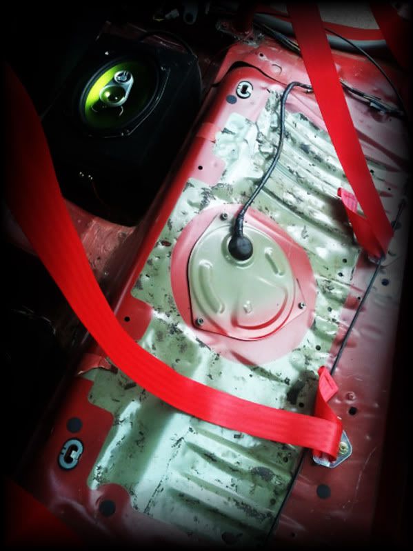

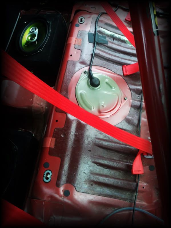

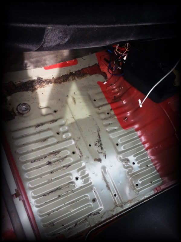

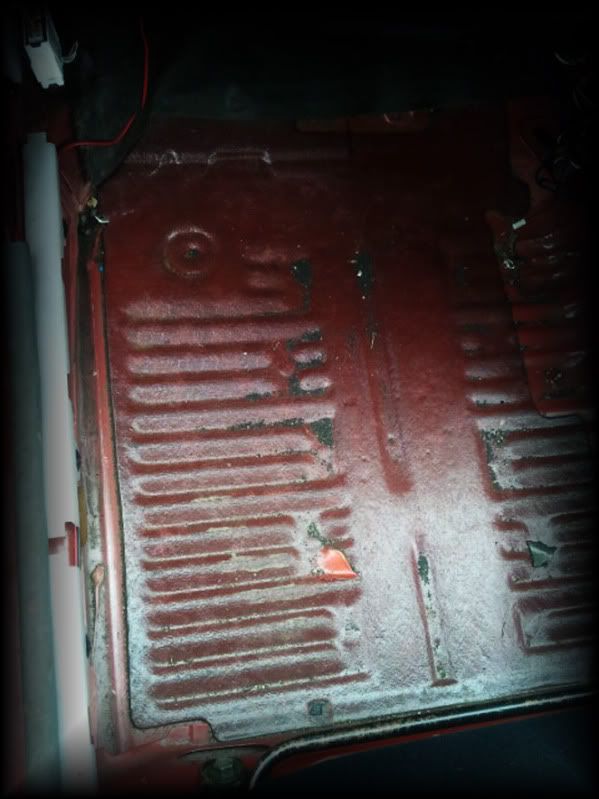

Today's task was to remove the sound deadening:
Rear Bench:

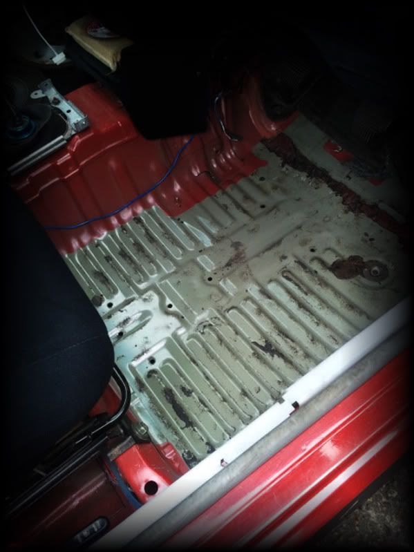

Passenger Side Footwell:
Driver side footwell done:
Overall weight lost:
May not look much,but i'm sure it'll have some sort of effect on the car :)

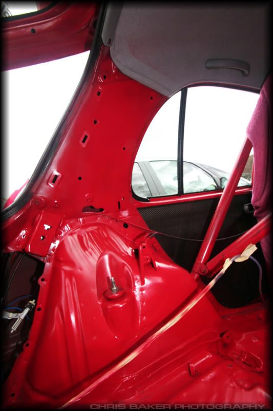

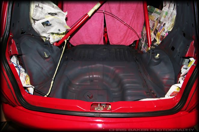

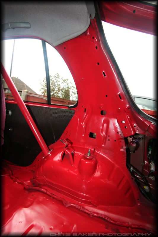

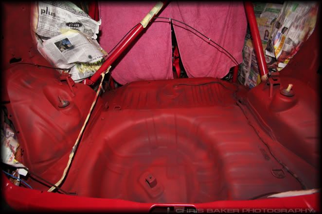

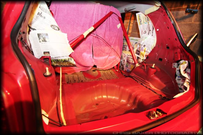

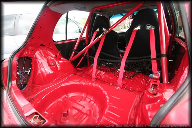

Back of the car (rear bench and spare wheel well) are now scotch brited ready for a coat of Etch Primer. Weather doesnt look too sharp at the moment so gonna leave the spraying till tomorrow when the sun is shining again :)
Next step was to start the re-spray of the back of the car
Slight rub down with a scotch brite pad to take off the shine:
Etch Primer:
Red Primer:
Then Paint!

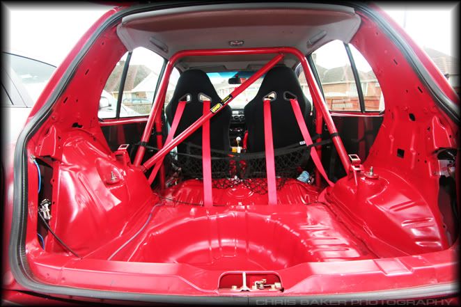

I cant remember as it was awhile back,probs in the £150 region thats including spraying the bonnet aswell :)
With regards to the OMP Cage,i have no idea which model it is,as i bought it 2nd hand from a member on here :)
