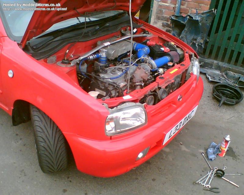

How are you planning on keeping charge temps down? That intercooler is begging for a cool supply of air. I would have been tempted to put it behind the front bumper and just route a few more feet of samco hoses, it would make a big difference to performance.
The other option is a bonnet scoop, although I've never really liked the look of them myself. Very tidy install though, well done.
latest pics of the engine bay now its a bit cleaner...
next on the list of modifications is mikes gearbox from the NME micra, this has a shorter final drive and an AP LSD. along with a 190mm HD clutch from oz. hopefully htey should be in within two weeks

Looks like one of your horns is damaged...
Looking at that it really does look like that IC will be getting very hot as it has no way to get cold air to it, how soon will you be fitting a chargecooler, it should see some very good gains indeed.

i think the size of the intercooler is fine however it needs a bonnet vent where it is.
