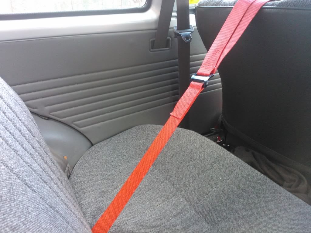

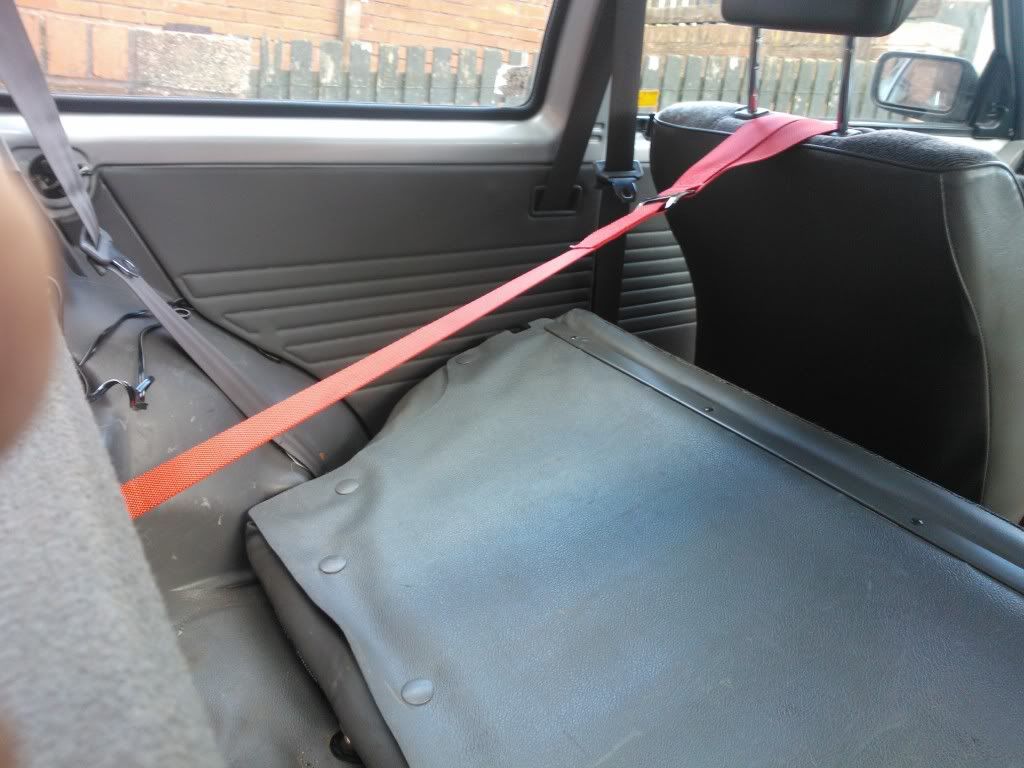

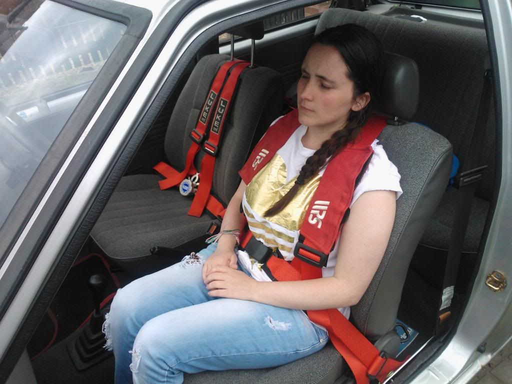

That's a look of 'Fine, I'll pose for your silly car but I hope you know you chose this over sex tonight'harnesses fitted

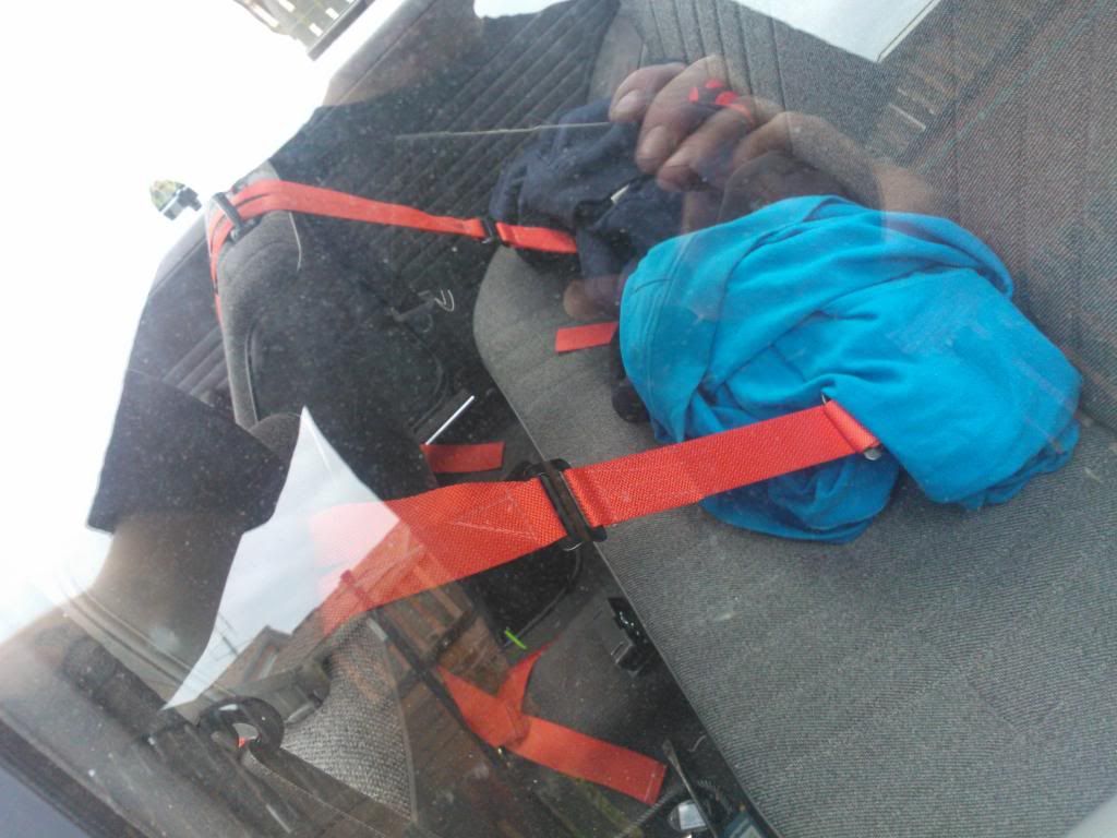

sshhush you i got no where else to mount themDon't wanna pi$$ on your bonfire Belly but the belt straps look a bit steep
Harnesses are supposed to keep you safer mate, not increase the risk of injury And you know I would gladly buy you a cage if I could When I win the lottery ehsshhush you i got no where else to mount them
Unless you guna buy me a cage? Lol
where else could i mount them?Harnesses are supposed to keep you safer mate, not increase the risk of injury And you know I would gladly buy you a cage if I could When I win the lottery eh
Personally I would say if they can't be mounted safely, within specs, then don't mount 'em. Harsh but true but that's me eh.where else could i mount them?

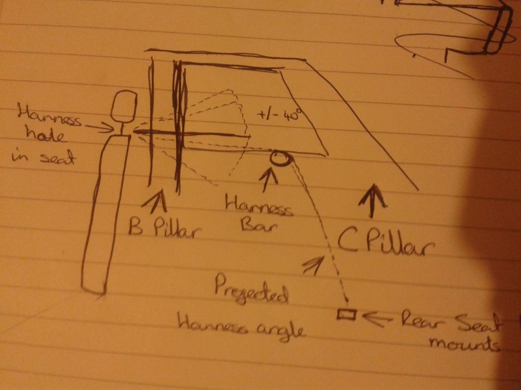

I feel like your dad now cos that would make me feel betterMight see if i can get a harness bar made up
As long as they're between horizontal and 40 degrees you're fine
Eaaiest way is a long steel tube welded directly behind the back seat.
That's if your keeping the practicality of it
And hope your harness reaches
Between b and c pillar as close as you can to your bolt holes and as level as poss to the holes in the seat.
I'd go 2/3rds across from the b pillar
Sure hold oncould you draw me a pic? lol
It's simple
At the moment, I like this a lot. Bar the Ripspeed seatbelt cover, yeah, I spotted it!
Don't fck it up junior
You can get 3" ones yesthats cos i already had them and my gf was commplaining about it hurting lol, im after different ones, can you get wide ones? just they only just fit them straps
Yup. But that's your rear seats blocked
Much but now I'd worry about the backrest being flung up in an accident

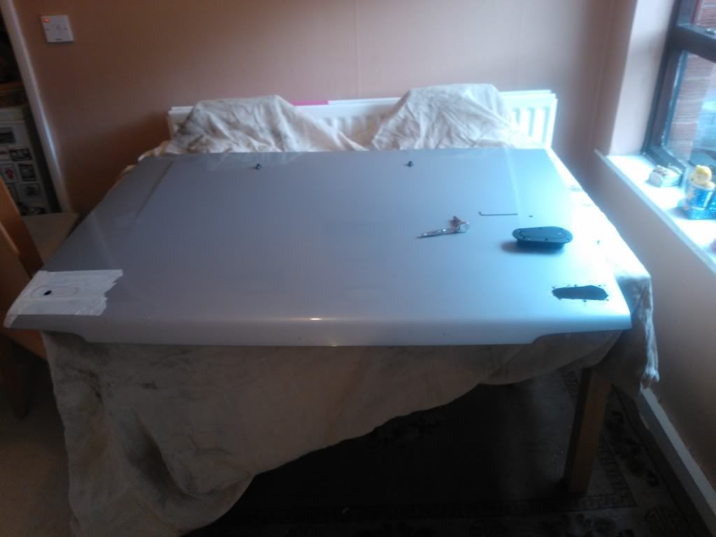

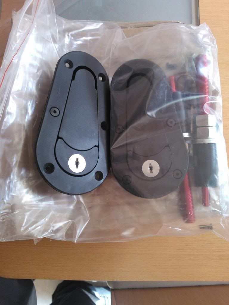

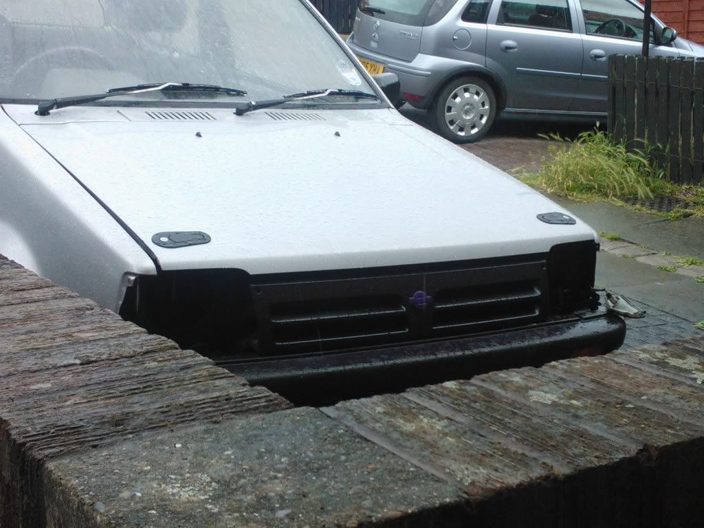

Nice job Belly but as the k10 bonnet is hinged at the front shouldn't the latches be at the back of the bonnet?? Or have you got rid of your hinges completely so its a 'lift off' bonnet?
hinges still to come off but there not attatched lol bonnet was annoying me being in the way lol
Raise the rear too. More positive air flowand it makes the front of the bonnet sit a lil high but dont care lol
Easy to do
Its possible but not recommended coz it can flap from side to side. You want a second set of pins reallyusing the normal bonnet latcch?
